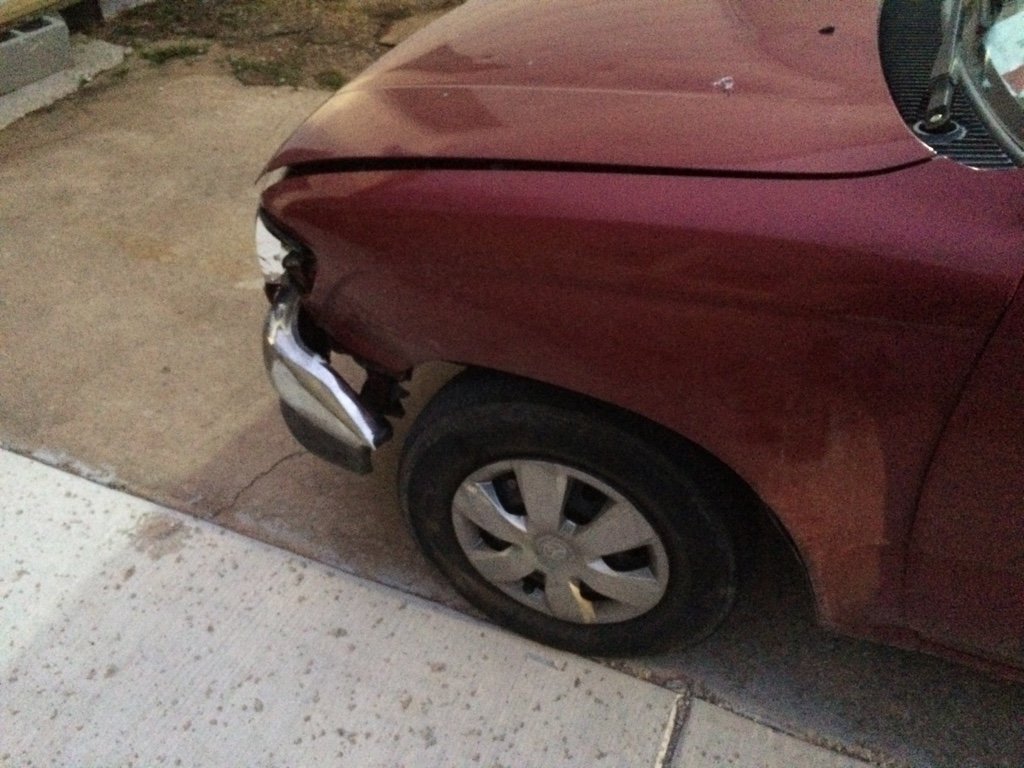

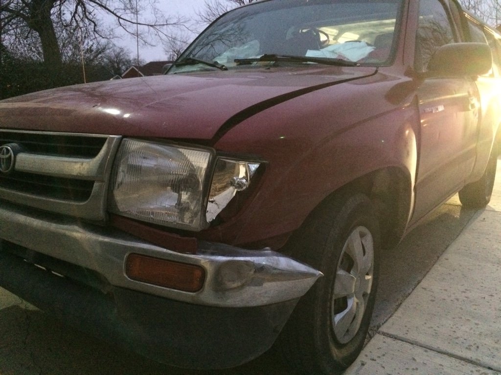

    Girlfriend has a 97 base model Taco that I will have do change some sheet metal on due to accident. Other driver uninsured. What models can I scrounge for:
    Fenders
    Bumper
    Hood
    Grill
    Headlight
    Turn signal85841eb7af1aa7180a752a2d5d2b24fb_7312cc141350a2c088da500e509c4a5f25f45f2e.jpgc7160072c9b62407d185ffa884e98dd4_0e347af0e6a4838b03e83d9052e481731a153ffd.jpg

    I would say 1997 to 2000. 1st gen ran from 95 to 2004, but the face lifts changed grilles, lights and bumpers, so 95 to 96 and 2001 to 2004 will not work without more work - doable though if you can find all the parts and you can do the extra work required.

    Thank you for that. I was hoping that a 4Runner might be a possible doner for some of it. Never really looked that close at the sheet metal on one, but parts for them are easy to find here. The Tacomas, not so easy.

    Upgraded 2002 Tacoma to 2018 Tundra
