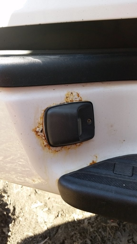

    #1 what's the best way to fix rust on the bumper?

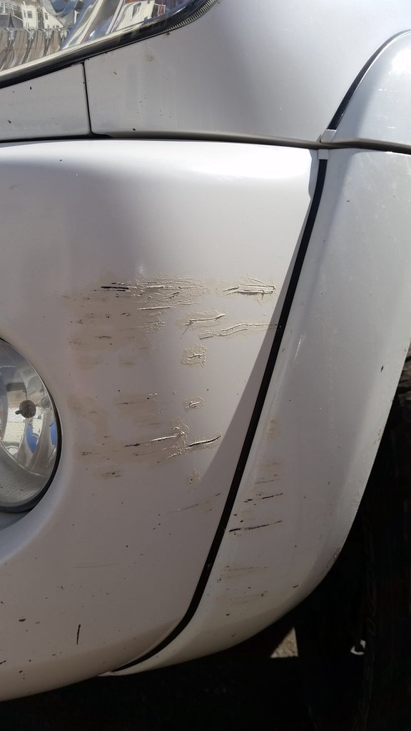

    #2 what's the best way to fix gouges on plastic body panels?

    Sand rust spots. Get good rust primer spray paint. Then napa auto spray paint matching color.
    For the other. Sand gored spot down until smooth. Get bondo to fill gaps and sand with # 400 to 600 sandpaper design for auto. Primed and paint.

    Will I be able to blend the paint or should I plan on painting the whole bumper?

    blend it.. no need to do the whole thing

    Holy spackle on the bumper batman. :D

    Bought it like that :rolleyes:

    Not sure if I'm going to be able to get all the rust off. Still working on er though
