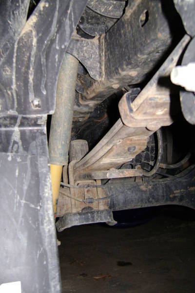

    Do you think my factory leaf pack is shot. In a few of these pictures I noticed that it looks like the factory leaf pack is bending at the end of the AAL making me think that the AAL is doing all the work. What does everyone think?

    that dosen't look good at all... The rear looks good, but the front looks like it's bent over the aal...

    Both sides look like that. I guess ill be buying a new leaf pack.

    i'll take a pic of what mine looks like..

    Here is a pic of my leafs..

    :eek: Dude, replace those leaf packs soon. They're really, really shot.

    the leafs are already shot..
    You could band-aid the problem, (airbags / timbrens), but those would be taking up all the weight, but not solving the problem..
    OP -
    1. Replace the leafs.
    2. Get a new AAL (if you want the lift back - better to replace the AAL too rather than reusing as you don't know how much stress it has already been taking)
    3. If you carry heavy every so often, get airbags or timbrens to take some of the load off the leafs when you ride heavy..
