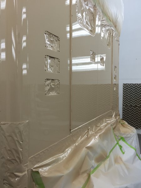

    Laid this paint down this evening on a ambulance. It reminds me of Quicksand. The booth lights in the picture make it look slightly off but in person and on a spray out panel it is darn close lol
    TX444 likes this.

    That's purdy! :thumbsup: Whats the color code for quicksand anyways?
