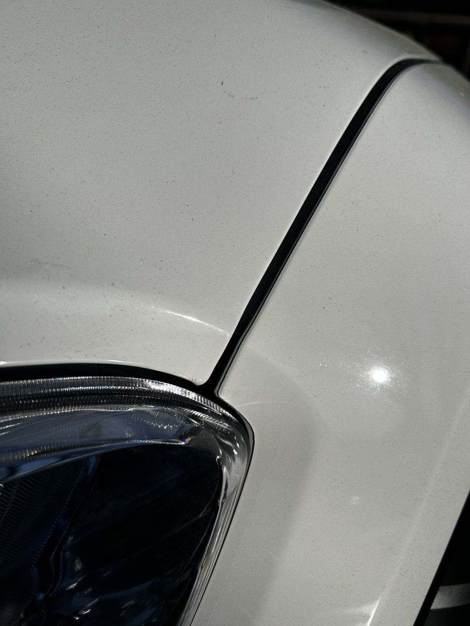

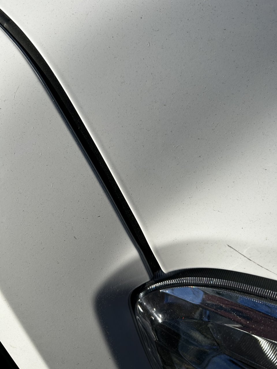

    I also noticed the headlight/fender gaps on both the left and right headlights in the pics: nearly exact duplicates: either it's after-market headlamps, fenders, inattention to detail on re-assembly, something still tweaked that wasn't replaced or: all of the above. No other likely explanation on a front-end event. When I look at it, to me it doesn't look real bad in the after-crash pics: More like a designed-in/engineered plan where the crumple-zone did it's job and the crash didn't exceed that plan.

    I just went out and looked at the gaps just for you guys .. they are all over the place lol. Mine is a 2021 never been fixed. How can you match something that was different from the beginning?

    Yep.
    2017, the same light gap on the left. Normal.

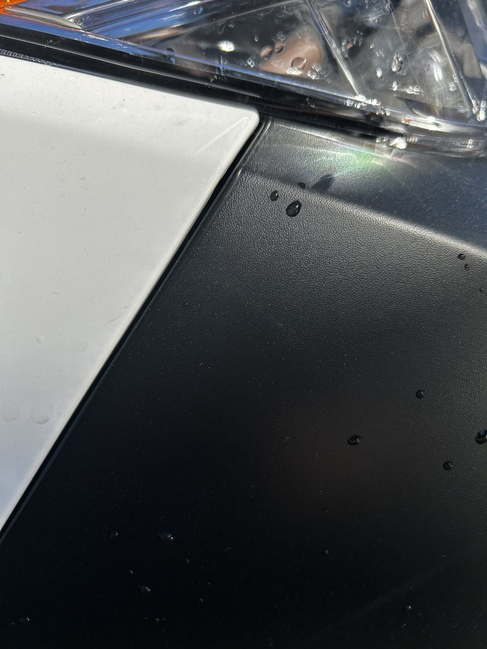

    Regarding the grille surround, they come painted from factory like that. I bought an extra one to use with the trail edition heritage grille, so I can swap back and forth with my silver colored heritage grille, and the white paint on the spare one I bought is most definitely a warmer white tone, compared to the factory white paint on my truck. The truck has a cooler blue hue to the white.
    I just try not to pay attention to the warmer hue too much, but it’s there and maybe only I notice it.

    The headlight fitment is normal. my truck, which has never been in accident, is the same way. Even with aftermarket headlights the gap is still the same

    The headlight fit is probably not going to get much better, the other stuff.....make them fix it.

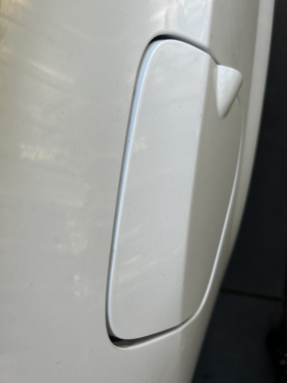

    For the Skewp, it looks like the push clip wasn't fully seated. Super easy to fix. Other than that, I'd would live with the rest.
