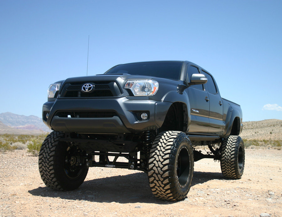

    4crawler.com get the "D1+RAD+BS". 1 inch would be max in my opinion since you have very minimal added stresses to the cab mounts and minimal amount of extending components such as steering linkages, gas filler, bumper mounts, etc. They also have aluminum spacers if you find it necessary. If not add "CLR" for black poly ethylene spacers otherwise theyll give you the white ones.
    D1= upgraded stainless grade 8 bolts and upgraded spacers to improve surface contact of chassis/spacer/body by maximizing diameter of the spacer block
    RAD= fan shroud drop mount
    BS= not really necessary but adds rigidity to your bed if you put gravel or atvs or anything heavy in your bed

    Haha way too much lift for me. Ive looked at those kits before and thats way too excessive for a DD. My 6" is just about right. Plus to get a loaded bulletproof kit youre looking at around 7000 US. Ouch.
