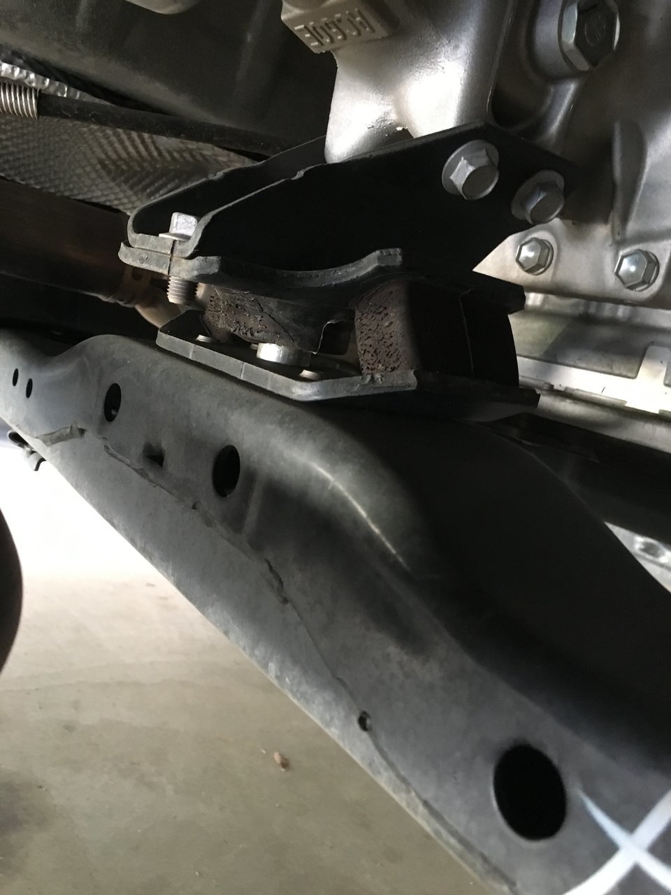

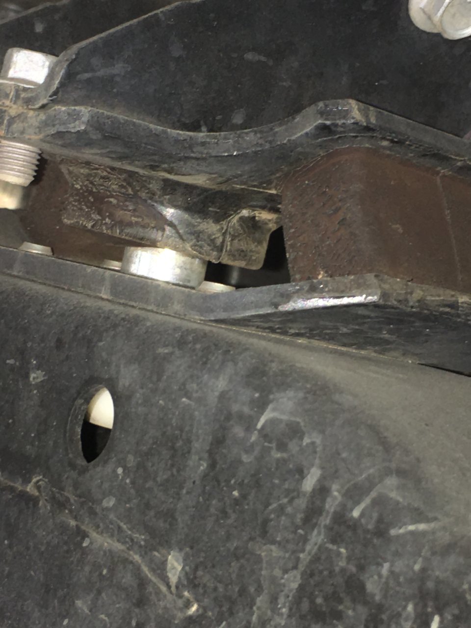

    hello! I’m new to the forum and need some of y’all opinion. I’ve had a body shake on my 16 dclb. I’ve taken it in and gotten some bs answer that it’s the road. Just curious would this cause my truck to wobble this is at the front under the drive shaft 21421961-B1F8-4D6F-A221-FB316892221D.jpg

    What is in the pics...?? Looks like a motor mount and it looks cracked.... is it..?

    transmission mount??

    That was what I was thinking..... Is that mount broken.... Sure looks like it in the pics..!

    Looks like the cross member to the transmission. OP. Look at that metal plug looking thing that hangs down and see if their is a hole where that is suppose to set down into. Might just not be aligned properly.. My guess. Ill have to look at my truck when I get under it next time.

    I'm looking at this area...looks like a crack.....
    Chewbacca might be right too...that shiny part looks like it may have popped out of it's place..!!

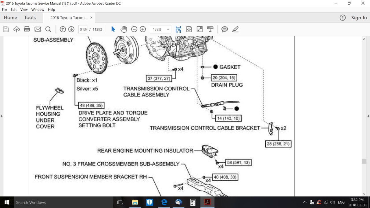

    Looks like it's this part in the pics...
    Rear Engine Mounting Insulator......

    Awesome!! Lots of great responses. I get a bad shake in the cab. Not the steering wheel and it happens on certain stretches of freeway. I’ve had my truck aligned several times. I just got a wild hair and looked under the truck. It appears the rubber is cracked and missing half of it. I’ll have to check some more. It’s been a pain trying to figure it out because the mechs aren’t sure what they’re looking for and I get it gets expensive swapping out parts. I’ve also had a clack:click noise when I hit dips. Not sure if they’re related but warranty have replaced left strut right lower control arm. So annoying but I’m going to take it when I can. Thanks again everyone

    Took a pic of mine for you...
    The rubber on yours looks like it's streched.
    Do you still have the top piece? Looks like it's supposed to limit travel.
