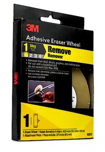

    I would just use a Rubber eraser wheel. Cheap and effective way to remove adhesive or vinyl stickers. Just don't be too aggressive in one area and burn the paint. You can buy them cheap on Amazon.

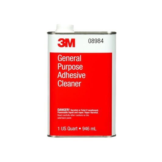

    It ain't cheap, but has worked wonders for me in a few cases.

    I have just ordered a rubber wheel off of Amazon. I'll let you all know how it worked. Thanks for the suggestions.

    Never heard of this magic, learning…gears turning

    ^^^^works incredible
    Just don’t go crazy with pressure/RPM’s of attached tool

    All those solvent's will strip paint/clear. Use the eraser wheel.

    Eraser wheel 100% worth investing in
