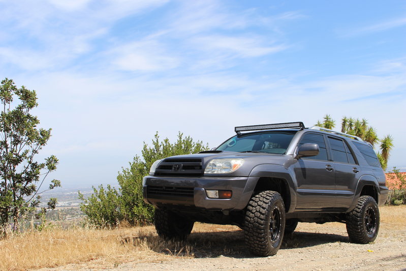

    Stock
    2005 Galactic Gray Sport Edition 4X4 V8 4Runner
    Now

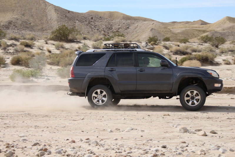

    When I bought Gunmetal it had a sport rack roof basket on up top. I took it off because I thought it looked ugly. Then when getting ready for the Tacoma World trip to Anza Borrego I wanted the extra room. To make the rack look better I painted the fairing matte black and mounted a shovel using fist grips, which I mounted to to steel plates to clamp on to the rack.
