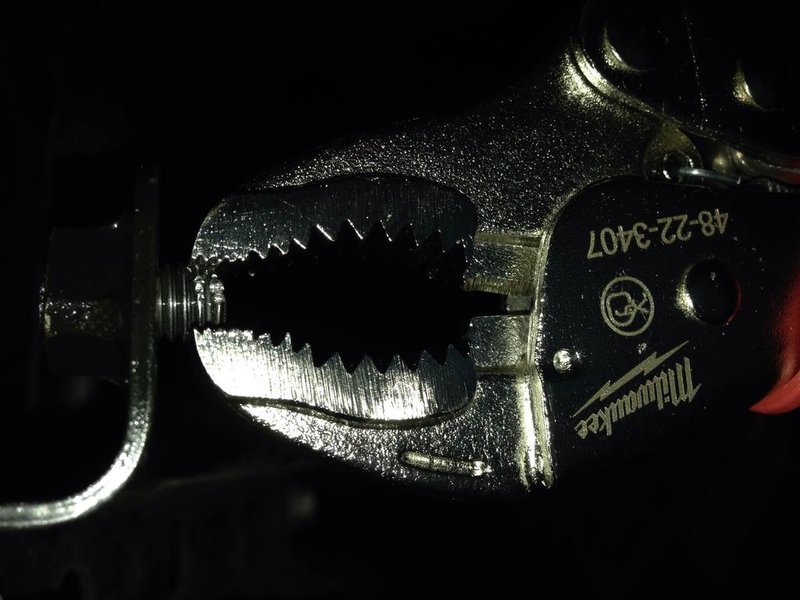

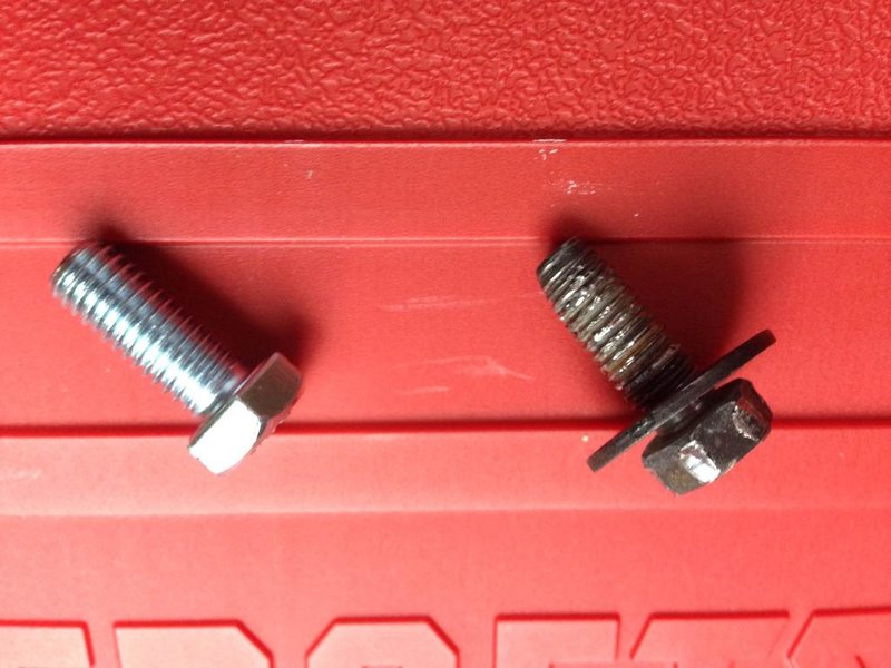

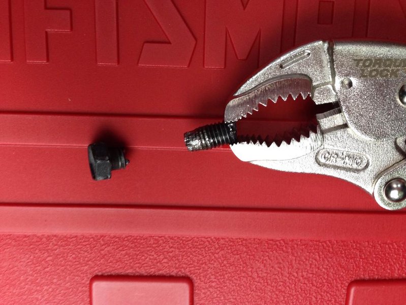

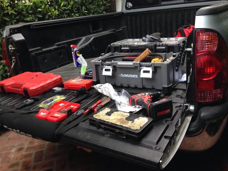

    Hey Guys,
    Sorry that I went in cognito these pass few days and left everyone in suspense!
    Here's the latest:
    Removed first bolt with torque wrench no problem with a little WD-40
    Second bolt was stubborn and wouldn't cone out. Torque wrench ate the fuck out the tip(pictures of that I will take today)
    Drilled a hole through the bolt and trued the bolt extractor which didn't do shit!
    So today I will be attempting to hammer the shit out of it hoping it will break since I have hollowed the inside.
    No access to a torch so heating it is out the question!
    Bought replacement bolts at the local hardware store.
    Attached are the pictures I took when I started the removal process.

    Get better vise grips and stronger hands :)
    I use lefthand drill bits, but since you goobered the threads on the back side standard drill bit is going to be a better bet.
    Another thing that may work is use you vise grips, and a small propane torch, heat the nut and vise grip the bolt from the back. Just be carefull to not heat the whole thing too much or it won't really help you just want the heat on the nut.

    You can get a cheap propane torch at walmart :)
    PB Blaster is much better penetrator than WD-40
    Get a set of vise grips that have less arch and smaller teeth and grip the thing sideways instead of with the tip.

    If there isn't any interference, use a longer bolt. If any bolts break again there will be more bolt exposed, to get a grip on.
