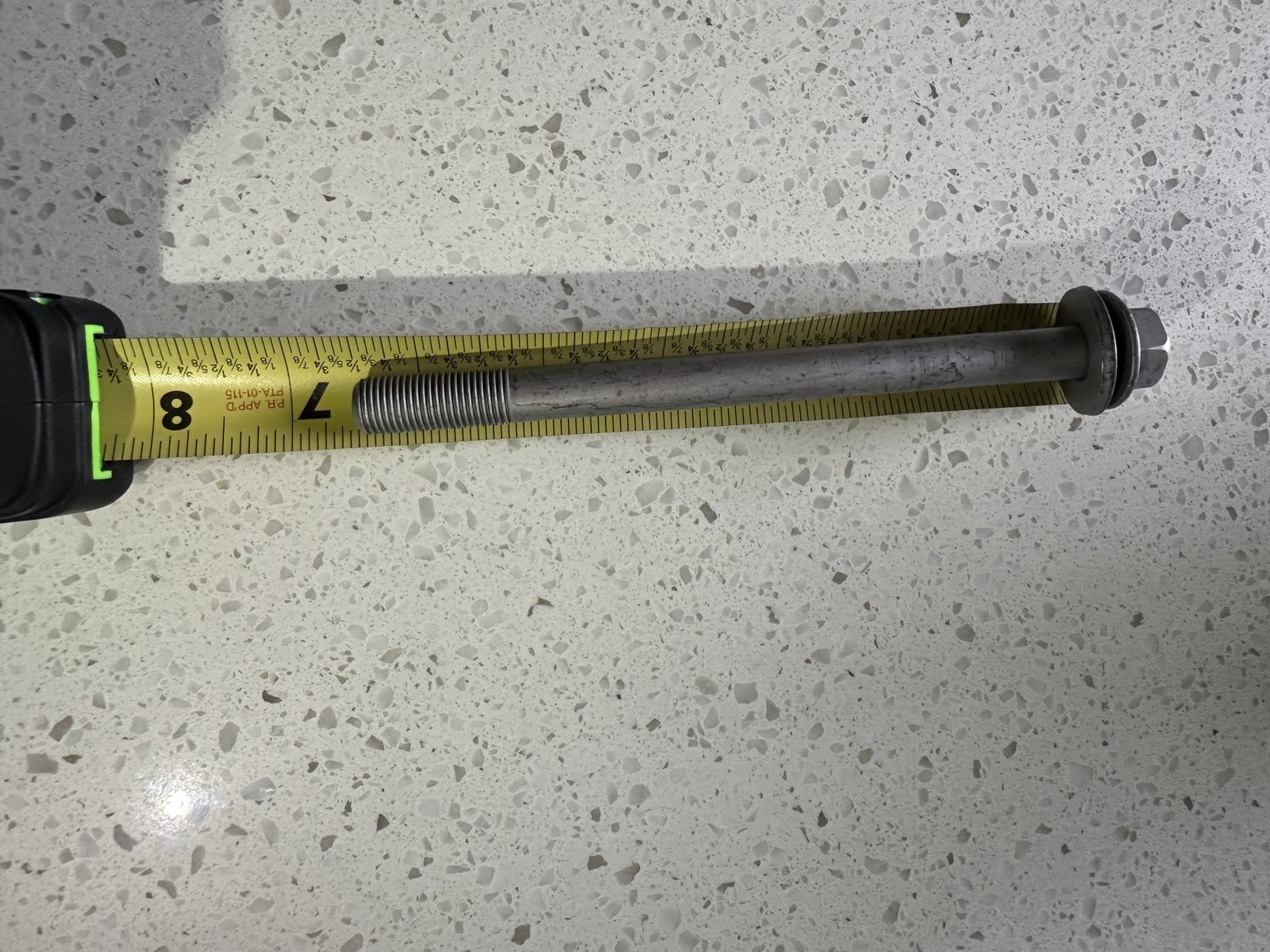

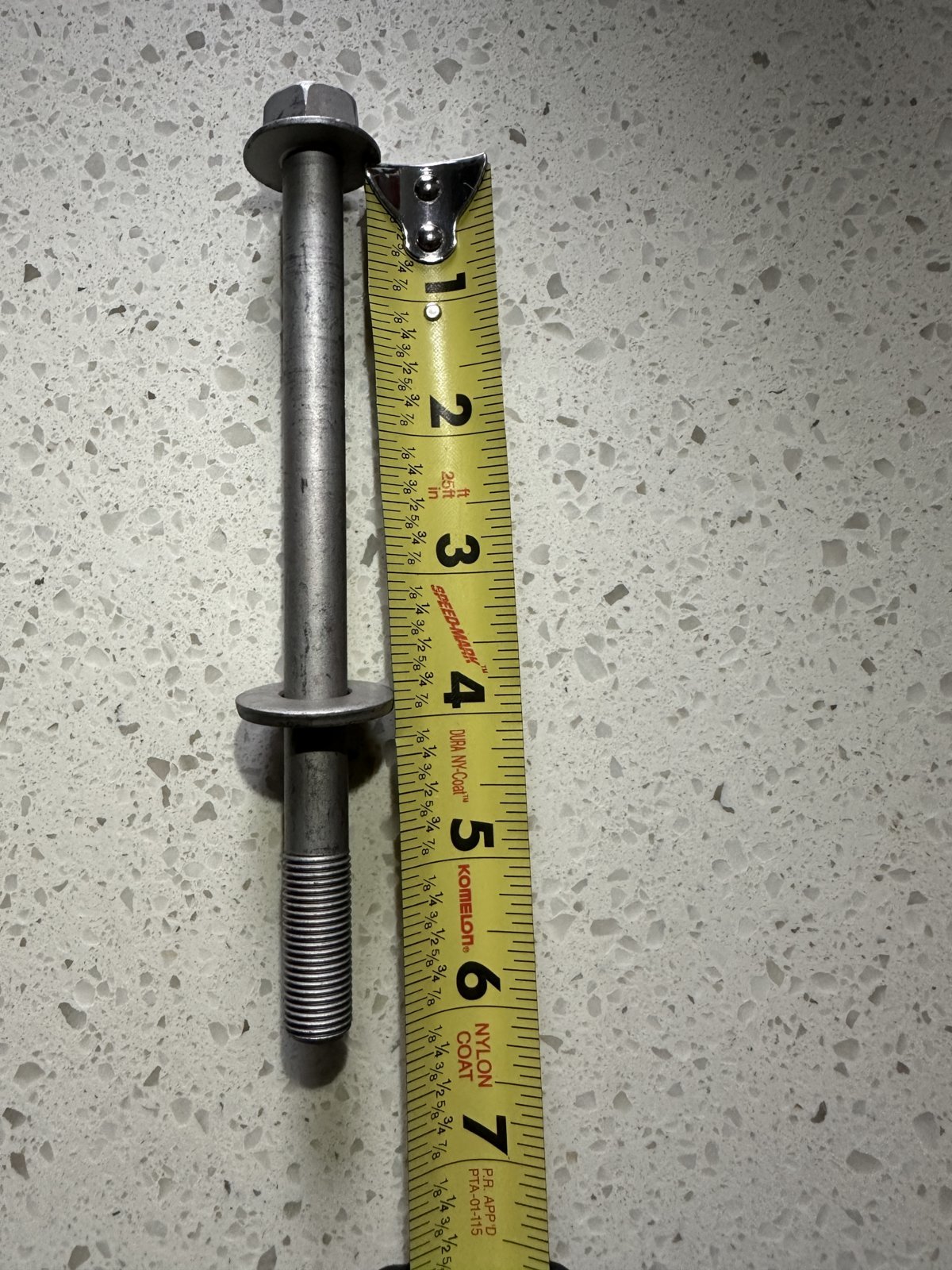

    Just a follow up from my last post.
    The other thread said;
    90119-A0135 is longer and for 4WD
    90119-A0137 is shorter and for 2WD
    Went to the dealership and they said for my truck (prerunner) it’s A0135. The gave me the following bolt which measures 6” (shaft) or 6.5” (top to bottom).
    I haven’t pulled the yet but assuming they are in fact the same, the prerunner uses the longer bolt even though it’s 2WD.
