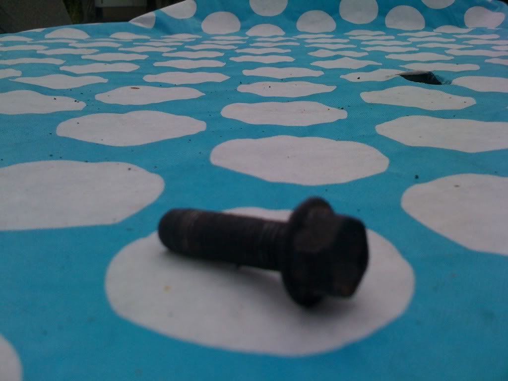

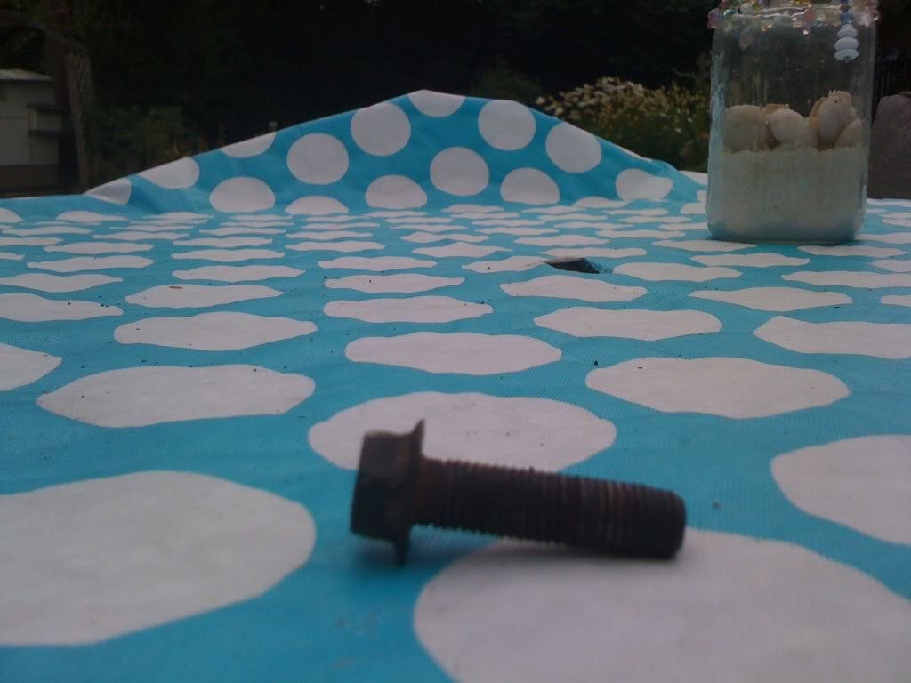

    i looked at the cat converter this morning, i believe its still there? Its that thing with the holes in it, i believe its attached to the muffler pipe before it goes into the engine. I googled a pic of the cat converter off a toyota. Good idea though. I checked all the plugs they arent backed out, in the process i broke off one of the connectors in the boot, so i had to go buy another spark plug wire and tools to get out the old spark plug ect. What a pain in the ass that was!! ha. oh well. Heres a pic of the bolt and my truck.
