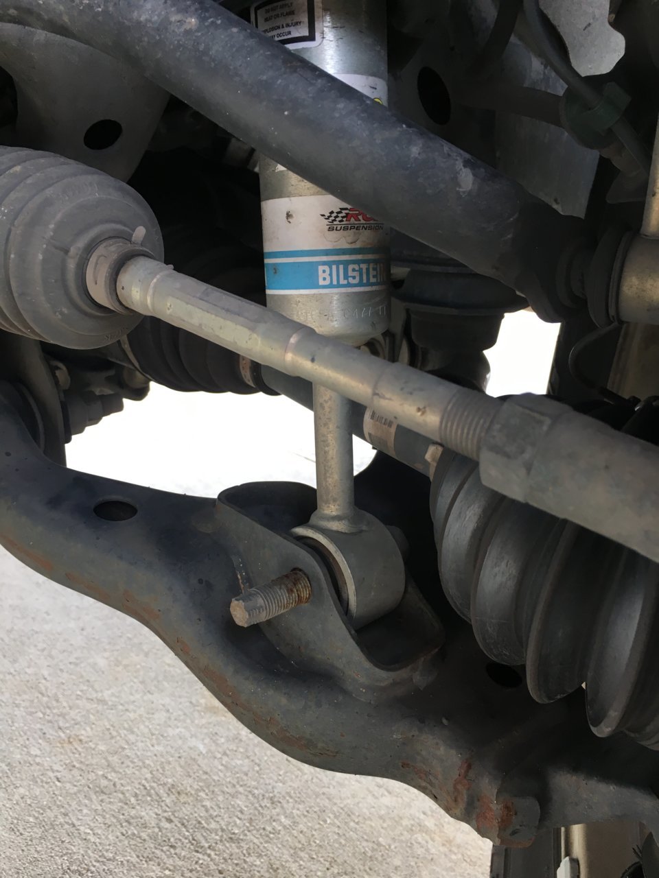

    Happened to notice the bolt was missing on the lower mount of my front left shock today. No clue how long it's been missing but does anyone know the size and torque setting for that bolt? Sorry if this info is already posted, I had no luck with a search. Its a 2011 Tacoma with bilstein 5100's. Thanks guys.

    I wanna say M10 or M12? Torque is around 61 ft lbs. honestly I’d just find any grade 8 bolt to throw in there until you find the right size

    I see a bolt in the pic. What I don't see is a nut . You got the twig you missing the berries . 61 ft lbs torque
