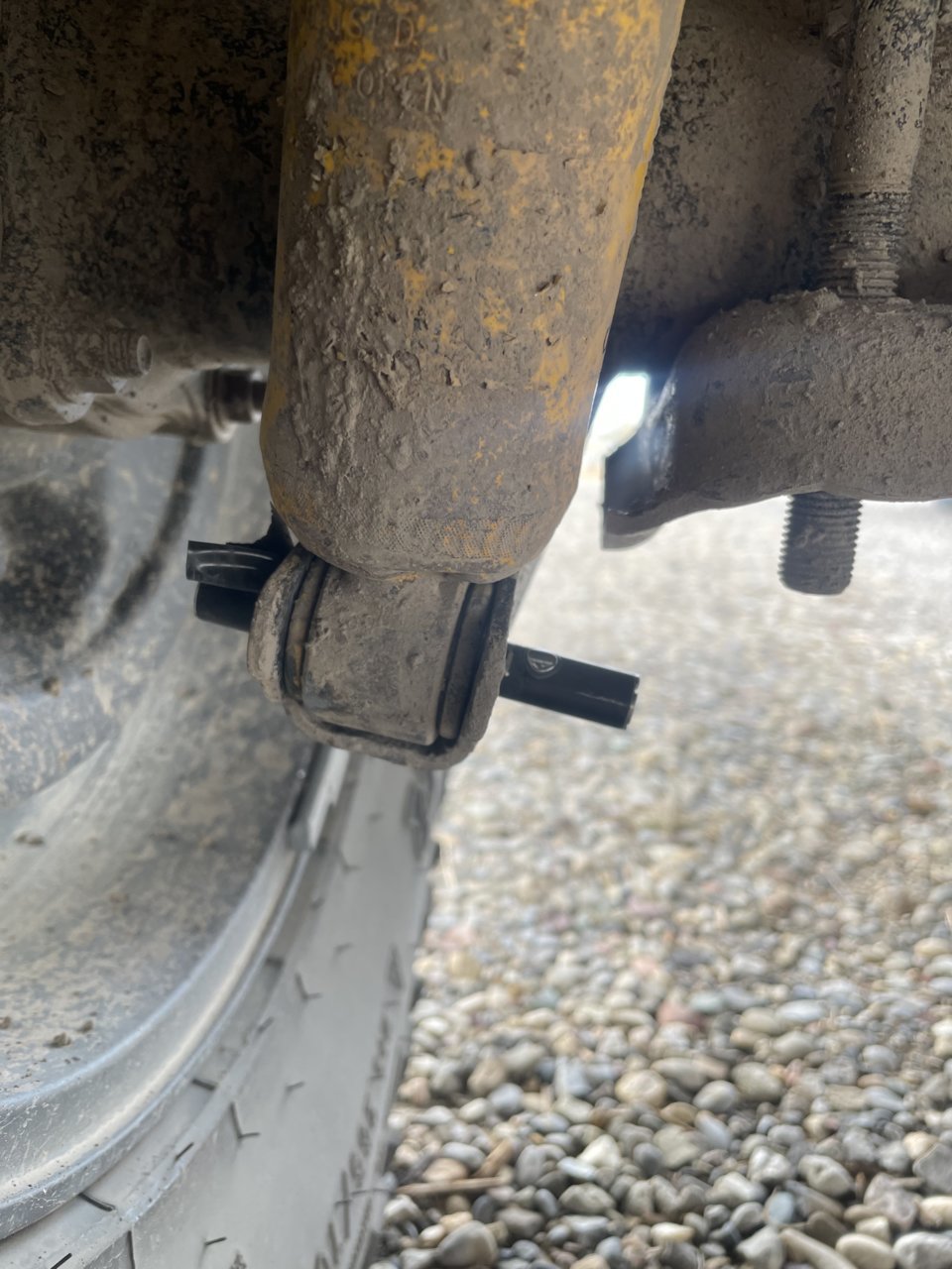

    So yesterday when reversing into my driveway i felt a clunk from my passenger rear wheel and when i proceeded to find out what it was the shock absorber was dangling down and the bolt was missing. does anyone know what type of bolt it is and where i can get a new one?

    Yes, I think 91552-11260 is right, supersedes to 90105-A0297. Washer is 94622-51200 and nut is 90178-A0057
    I think it should be M12-1.25 x 60mm long. Use a flange bolt and nut if you can.

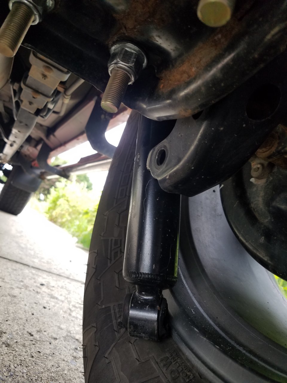

    If this happens and your in the mountains a 510 vape cartridge battery works !!!

    not worried about steel catching fire . The bushing was already damaged . Saved the mount and potentially more
