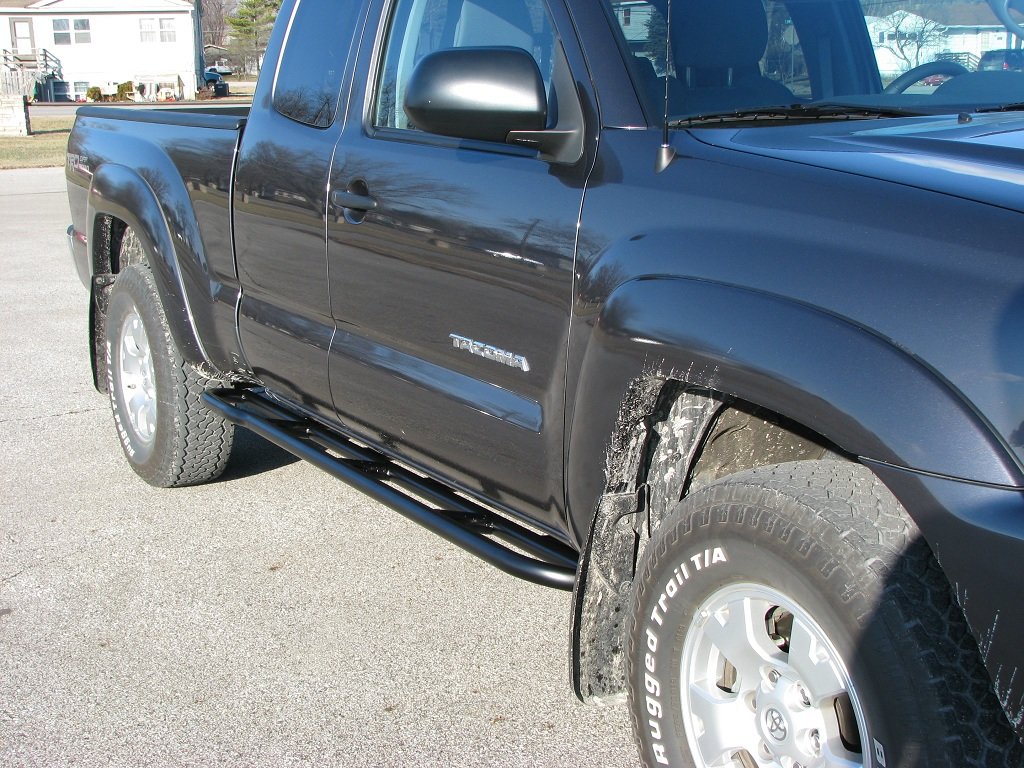

    ... Pics. I'm looking for any good bolt slidder pics. Or help in general. I just got my BAMF bolt ons for my 12 AC and when I mocked one up it seems to line up with holes but the washers that came with it aren't going to be big enough for said holes. A fender washer would work but that seems odd to me. Pics would help immensely. I searched to no avail. Thanks!

    I'v got 4Xinnovtion sliders, bolt on model. Only like 3 or 4 hole line up, the rest you have to drill, no big deal. Sharp drill bits are what you need.

    can you post some pics looking down on these from the front view. Also, one that shows how far they stick out from the side of the truck. I am looking into buying these and love the look of those.

    Got these from Adam at 4xinnovations, great product, great guy to work with. The sliders could hold up a building,... truck, no problems. Hope thos helps.

    I guess I should clarify guys. I'm looking for pics at the attachment points to see how you mounted in better detail. Thanks.

    I have a set of BAMF DCLB sliders. Bought them here used.
    FWIW, all the holes in the vertical portion of the mounts aligned well with oem frame holes.
    My sliders came with square plate washers and round typical grade 8 washers. It seems the square plate washers go against the frame and the round washers go against the slider bracket.
    My sliders also had a pair of long plate style with welded on nuts for the forward mounts.
    The BAMF DCLB sliders were originally designed for 4wd applications. My truck is a 2wd prerunner. One of the brackets, while it aligns with the frame holes, 2 holes per side have rivets in them and a bolt on the lower surface. These fasteners required me to slightly trim the lower flange of the slider. I have not yet removed the rivets and installed bolts but plan to.
    I called BAMF about this and Jerry Lee stated that the riveted crossmember for the frame is in a different location 2wd vs 4wd DCLB's.
    Regardless though, you will need to drill the slider bracket lower mount holes along the frame rails lower flange.
    If you still need photos, I'll take some in a couple days when I get home.
    These are, in my opinion pretty stealth and not noticed unless near the truck, but should prove to be very robust.
    PK
    Want to add, I corrosion proofed all the small parts by glass beading and applying OSPHO, then Rustoleum krinkle painted. The sliders themselves had been LineX'd by the original owner. When the sliders were installed, I coated the fasteners with Mastinox.

    Thanks this is what I was looking for. I found out today I didn't get the square backer plates. I have the long piece with the nuts welded on for the front mount in the boxed portion of the frame. If it's not too much trouble I would like to see some detailed pics. I do better if I can see it.
