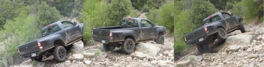

    I didnt want to weld to my frame either but wanted a some sliders strong enough to support the weight of my truck. I designed my own and FEA'd using Pro-Engineer software. Had a buddy build them and then had them powder painted. Before painting, we wanted to verify the FEA results so we bolted them to the trailer hitch of a F350 and used a fork lift to raise the entire back half of the vehicle off the ground. Pretty strong. I can lift my Tacoma by jacking right on the skid. The skid mounting plate runs along the frame and adds rigidity to the frame as well. Hope you guys like em as much as me.
