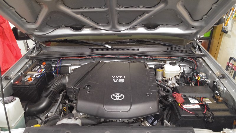

    I used it for my dual battery isolator as well. Made some spacers out of aluminum stock for it to fit because my isolator bracket wasn't wide enough. I installed loom over the wiring since this pic was taken.

    My bracket was JUST wide enough for the holes, could stand to be about 1/8" wider per side but for it to fall out would need the bracket itself to fold and at that point i would likely have been in a wreck ha.
    Do you recall where you tapped into the ignition source for the solenoid?

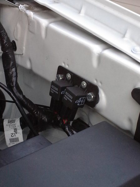

    I used it for my off road light relays but I just went to my bolt pile so I have not idea what size they were.relays.jpg

    What relay mount is this? It's exactly what I need since my relays don't have the removable tabs on the back so they won't work with the Cali raised mount.
