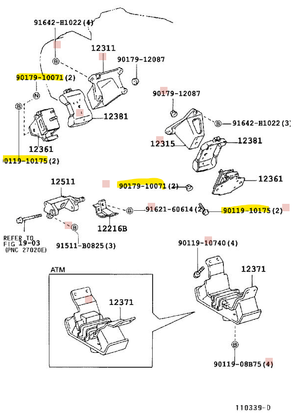

    By chance does anybody have the bolt sizes for the motor mounts on a v6? I am going to have new motor mounts and transmission mounts replaced and want to have new hardware for that, instead of reusing the old stuff. Mainly the engine block and frame perch bolts.

    Looks to be Toyota part number: 90119-10175 (bolt) & 90179-10071 (nut) for the motor mounts, and 90119-10740 (bolt - mount to transmission) and 90119-08B75 (bolt - cross member to mount)
