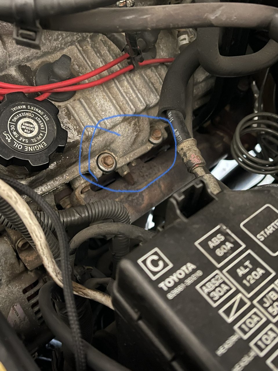

    I have 2003 double cab dlx Toyota Tacoma and as I was attempting to do spark plugs there’s a bolt missing nearby and was wonder what’s the right size bolt I know it’s a 10 mm but don’t know the ]

    Definitely not a 10mm.... 10mm hex head is different from a 10mm bolt. IIRC it should be a m6

    Easy to measure the depth of the hole
    M6 x1.0

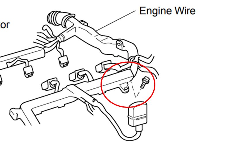

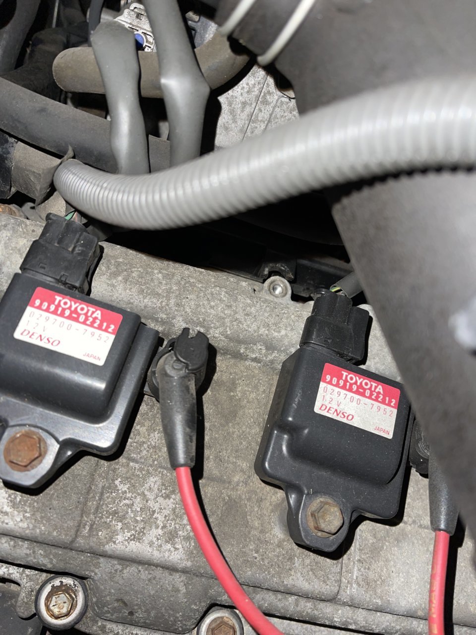

    I must be missing something, but the two pictures look like they are in different locations.
    The missing bolt in the second picture looks like a wire harness retainer bolt and there is a broken plastic protector just behind it. Is that correct? If so, not need to replace the bolt. I is just to secure the wire harness.

    Like this one:

    Don't bother with the one that's missing. It just holds the wire loom/casing that's just above it but the "ear" on yours is already broken and can't be held down. Mine completely deteriorated a while ago and I just wrapped it with common 3/4 accordion wire loom.
