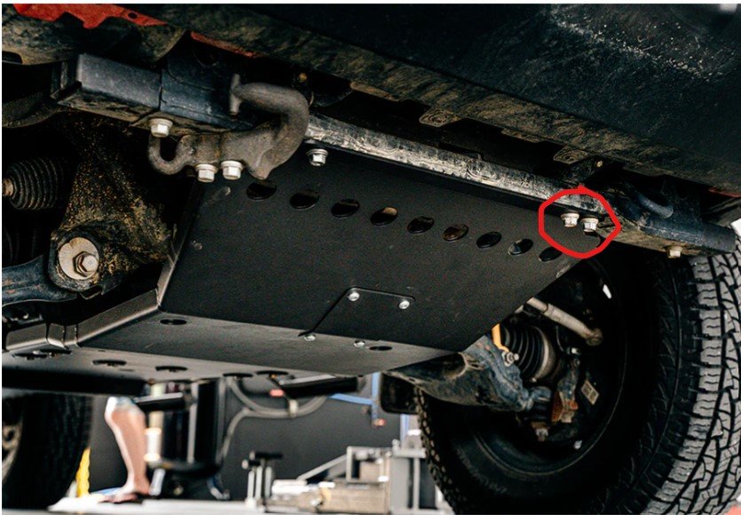

    I know the head is a 17, but does anyone know the exact size/thread on the bolts that hold the stock skid supports on. Circled in the picture below.

    M12x1.25

    M12-1.25x25-40mm length would do the trick
