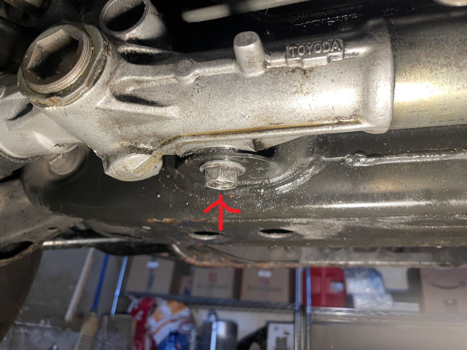

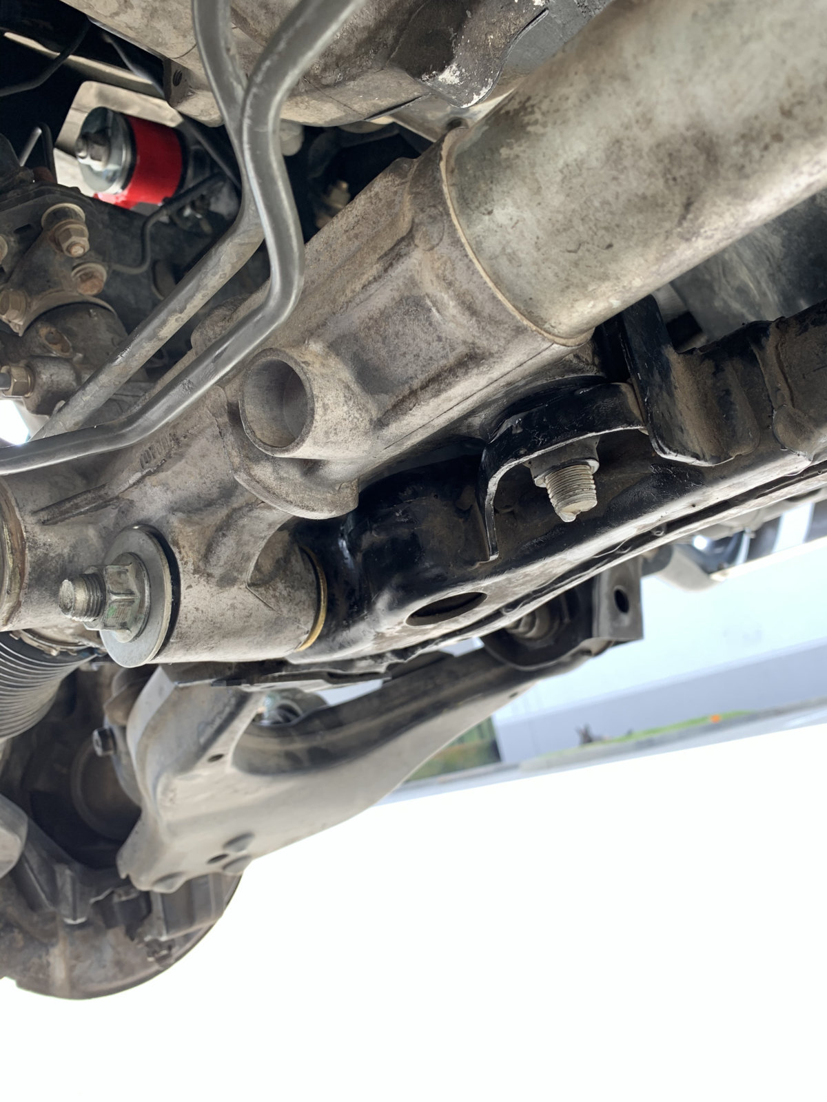

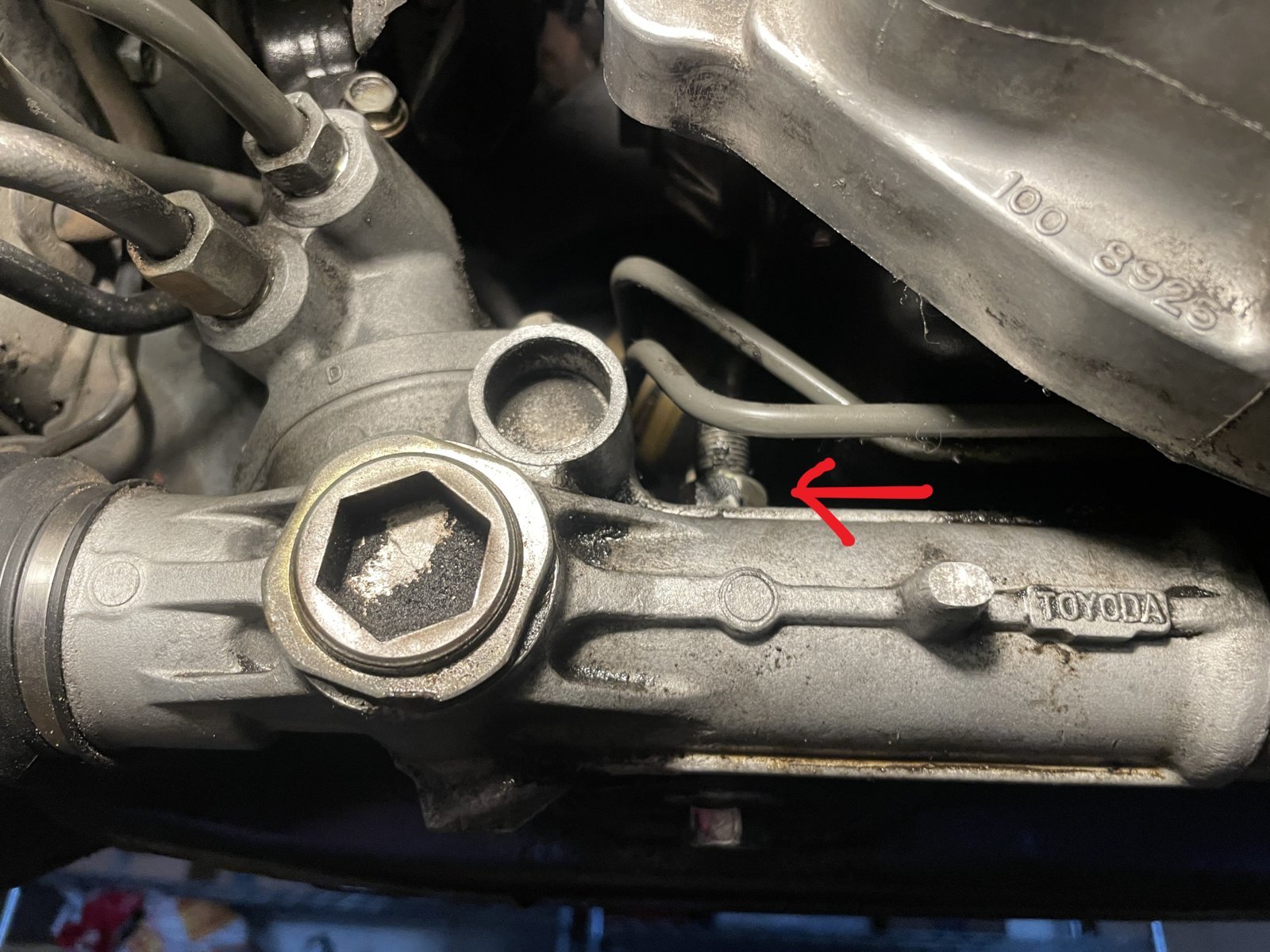

    This 19mm bolt is stuck on. I tried Blaster fluid twice, and a DCF891B impact 3 hours later with 800 ftlb breakaway on high setting and full battery. It's probably never been removed. Loosening other bolts with my impact was no problem, including the same 19mm nut and bolt on the other side of the steering rack that was probably on for 27 years too.
    The nut is on top. Pics attached. It ought to be easier to loosen the nut than the bolt, but stuff is in the way, no room for socket wrench. My next idea is buy a 19mm line wrench and a huge pipe extension. I don't have a torch, and I'm leery of the heat damaging the PS fluid lines
    I also just sprayed it with an acetone / PS fluid mix which I heard might work better, and packed it up for the night.
    What do you think?

    Have you tired a 19mm six point socket and a long breaker bar?
    Impacts are nice, but they don't always work.
    Especially if there is a bushing absorbing the impacts.

    Might need a breaker bar with a pipe as a handle extension. I've found that will be way more powerful than any electric or air impact wrench.

    Are you soaking it with penetrating fluid from the top? I’d shock it with a hammer from the bottom as well while soaking it if you don’t need your truck on the road soon and do that for awhile. I don’t think some heat would hit the rack especially if you have an inductive bolt tool.
    x3 on the 6 point and breaker bar - I thought I read you had used one but reread and saw it didn’t mention one.

    You have a little micro torch.....that and watch the pb blaster boiling out...
    soak and repeat.....
    since the heat.....I've never rounded anything off......and there have been some ONES.......
    Also you might try to break it forward, and then back it out...

    Get a box end wrench or socket on the top nut and loosen up there first. Is it welded on?

    It’s a nutsert in the steering rack crossmember.

    The lower nut is welded and you need to remove it from the top.

    He's right you know. The bolt goes from top to bottom and you are trying to loosen a welded nut instead of loosening the bolt.

    Seems to me it was installed the wrong way prior. Unless it is designed to go from either direction, mine dropped in from the top down....
    No one else caught that huh?
    *edit maybe his design is different. Seems to be different somewhat with the bracket.

    Looking at your picture compared to his I looked at his profile which says he has a 5lug. I know the 5lugs use a different steering rack, so it is possible that it mounts differently. The crossmember definitely looks different, but my manual doesn't show the rack for a 5lug so I'm not sure if the bolt still goes through top to bottom or if the 5lug actually mounts differently and does go bottom to top.
