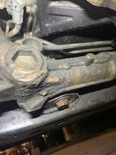

    Be patient, let it soak. I've used Gun Cleaner spray and WD40 makes a Breakaway spray that I've had luck with. Soak it from above at all angles

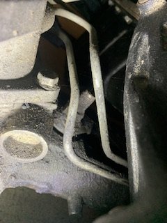

    I second this one, I was staying out because it looked unfamiliar to me. Also the PS lines appear to be pointing to the back of the vehicle, mine point to the front and are a lot more difficult to access. This looks like a different design.

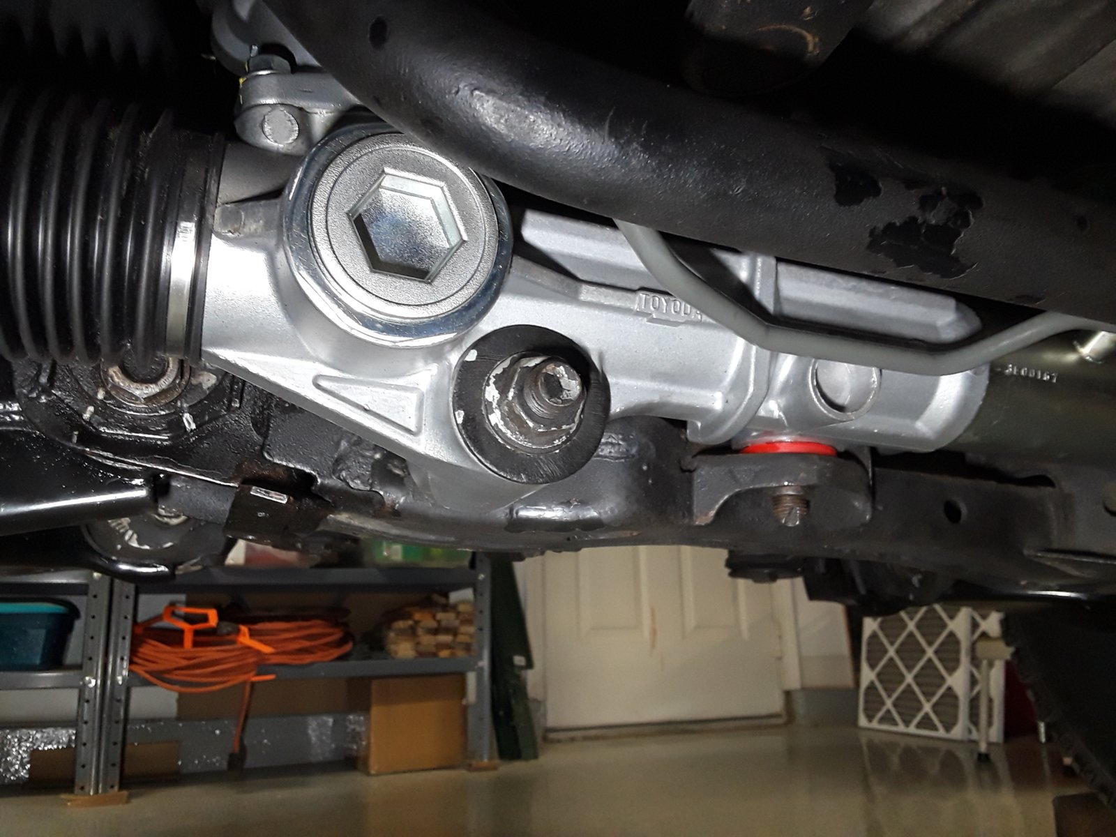

    There should be enough room to get in the top with both a breaker bar and a torque wrench, I did. Pic below.
    If you haven't already, I'd get a mirror and flashlight in there to see if the top nut is welded or otherwise pressed in. If it's not, I'd work on the nut, an impact wrench should have done it. If the nut is not welded/presssed in, you stand a chance of breaking the bolt.

    Yeah on a 5 lug the the ps pump lines go in the back of the valve control...
    and there is just two mounts.....the vertical bolt points up....and then the c-clamp mount...

    Yes, it's a 5 lug, different design that everyone else as far as all the suspension and steering rack.
    I already have the bushings. The major brands don't make them, and I had to order some no name ones online. They look right, or at least the D bushing does, and I posted pics of this particular bushing on here before, but nobody has this truck so nobody could confirm that it's right.
    I tried a breaker bar on the bolt today after letting it soak in the acetone/PS fluid mix for a couple days. I braced my feet against the wall and was bending the bar pretty good. I feel like any more and I'm going to break the bolt or bar or socket.
    I don't see a way to get a breaker bar on the top nut. Maybe with a U joint adapter on the socket. But people are suggesting here the nut could be welded on. I don't want to try a breaker bar on the nut, if I can even get a tiny bit of wiggle room, at the risk of breaking something including the power steering lines.
    Is it even possible for the bolt to be welded on instead, or make any sense?
    The reason for this is I have a vibration that I feel like is in the PS rack. I feel it in the steering wheel mostly, and over every rough patch in the road. So I want the bushings replaced. I've been trying to solve a vibration for four months. Mechanics are refusing to admit there's a vibration for some reason, or refuse to admit it could be a bushing, telling me my tires might be out of balance or some bullshit like that that I've already checked, or spraying a couple bushings with some useless grease and giving it back to me, like they don't want to work on it, whether I tell them exactly what to replace or leave it up to them. The strut rod bushings that are fallen apart are also staring them in the face and they say everything is fine. I don't get it. The truck is otherwise in great shape. So my next plan is to start trying to take it to every mechanic in a wider radius until someone is willing to do it.
    The strut rod bushings though from my understanding show themselves when you brake and it lurches forward or clunks, and I'm not getting that behavior at all. I'm getting the vibration at steady speed. That's what led me to try to do the steering rack bushings.
