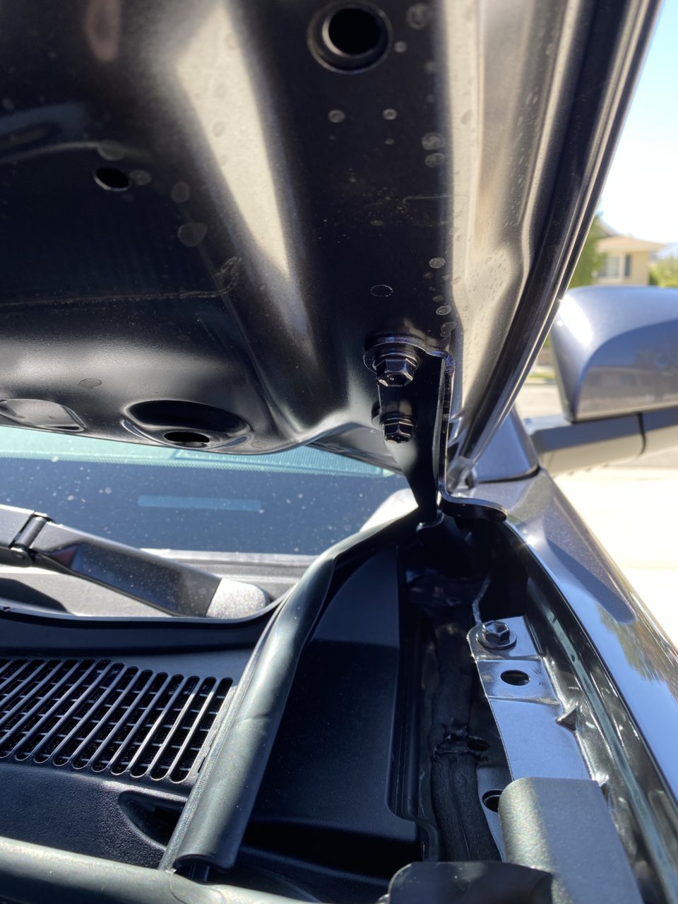

    What are the bolt torque specs that mount the hood to the hinge pictured? Specific truck is a 2021 TRD OFF Road tacoma 4x4

    Good rule of thumb....
    6mm thread dia = 72inlbs
    8mm thread dia = 17ftlbs
    10mm thread dia = 30ftlbs
    They might not be Toyota's spec but their tight enough to hold and you won't damage any threads.
    Disclaimer- if the threads are damaged or the bolt threads into Aluminum all bets are off.
