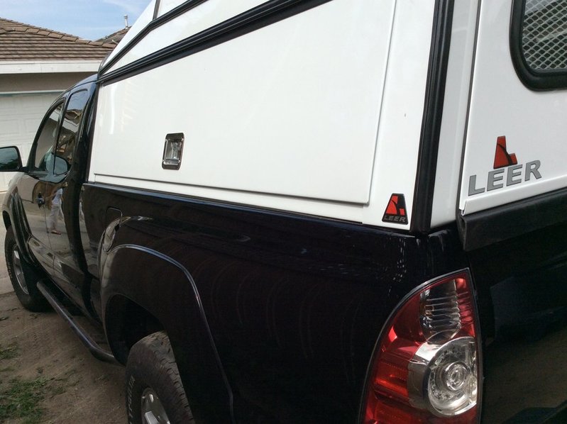

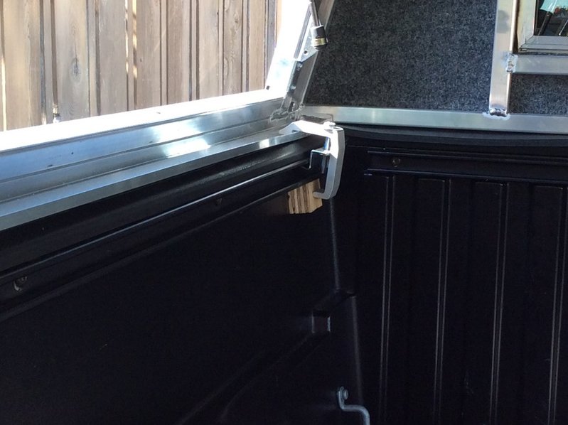

    So the canopy arrived and, as I anticipated, I am not happy with the clamping system.

    That is pretty hokey, the bolts on mine go through holes in the canopy sides and have t-nuts in the bed rails.

    The tail gate is currently a full inch below the hatch cover.
    I am thinking this canopy is better down on the metal bed sides. With it dropped down the back will be more secure and the sides might have a chance of being weather tight.
    At the moment the meal ril is bent down at the clamping points a fair bit. I think I need to take the thing off, straighten out the metal on the canopy, then remove the plastic bed caps and bolt it down.

    Fixed it!
    Off with the plastic bed caps. Now the canopy is about an inch lower. A much cleaner installation.
