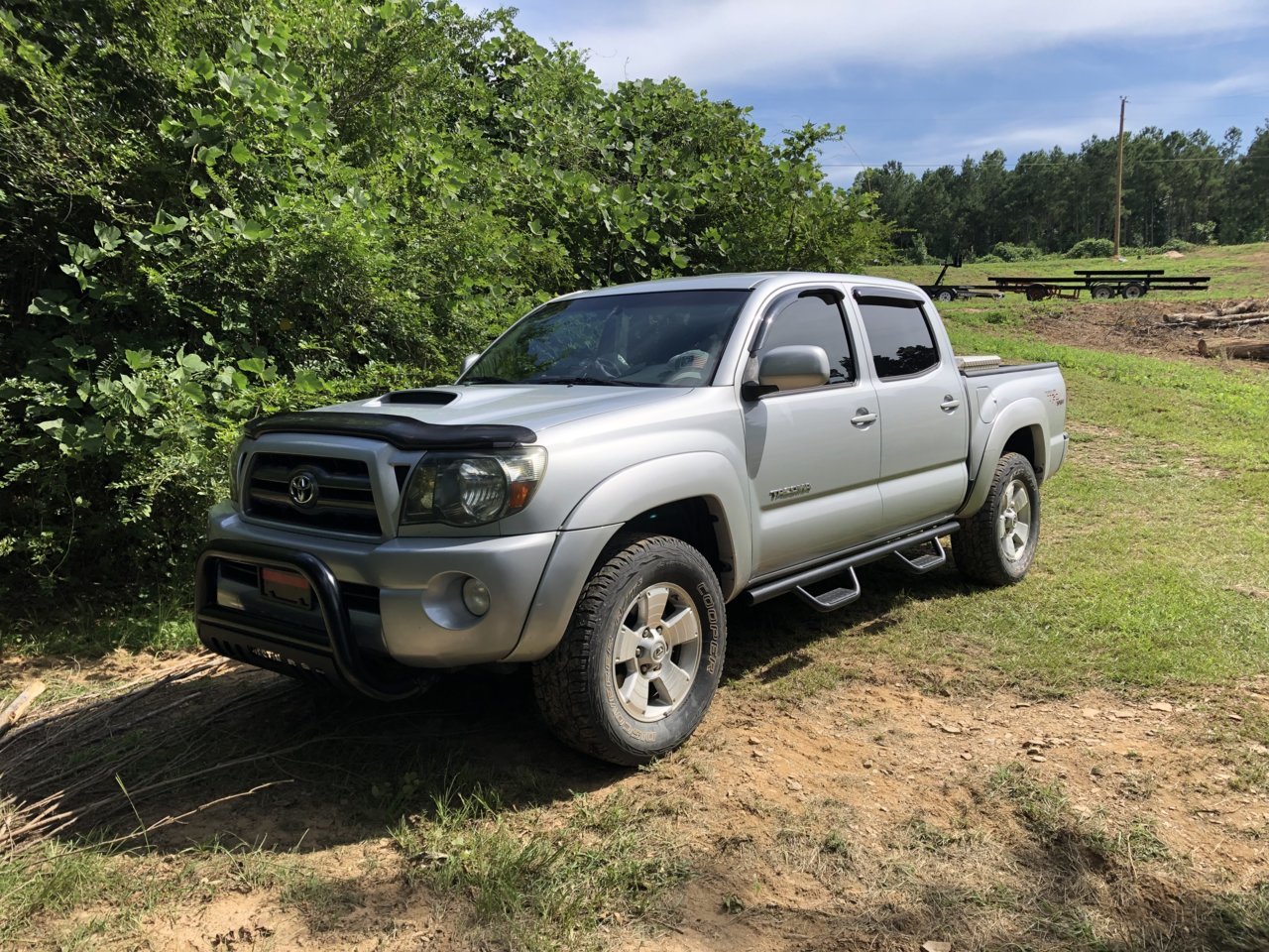

    8E2602AC-E394-4DC6-BFDD-16700C23719A.jpg I’m a volunteer Firefighter/EMT and I’m looking to install emergency lighting in my 2009 Tacoma Double Cab. What is the structural support like in the headliner near the front visor area and around the rear window? Would it be safe for me to bolt into these? I’m looking to install a visor light bar (in the visor area obviously) and a 4-head light bar on the interior flush with the rear glass. Have considered suction cups but want to maintain functionality of the rear sliding glass and would not like my lights to become a projectile in the event of a crash.
    Picture of my truck for attention.

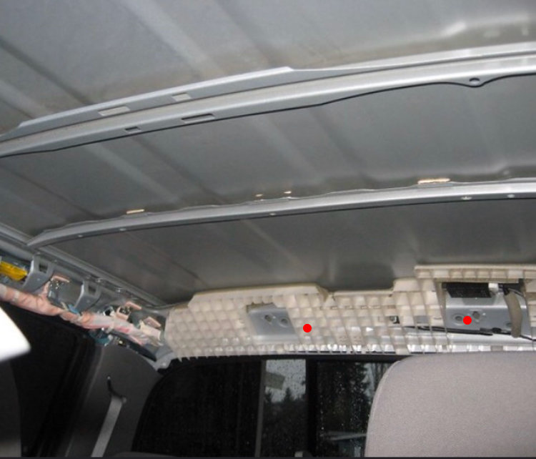

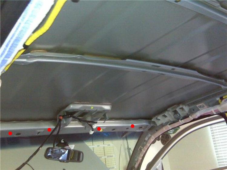

    33FAFB86-CFC3-4430-8E4E-FFD6C0A47A4E.jpg 8A9AA3D5-7499-4322-AAA1-4C178570C352.jpg So would the red dots be safe to put screws into?
  6. Feb 6, 2020 at 8:52 AM
    81shark
    81shark Well-Known Member
    Nov 7, 2008
    #10567
    4,079
    i'm no expert, but don't see why it wouldn't work. i'd just be careful to make sure you aren't screwing into any of the wires that run in the area

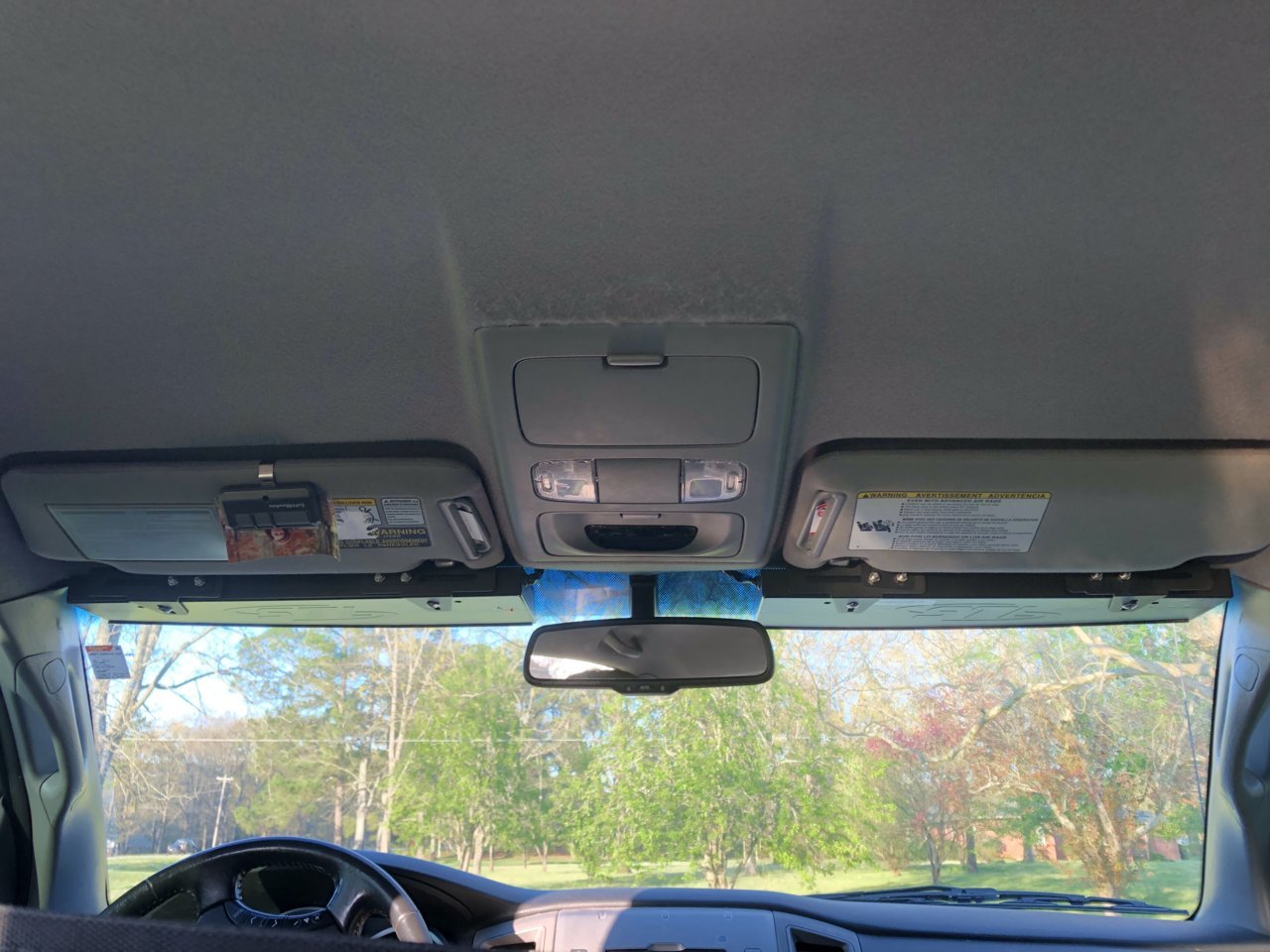

    Here’s my ILB mounted and wired. Been so busy with work and life I haven’t had the time to install everything else. So far my set up is a Speed Tech Lights Raptor ILB in red, 2x STL Z-4s TIR in red in the grille, 2 Whelen LIN3s in red on my rear tag and 2x Whelen Dominator 2s in red in my back glass.8E1ED088-51D0-4271-BE6B-42907369CBFA.jpg
