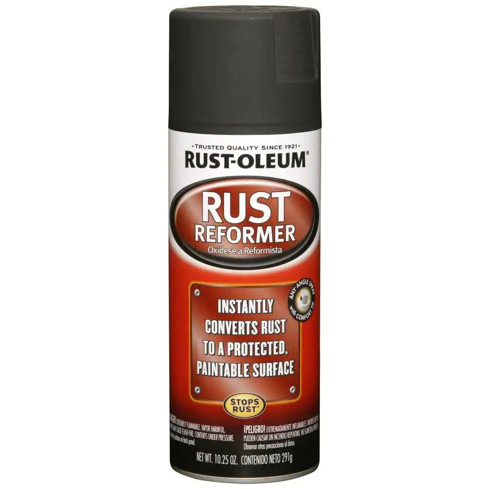

    If this help, I've always had success using Rust-oleum Rust Reformer. Take off some of the rust with a small brass or wire brush, use a paper towel (or 2) -- push it through the rusty bolt and spray away without causing over spray. If it comes back, re-spray.
