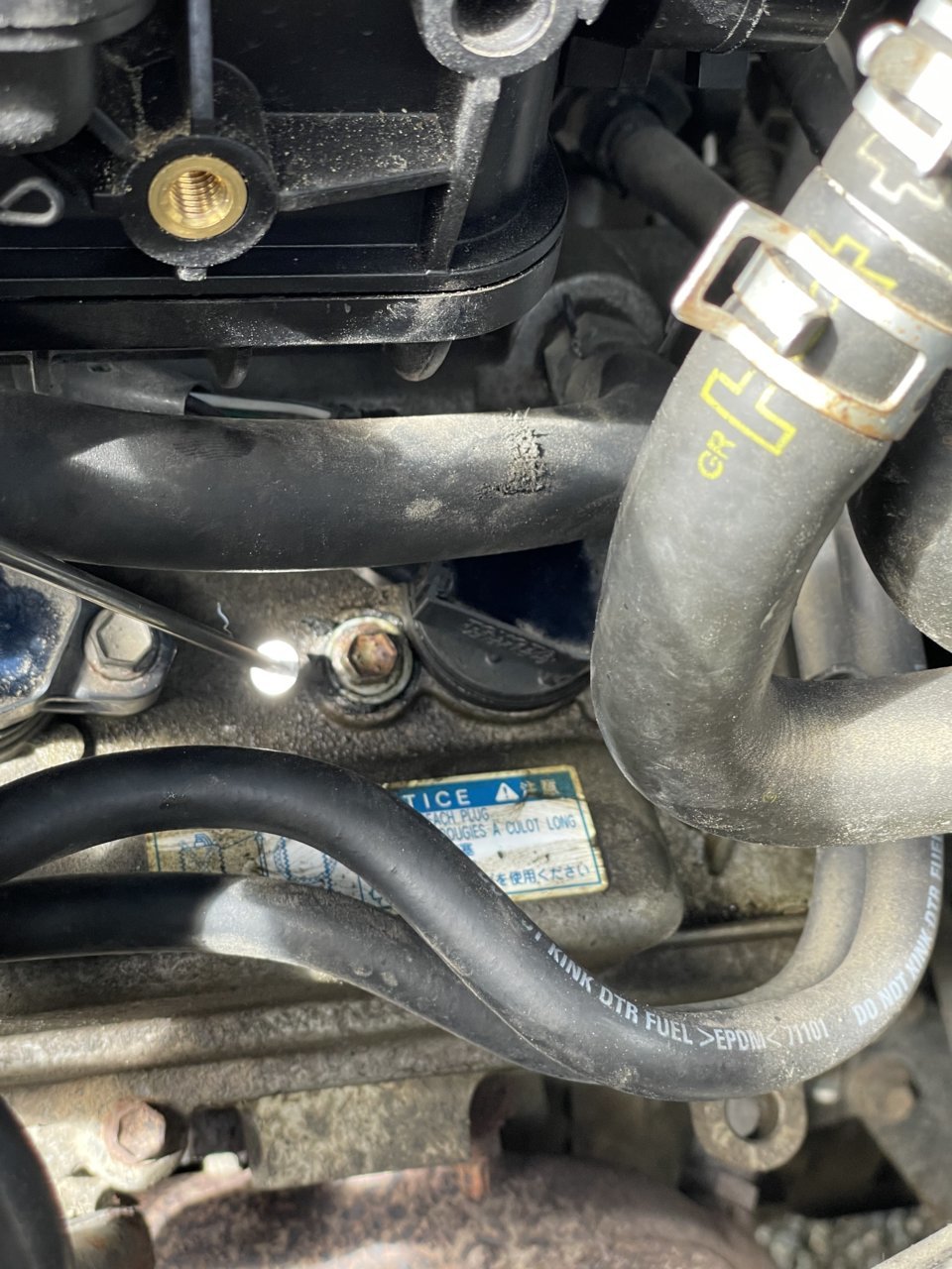

    Any one know what the bolts next to the coils are, leaking oil

    Have you pulled the spark plug? Seems like the next investigative step.

    Those bolts hold down the valve cover I think. The spark plug tube seal could be leaking and the plume has spread to the bolt head.
    How old is the PCV valve?

    Just finished doing the plugs no oil on the in side of the coil. Haven’t change the pvc valve, had the truck for two years put 15000 km on it.
    That bolt has a rubber gasket on it that looks pretty bad!

    Those are in fact the valve cover bolts, and their sealing grommets. They can be had alone if the valve cover gaskets are good (or you're lazy) otherwise they come with the VC gasket set (as do tube seals, which BTW if your spark plug tubes were leaking all the way onto the VC, you'd have a serious problem)

    Should a just replace the grommet, or do I have a bigger problem?

    Replace the grommet and replace the PCV valve. The PCV valve, if it's the 15 year-old factory original, could be the root cause of the problem.

    You're looking at a valve cover gasket job.
    You need a valve cover gasket set with grommets and tube seals

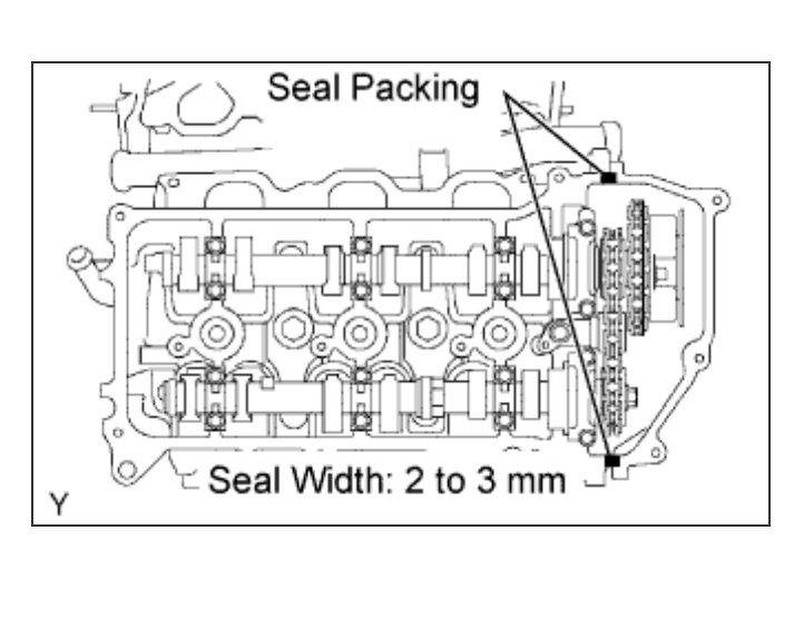

    And some RTV.
    Apply it where the Timing Cover, Head, and Valve Cover meet.
    I know you know this @b_r_o . Just putting it out there for OP.IMG_0224.jpgIMG_0225.jpg

    Replacing the pcv valve and the grommet solved the problem, thanks for the help guys!
