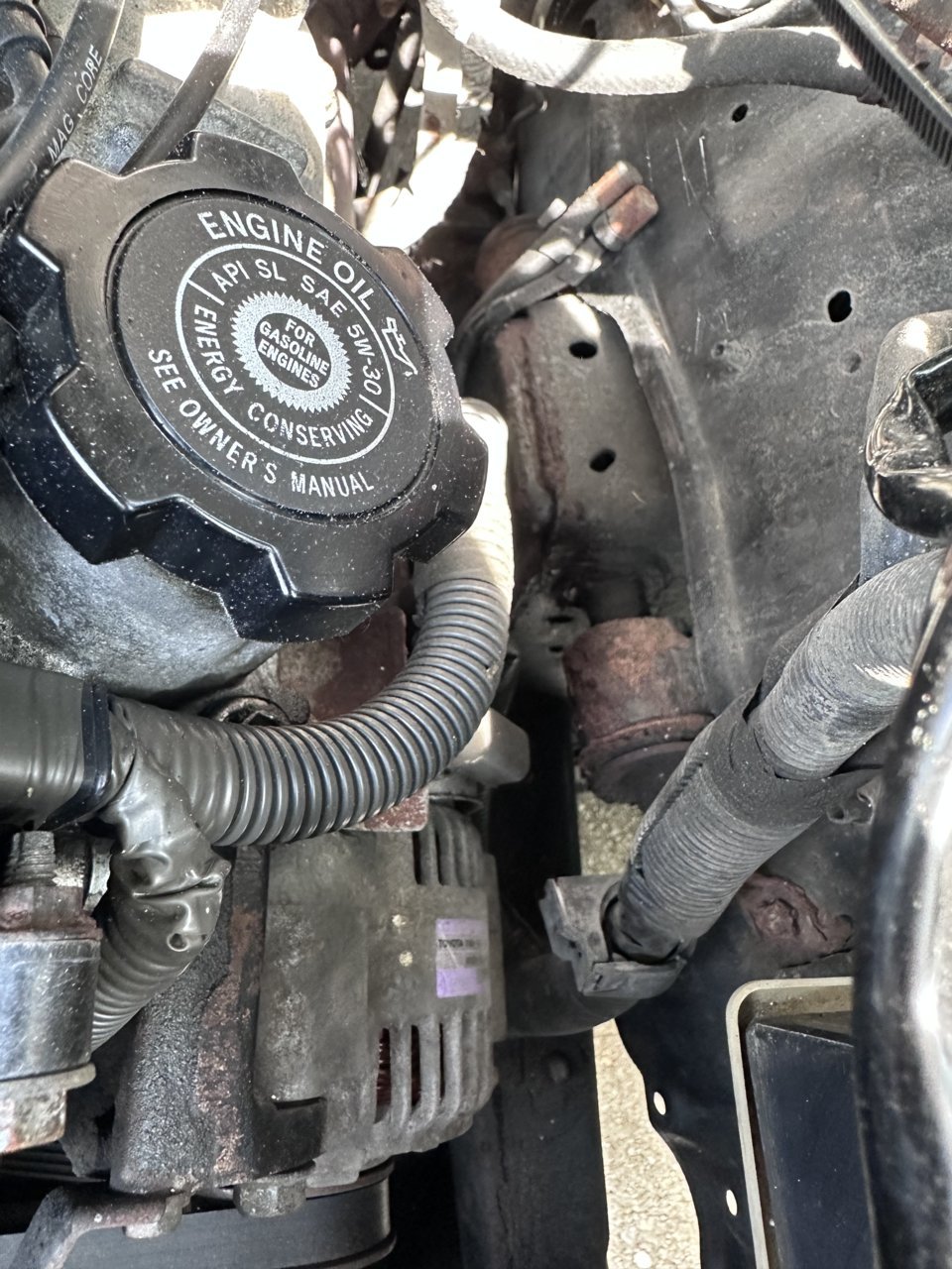

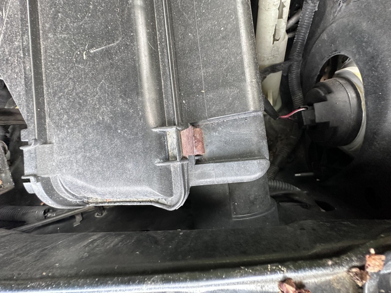

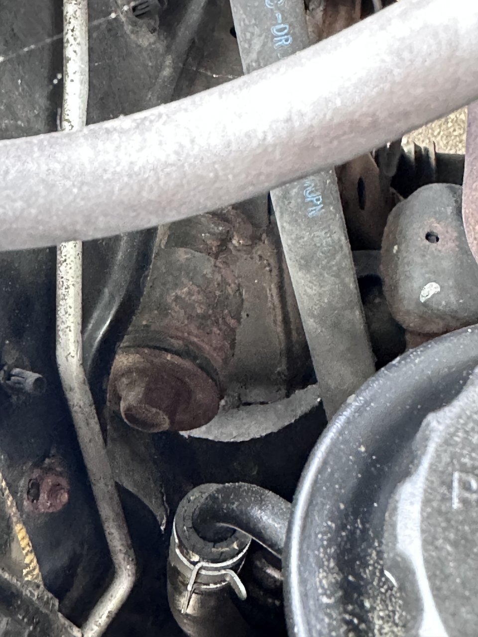

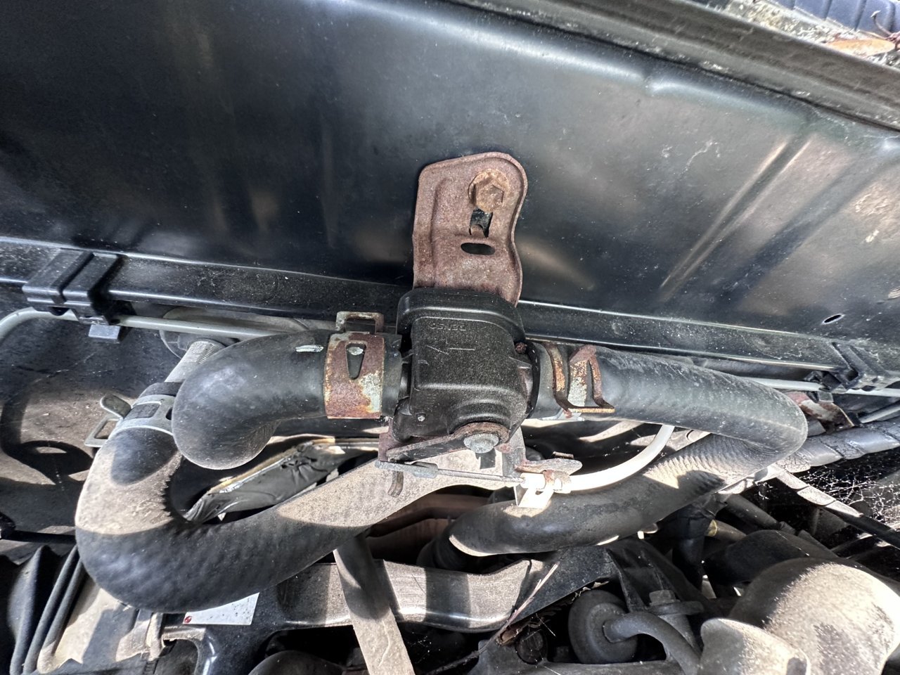

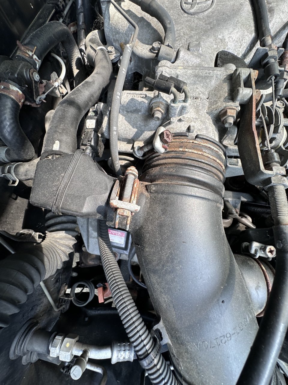

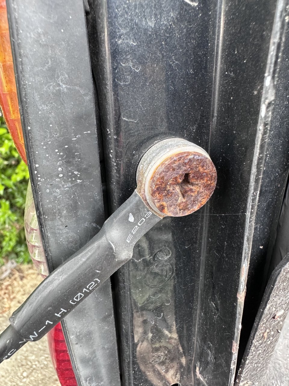

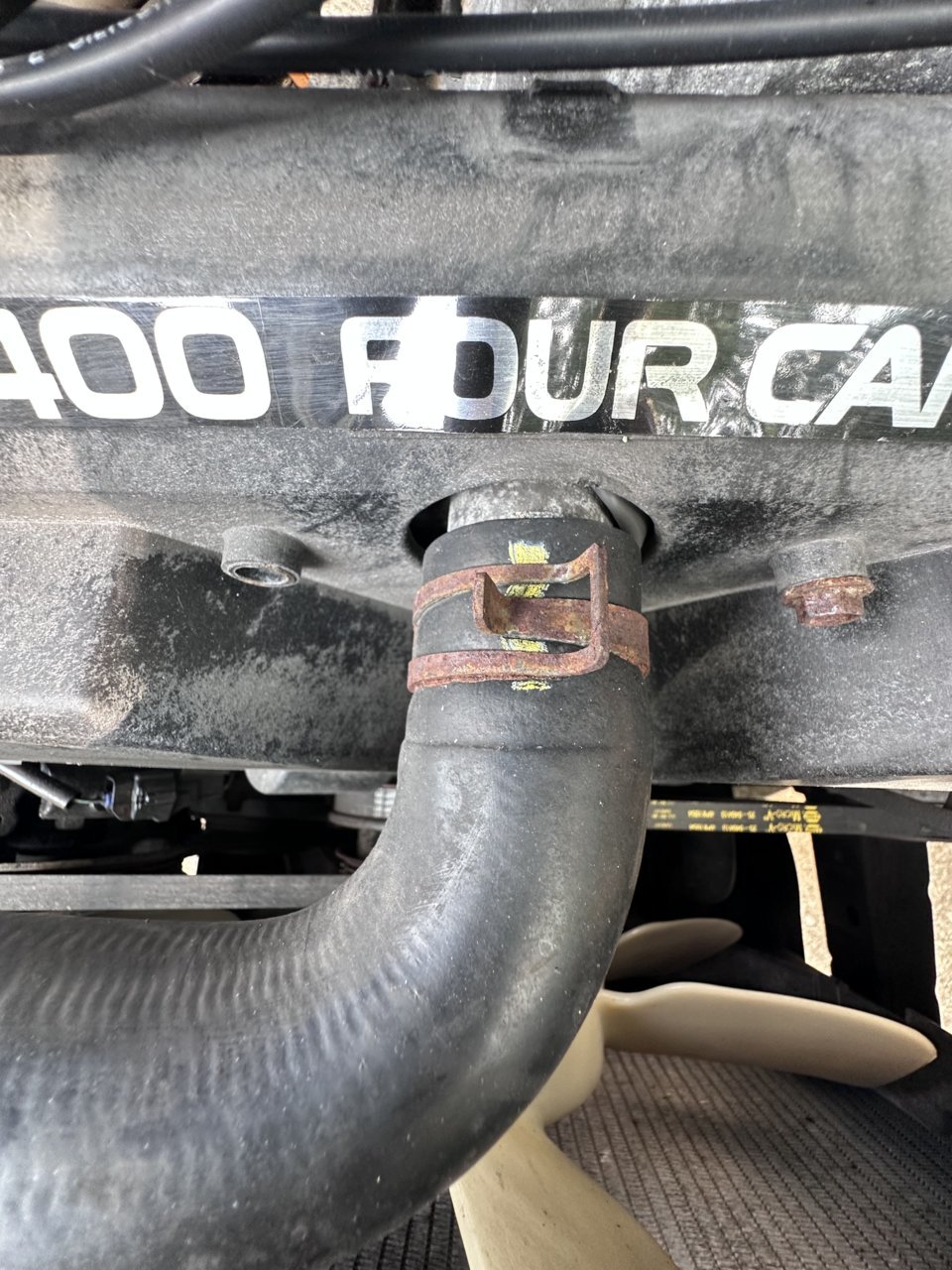

    I’m trying to find the bolts and clamps to replace the all the rusted bolts and clamps and the rest where can I find the Oem or close to that exact parts for my yoda thx

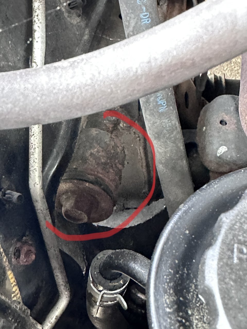

    Does anyone know what parts is that red circled

    That looks like your upper control arm bolt.

    Yup, what Madjik_Man said. There's also an upper control arm bushing in there that the bolt goes through.
    For the clamps I'd search Amazon for constant tension clamps. Best to get a kit with various sizes to keep on hand

    Replacing everything is going to add up quick! McGeorge Toyota for OEM or Rock Auto.
    Alternatively, for simple clamps and bolts, remove them and leave them in a bowl of white vinegar overnight, works great. Paint or treat with WD-40 after unless they are frame parts and you're planning an underbody treatment like Fluid Film or WoolWax.
    The CA bolt is a bit bigger project but if it's only the rust you're after there you can try de-rusting it without removal. Use one of the many of the de-rusting products available or make a "poultice" of white vinegar, leave it on the part overnight and keep it damp with vinegar. Be sure to make up a paste of baking soda after and leave it on the part for a while to neutralize the acid in the vinegar.

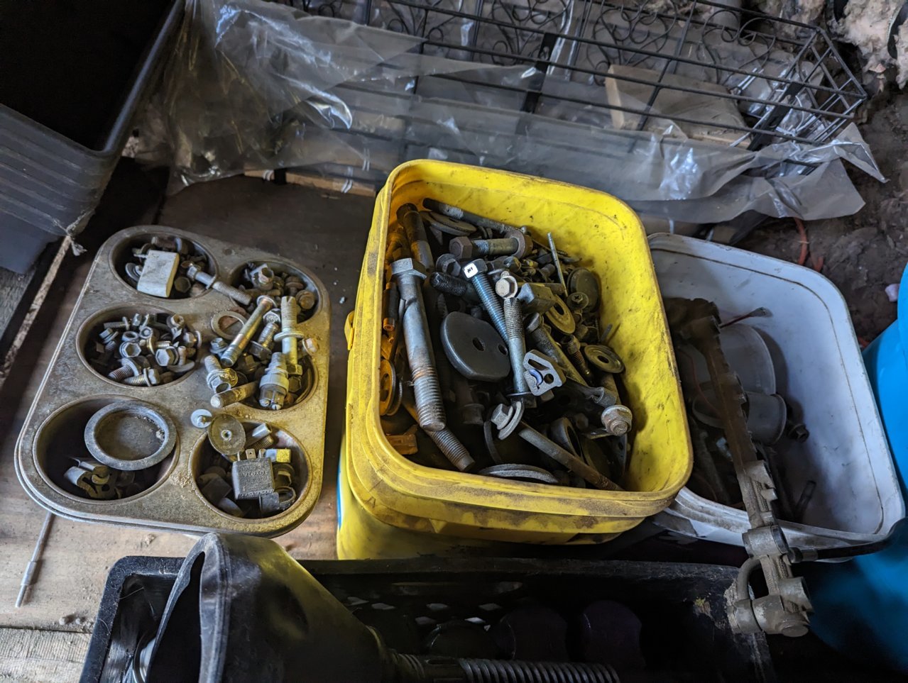

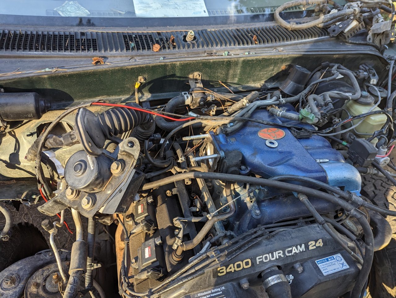

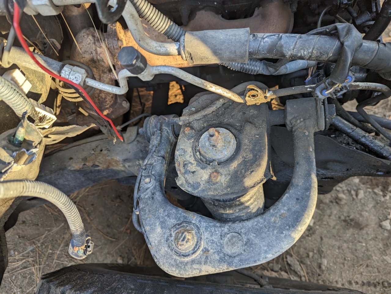

    PXL_20230616_023454547.jpg PXL_20230616_023440919.jpg PXL_20230616_023602207.jpg I have a lot of what you need.
    PM me if you are interested.
