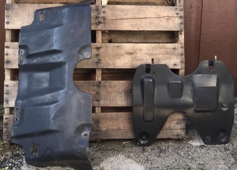

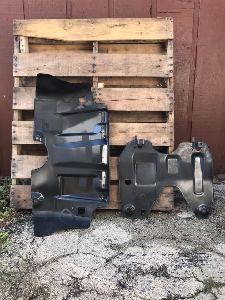

    • 8/26/19
    $20

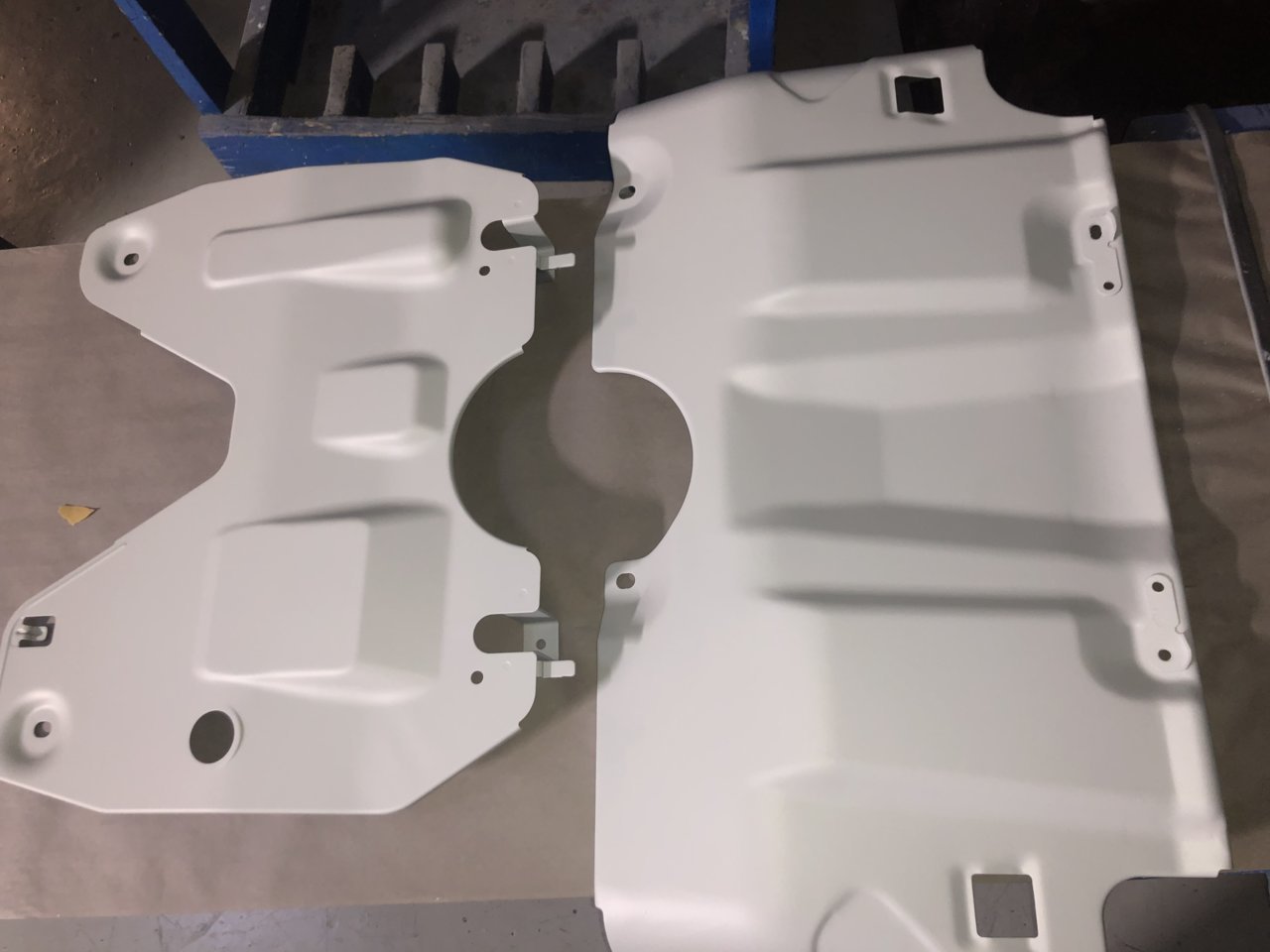

    Used Trd Off Road skid plate from a 2016
    A few more shots of the skids as is!953CB83F-DFEB-4044-BE02-642468423EBC.jpg
    Then the magic starts!
    Degreased, pram machined edges, scotch brite, alcohol wiped, primed edges and baked. Dropped off to my paint guy at work! Can’t wait!
    Came with hardware. Has a little rust but should clean up in magic aviation fluid!
    $20 is a steal and after the paint should look sweet!
    Guess I need to go find my 10mm socket to take the Air dam off and my 12mm to remove the current TRD SPORT skid.

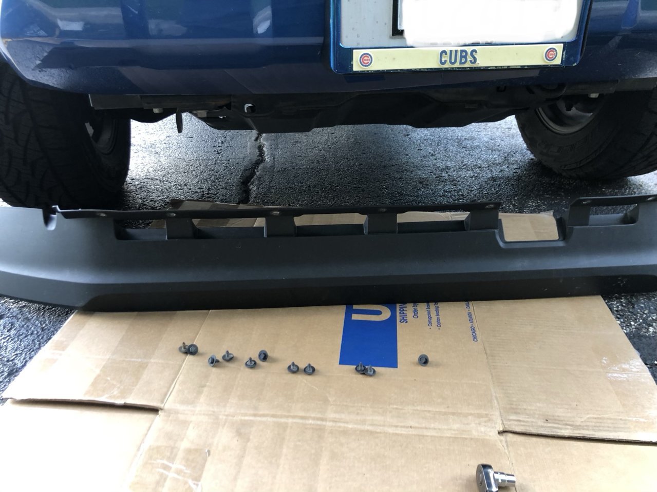

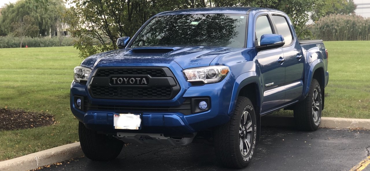

    8/29/2019
    • 2016 TRD OFF ROAD skid plate(2 piece) install on my 2017 TRD Sport
    Cost:
    $20 Facebook marketplace
    Tools:
    *10 mm to remove airdam
    *12 mm skid plate removal/install
    *Mr Torch (when you break a bolt)
    *Locking pliers (when you break bolt)
    Time:
    *1hour total.
    *Cleaning and paint prep of skid
    30 minutes
    (not including paint time/oven baking)
    *Removal/ install
    30 minutes
    (Mine includes broke bolt removal)
    And a recap how we got here
    Bought a 2016 TRD off-road skid plate set (2 piece ) $20 on fb marketplace
    As is:
    Quick clean, degrease , pram edges, scotch brite to rough up, and alcohol wipe for all residue removal.
    Off to the paint booth with 5 shots of paint. Into the oven for baking overnight.
    Next day:

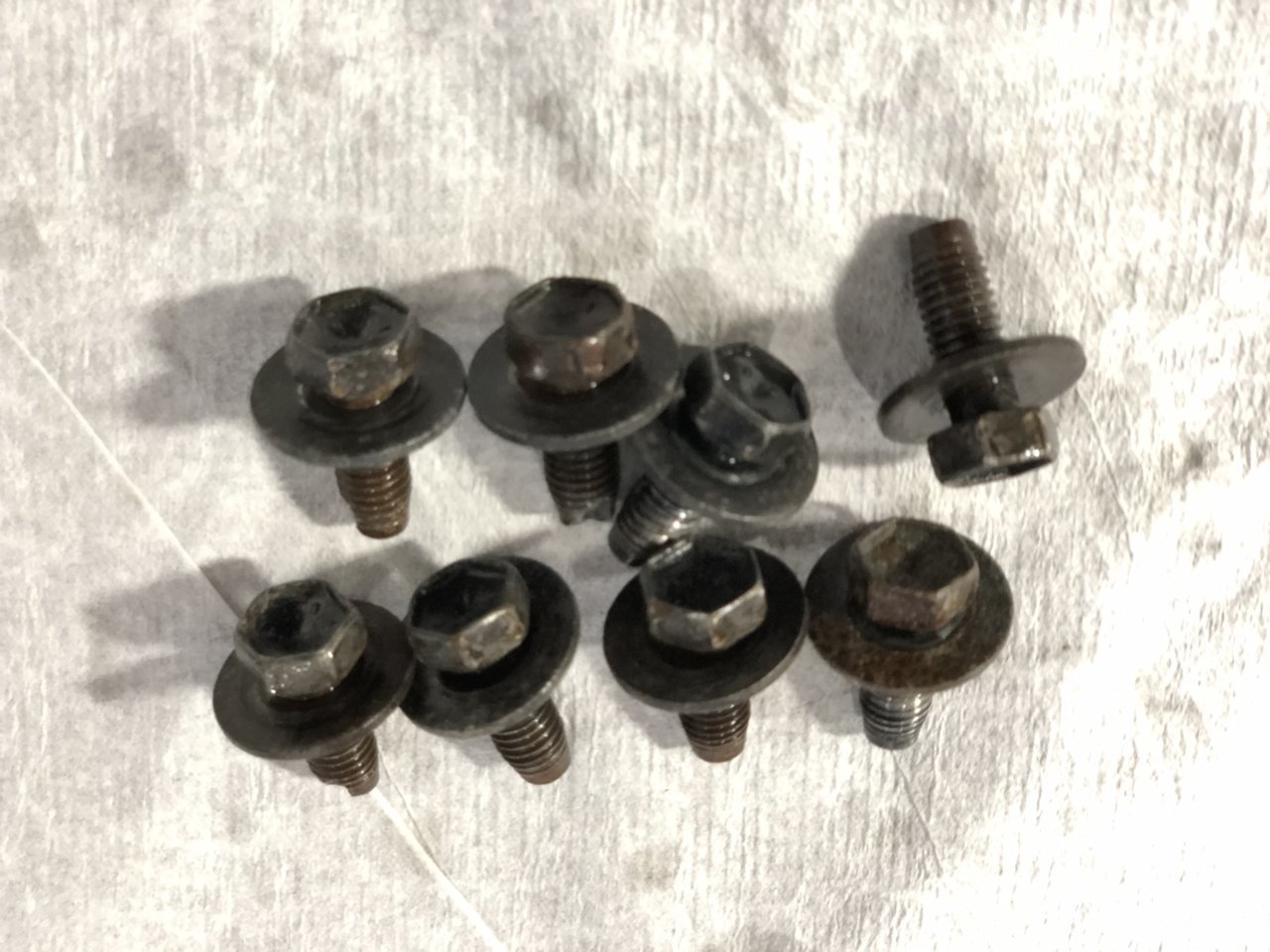

    Fast forward to Thursday 8/29/2019

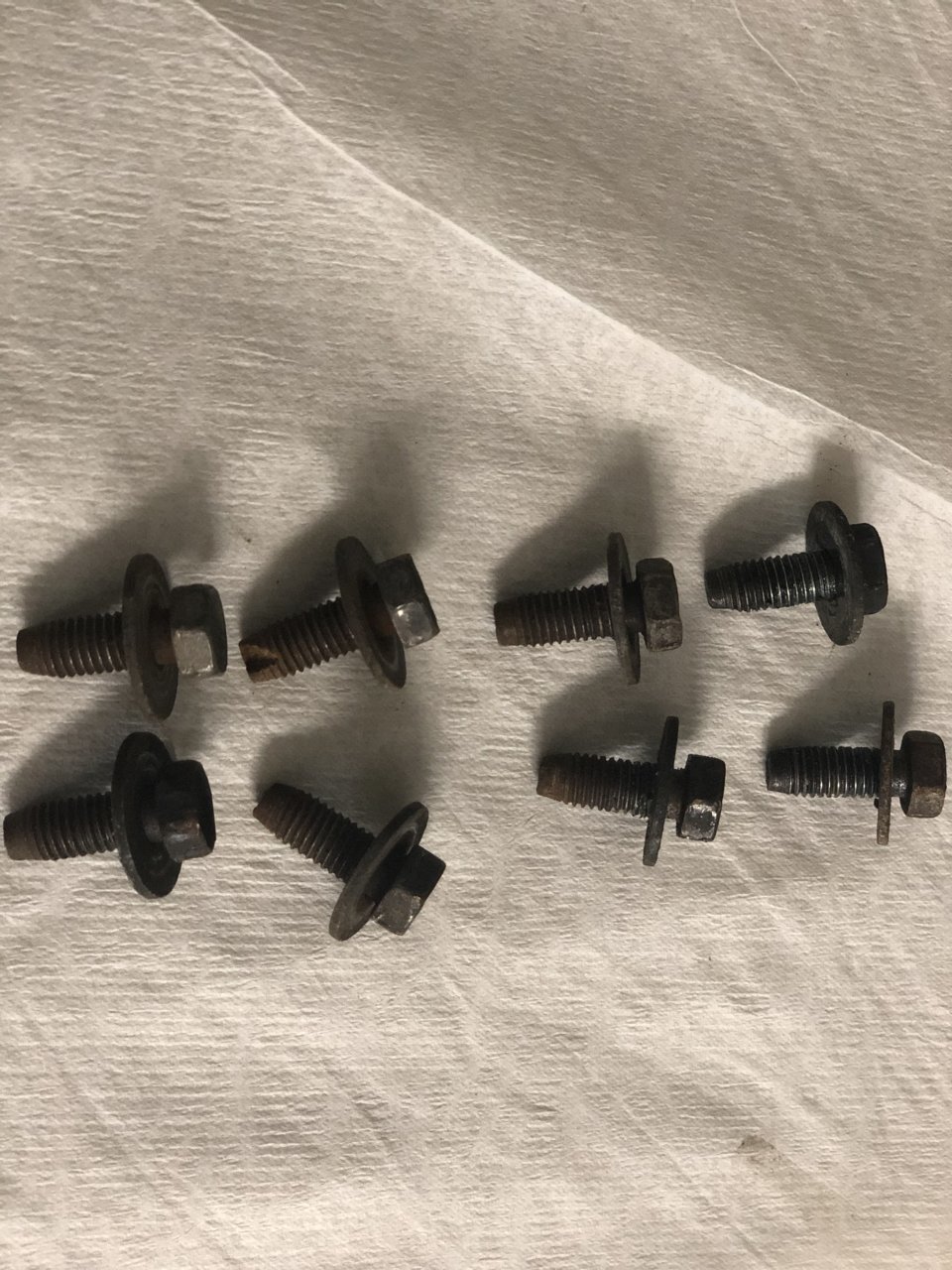

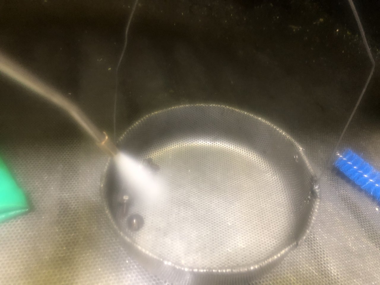

    Cleaned bolts and washers in the vented part washing station
    Mineral spirits are awesome:
    6DB5C54C-365A-420F-8CE1-FB499BA5AC75.jpg C7B92879-2BBD-49E6-B065-1E0336728CF5.jpg
    Grab tools /bolts/cardboard and out to the parking lot!
    Step1
    Remove air dam! 11bolts/10mm

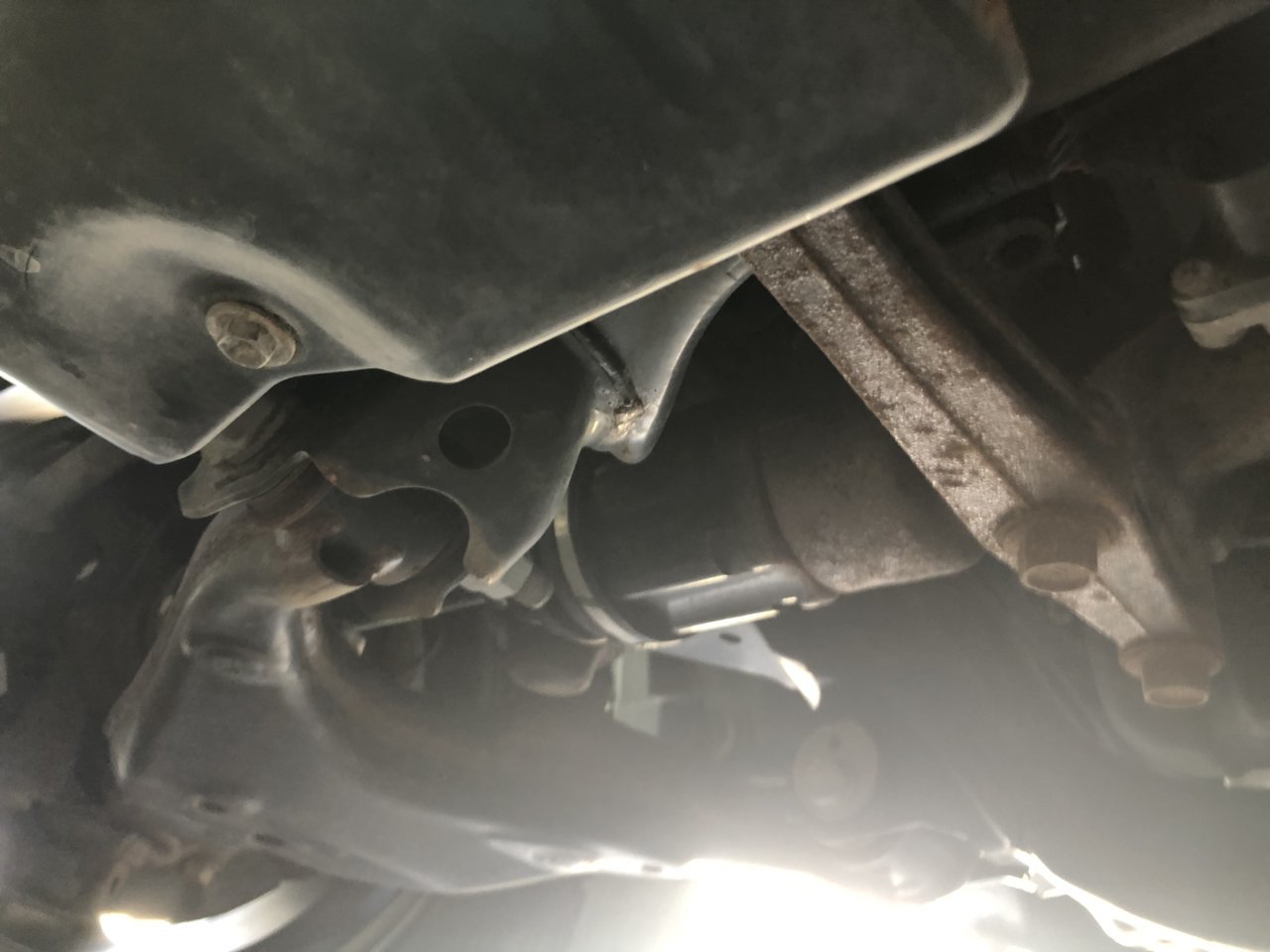

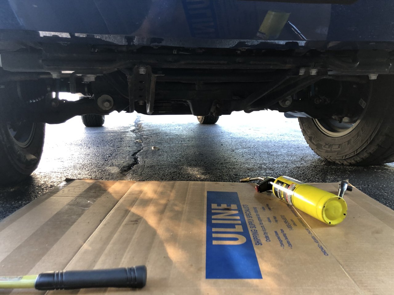

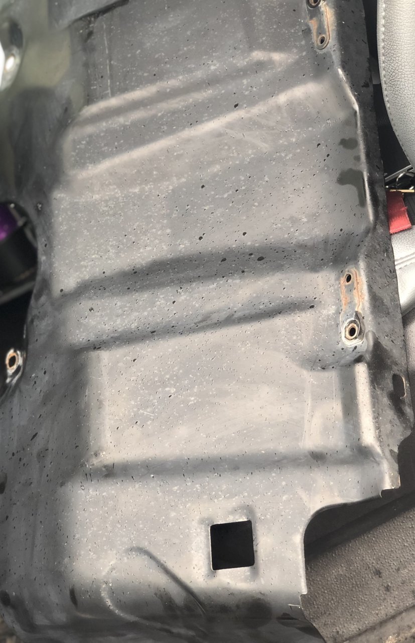

    Step 2 :
    Remove 4 bolts holding on skid plate and remove!
    That bolt head broke on removal!
    Insert pic of MR Torch:
    Comparison of stock front skid and painted skid:
    Step 3: Install front skid
    Step 4: Heavy grease applied to bolt holes and all threads on bolts
    Can’t even call it a mod. Just removed the air dam/chin strap and repainted a used skid. Oh well! Looks better
    Mall rating?
    ⭐️ ⭐️ ⭐️ out of 10
    (No lift, winch, bumper, tires)
    STrooper likes this.

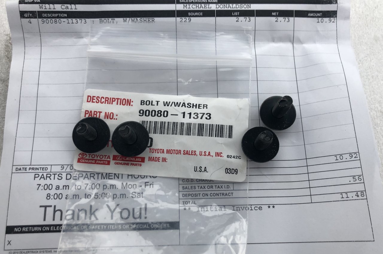

    •Purchased 4 new 12mm skid plate bolts with washers @ Racine Toyota
    Part #90080-11373
    Quantity. 4
    List $2.73 ea
    Sub. $10.92
    Tax. .56
    Total $11.48

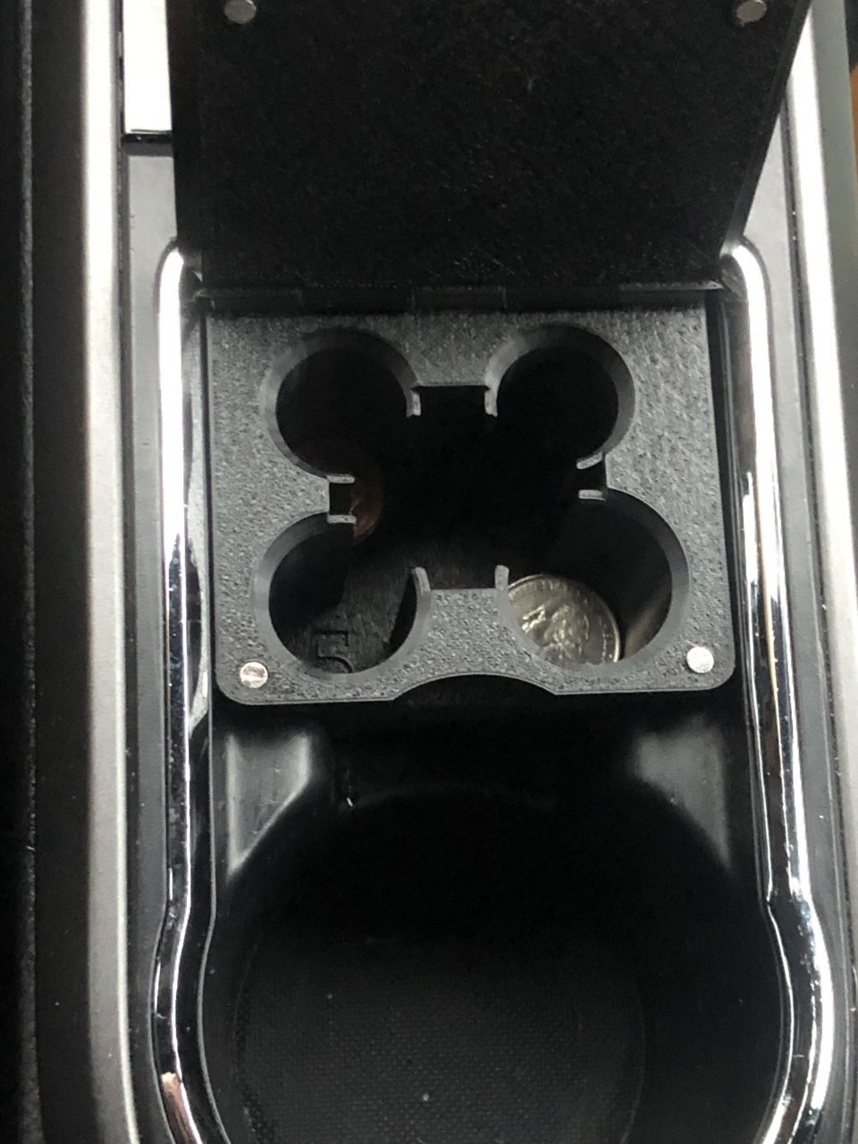

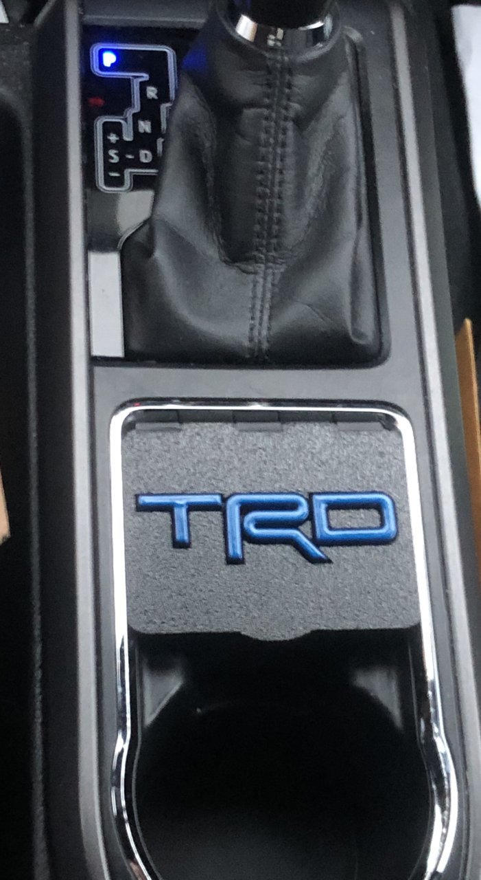

    2/16/2020
    Trd 3d printed coin sorter
    Matching Blazing Blue
    $20
    +6.00 s/h
    $26

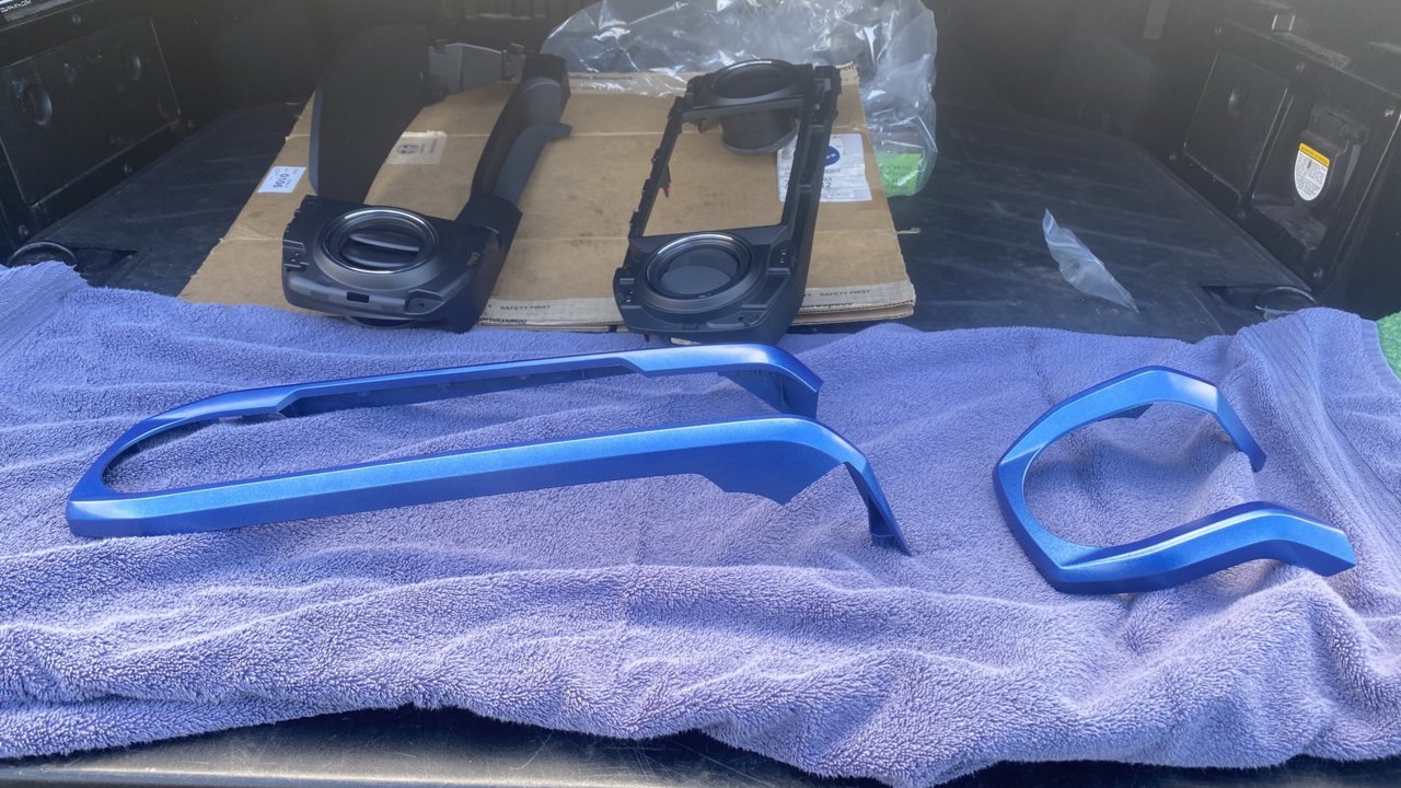

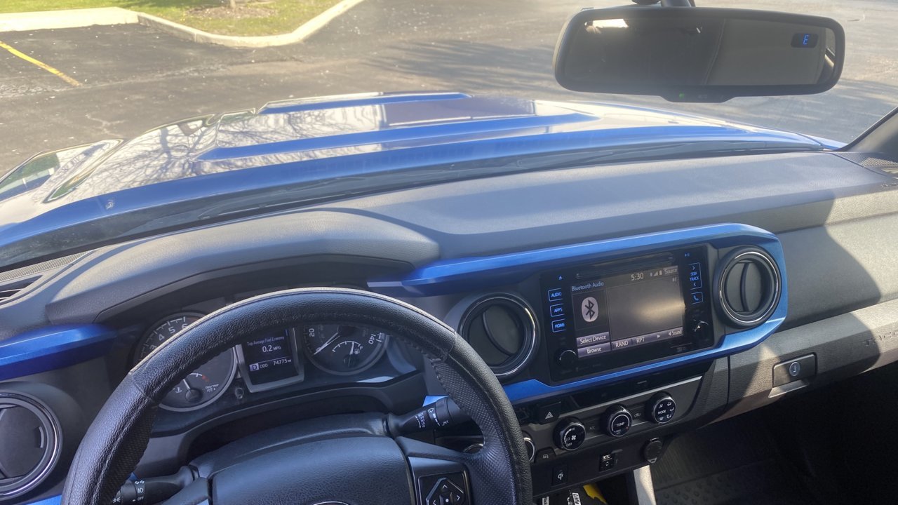

    •5/12/2020

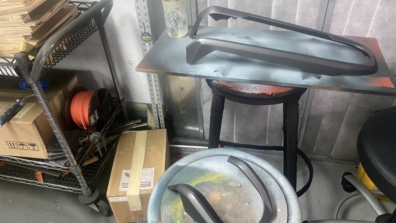

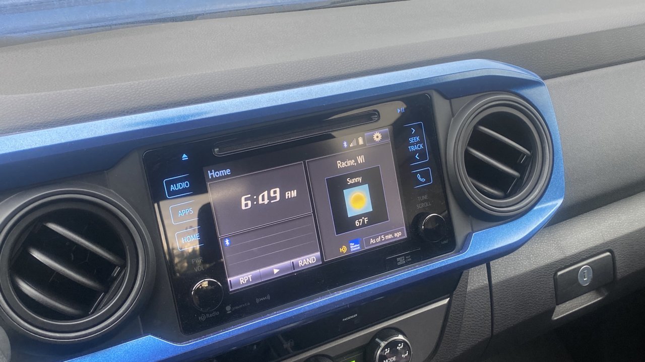

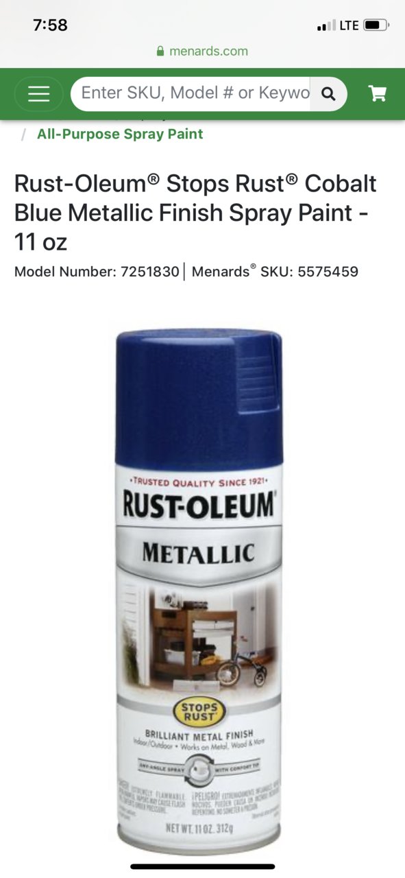

    Interior Dash trim painting
    Cost?
    Paint - $5.56 At menards
    Labor - $0 (Renato)
    My friend Nato painted my dash trim. Matched almost perfectly to Blazing Blue Pearl!
    Original:
    pulled the trim
    Paint
    5AE3B204-447F-40BE-92A5-E465FE114FB7.jpgReinstall
    the paint
    Thanks Renato!!!

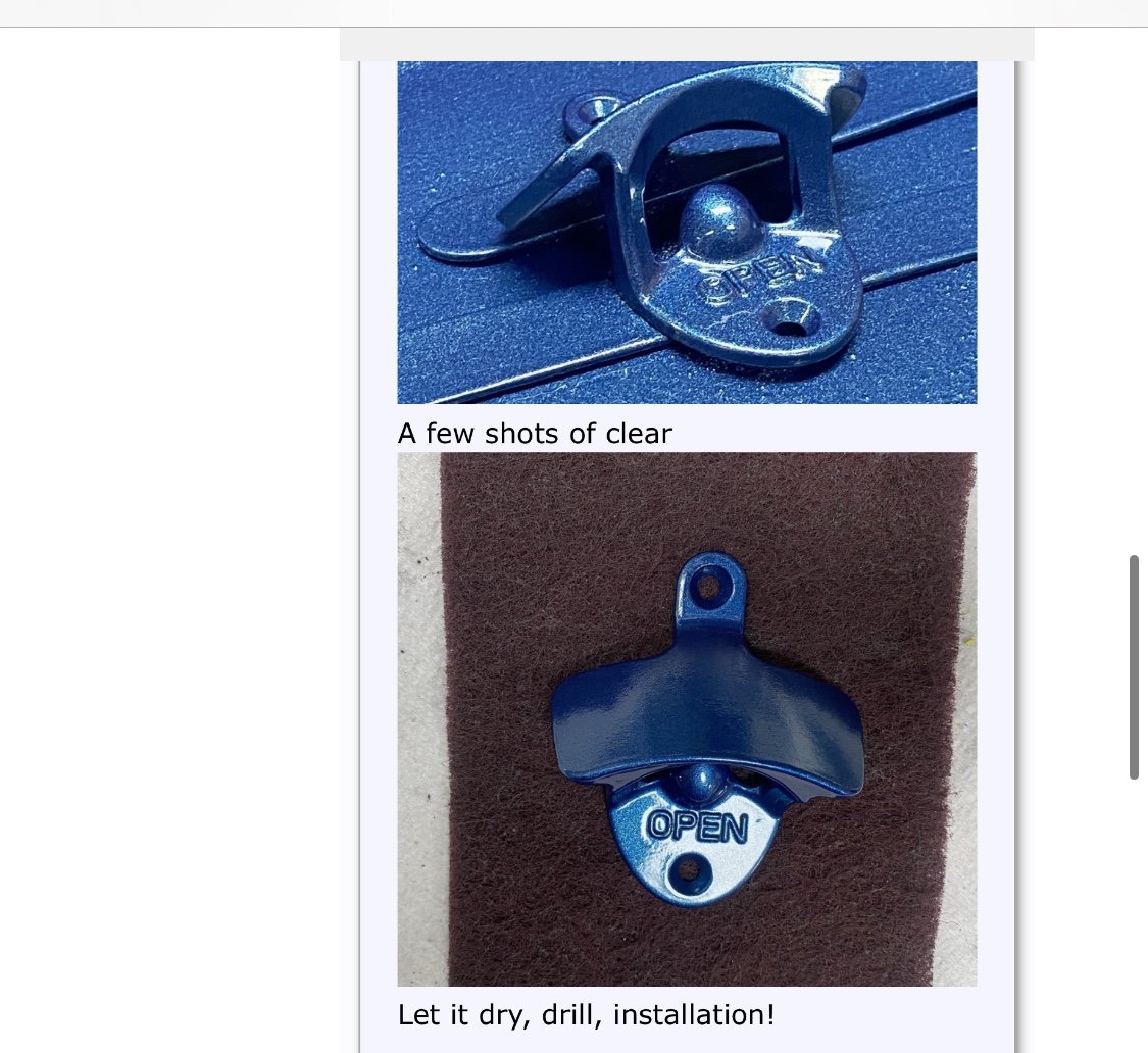

    6/3/2020

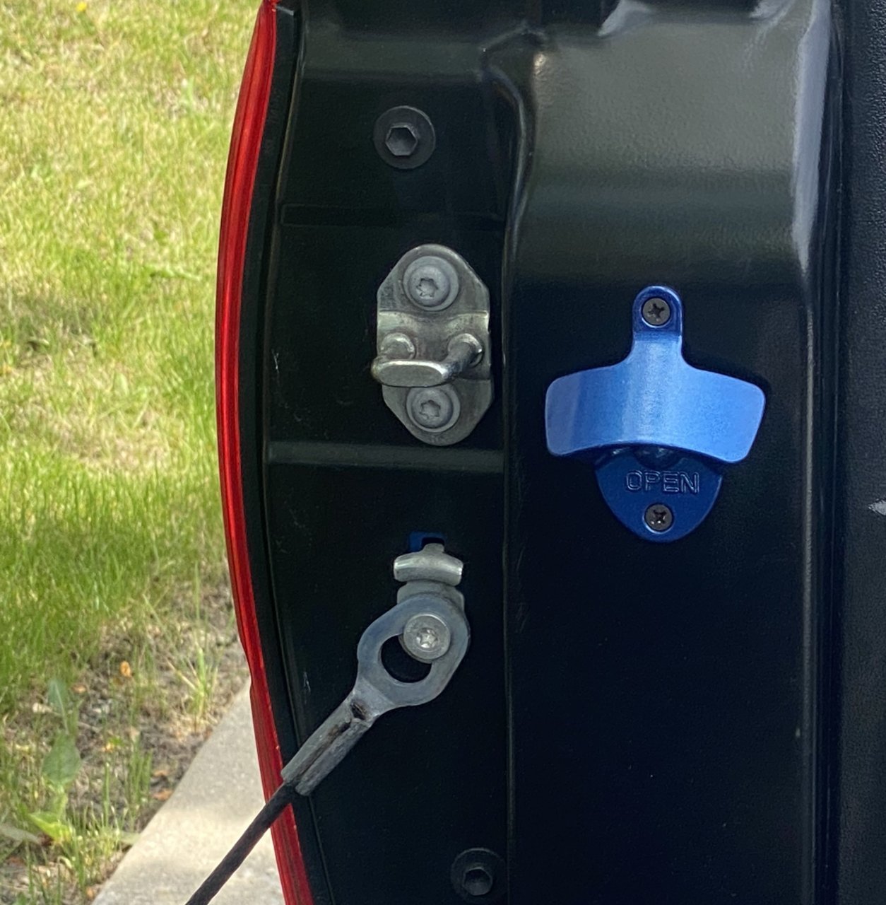

    •Blazing Blue Bottle opener Mod
    Measure twice , drill once!
    Measure and drill pilot holes
    And the install
    E251534B-5676-4D47-991D-36B13E358443.jpg Done!!!
    Lighted Bottle opener for those camping trips that involve drinking after dark!
    2 screws and solid as a rock! Check back in 6 months of heavy use.
    $5 and some spray paint!
    Absolutely came out awesome

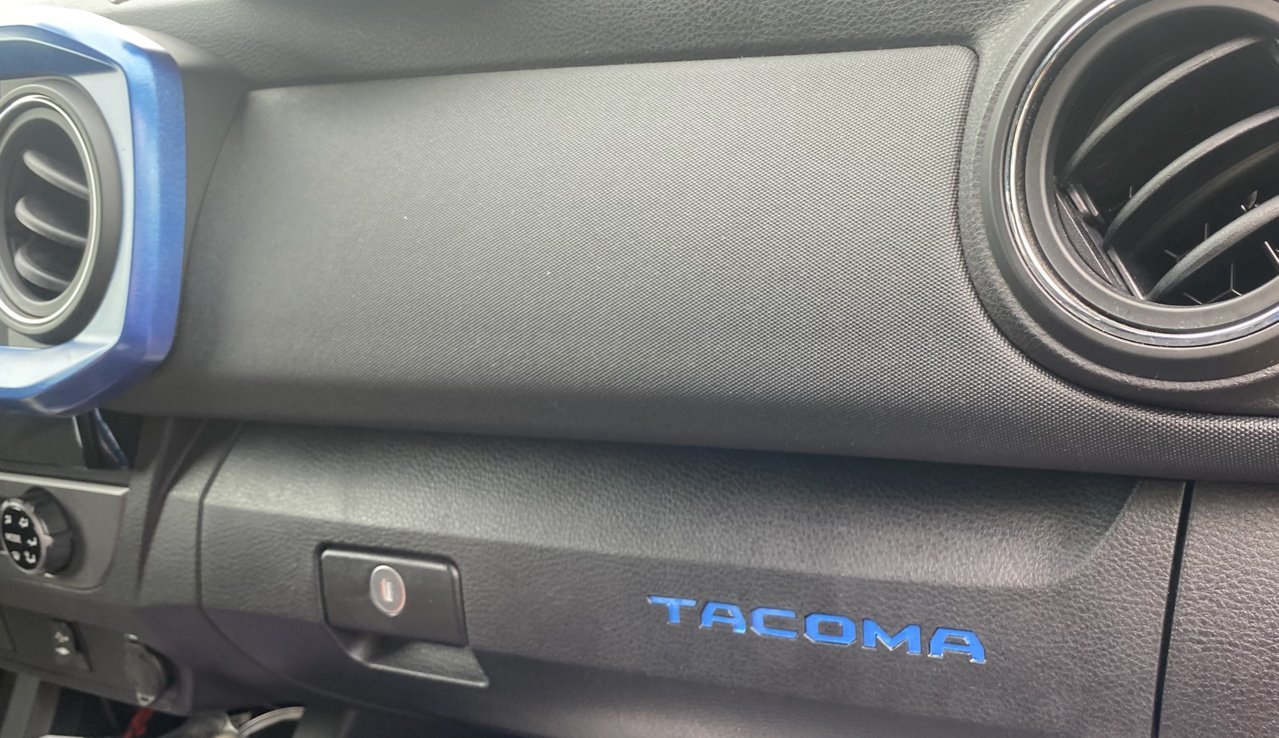

    • Glove box vinyl inlays (BBP)
    just did the old glove box vinyls today

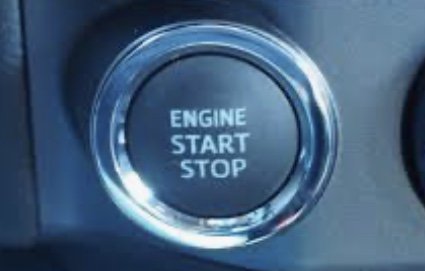

    6/15/2020

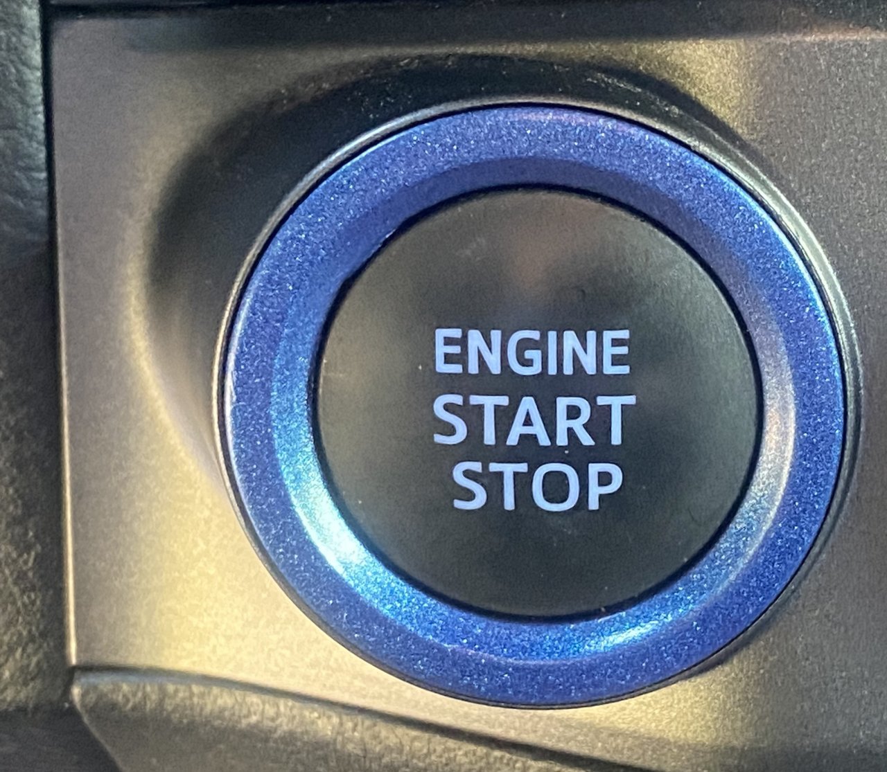

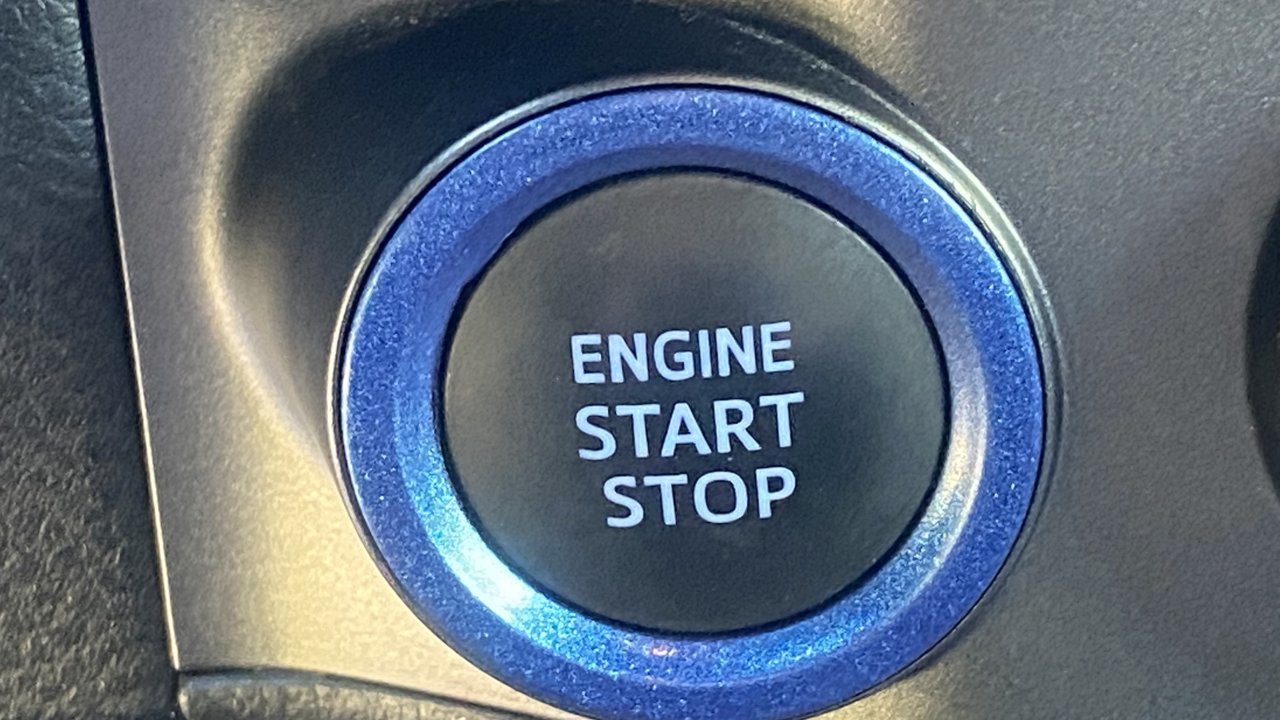

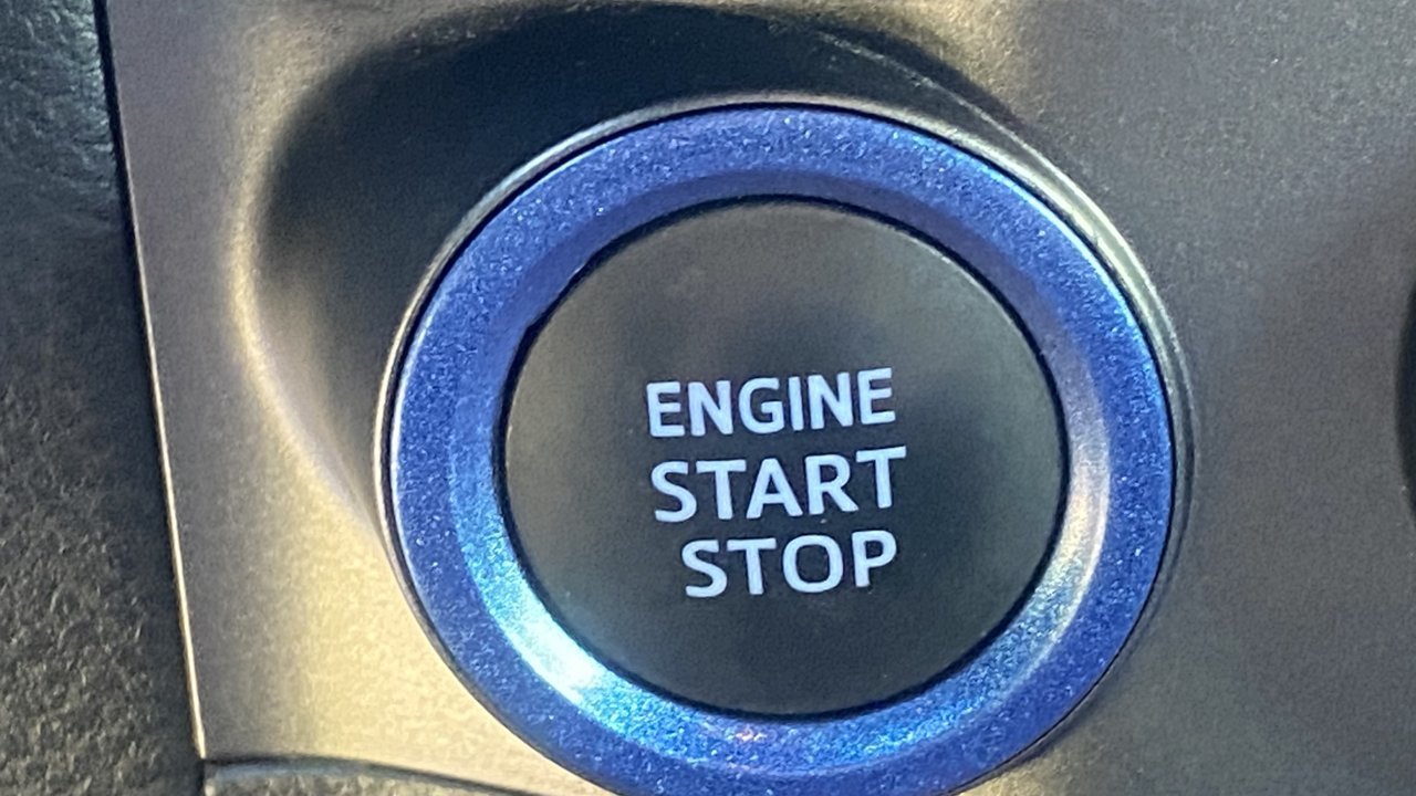

    • Painted chrome trim ring for push start button in Blazing Blue Pearl
    before:
    After:
    602D1D95-CE33-43D9-973E-BEC71191671A.jpg 8657B594-4DD6-45F2-B457-A9FB362141D3.jpg

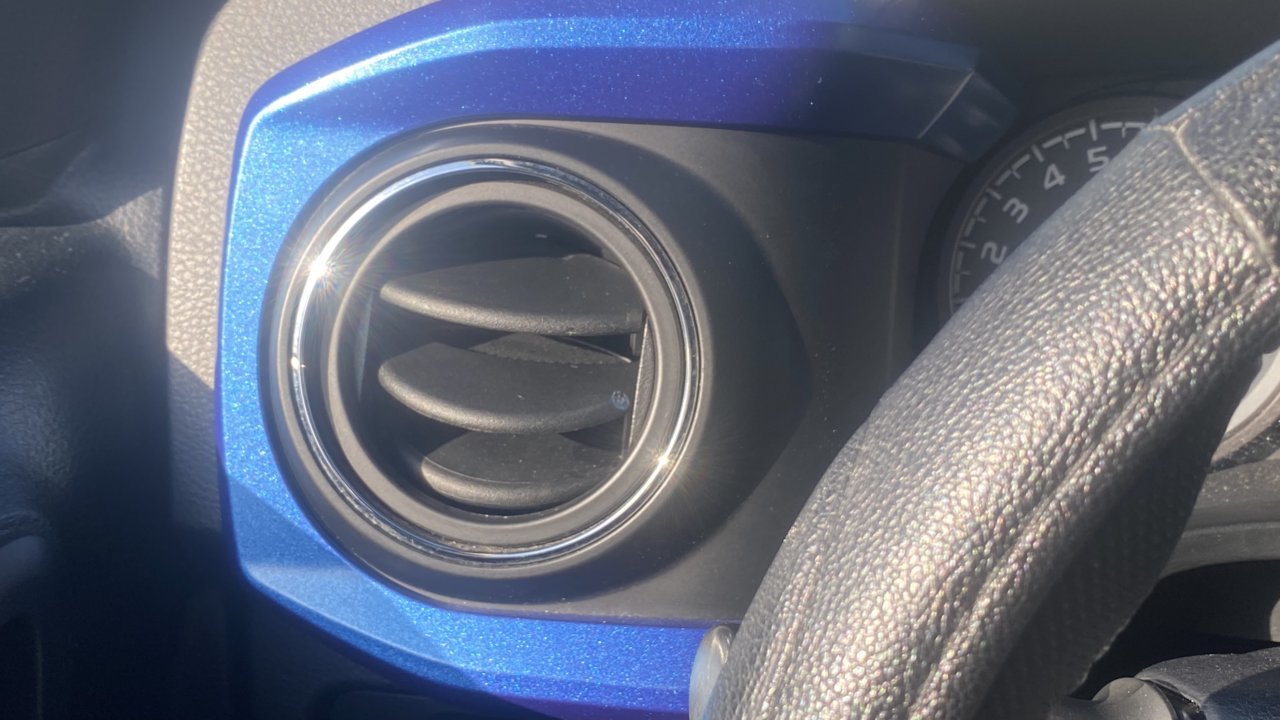

    Before:
    Vent rings removed and painted black
    after:

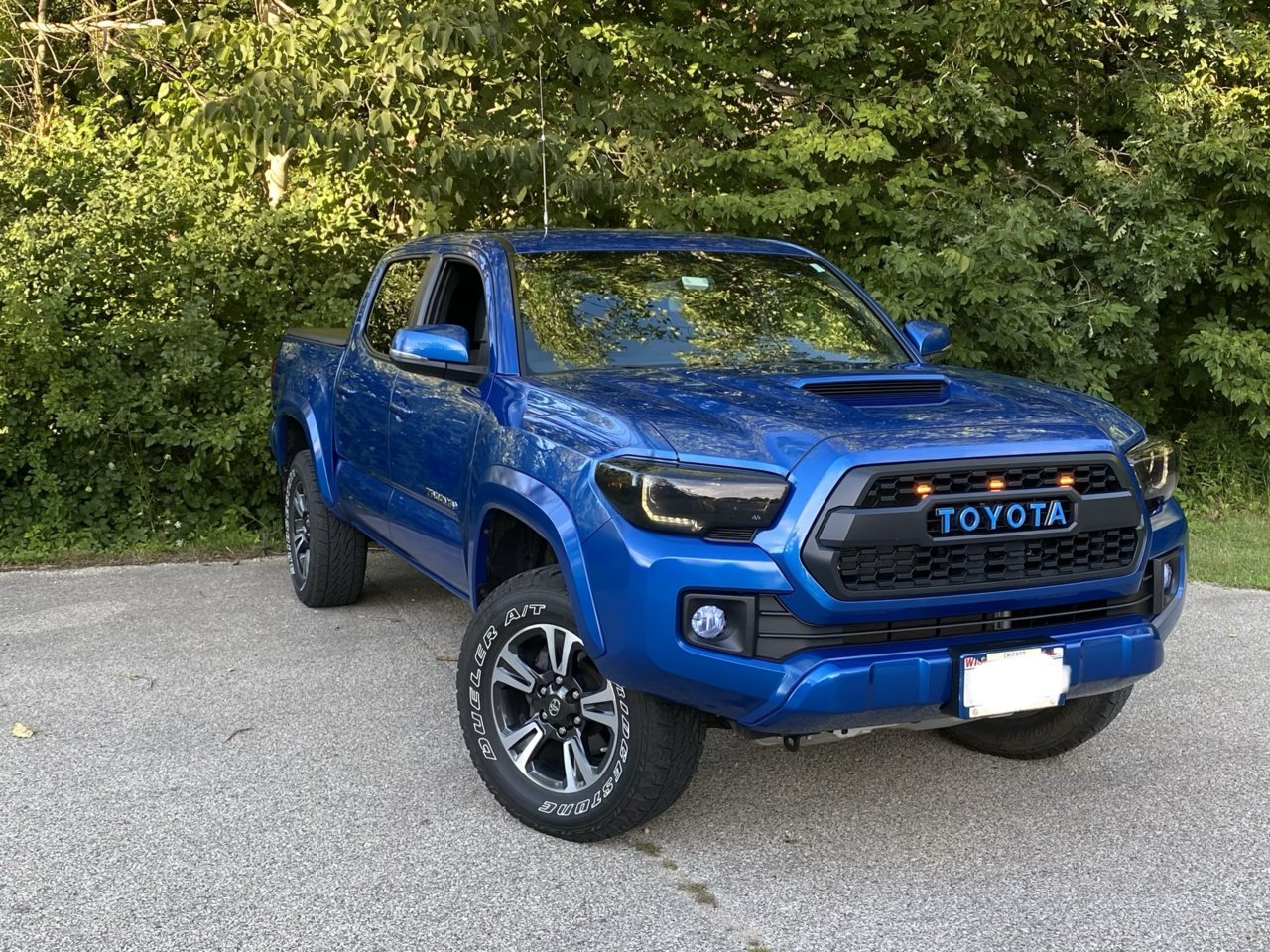

    8/9/2020

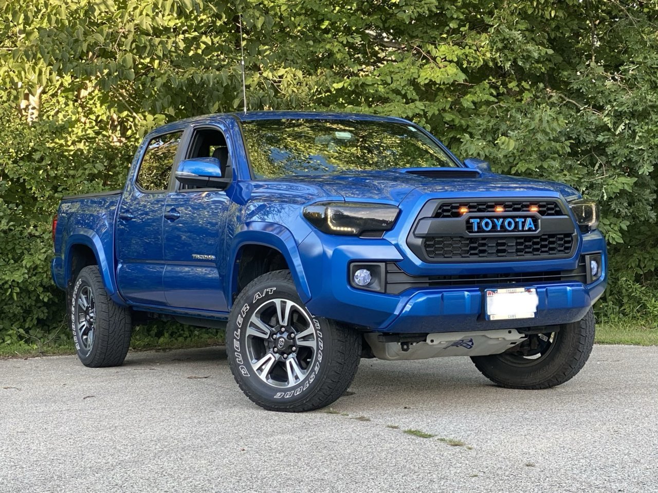

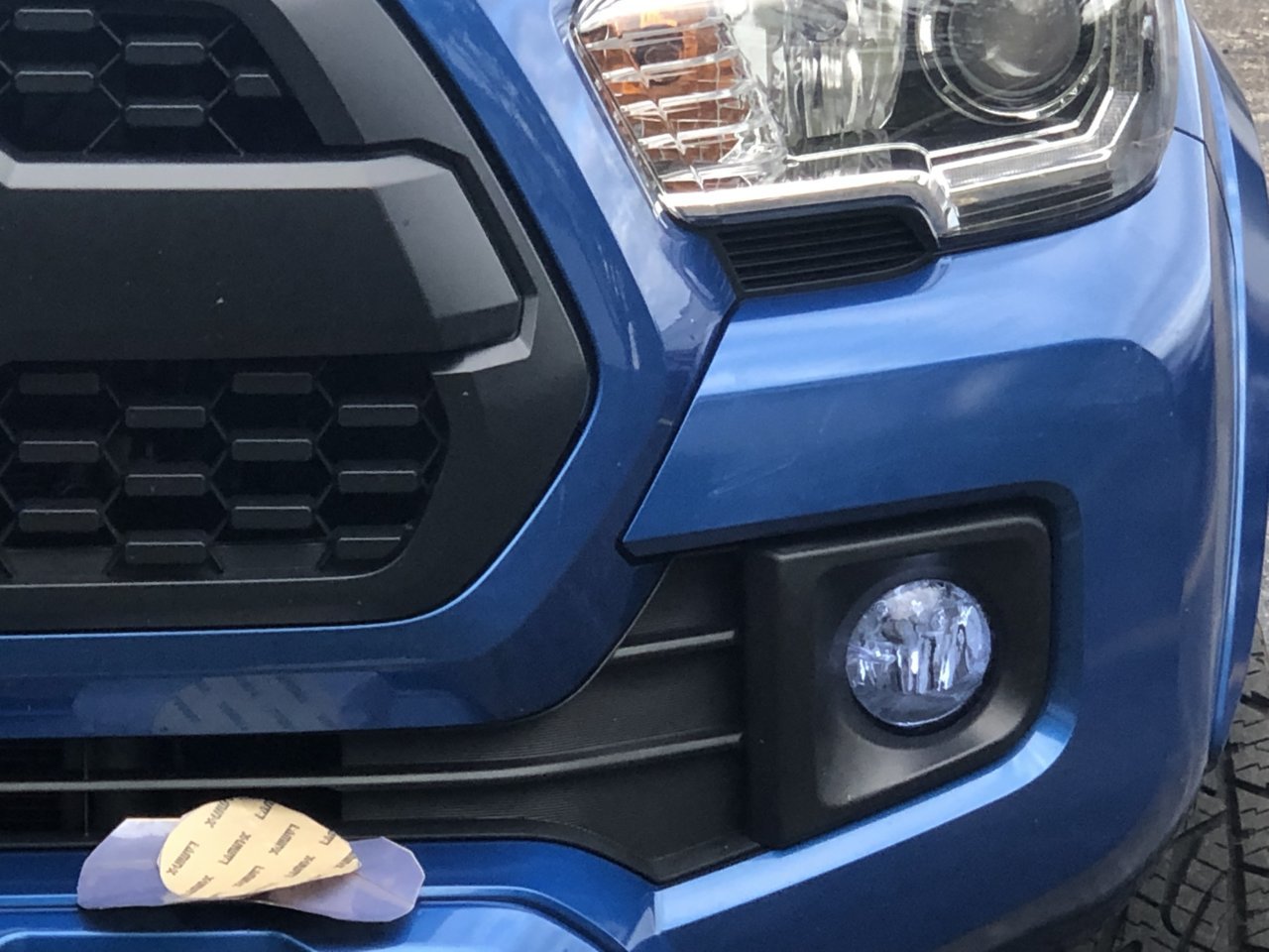

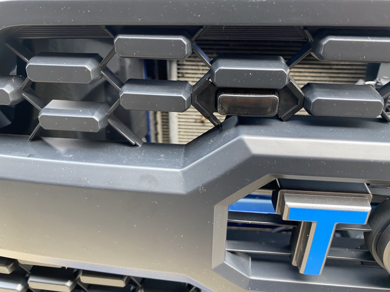

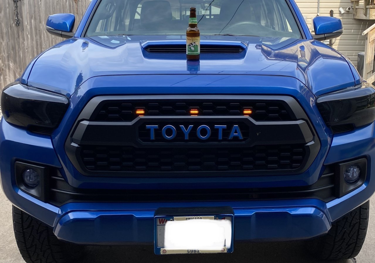

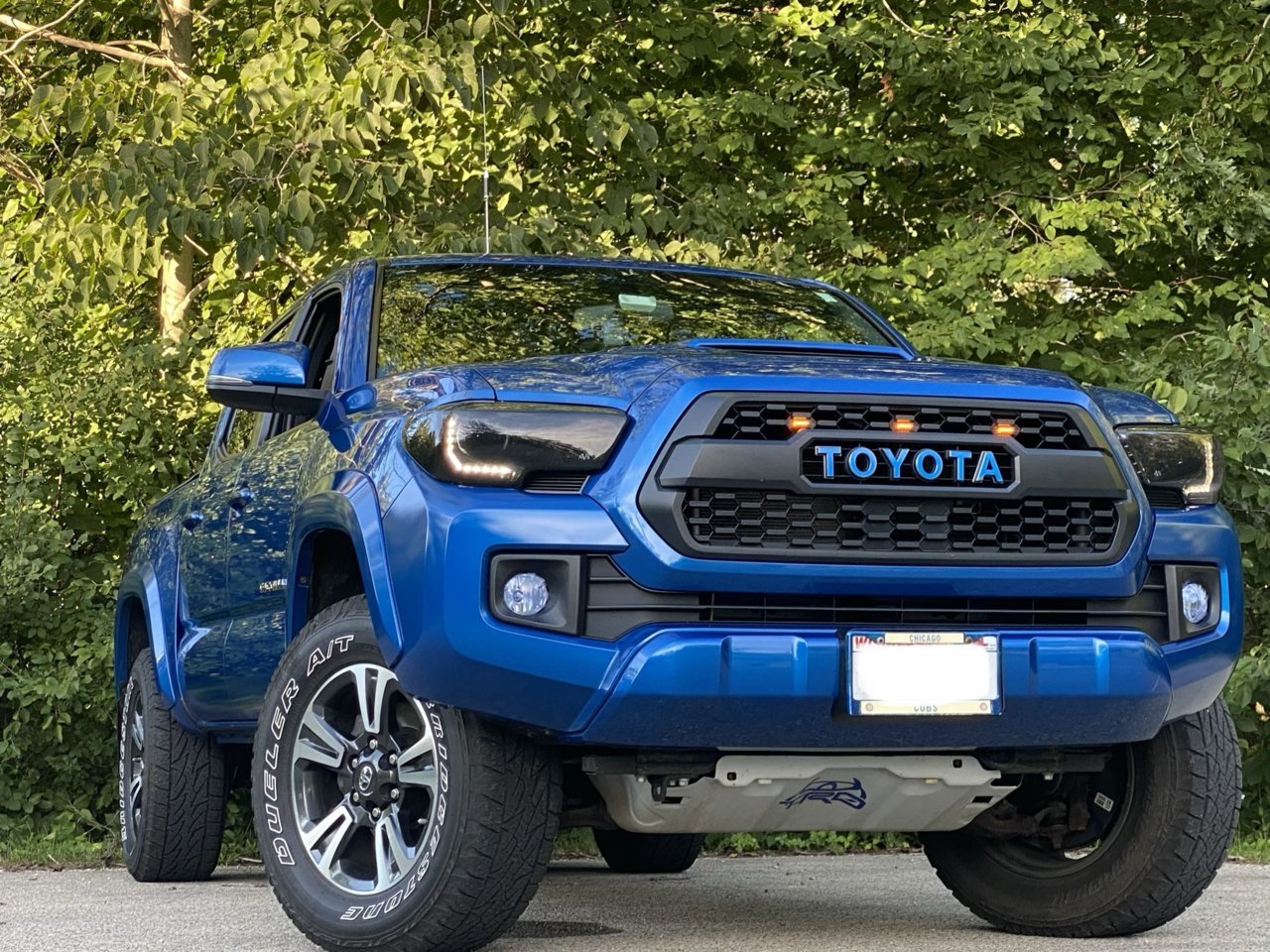

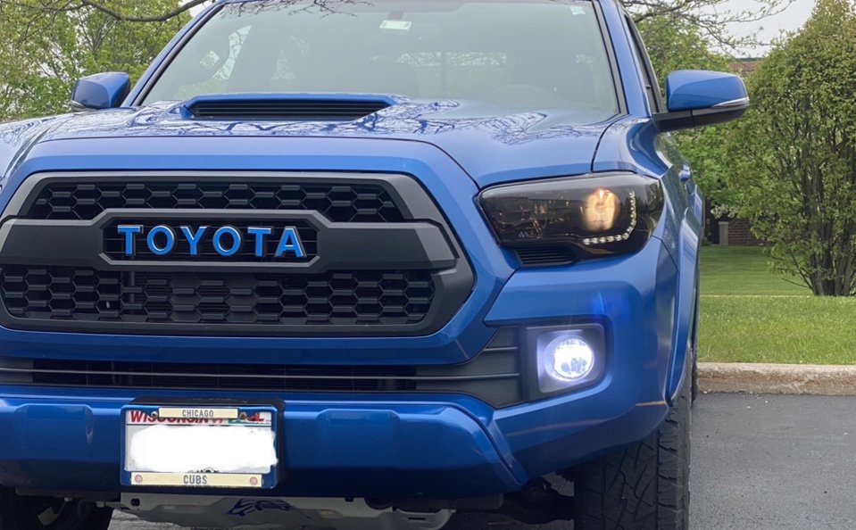

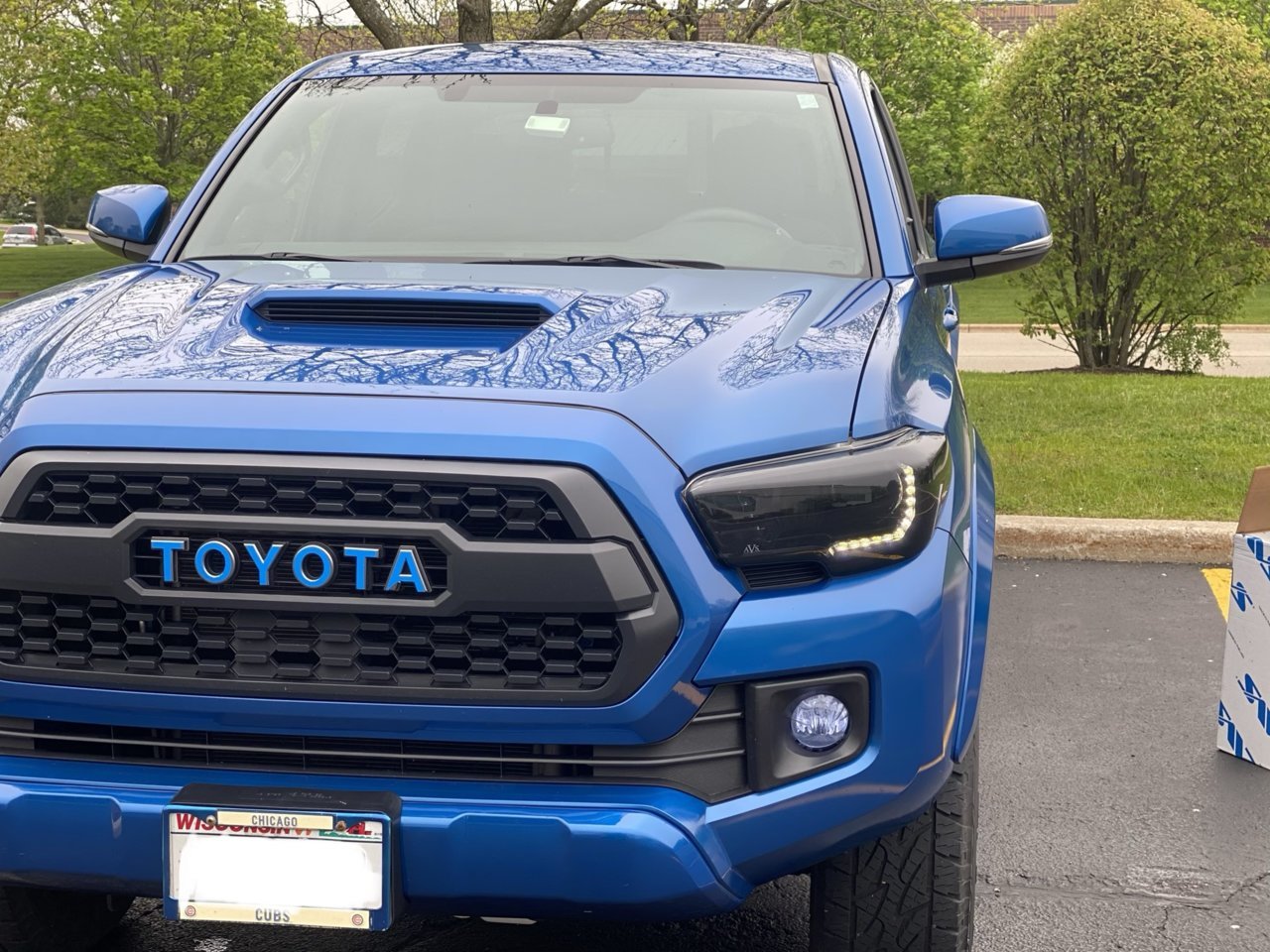

    Install Pro Grill lights
    Smoked lens/Amber light
    eBay special
    Some love ‘em , some hate ‘em!
    I think they improve the look. I like the smoked lens lights. when the truck is off you don’t notice the bulbs. They just blend in. Looks awesome!

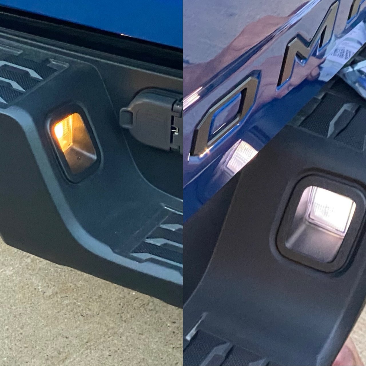

    Replaced stock License Plate Bulbs with L.E.D !
    Wow.. amazing difference
