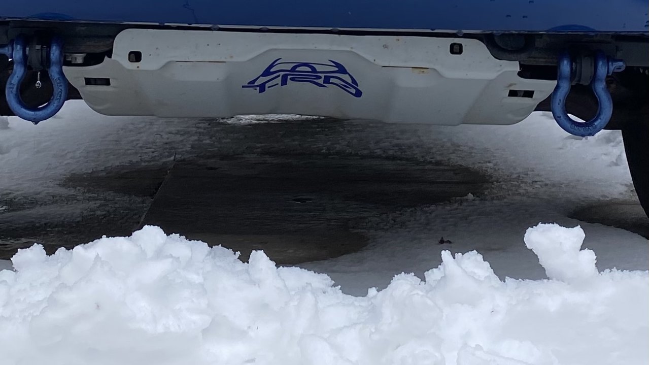

    Recovery Gear
    ARB Weekender Recovery pack
    Cost? $0 won at Chi-Town4x4 open house

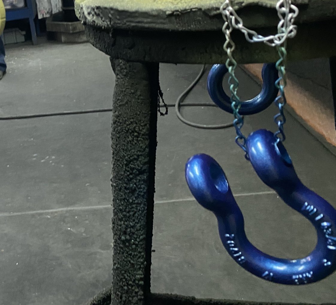

    Front shackles
    Arb shackles (painted blue)
    held on by Demon Brackets
    (Not sure if they’ll hold but in a emergency we will see)

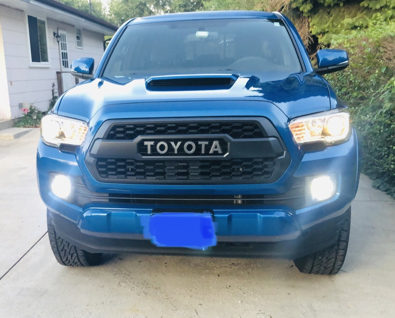

    Exterior:
    Trd pro grill
    Trd pro grill smoked “Raptors “
    Trd pro grill Blazing blue vinyl letters

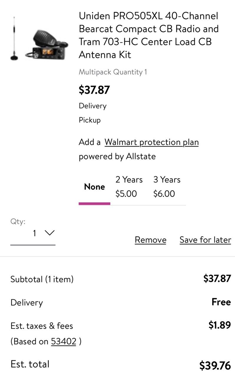

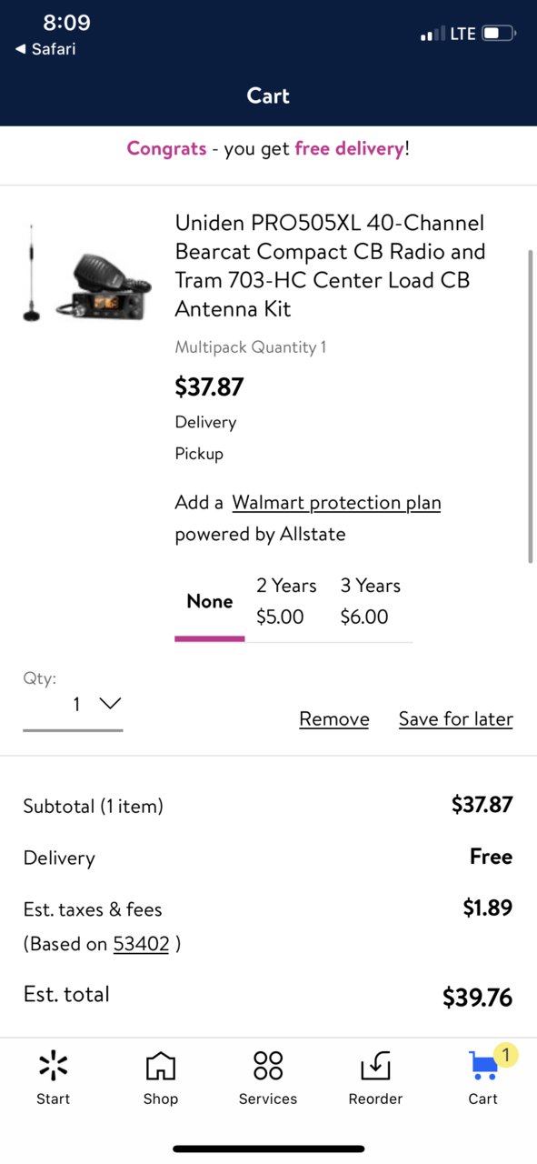

    Communication Gear:
    Uniden Pro 505 XL CB
    Tram 703-H3 center load Magnetic Anrenna
    complete Package deal from Walmart $37.87+ tax and free shipping total$39.76
    http://www.walmart.com/ip/Uniden-PR...am-703-HC-Center-Load-CB-Antenna-Kit/50705164
    Additional Antenna:TBD
    Antenna mount bracket:TBD
    Additional com devices: TBD

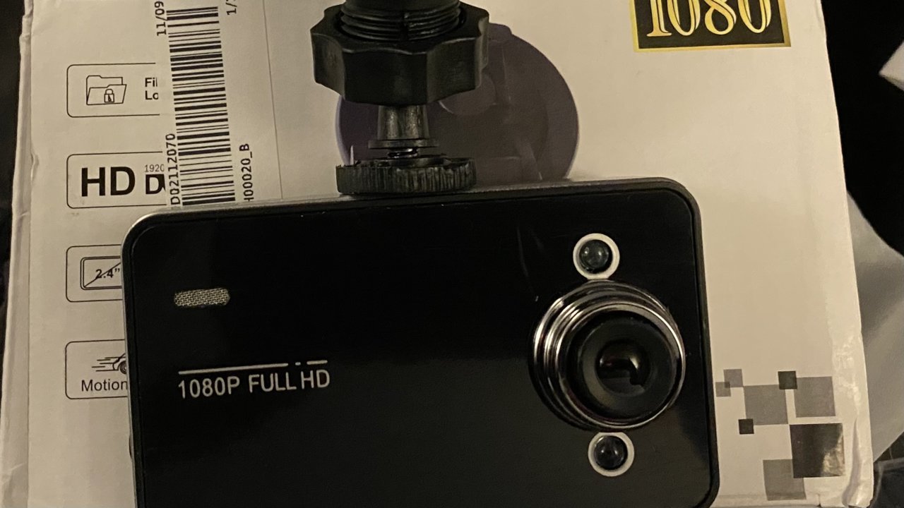

    Dash Cam
    K6000 1080p dash cam
    (Christmas gift from the wife 12/25/20)
    https://youtu.be/ymHZmL_cI9A

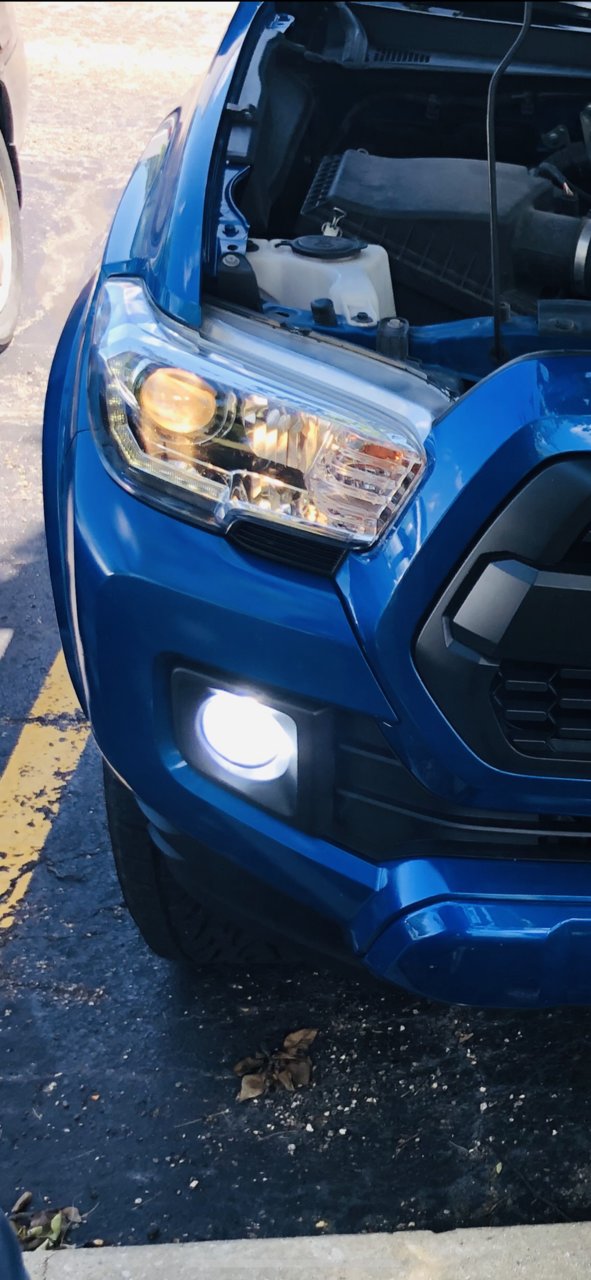

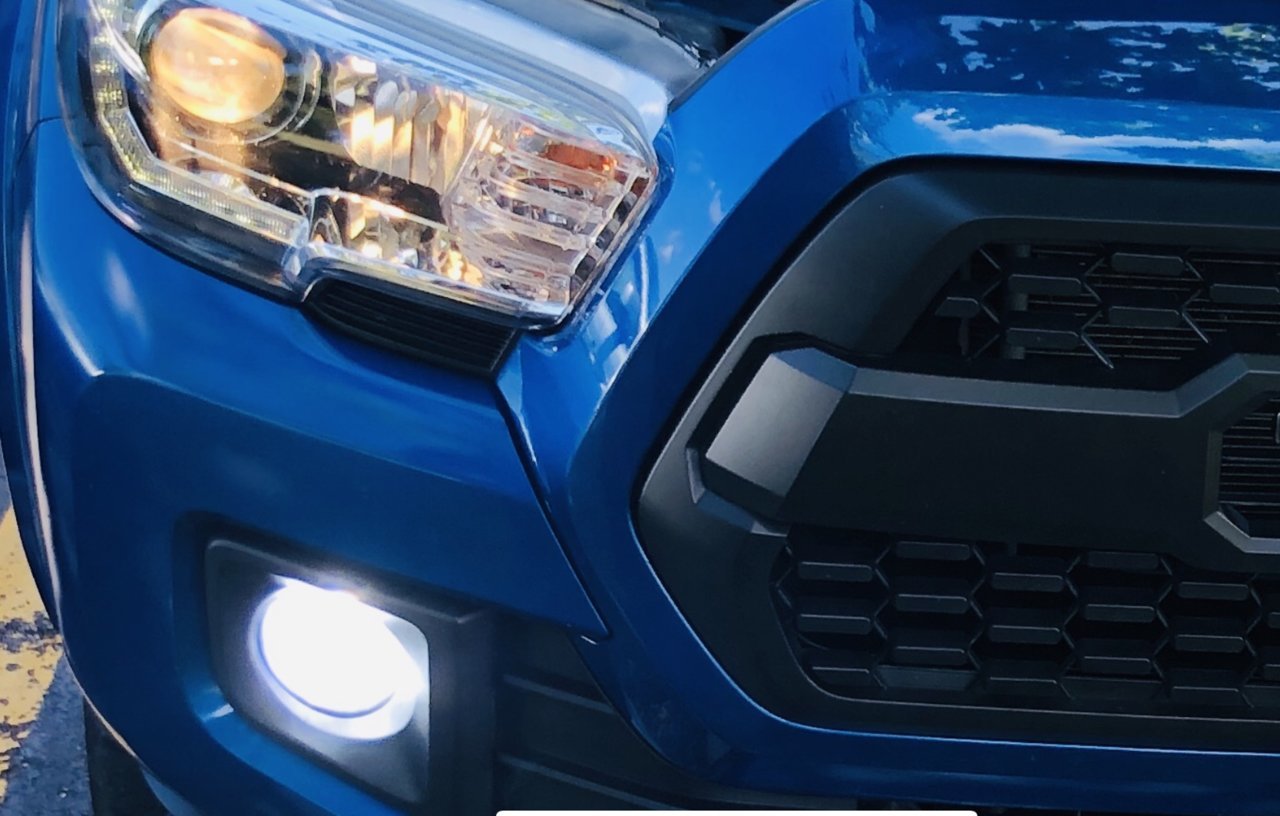

    Headlights (Lasfit led h11
    Fog lights 6k bulb(Las fit h11
    H11Lasfit
    Lamin-X Blue fog light Tints

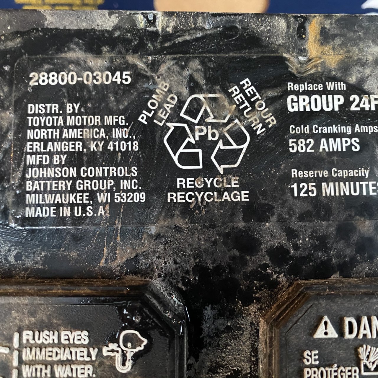

    Toyota OEM Battery
    28800-03045. Group 24F

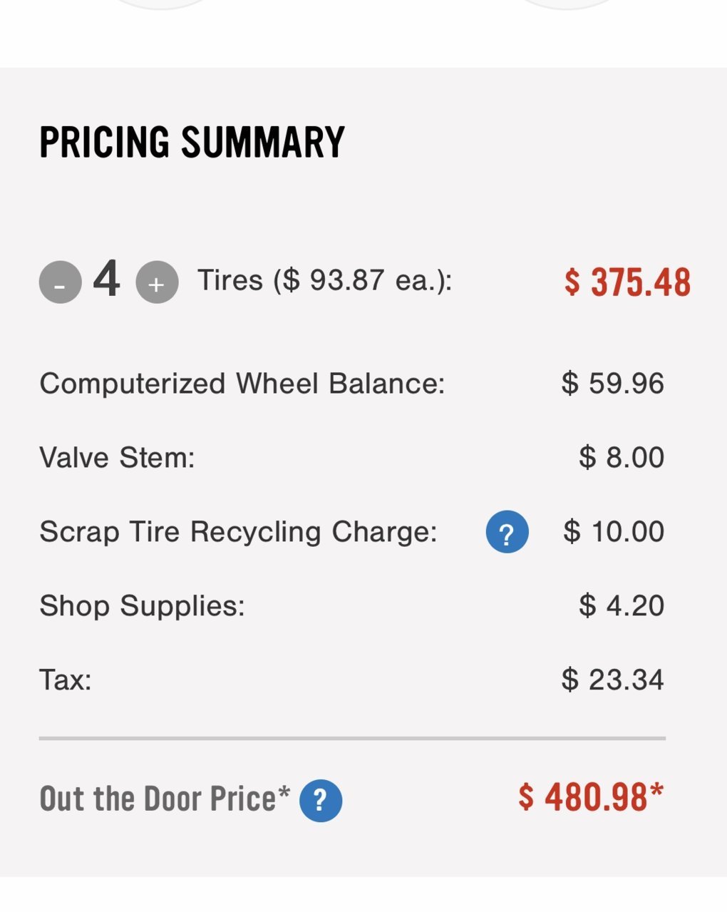

    50,000 miles
    New tires
    Just tires Appleton,wi
    $480.26
    Oil change

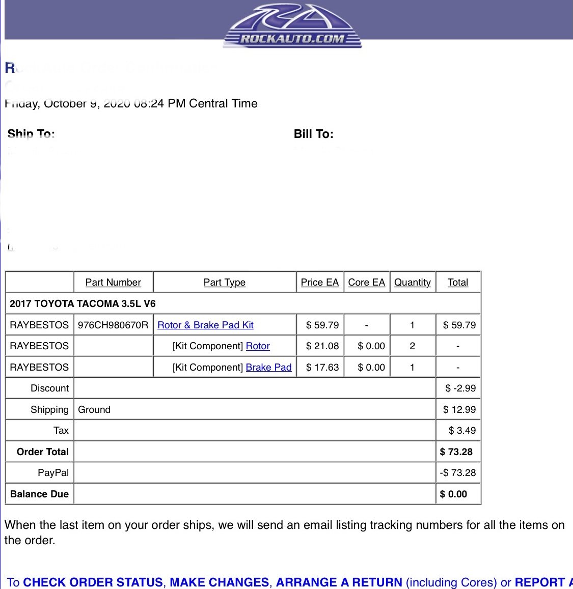

    Brake inspection
    (Needs Rotors and pads)

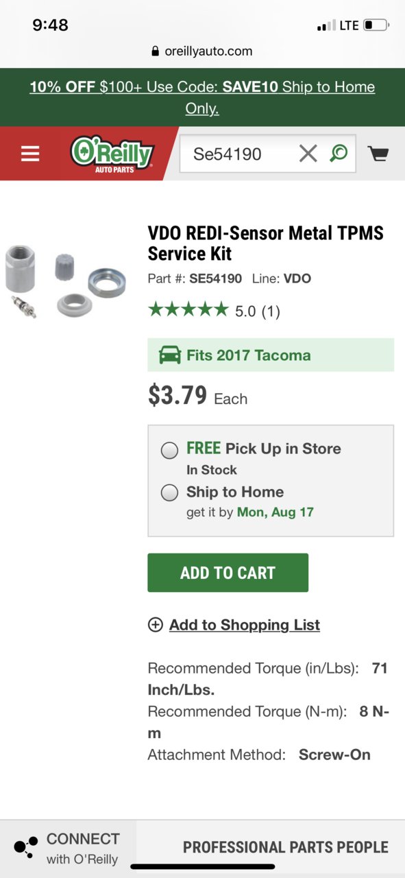

    1 valve stem fix
    (O’Rilley auto parts Racine) $3.79
    VDO-redi sensor TPMS repair kit ( valve stem repair kit) $3.79 each and bought a spare!
    _____________________________
    83,891
    Rotors and Brake Pads Replaced
    By neighbor Tom

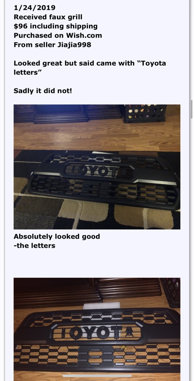

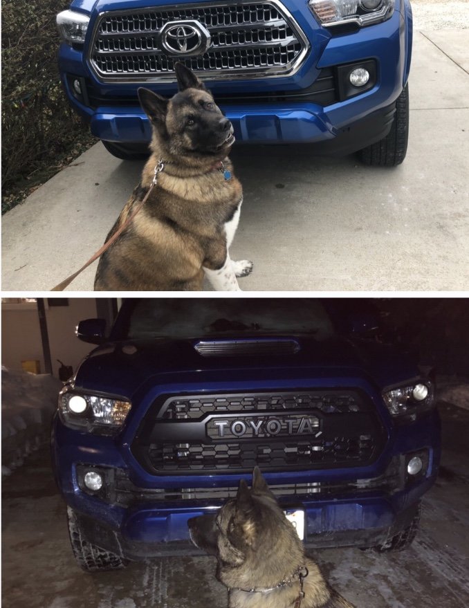

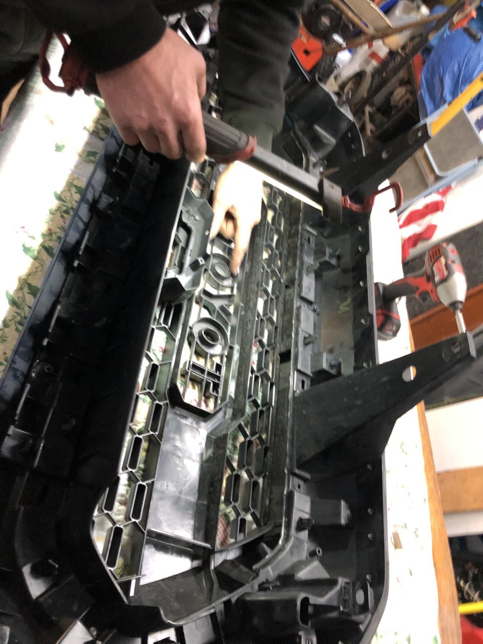

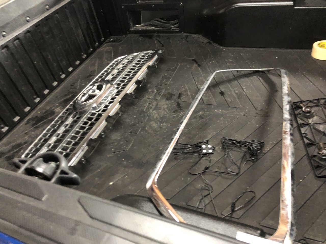

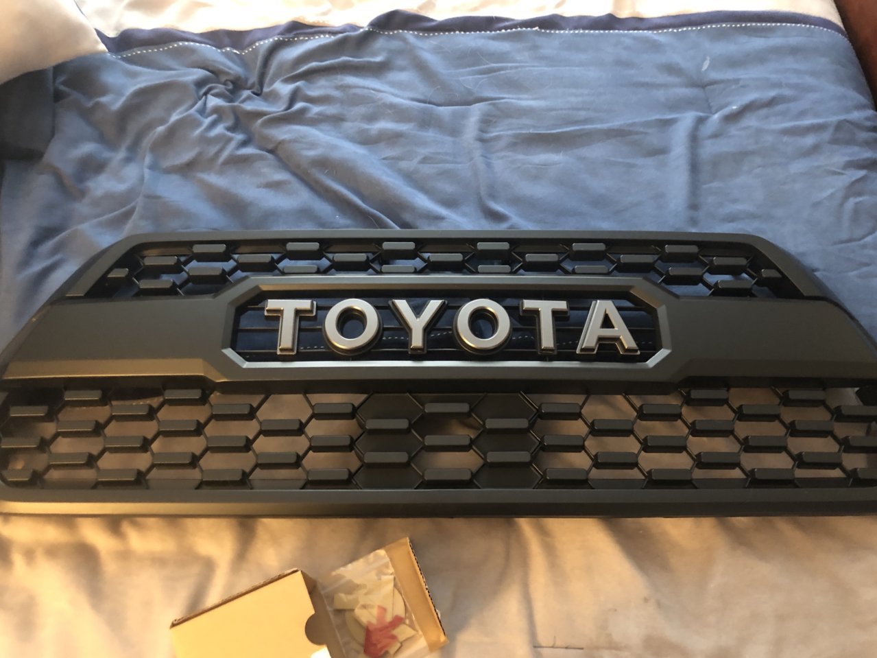

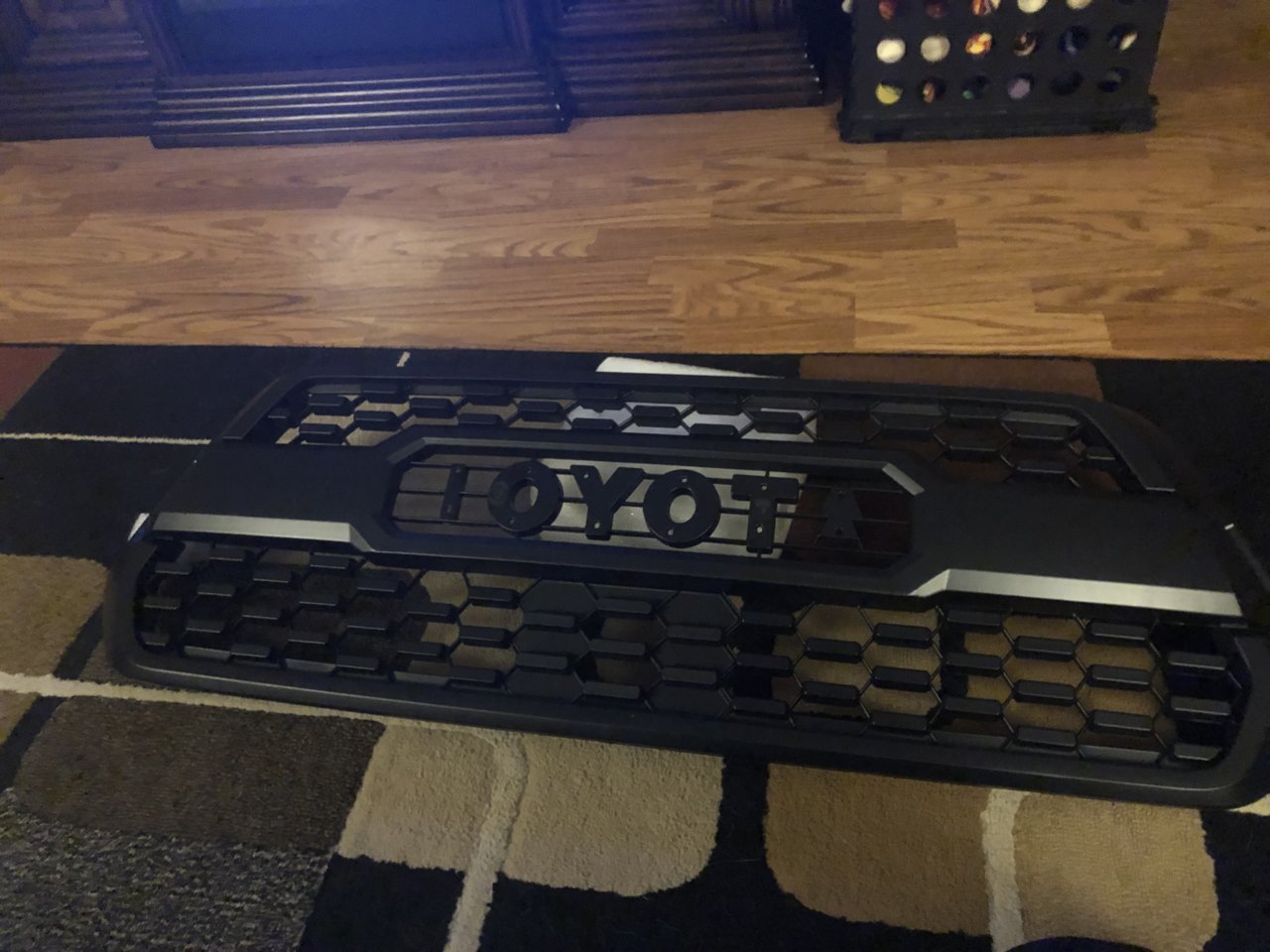

    1/27/2019
    Install day!
    Taking apart the China chrome grill
    Clipping the new grill in place!
    Easiest install ever! 25 minutes!
    Before/after

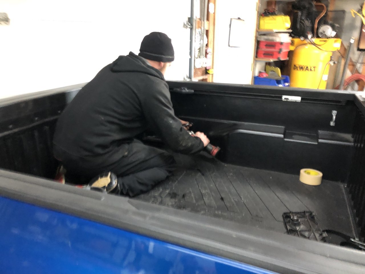

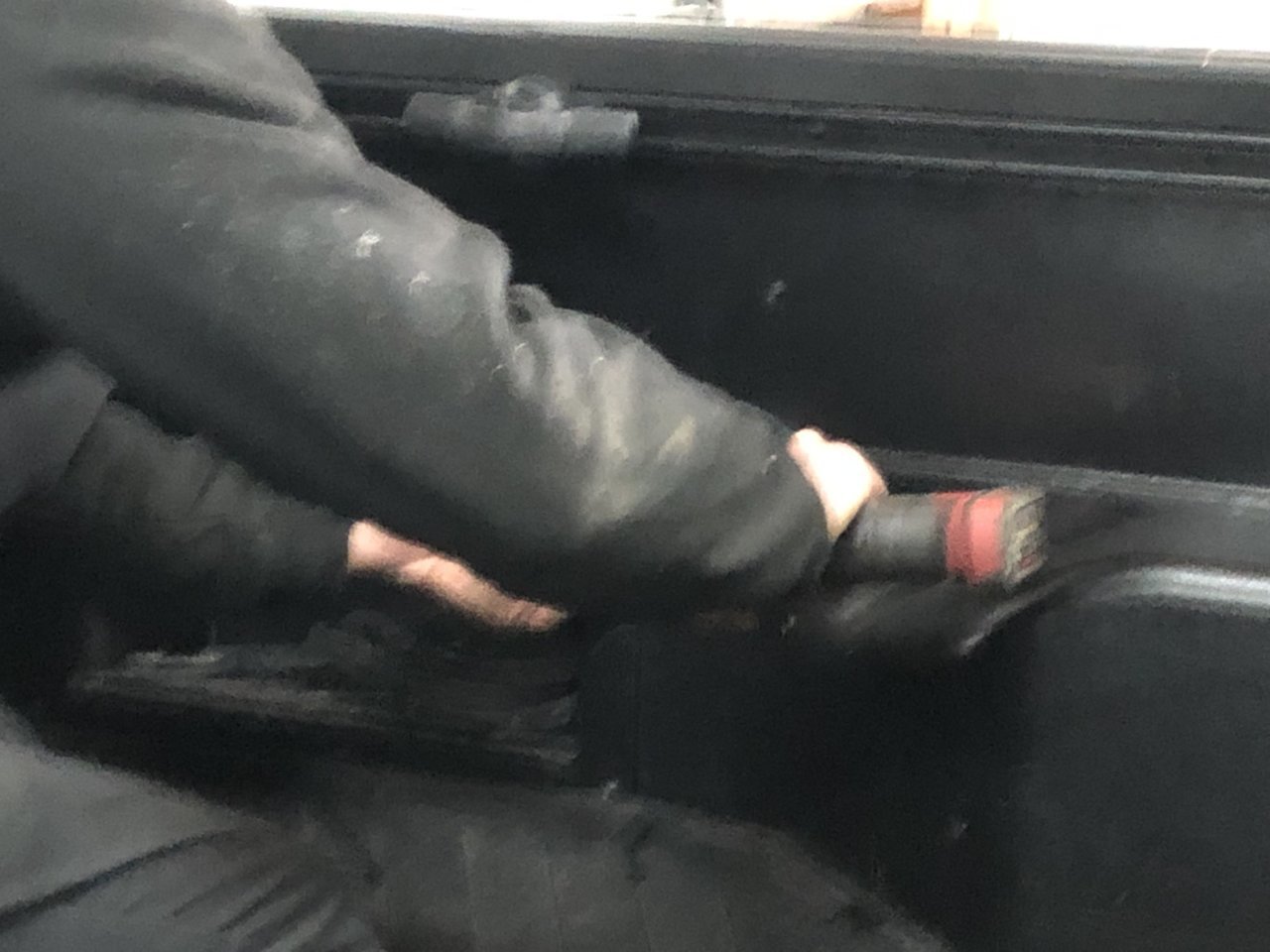

    And install day!
    1/27/2019
    Installing XPRITE lite bed lights
    I believe he got them on Amazon .
    4 leds per light!
    Warming the truck in the neighbors
    garage overnight. Removed the tonneau cover to heat the bed walls!
    The man, The myth , the legend! Tom installing.. if you need some work done , he’s a guy to do it/fix it!
    Removing cubby to access wires
    Interior panel opened and connected to rear cargo light switchD96057B6-C1AA-43B0-ADD2-9C0EBD5B2C86.jpg
    Mounting the lights, he lined the lights up with the screws holding the Toyota track system in place . Drilled and riveted in place. Tucked wire behind the rail.205B6C12-6898-4446-B511-C1DAC965A344.jpg
    Reassemble and boom! Bed lights on the Cargo switch!

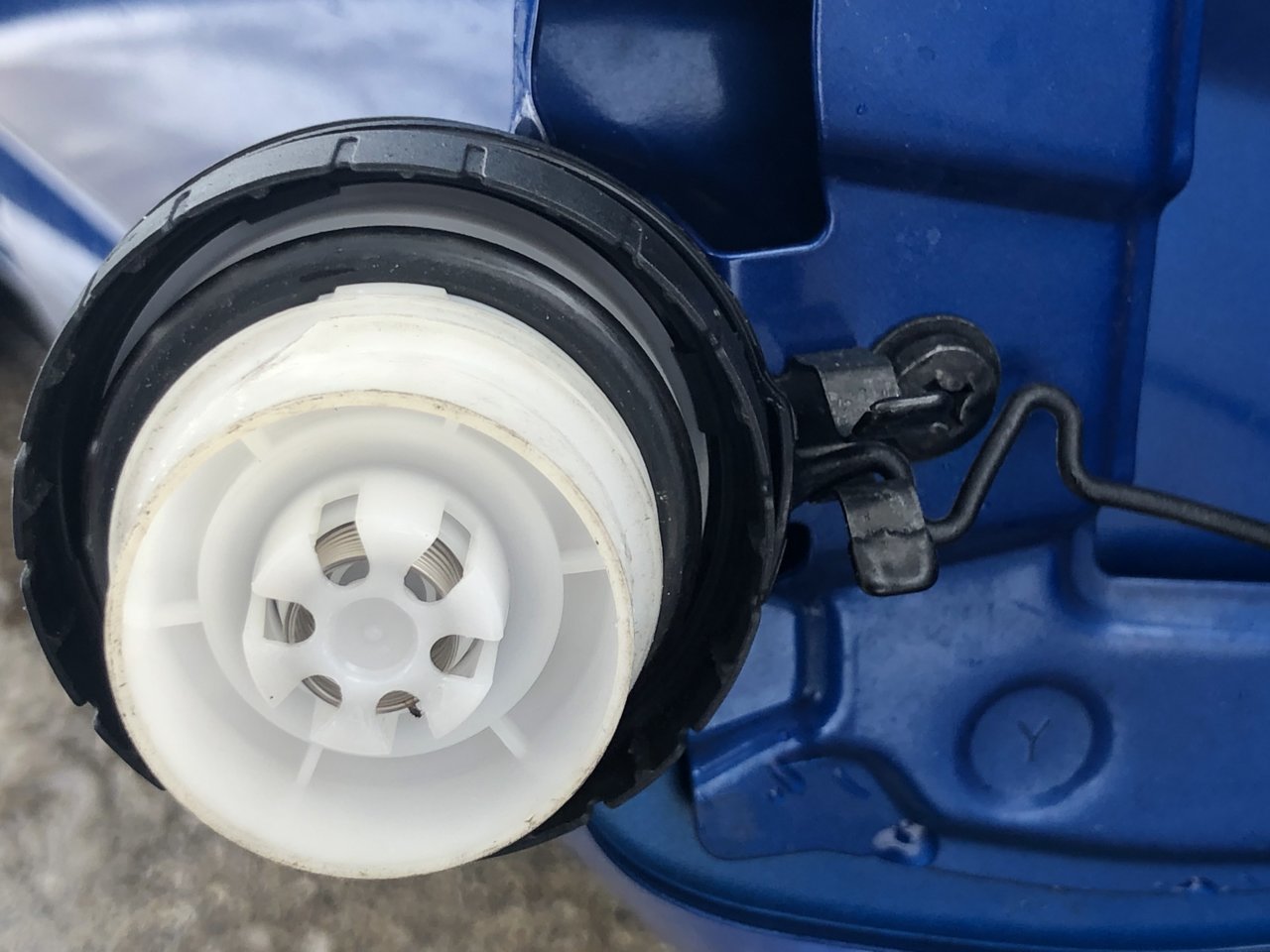

    Fuel cap holder!
    Standard
    Had this truck for ever and saw the link for gas buddy(gas cap holder).. turns out ours are built in if you have the plastic strap attached to the fuel cap still.
    Obviously when this cable breaks
    70EF59D8-4099-4F19-8AF6-326C67087D17.jpgI’ll be jumping on the gas cap holder.

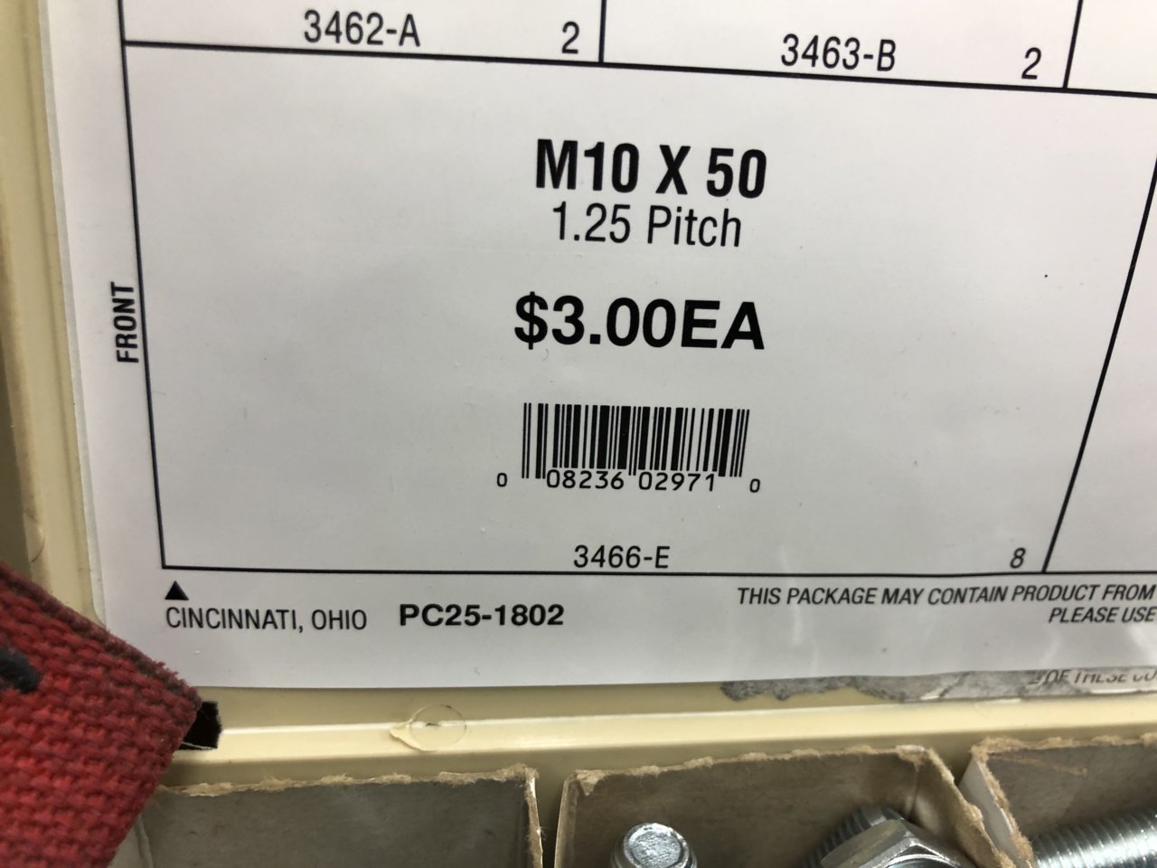

    1” Tacoma seat spacer install
    Headed to McMaster or local hardware...
    Memo to self
    Seat spacers
    X 4 (2 for each seat)
    Hex cap screws
    M10- 1.25 x 50
    1/2 x 5/8 x 1 steel spacer
    Tools
    14mm socket and 11/16 socket
    At local Ace Hardware
