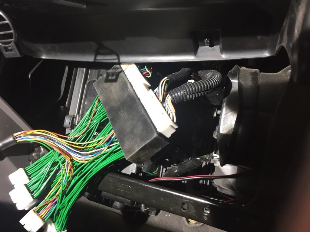

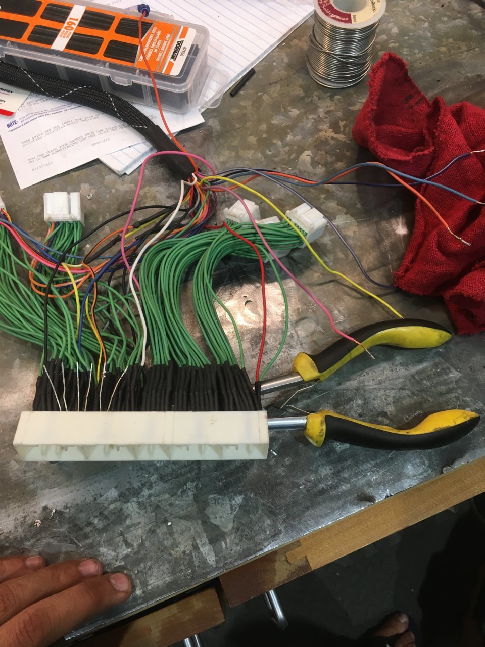

    Mine had no black box around the soddered wires, allowed me to pull it around 90 degrees (nevermind my soddering job, was converting from 2002 to 2000 pin outs)
    I plugged into the ecu first, then made it go at a 90 to the right, the hardest plugs to put in are the far right ones

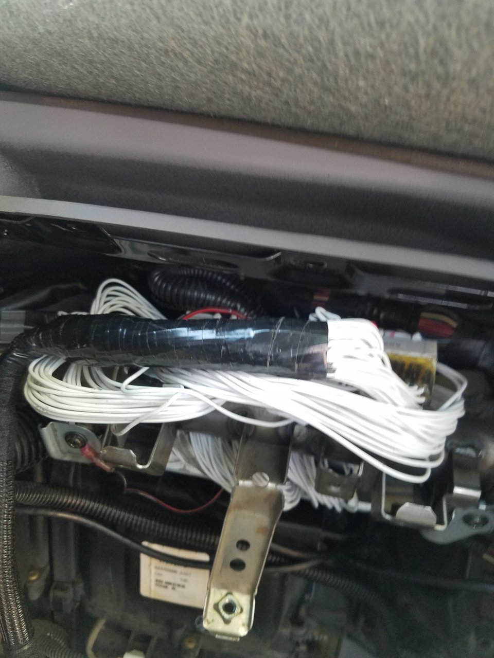

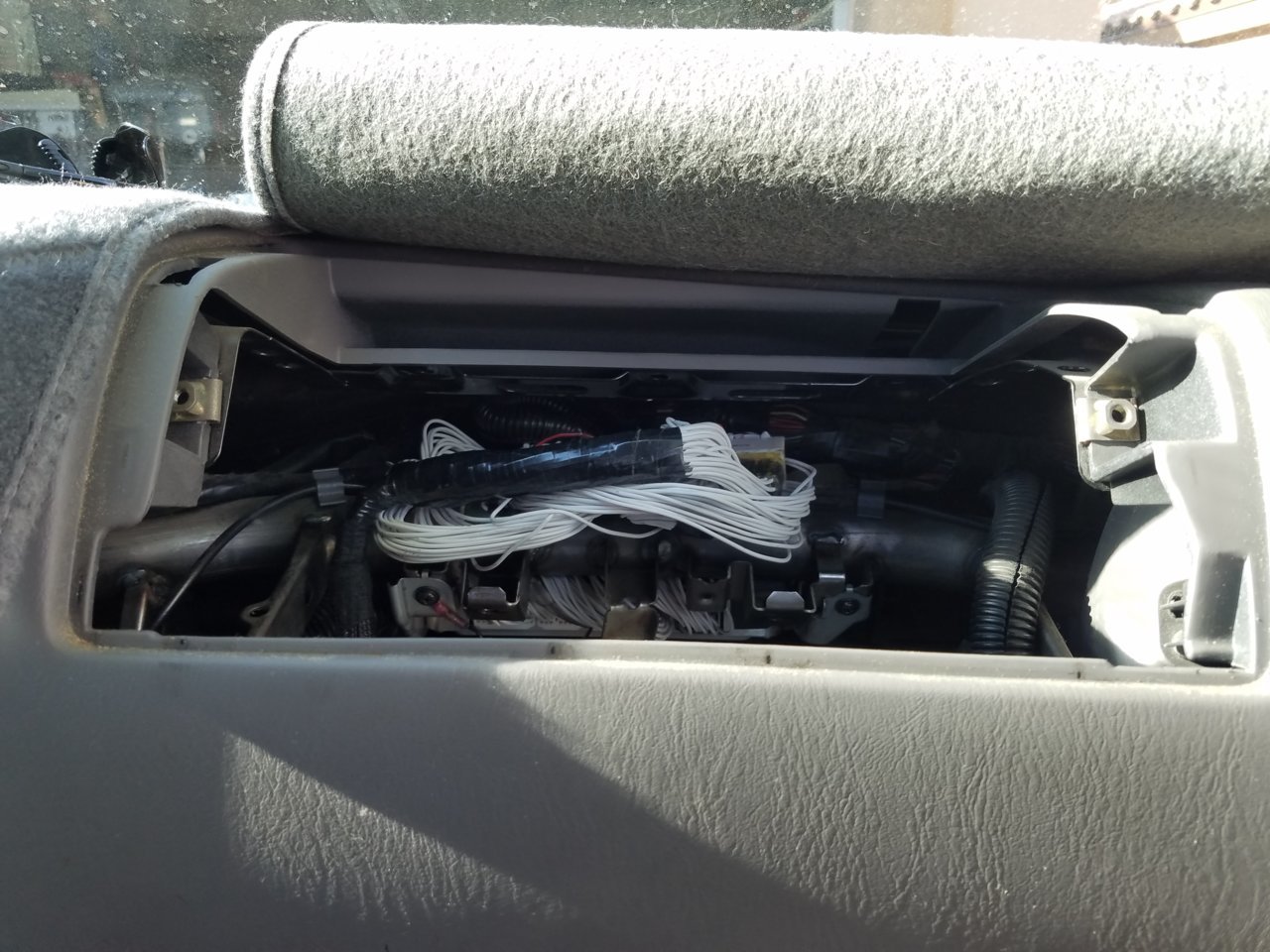

    @Rldanie ended up doing his like mine. It's a bitch to do but possible. You fold the harness back over the top of ecm.20200608_172606.jpg 20200608_172613.jpg
    Rldanie[OP] likes this.
