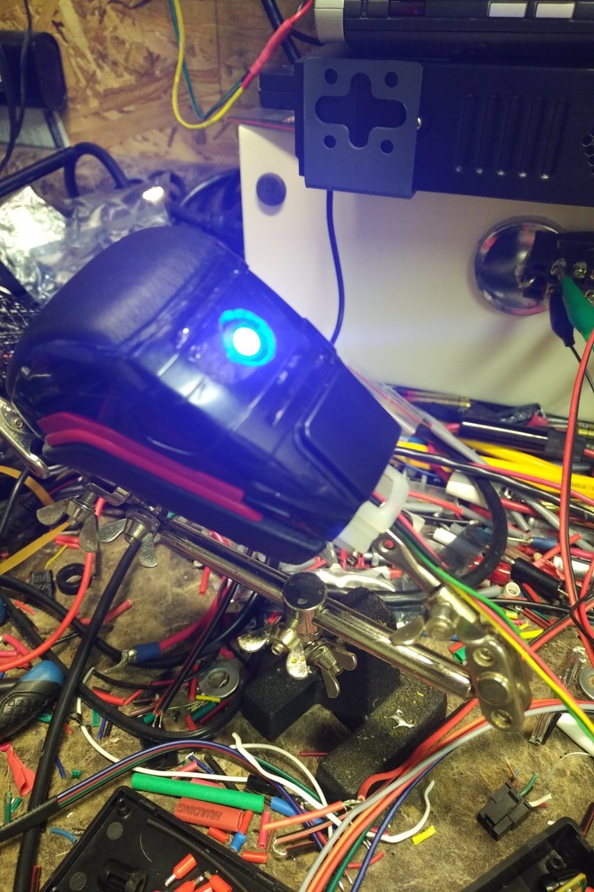

    If you wanted to control the light output you could connect to the illumination circuit instead of the 12v accessory wire harness in the rear centre console.
    I can make a single input wire harness but the cost is only $5 less. The idea of dual input is one input connects to the accessory circuit and the other can connect to the flashing security light circuit in the dash. That way the LED flashes when the truck is off.

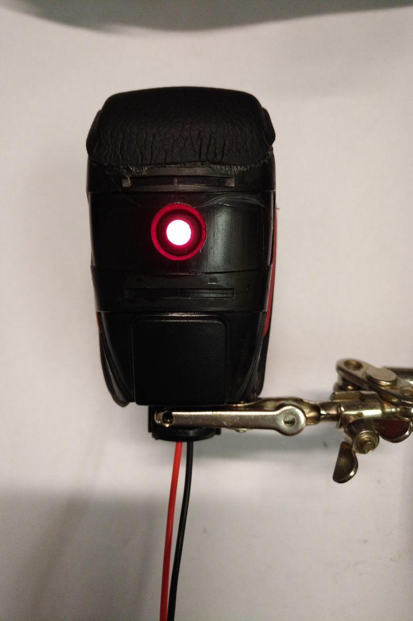

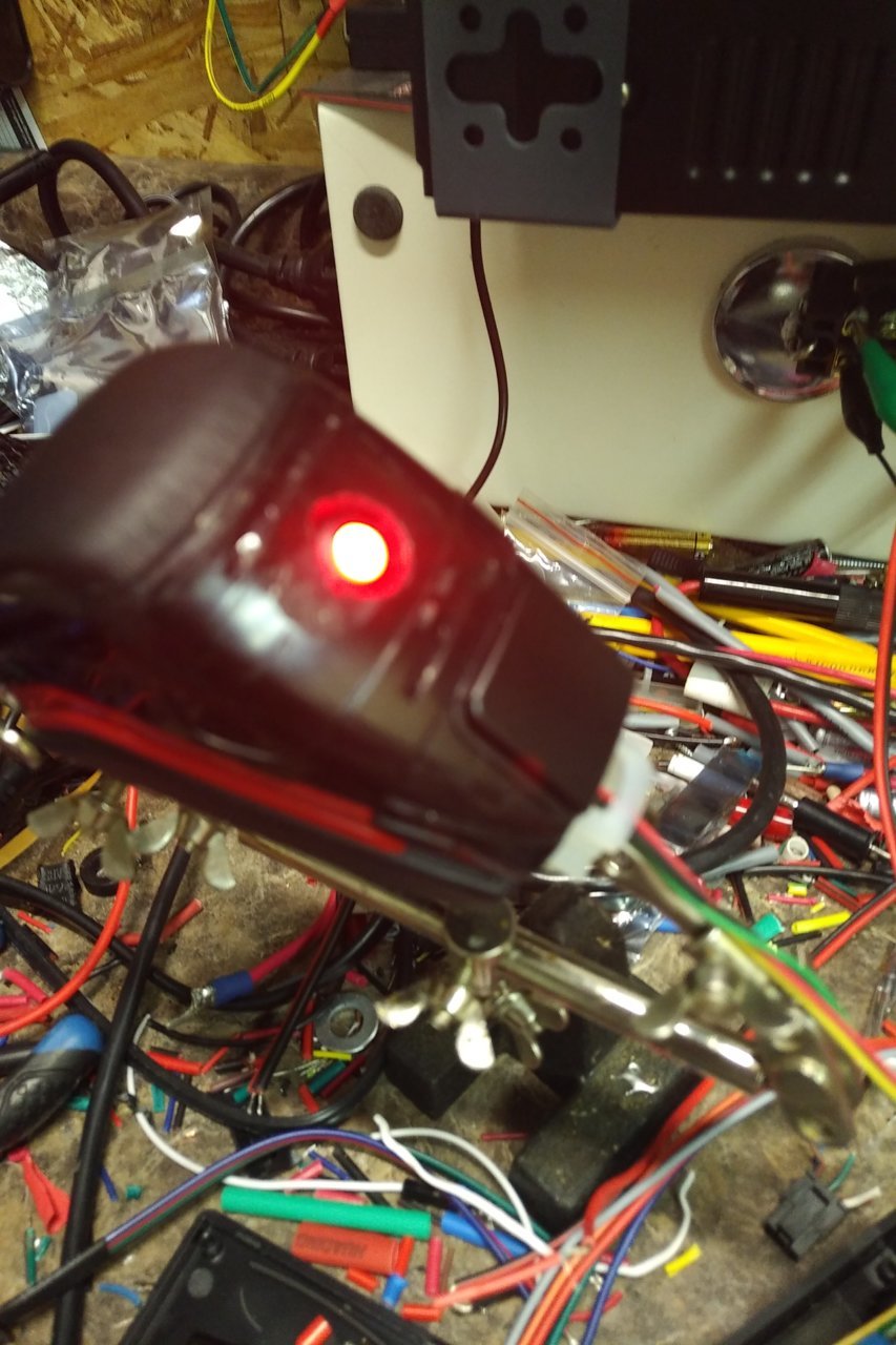

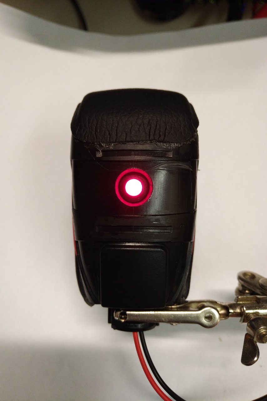

    This is an example in red.
    #1 input is from Acc circuit.
    #2 input is from security light circuit.
