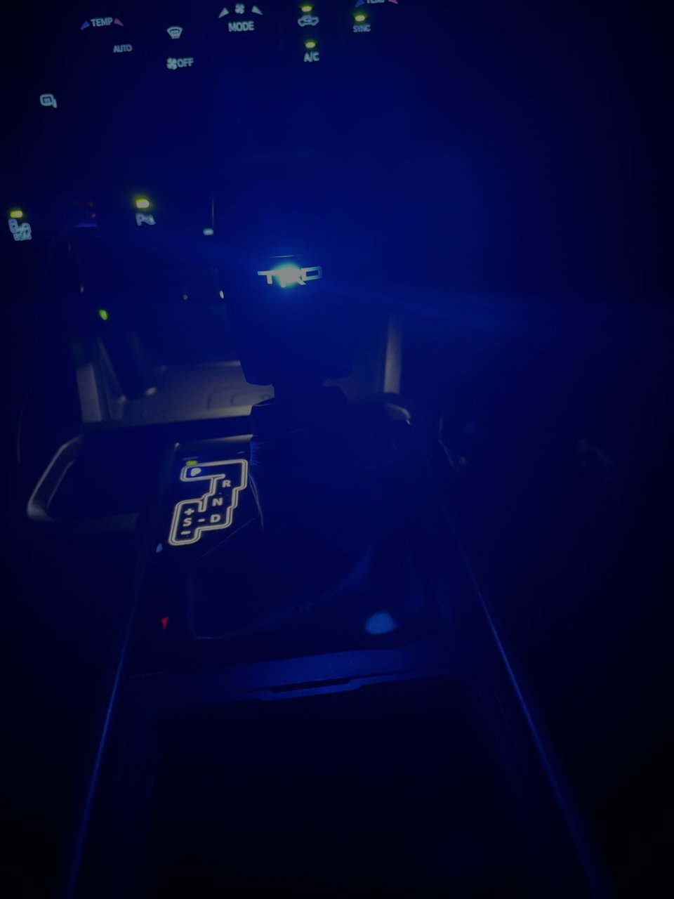

    Just wondering if the pictures are an accurate representation? It appears that there is a noticeable lighting hotspot on the "R" in TRD. I know that sometimes pictures can give a bit of a false appearance when it comes to lighting which is why I'm asking. I'm interested but also a bit picky about details so wanted to check about that. Didn't notice a light diffuser being used but I suspect it's an extremely tight area you are working in.

    The pictures were taken on my bench using an AC >>> 12V adapter so they may seem a bit over exposed due to poor lighting compared to the real world application in your vehicle.
    I use diffused LEDs which have about a 40 degree diffusion pattern but this is not maximized because of the tight spot the LED is located and the closeness the opaque TRD clip-in once re-assembled.
    The blue and red LED pics are actual installs while the white and green are just an dis-assembled "test" example. I still have to test a few different resistor values still to get the best output without creating a noticeable hot spot in the middle.

    To all those who have purchased my wire harnesses and complete shift knob kits already, I am going to do some experimenting to possibly widen the diffusion angle of the LED due to a concern that "Up2NoGood" had mentioned. If successful I will post a conclusion and revise my installation instructions accordingly.

    Another way to get even more diffusion is to point the led away from your lens, it will still illuminate but without the hotspot.

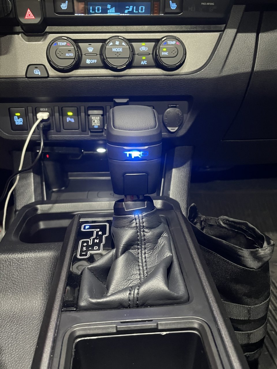

    Turned out pretty damn good! Thanks @oostroma!!

    Looks great!!! Just an observation, does shift boot not lock into the shift knob or did you just snap a photo after install?
  12. Mar 27, 2021 at 7:29 PM
    #52
    mwrood
    mwrood Well-Known Member
    Oct 6, 2020
    #343042
    1,030
    2021 Voodoo Blue TRD Premium Sport
    It does snap into place like normal. I’m just an idiot and forgot to do it before taking the picture. And I was too lazy to go out and retake the picture. Haha.
