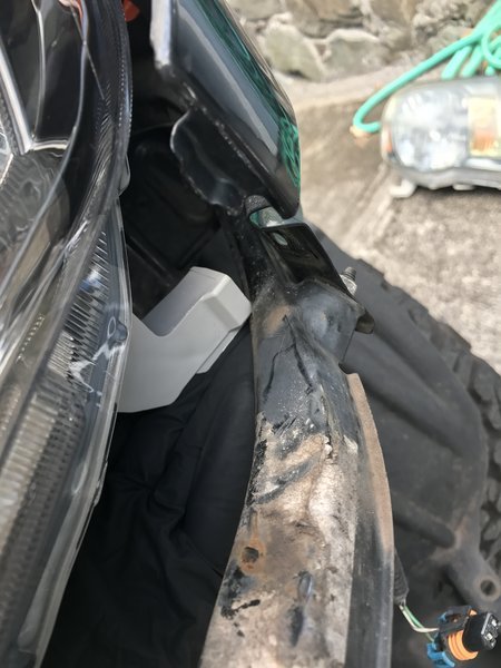

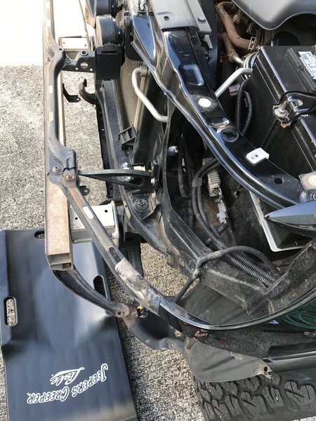

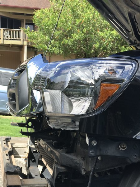

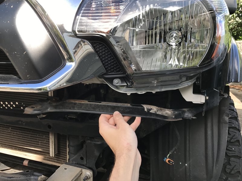

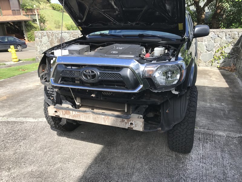

    Test fitting new grille (thanks @AugustaTaco) and headlights (thanks @Braunschwaga)
    Needed to remove the bumper extension bracket in order to get the headlight bolted in.
    For anyone doing the conversion with an aftermarket bumper, you still need new brackets that are listed in the conversion threads. The only one you might be able to leave out is the center bracket located in front of the hood lock support. But without it, you lose some stability to the headlight brackets.
    As you can see, '12-'15 brackets needed for newer style headlights to fit. Also, the newer bumper filler pieces will not connect.
    Removed bracket to test fit.

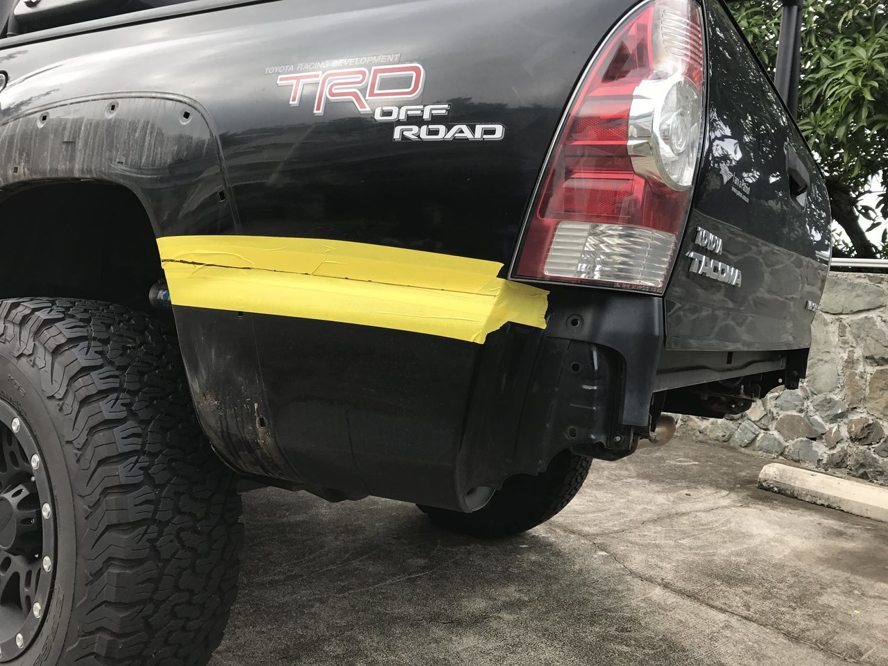

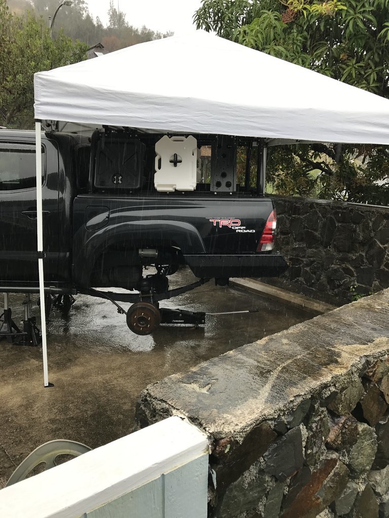

    Silly rain
    The next morning....oops!
    Getting ready to :sawzall:

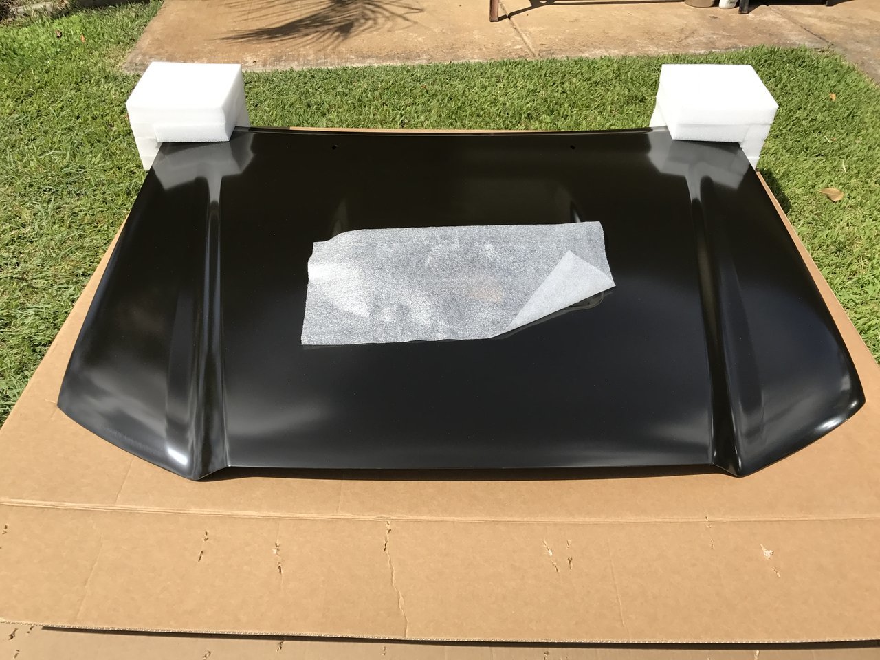

    Picked up the final puzzle piece to keep me occupied for tomorrow. 12'-15' hood
