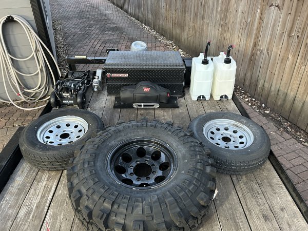

    Apparently I'm a glutton for punishment. I wanted to get a run around truck to help keep some mileage off of the tow rig. I found a pristine 86 XtraCab body a while back and a deal on a 96 Tacoma 3RZ 4x4. It has a slight CO lift, AALs in the rear, a set of new 31s, new radiator, plugs, wires and runs like a top. I'm going to use the Taco drivetrain and transplant the interior, gauges, steering column, dash and electronics into the 86 cab. Planning on running a set of Skinny 35" Interco SX2s on some Tacoma wheels that I had left over from my 02 Tacoma. Ill be picking up the 35/10/16 SX2s on the way back from the project I'm currently on. Should be a fairly straightforward swap (to an extent). I will more than likely freshen up the motor a bit while I have access to it easily. The Tacoma has working AC and Heat which is a plus. I may end up replicating the boost setup I'm currently building for the 2Rz for the Red Truck. We'll see..
    I found some frame dimension drawings for the 2nd gen truck and 1st gen regular cab. The front 4 mounts line up just about perfectly. The width between the frame may need to be adjusted outward a tad. I will have to figure out the frame extensions at the end after the body swap is done. It's only approximately 8-10 inches of frame extension in round numbers. Or, I will just build a custom bed depending on where the rear axle CL ends up. It may be a bit too close to the rear of the cab.
    On to the pics...

    The cross bars should line up with the braces on the Weatherguard packrat tool box I picked up. All the square tubing is 1.5” .25wt. I trimmed the frame rails back to align with the base of the tube bed. I’ll tie them together with some .25” plate. The risers are some 3x3 square tubing 2.5” line that I ripped down the center.

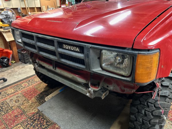

    New OEM grille and headlight buckets from a buddy.

    Got a little more accomplished. Found a set of Mastercraft seats on FB marketplace which I was sure that was a scam. I was pleasantly surprised. I didn’t get shanked and got them for 300 for the pair. Got a set of inner door panels from Flintstone Fab. Getting real close now. Not everything matches but oh well….

    It is going to have a Weatherguard pack rat tool box/Flatbed..
