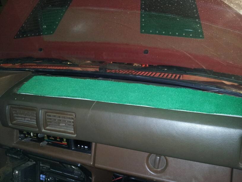

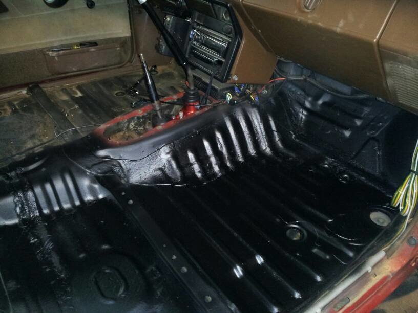

    Added some killer green carpet on my dash to cover up all the cracks.
    Started another layer of rustloeum sound deadener on the pass side.

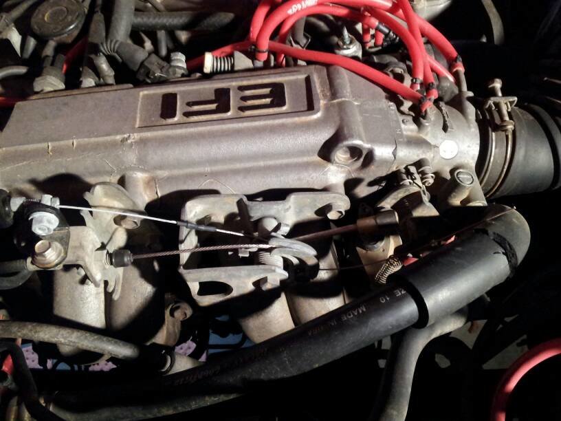

    Fixed my sticky hand throttle

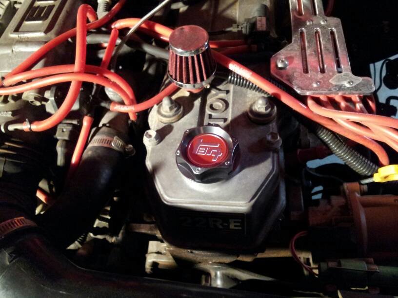

    Added a blingy TEQ oil fill cap

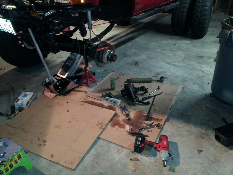

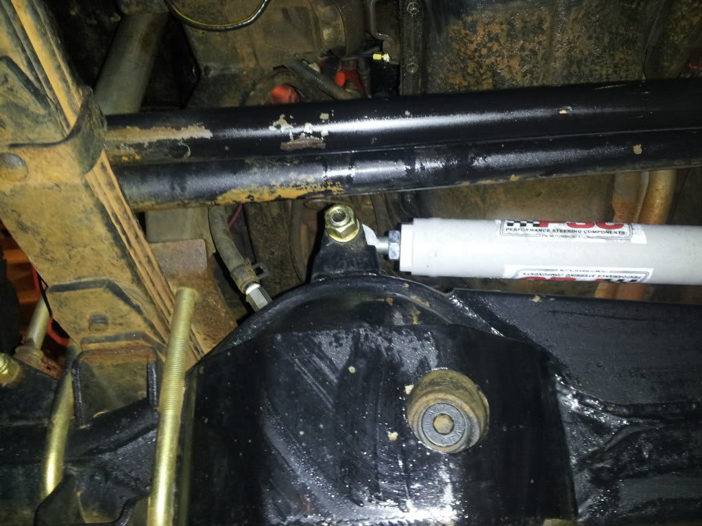

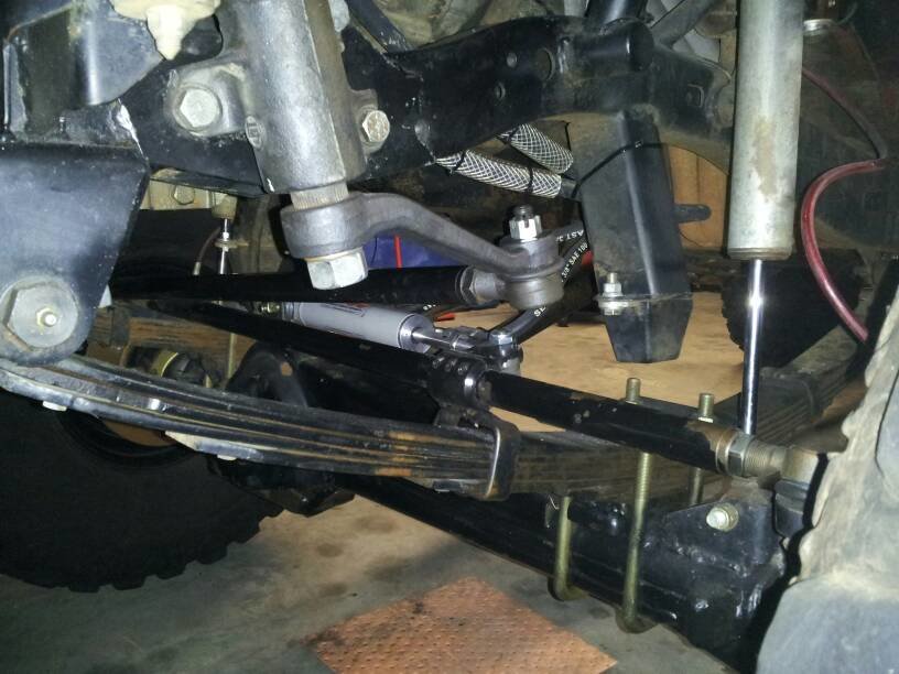

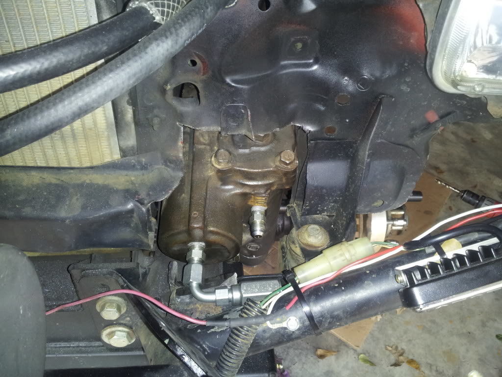

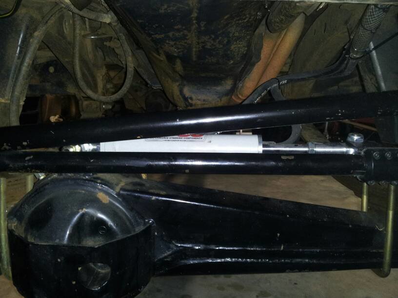

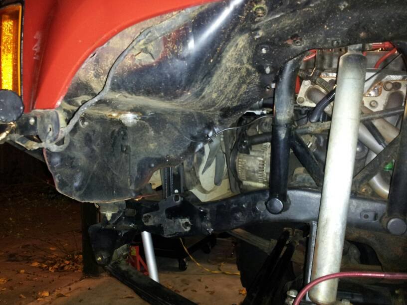

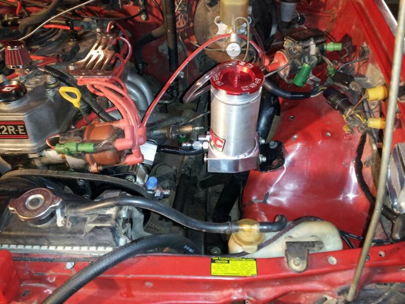

    New pump is in. Steering cooler is mocked up. Reservoir is placed where it should fit. I had to cut off one of the mounting points for the stock airbox to make it work. Steering box is off. Old steering stabilizer is removed. The mess is made. Got some royal purple max steer on the way from Amazon. Just need to pick up my other box in conroe. I need to figure out the low pressure feed line to the pump. Its tight. Other than that i have to finish it up if i wanna wheel.
    Pics

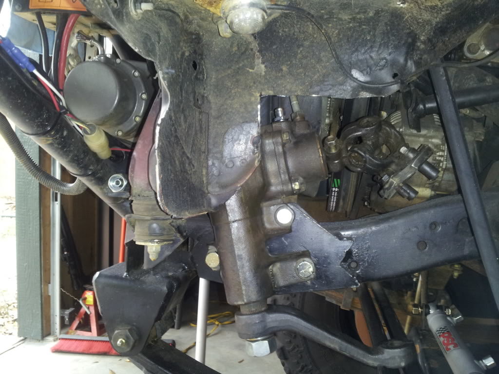

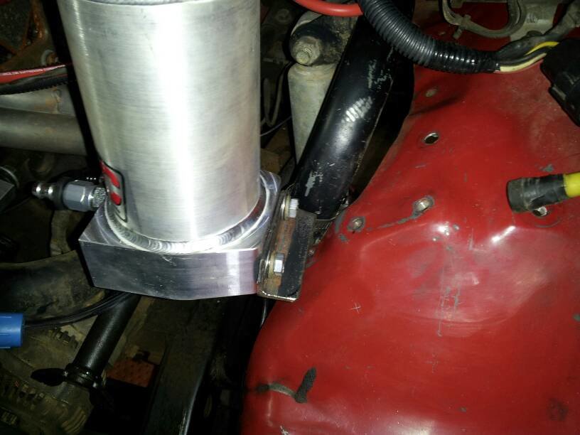

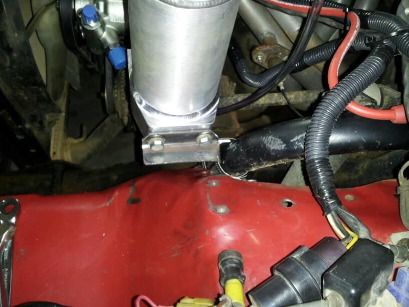

    I figured out a better mounting idea last night with a piece of 1x1 angle iron that will be mounted to the drivers side shock hoop. This added about 2 inches of clearance that was definitely needed. It will be temporarily mounted with a couple of hose clamps and welded on later. I need to take the edges off of the new bracket and throw some paint on it before install. I am waiting on 2 -10 90's to show up so i can start routing hoses.
    I also ripped out all the non working AC bull˟˟˟˟ since it was in the way. I have one hose left that is being a real bitch to get off at the compressor. I am capping off all of the connections under the hood for when I want to tackle the AC re-install if that ever happens.
    I started combining/untangling all the random wires and ran them the correct way away from heat sources/moving parts. I added some dielectric grease to every plug around the ignitor, main harness and other engine components.

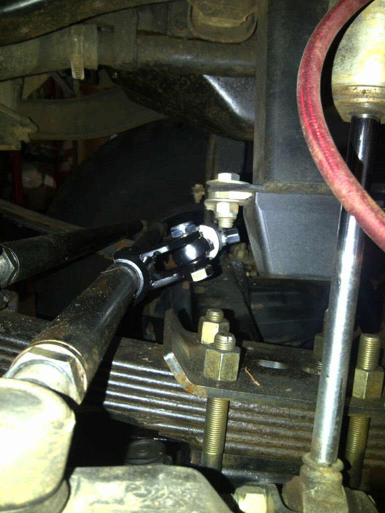

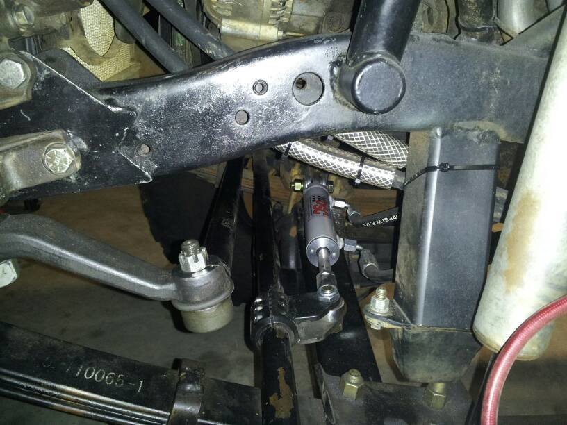

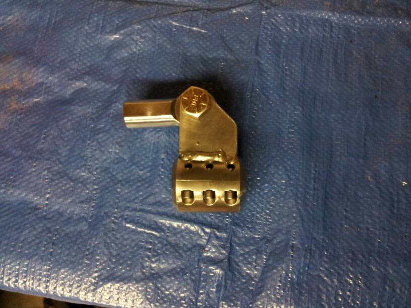

    I got the ram mounts welded to the Ballistic 1.25" tie rod clamp so that can be mocked up as well.
    Got the new steering belt on. I went with one that was an inch shorter than the stock length.

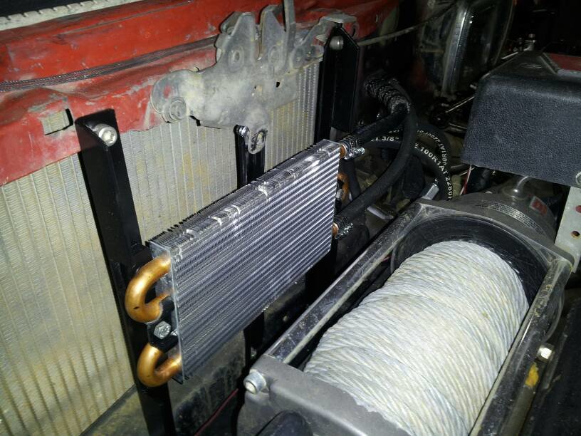

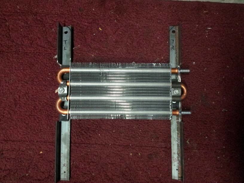

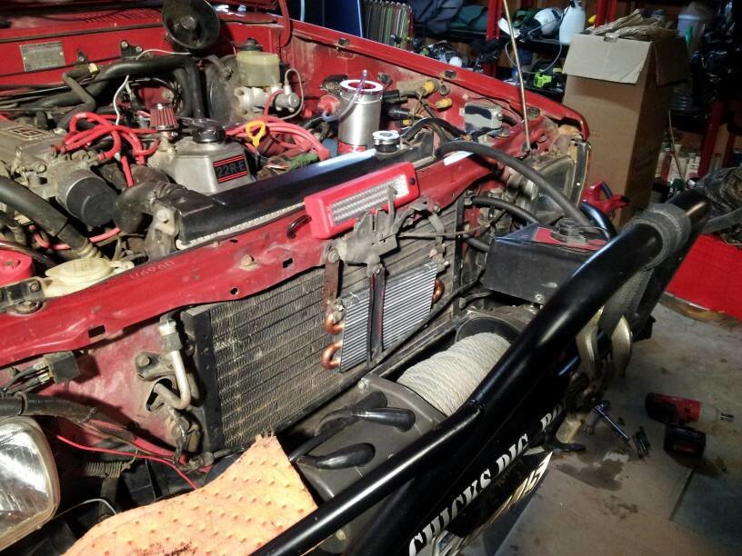

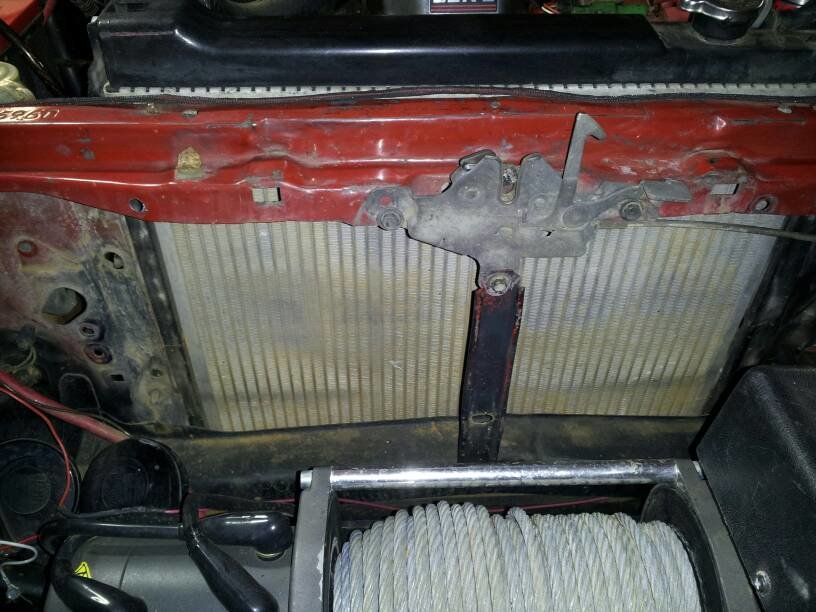

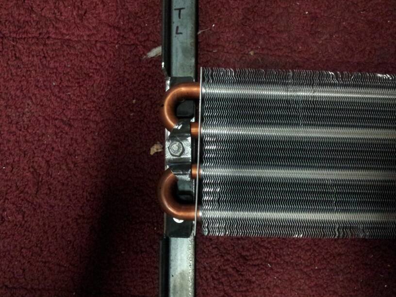

    I worked on my steering cooler mount a little before I left on vacation. I used the rubber spacers that came with the cooler, 2 pieces of 1x1 angle iron and 2 tubing clamps off the A/C system that I removed.
    Its a little tight behind the grill but it will work. I need to trim the back side of the grill a little. I had to flip the bracket around that goes from the lower core support to the hood latch. It bought me just enough clearance to mount the cooler.

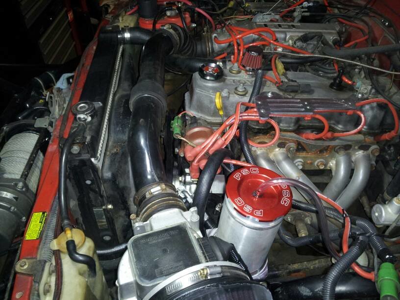

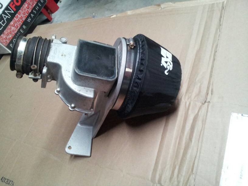

    Fixed my airbox clearance issue with some LC Engineering bling
    Pretty solid kit and CARB approved for those who need it.

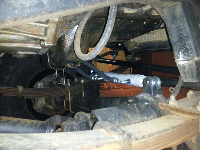

    I also stared at these a while and wished I was at a point where I could install them.
    I got the OK for some PRP seats and a 4xInnovations cage due to the fact that my Tacoma is paid off as of this month. Damn I haven't been without a truck payment in a long time.
    Picked up some new fluids

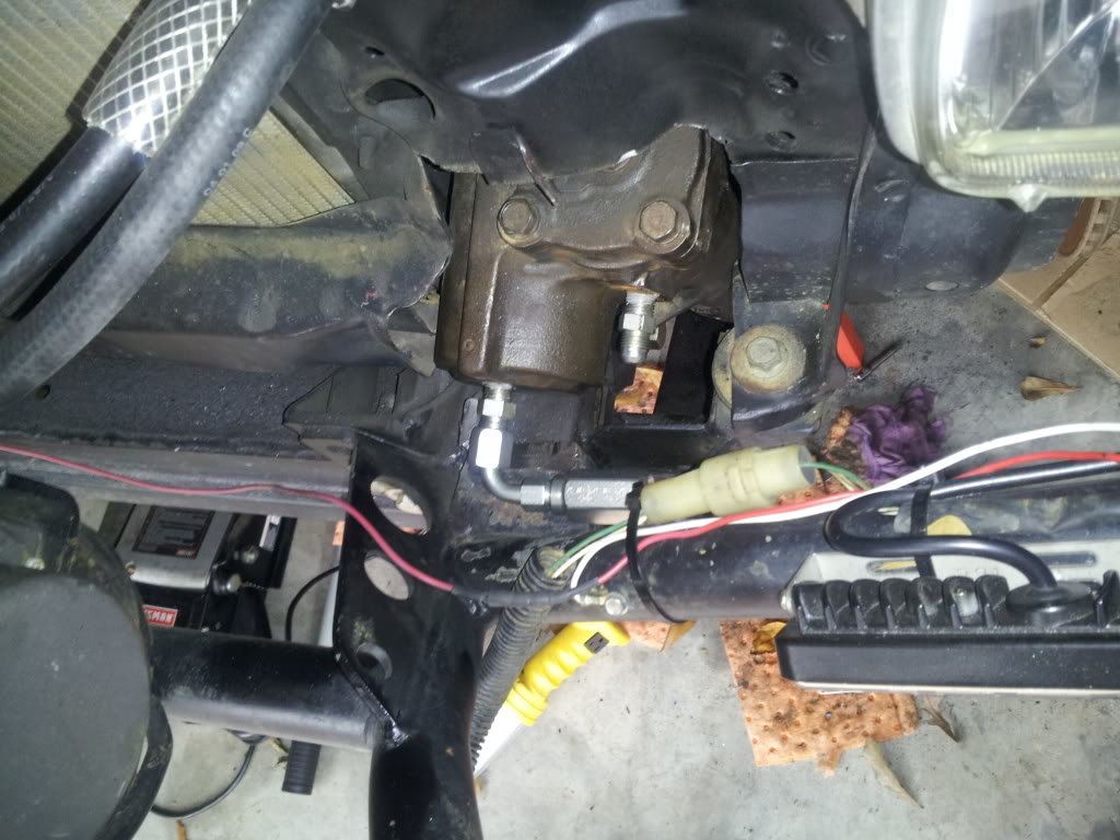

    I chopped on the core support a little more for the steering box
    and mocked up the Ram

    Everything is in place to get the final hose lengths figured out, cut and made up. Then I need to connect the steering shaft, fill her up and start bleeding the air out of the system. I installed the cooler last night. Just about ready for a test run.

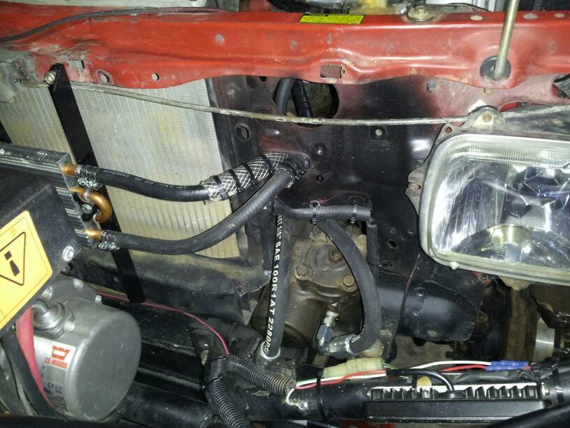

    After messing around with this project for a while, I finally got the hydro assist wrapped up and ready to fill.
    Looks kinda tight.
    Cooler in place. The bracket for the latch support was flipped around 180 degrees to make a little needed room for the install.
    I had to chop out a little of the front core support. I used some 3/8 fuel line to put on the sharp edges and zip tied them down. I also used some scrap hose to keep the cooler lines from getting cut.
    Now I just need to fill her up and bleed the system. Hopefully that will go well.
