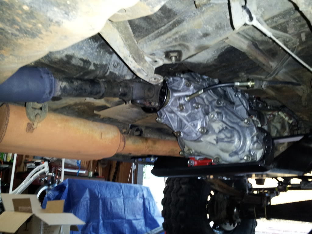

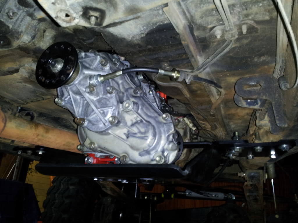

    Made a little more progress last night and averted 1 small disaster.
    Put these
    On this

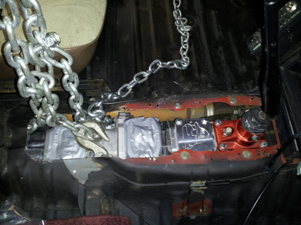

    I got the stock tcase loose and almost dropped it on my head. I'm a moron. Got it back in place and will lower it tonight with an engine hoist.
    Then I will clean up underneath and change out the transfer seal.
    I found a place to mod my driveshafts local in my Hood for about 80 bucks.

    So sweet. Glad you didnt die dude! You think i could get my case out with a buddy helping, or should I get a jack/hoist?

    If you have help it can be done without a hoist. I was working solo.

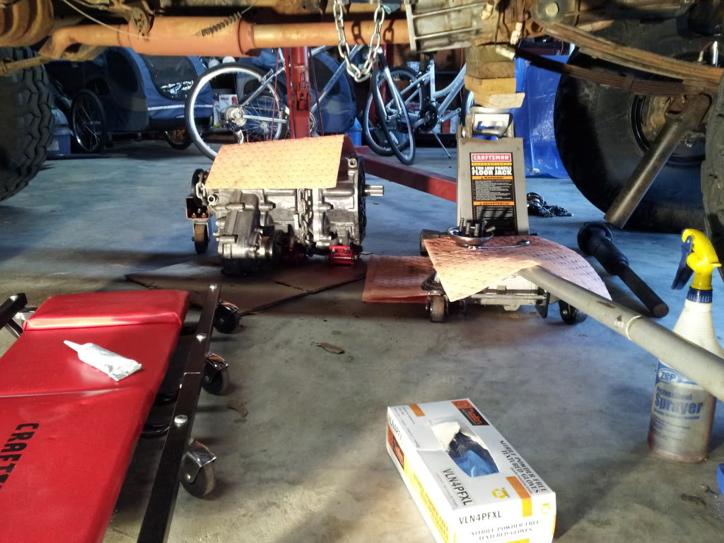

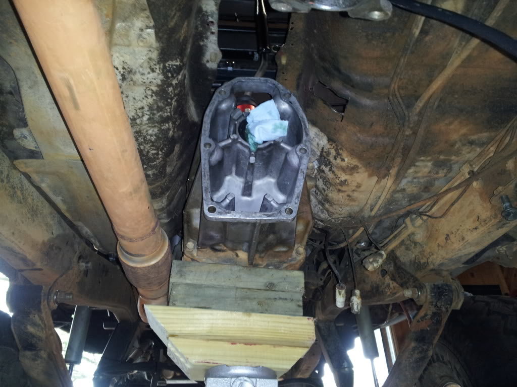

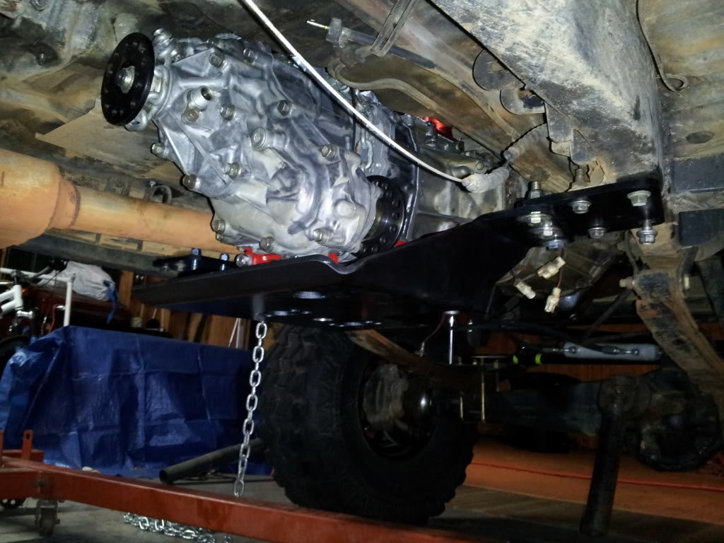

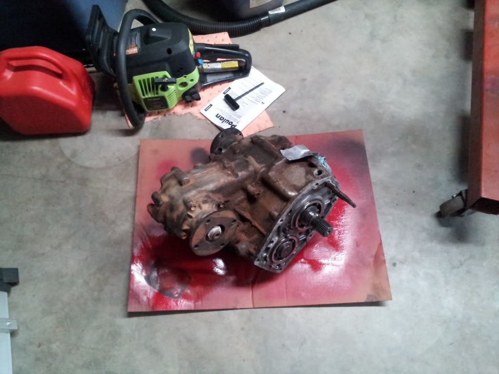

    Got the TC pulled this morning.
    Drilled a whole in the crossmember in order to drain the crawlbox through the adapter.

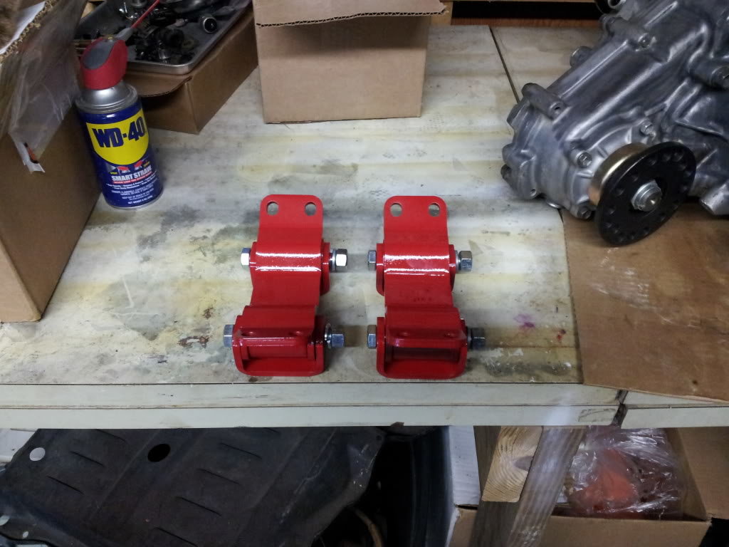

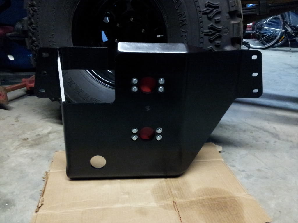

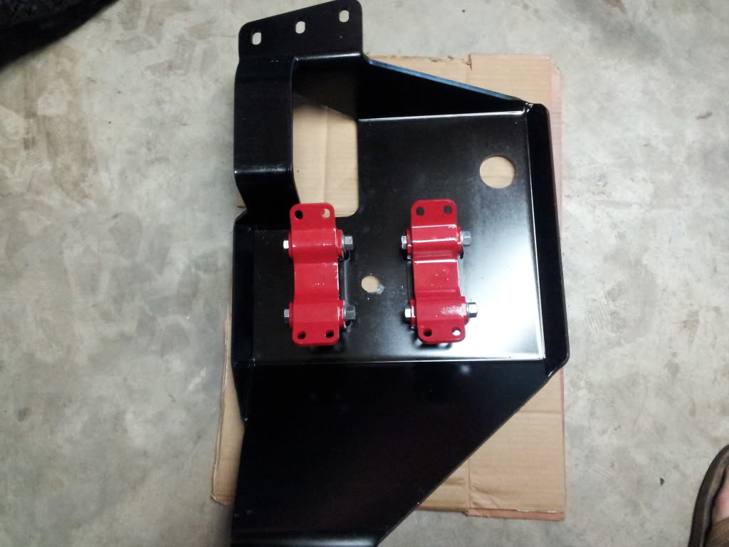

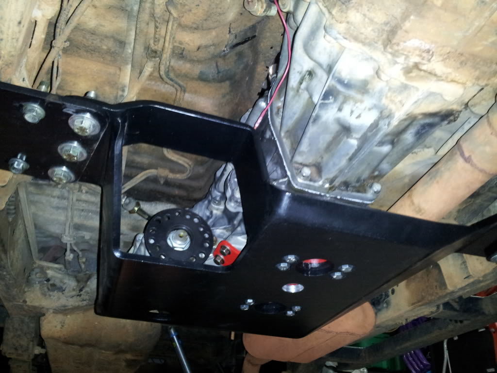

    Got my duals bolted in tonight. I need some different bolts for the crossmember to finish it up.

    I get it buttoned up tonight. I think I have the fasteners covered now. Off to the driveshaft shop Monday or Tuesday of next week.

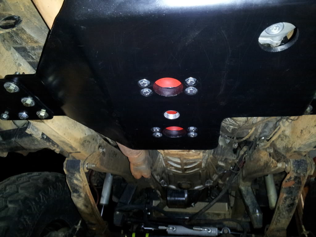

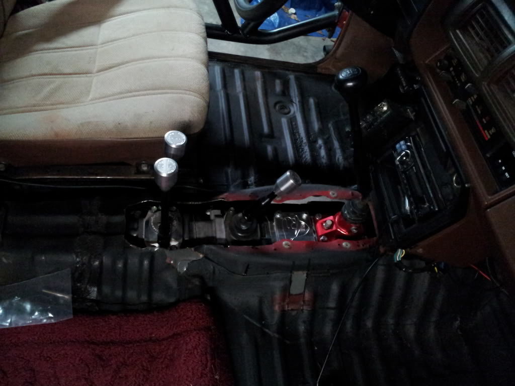

    Progress for tonight.
    Got the speedo extension and extended the 4x4indicator wire.
    Everything else buttoned up.
    Getting driveshafts next week.

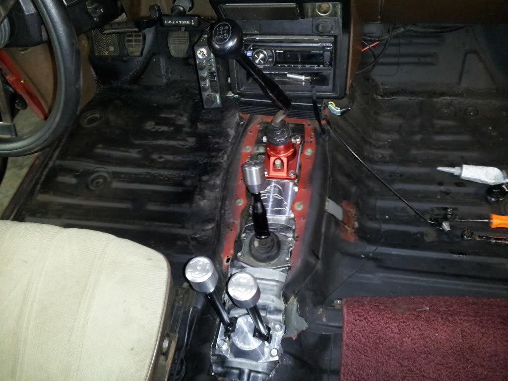

    Looks great :thumbsup: I'm in the middle of doing mine right now, and I was wondering how much do the rear shifters move when you shift them into gear

    The 2wd to 4wd shifter has a fairly short throw. The rear high/low has a little more due to the fact it can be in 3 positions.

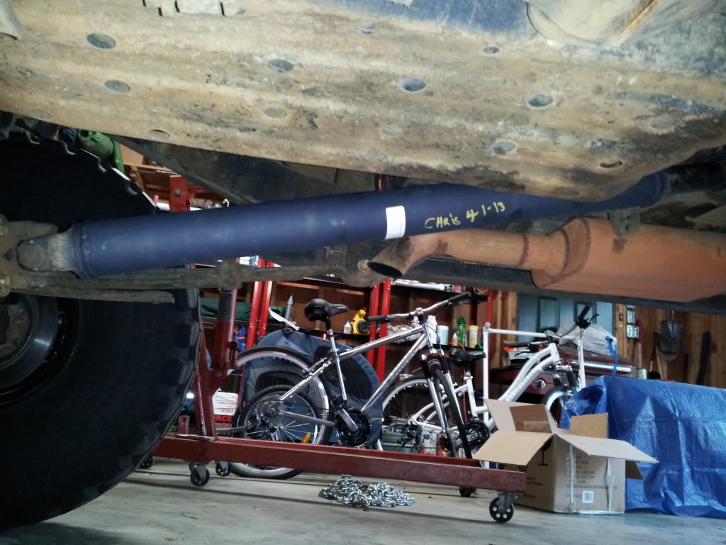

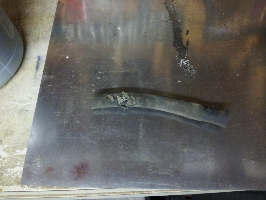

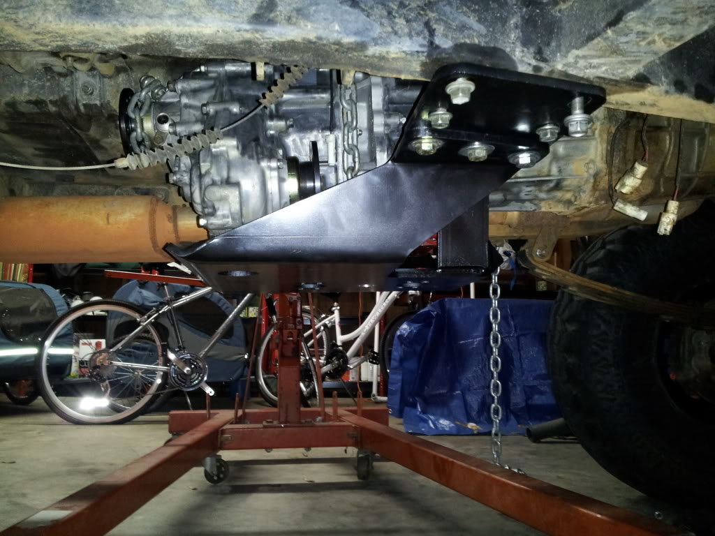

    Got the rear driveshaft picked up and installed.
    Fixed a hole in a fuel return line.
    Filled up the transmission with some Mobile 1 gear oil.
    Most importantly started the truck up easily for once.
    Hopefully I will have it at Dave's for the cage by the end of this week.
    Edit: the pics show the crossmember incorrectly bolted up. It mounts above the outer tabs not below like the pictures show
