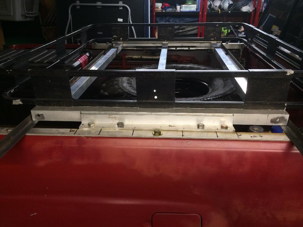

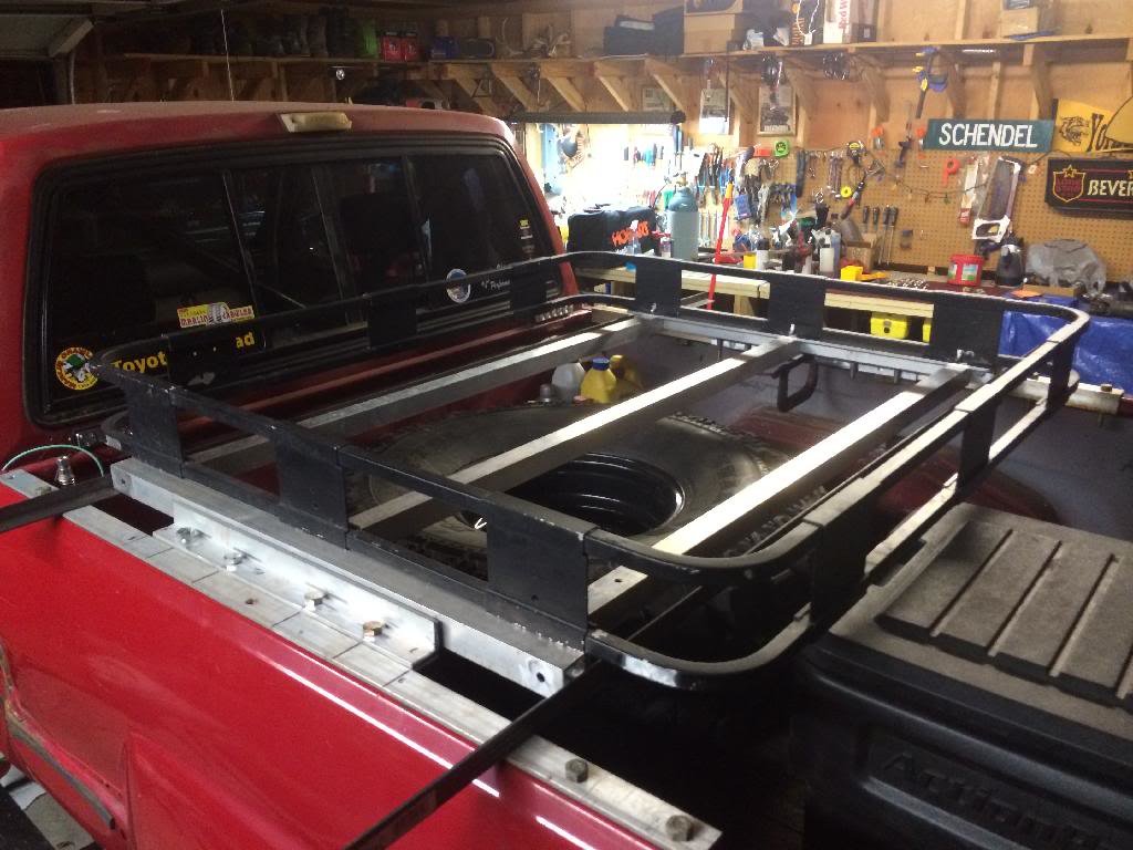

    I have been working on a set of sliders and my bed rack. Once I finish those up, I will try to get this thing bobbed before Jambo hopefully. Swamped with work right now which isn't a bad thing. Just sucks for working on the truck.
    Here is the progress on the bed rack
    CA400CBB-E7B8-4323-942B-6DD95CFB2E3B_zps_19397571b726cbfa4977d837d1511217036d7db5.jpg
    603B91D7-333E-44FC-A01C-946C6E9367E7_zps_e7f8867c9f5ca336c0c7260dfa58ec71dfd171ad.jpg
    I kept it forward enough for the bob whenever that comes.
    I just need to drill a couple more holes and put the floor in the rack/paint.

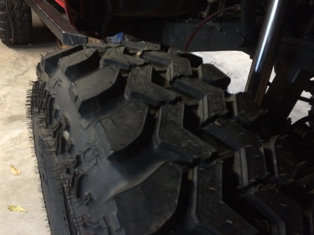

    Forgot to add I found 2 brand spanking new 37's on CL a while back. Pick both of them up for the price of one. I got these mounted up and replaced my chewed up front tires.
    E9BEACCE-980C-4453-BC5C-069DAD1701E1_zps_1bec57ad4474c6fc5acc73a5db84c43061341c1a.jpg
    Now I have new rubber all of the way around and 4 spares

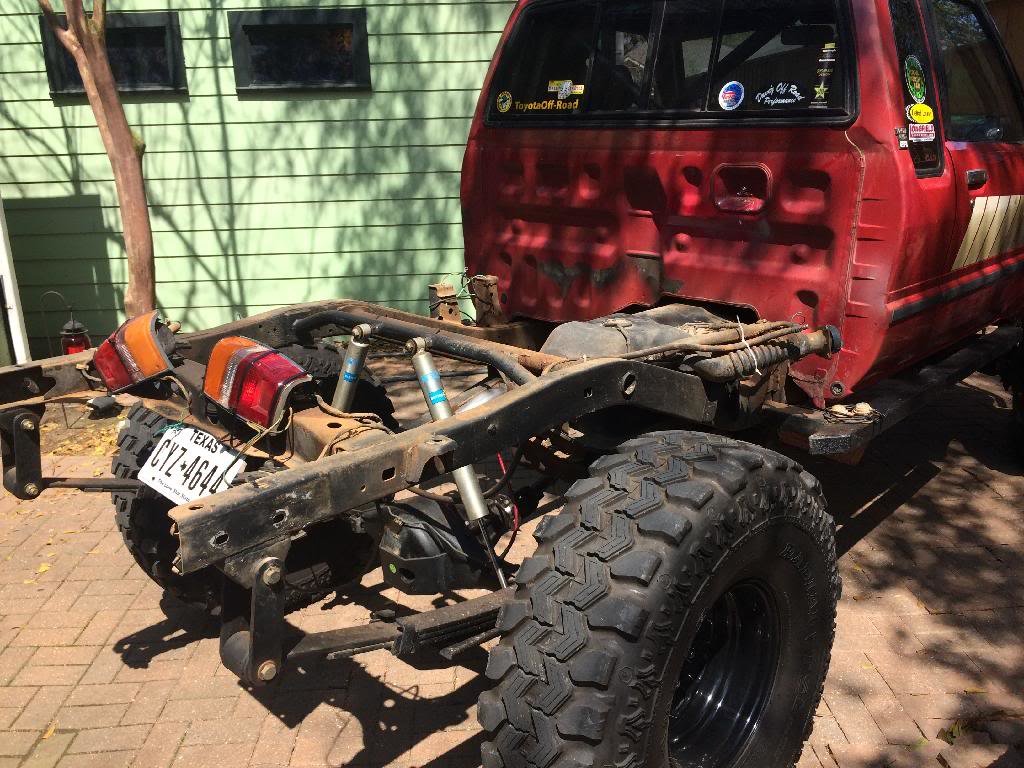

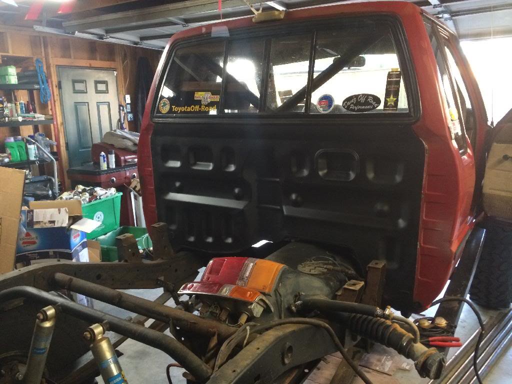

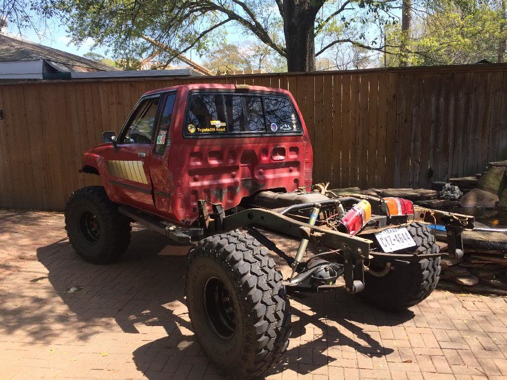

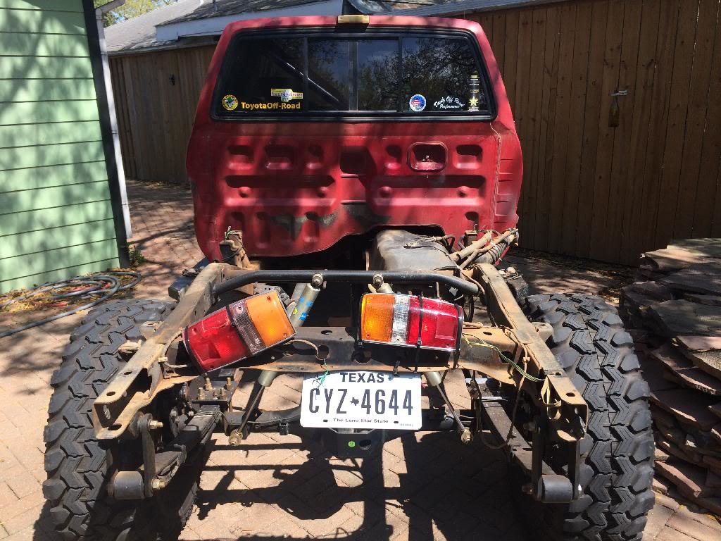

    Well I officially have a truggy. Swung by My buddy's and dropped off the bed.
    F2A1716F-E5B3-4EEF-A0B2-5041D10D8992_zps_a99c2bc12990f9f1578ea1e8f1b12748186669b9.jpg
    DC9AC610-3F03-4FCC-BFED-6798262F1CE4_zps_5651623842a7e885d1865ba9d681b9fb27d96aa6.jpg
    9A4BBAA4-33E4-488A-A208-57D261FBEDC5_zps_5ebaead6b369d482ba63e35508ab97c1b4a3742a.jpg
    Cleaned up the rear of the cab with some rustoleum bed liner.
    Also pulled the fuel sender to see if anything was prohibiting its proper function. Nothing. Probably need a new sender.
    Pulled the fuel pump assembly and replaced the fuel pump with my spare since the original pump didn't sound healthy. Seems to run better with the new pump.
    939067A5-4750-4A06-BB07-85DA692A49BB_zps_d15caa90a9abb4de6ebb5afff32585b776a1e87e.jpg
    Just waiting on the bed to show up so I can get it installed this week.

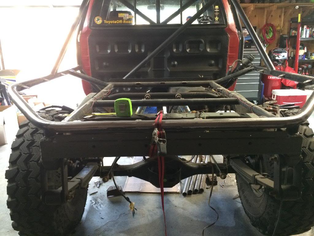

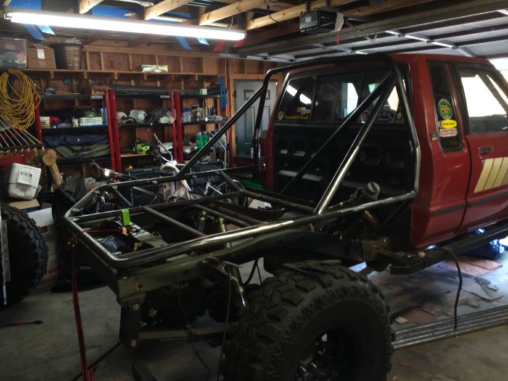

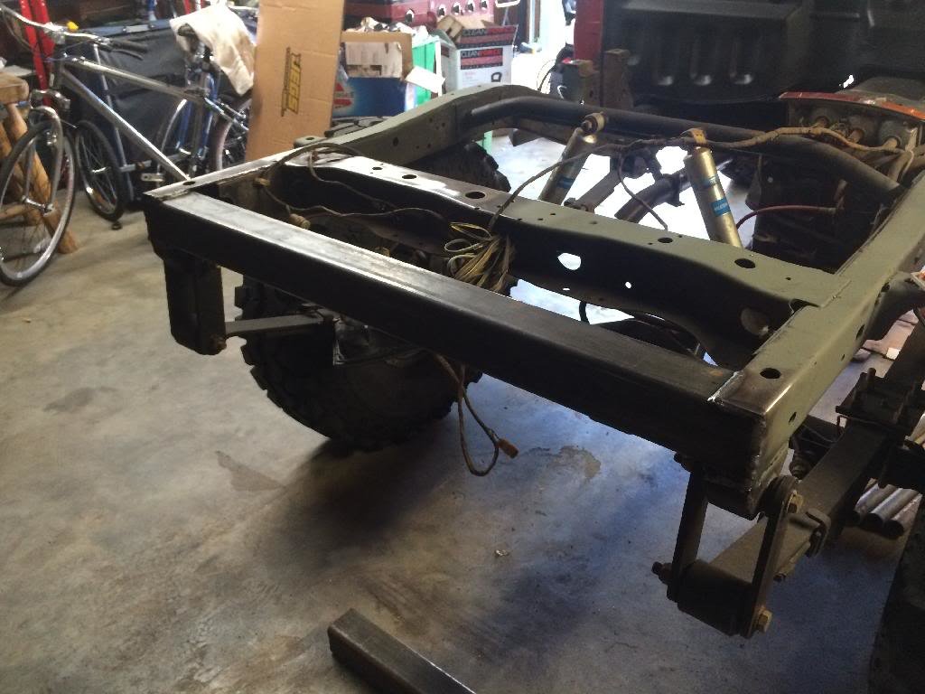

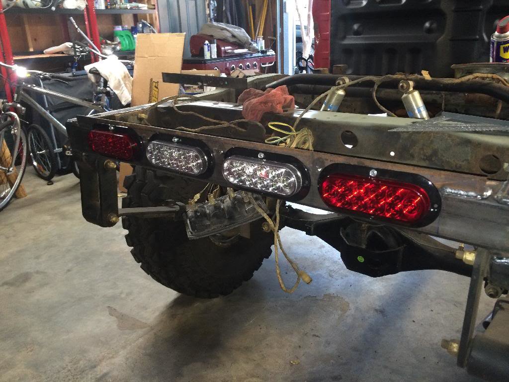

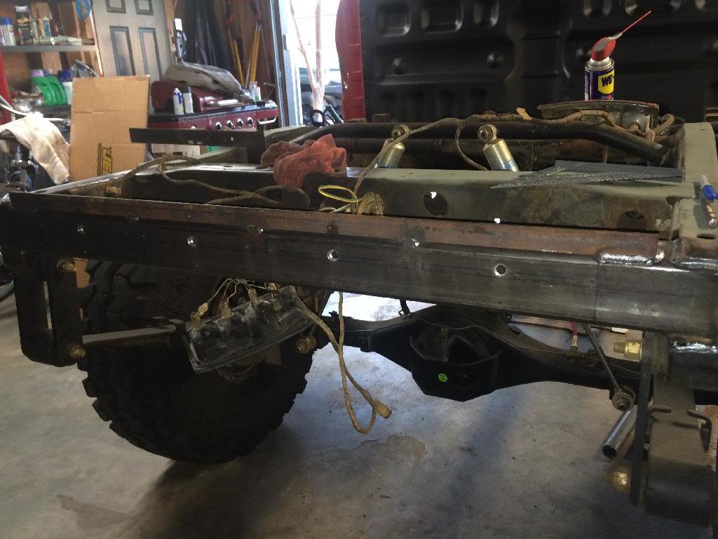

    Got started on the rear crossmember. Chopped off 2.5 inches of the frame that won't be needed. Added a piece of 3x3 .25wt square tube and burned it in. Had to add a piece of 1x1 angle to the top to use all 4 holes to mount the lights. Stabbed the lights in to see how well my hole marking and tape skills were. Just need to figure out the wiring now.

    Wiring will be the final step. I am pretty sure I got it figured out.

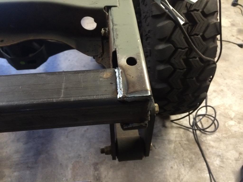

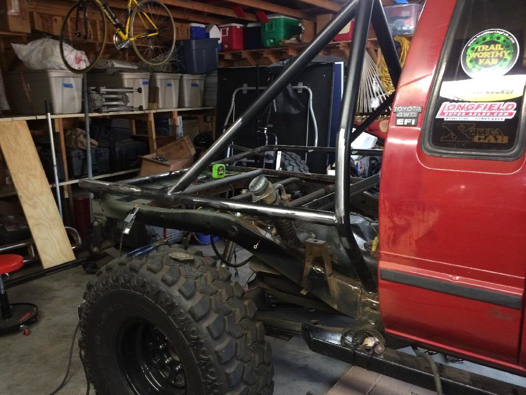

    Picked up the bed this afternoon. Did a little fitting and trimming and got it welded on. I have to say my little Hobart machine is a workhorse.
    97A57D45-A2AF-4A51-B240-6814605579D3_zps_097be6c39bb1a31262375df9eddf1f86727b7e63.jpg
    D928C449-E004-43C6-B507-552E4C64ADBB_zps_03bd5d31bb6a9bbdad7b16d3c8f1fd9a48b7face.jpg
    CF55A5CC-F107-446E-8E36-A3E1C51974DA_zps_456b46569103649641b2ca8f2bedadfde050b13b.jpg
    Everything went on easily since we cut the mounts off flush with the frame.
    Now that the hard part is done, the little tedious chores begin.
