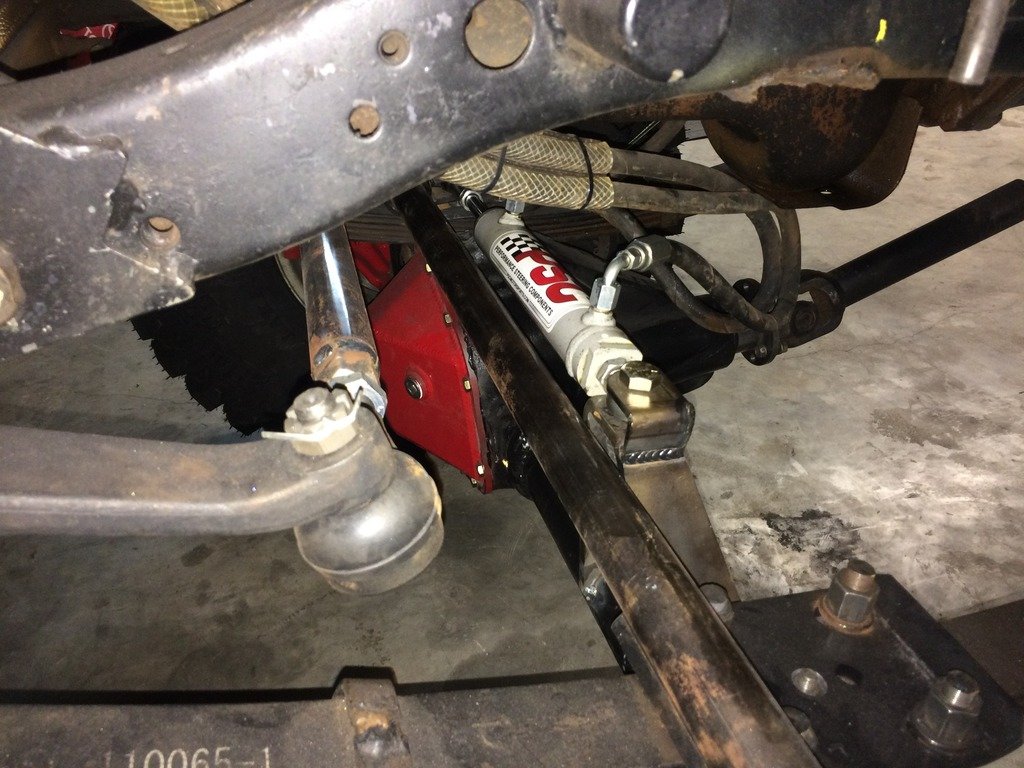

    Got a little accomplished tonight.

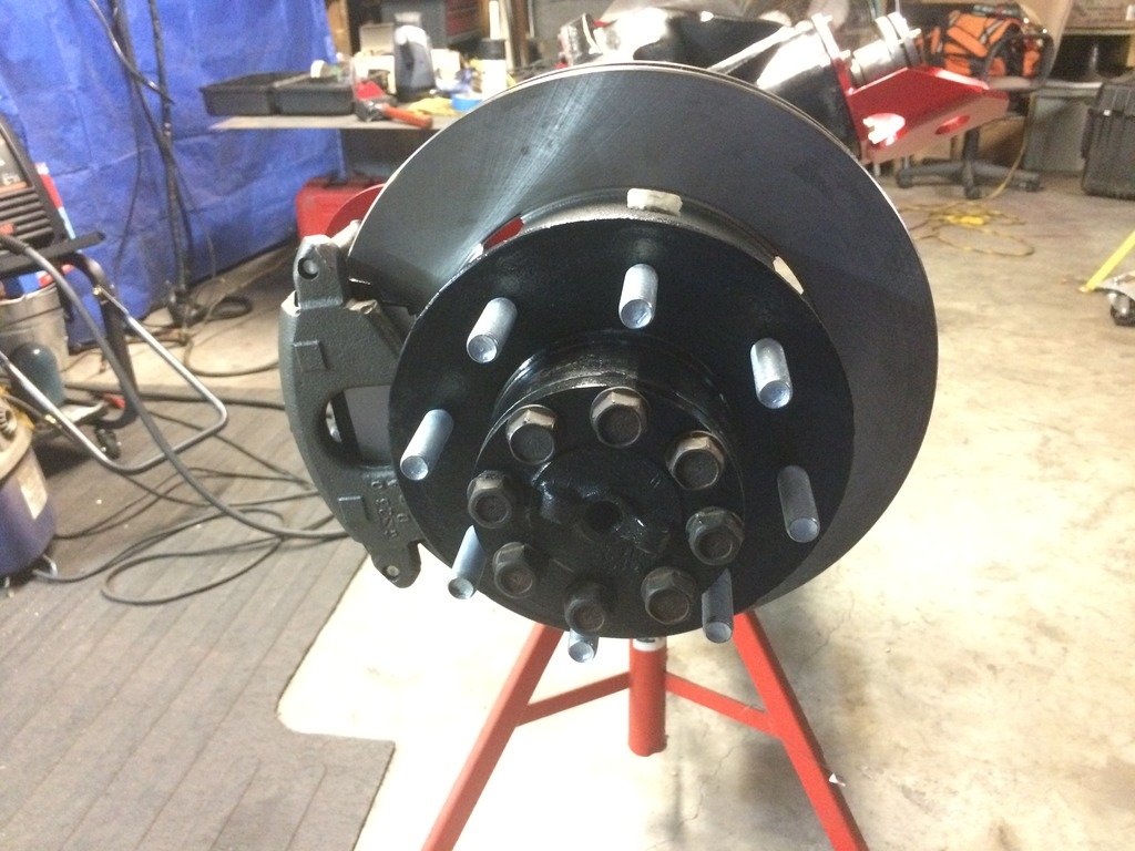

    New pitman arm with the Chevy DL taper installed and centered up fairly close. I finished drilling out my front hanger with a dull as drill bit. Had to do that to prove a point to myself and I wasn't spending 20 bucks for a bit I was going to use once. I got my hydro assist mocked up and disc brake brackets installed akin with the spindles. Just waiting on my wheel studs so I can finish assembling the 60.

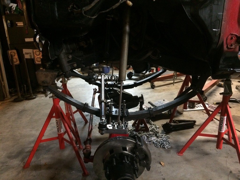

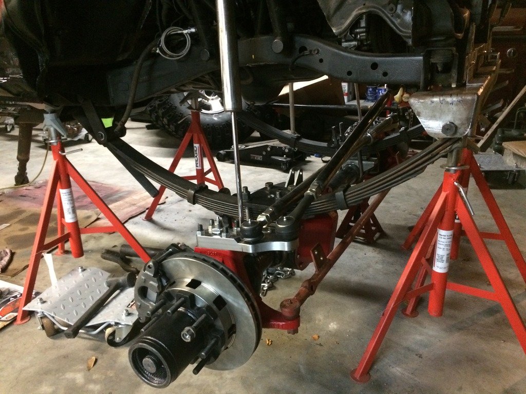

    I got the 60 mocked up last night. I'm still going to move the front hanger back another 1.5 inch. Axle is at full droop as of right now. Everything clears except for the tie rod being extremely close to the pass side u-bolt and nut. I need to trim the u-bolts on the driver side since they are way too long.

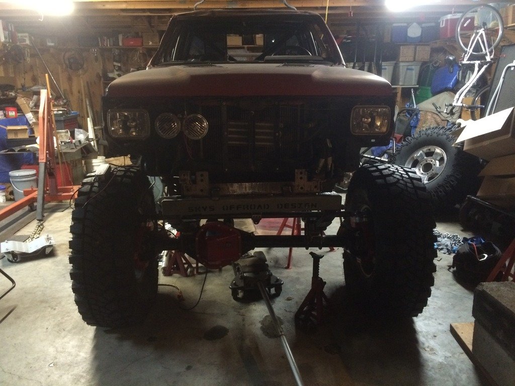

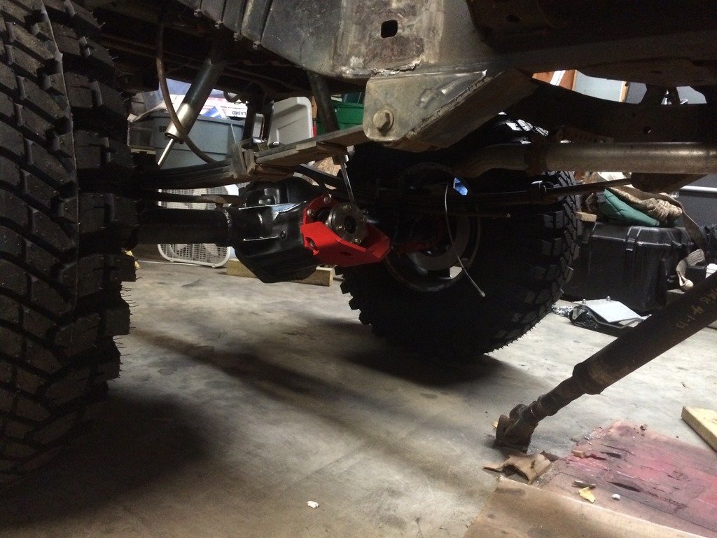

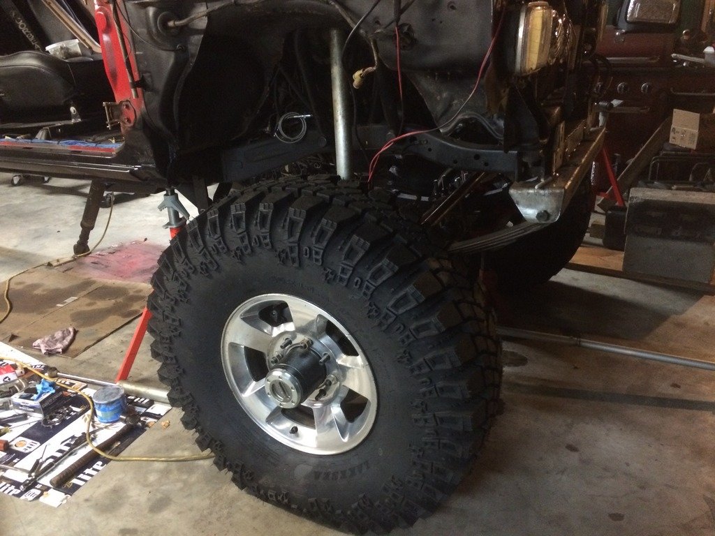

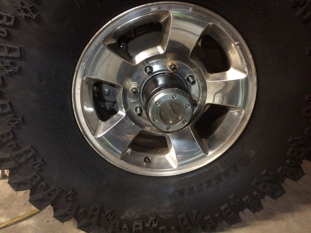

    I installed my Yukon hubs tonight and got the tires put on the front end.
    52178FB8-8B62-4B58-95DF-1528E43538A7_zps_ed30c90bf2634ca6799463ada6c05f7384d1ed02.jpg
    FB023E48-CD7D-4E01-93C7-9625A6EFCEF6_zps_743ce3698ff46ce6db592b40ded405adb835a77a.jpg
    71EC49D9-EF49-467A-91CA-6B9D789696DE_zps_3658c43ac1bb7dcdc9f7cec44d7f525728c45a9b.jpg
    Front end is right at 78" wide .

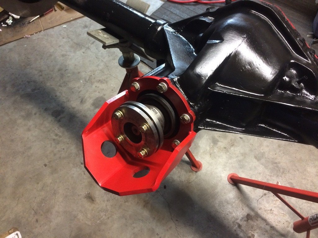

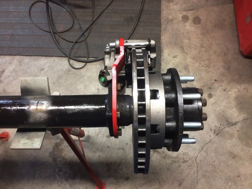

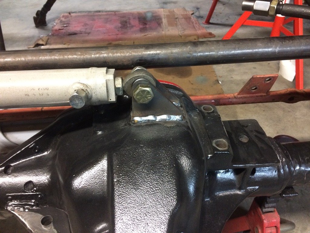

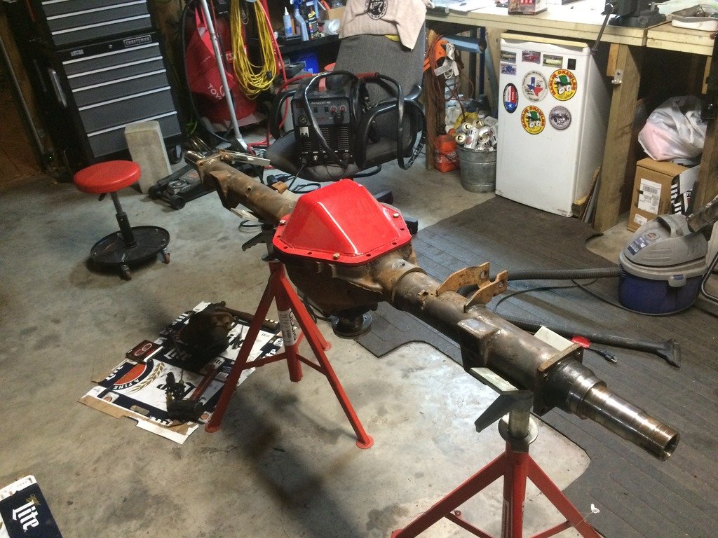

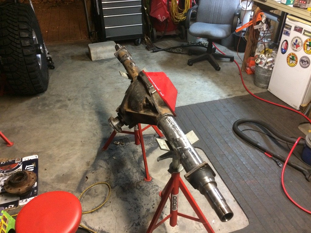

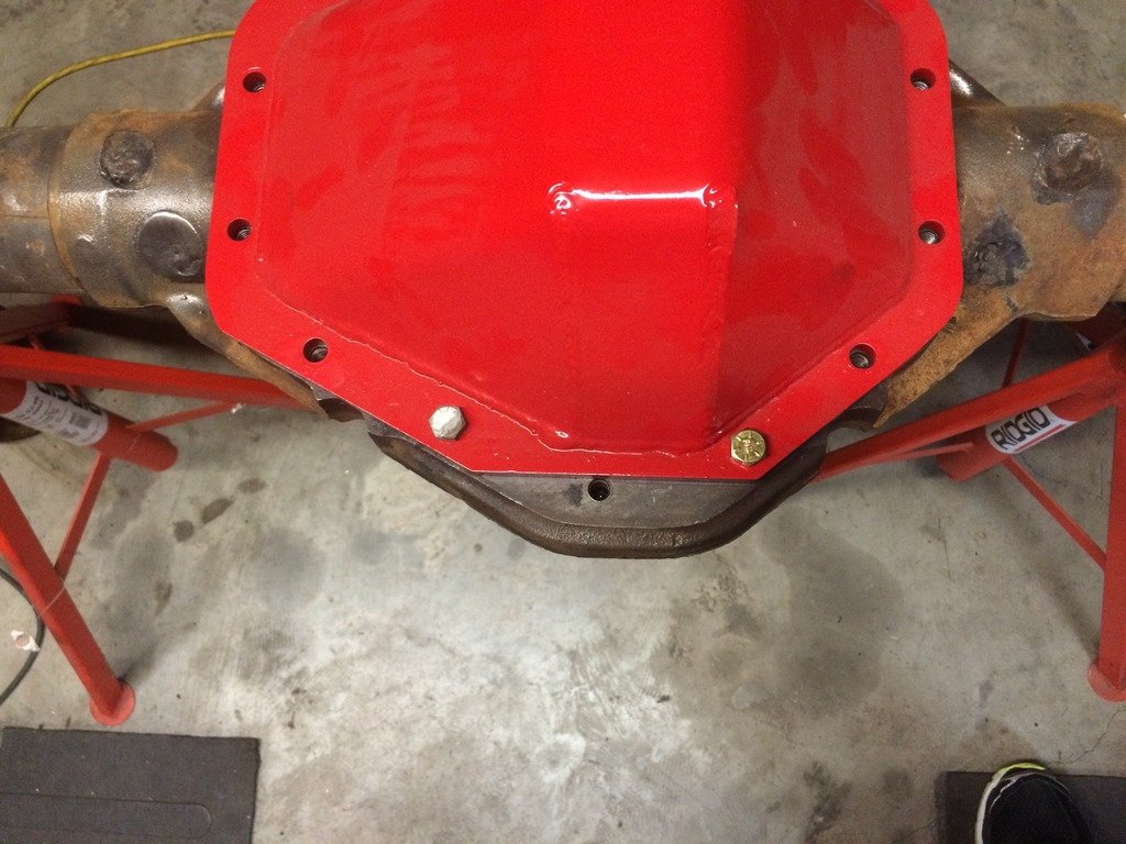

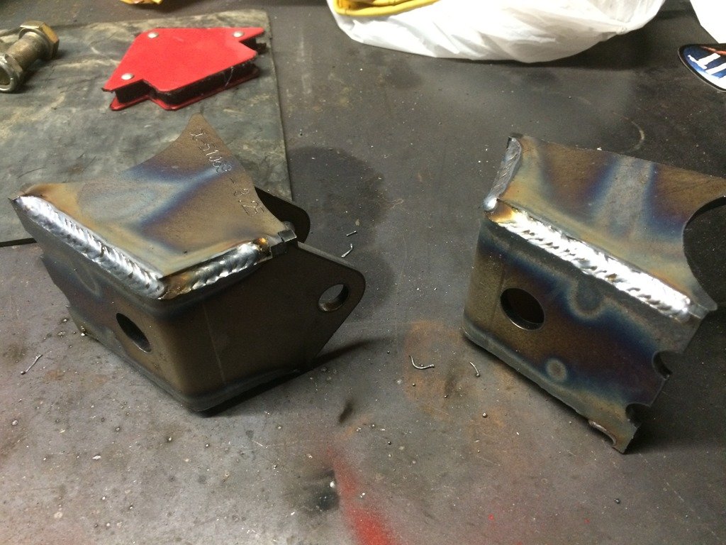

    Picked up my 14 bolt yesterday . Got to cutting on it tonight.
    Welded up the shock mounts from Chassis Unlimited.
    4CE90264-59E4-4DB9-A045-686D1A304FA5_zps_49d6915d67510e8f64b277c069274f1533bf8165.jpg
    Removed hubs. Began the clean up.
    37FDC51F-6F58-47C8-8961-CDA4919F7573_zps_64078d3895de2e2f76f5092c2d21b86325a0735b.jpg

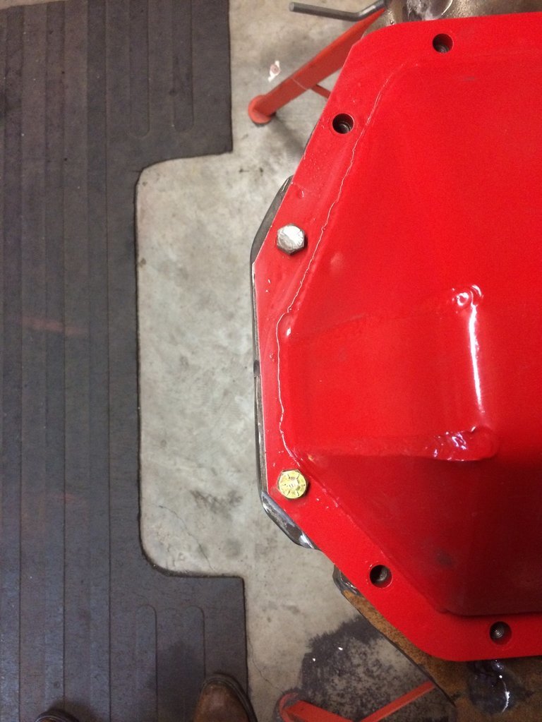

    Barnes diff cover before.
    64EFC076-65B6-40C5-9DF2-7FB600B6B202_zps_8811c25a731d63ef2a8ac577da201371a2c1d3f6.jpg
    After
    FCBF8E01-D003-4374-8E77-3922ED4C97D9_zps_afac74814df7b69c5d53c582196a658e6a721748.jpg
    All brackets off little bit of grinding left.
    1BC9B8EC-1B00-4B62-9BD8-0659808CDE3C_zps_a4250078bda8acf5e003bb2fffefbf861440a7f9.jpg
    Next in the list: clean up hubs, re pack with grease, install disc brakes, pinion guard, brake lines and tabs, axle perches....
    Should have it in by the end of the weekend..

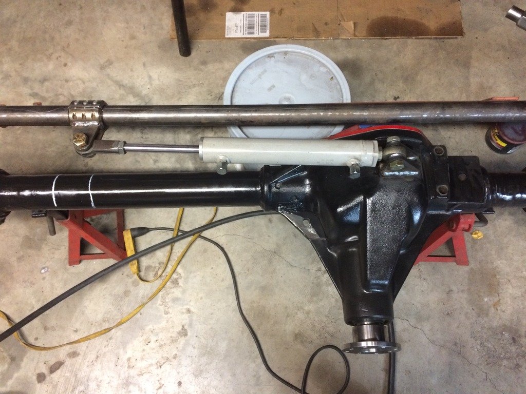

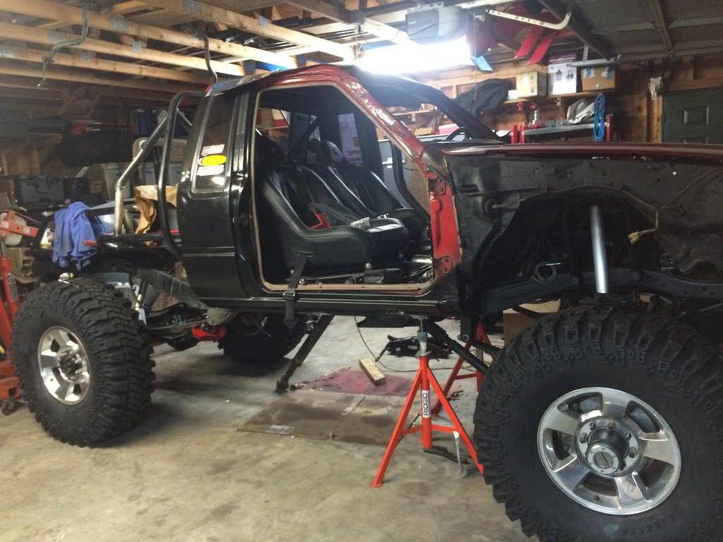

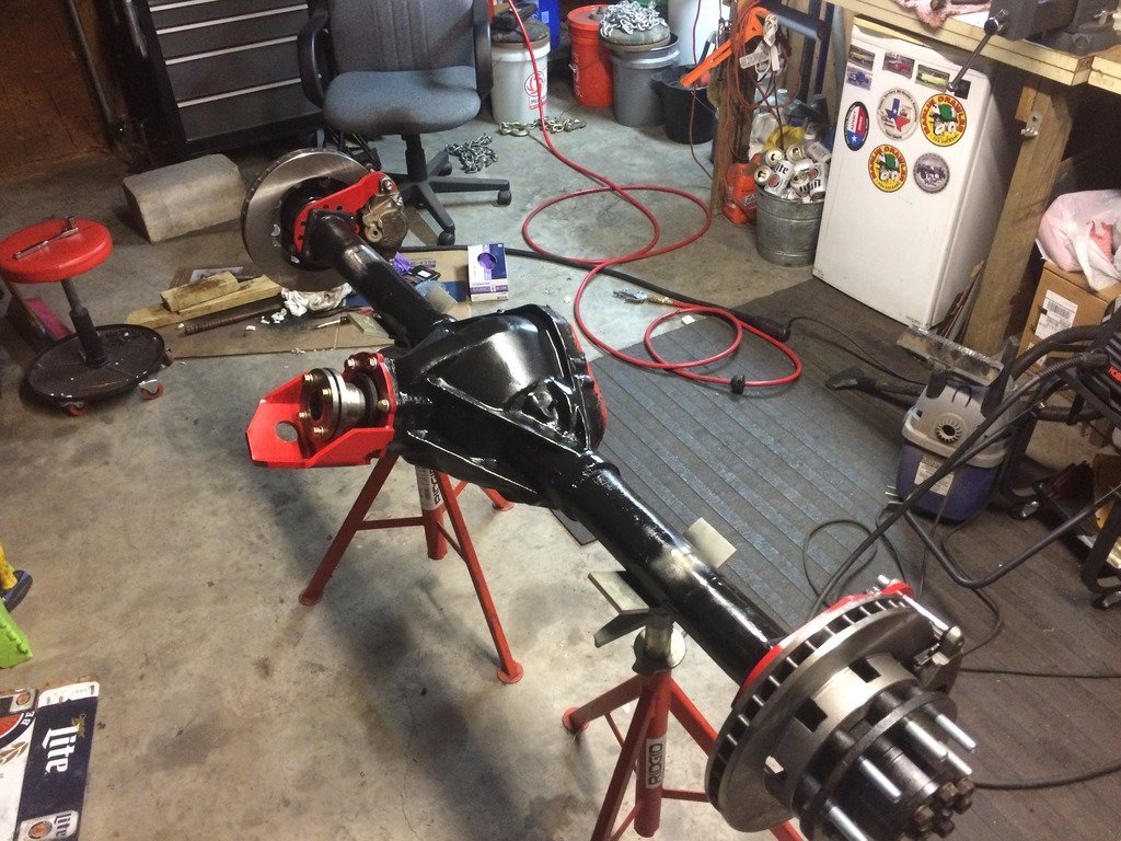

    I pulled a late night and got the rear axle fully assembled.
    F21A9F29-FFF1-4677-8C57-15C1A981C26E_zps_7eb9ab097e2e3b79a351e05890688e2db86c8b33.jpg
    C5F2618F-57D2-4FF4-9C58-3C70A3396213_zps_fd0560b2992506ba7ed53ebcd00111abe88a3ddb.jpg
    8CE63D02-E5E8-4D4B-8500-894320E3C7F6_zps_0acd00039dcd8ea7651e7d3e0232c6b3550bf663.jpg
    49372D9E-7284-452F-B44E-933888743401_zps_47611bd43438844bf9eff5da51a6996a3dfdbc42.jpg

    After almost 5 months I have a roller again. I need to finish plumbing my rear brake lines and address a few things on the front like removing a leaf or two, add some brake fluid and bleed them out.

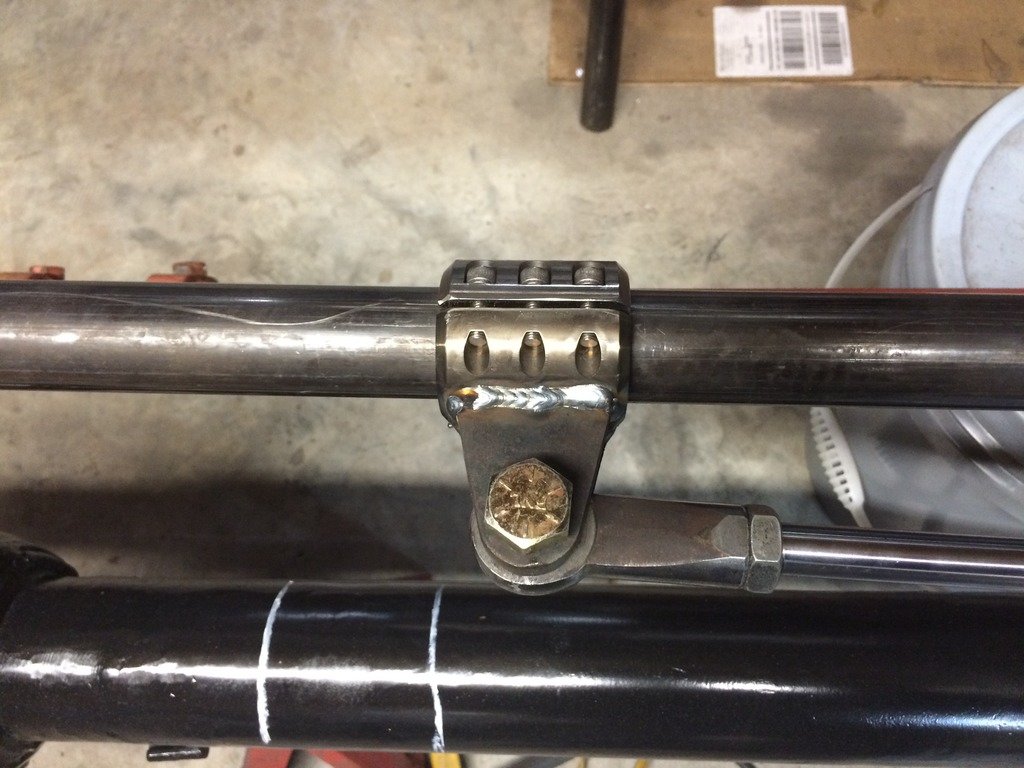

    Got everything finish welded tonight including the hydro assist. Gonna take it for a spin tomorrow. Fingers crossed.

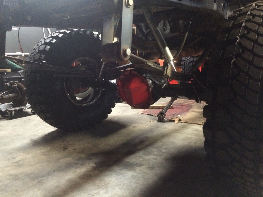

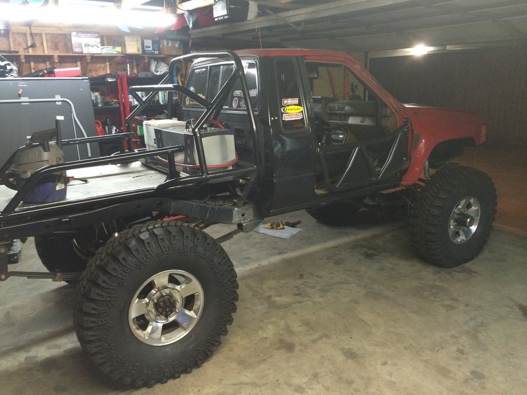

    Drove the truck for the first time in a long while. Just need to address a few of the finishing details. Other than those, I'm just about ready to wheel.

    Looks badass. I can't find much info on those tires. Did you get them new or used?
  19. Nov 1, 2015 at 1:37 PM
    #399
    Boomtacoma01
    Boomtacoma01 [OP] Well-Known Member
    Dec 7, 2009
    #27162
    1,390
    Houston
    They are new. I guy here in Houston ordered a container full of them and had them imported. Basically are a cross between an irok and mtr with a rubber durometer close to a BFG red label.
