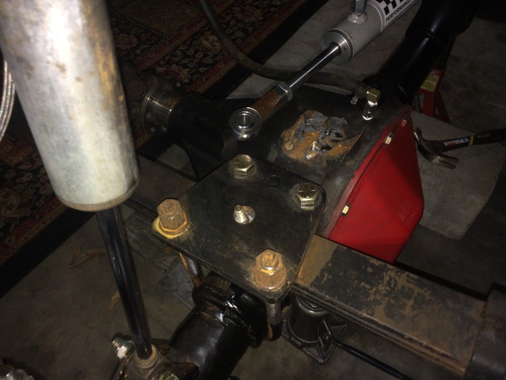

    I added a piece of 1/4" plate in the rear of the front spring hanger and got it burned in to add a little more strength to that area. It made it a ton easier to get a good weld. After that I painted everything up in that area.

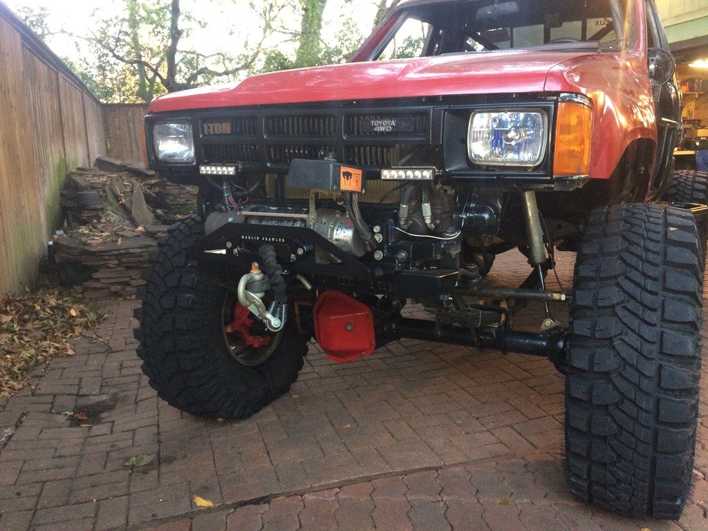

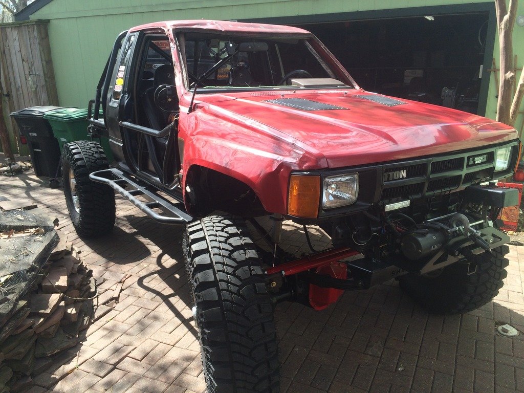

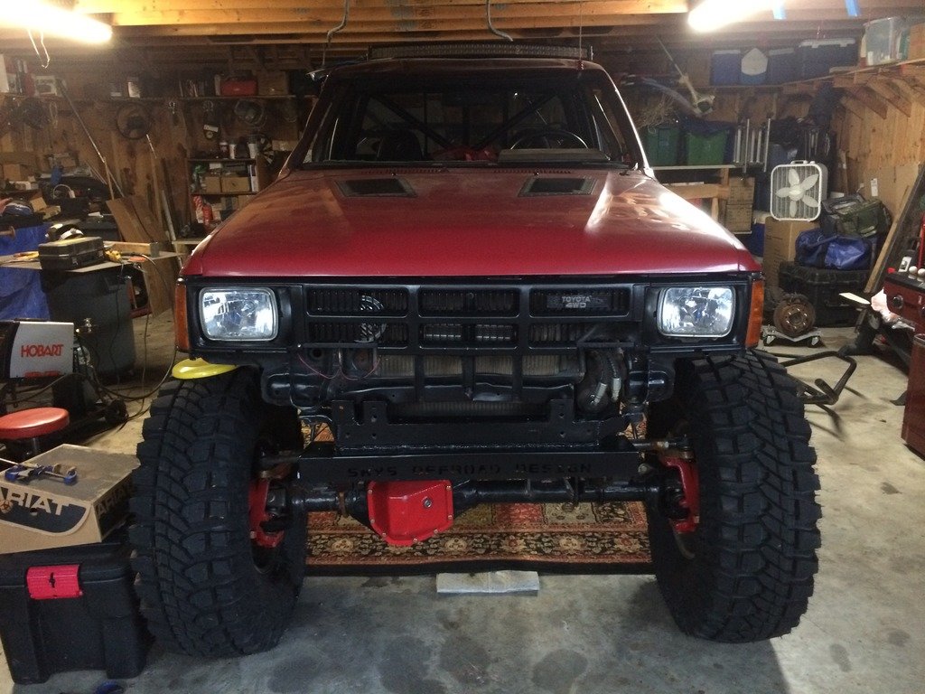

    Got my trimmed up grille installed for the first time in almost 3 years.

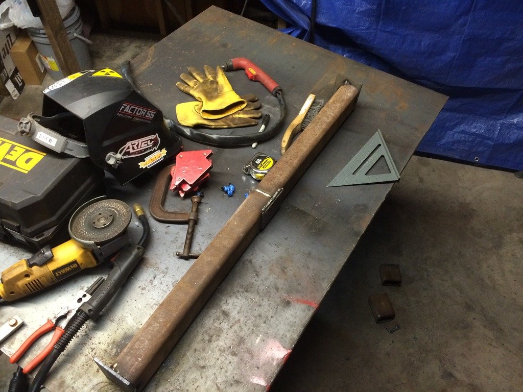

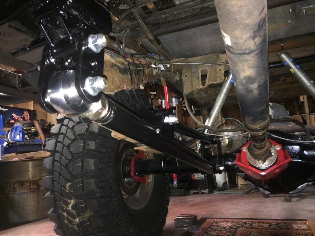

    Started on my rear traction bar cross member. It's approximately 36" wide made of 2x3 .25 wt rectangle tubing with 3/16 scab plates for the frame.The Chevy 63s are prone to tons of axle wrap. It was bad before and I assume it will be worse now with the increased unsprung weight of the 14b and 40s.
    36767232-67D6-4B1A-928D-76B27D7370E6_zps_b5bf37f2ed6c09a587ebfee3e8f561200019863f.jpg
    Waiting on my sliders,traction bar parts and some one ton brake parts to show up.

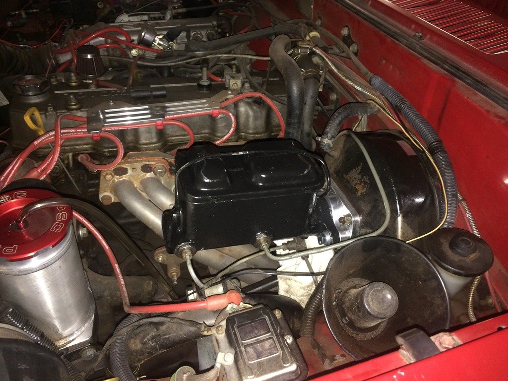

    Finally installed my 1 ton MC. I ended up replacing the rear OEM brake line with a -3 SS line to remedy the leaking one.
    Added some fluid and got them initially bled. I just have to tuck all the lines away. Then on to a test drive.

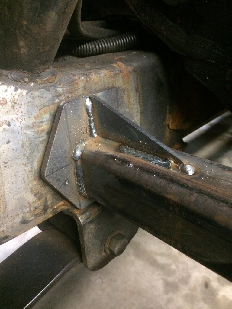

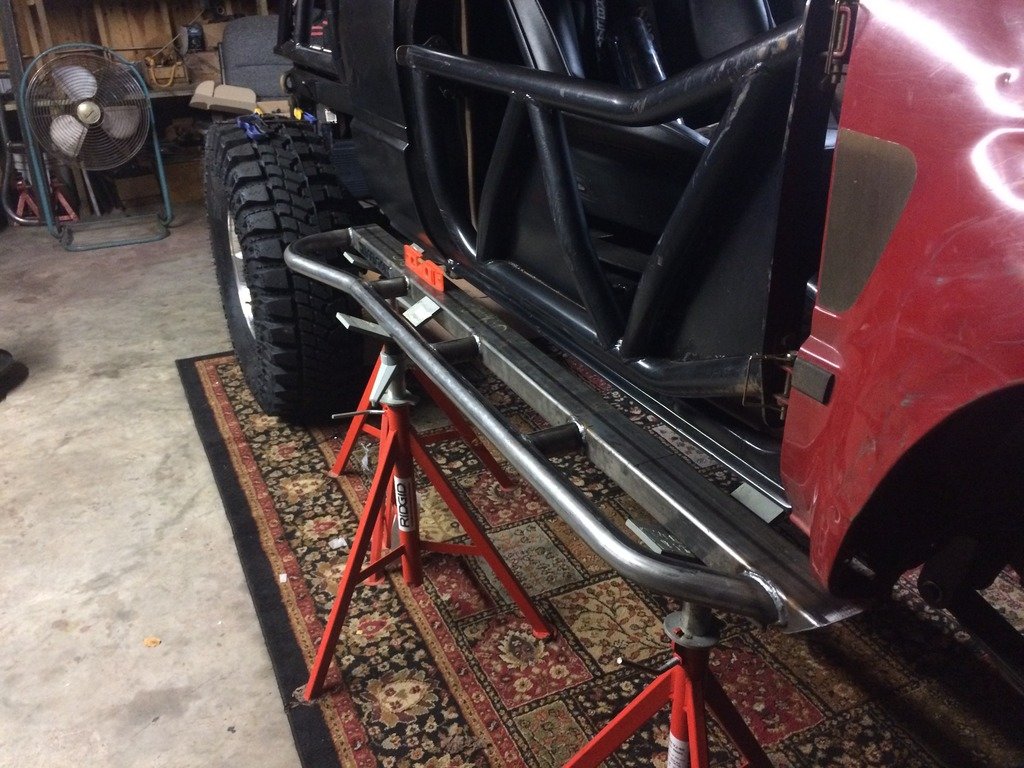

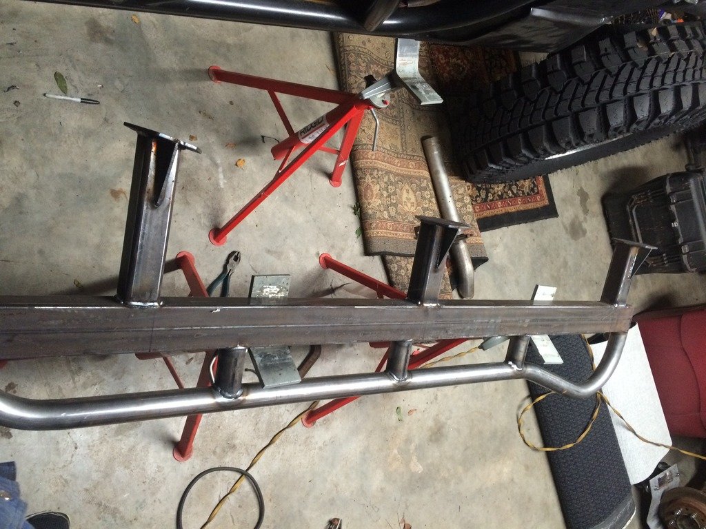

    Started mocking up my sliders tonight. I found them online from a shop called Slag Factory. They are 67" long with a kickout. The main tube is 2x3 with 1.75 outers and 2x2 legs. Scab plates and gussets were also included. They seem to be built well. I'm leaving the 2x3 tubes out a bit in order to be able to tie some tube into. Time to bust out the chop saw tomorrow to get the other legs cut and burned in.
    07A38D92-5AF6-46ED-8AD2-3CD244DDD7FD_zps_1255cf38d5c5fef03e2569a145c795dbd5a7a128.jpg
    011E2A7F-24B8-452A-A693-03A85353AE6B_zps_0a73dfe1f6b7987d5d34d460286823f8ff9c3539.jpg
    BBB42BBA-7621-486B-BFFE-8D5D01924E6E_zps_e6c4475bd005a79a4535bc0841a514e80b79947a.jpg
    Scab plate and gusset
    0BB8AA3C-4EB9-4769-BDCD-9D29EDB26E12_zps_773c21e8bc86113496b0875af7ab973f57ef193a.jpg

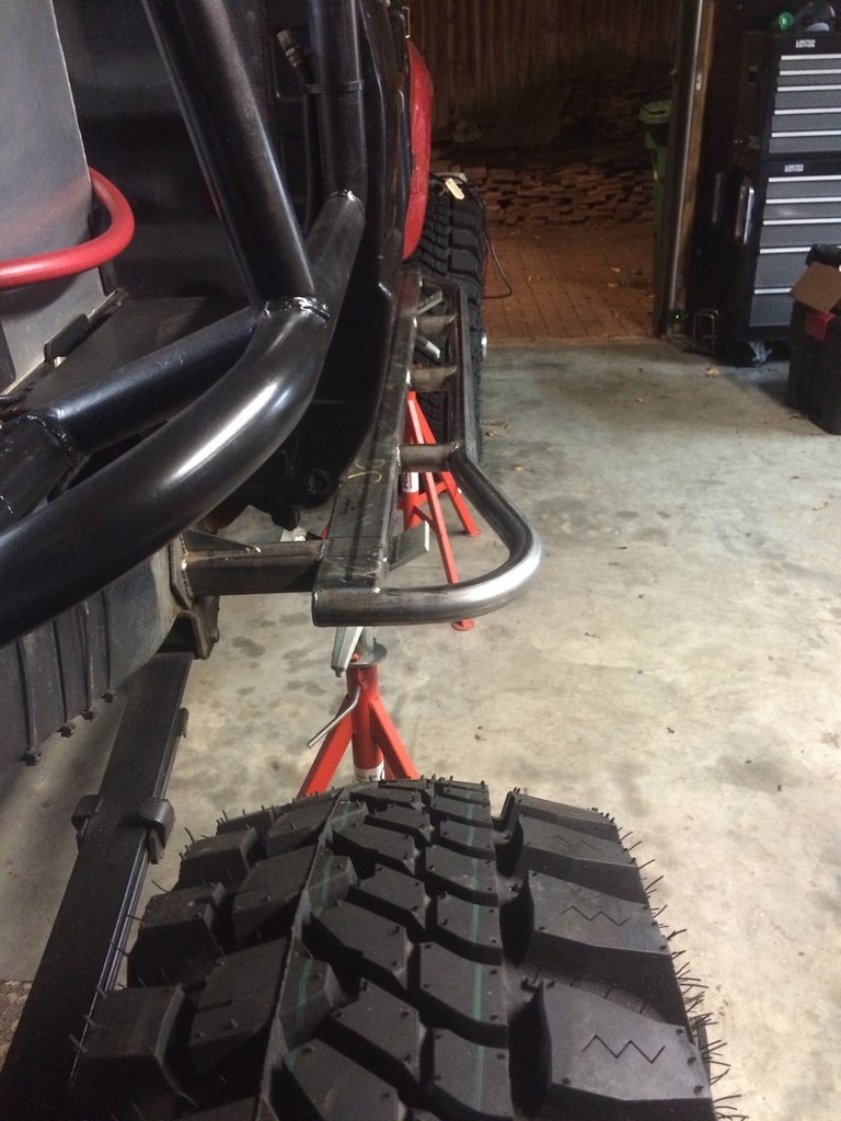

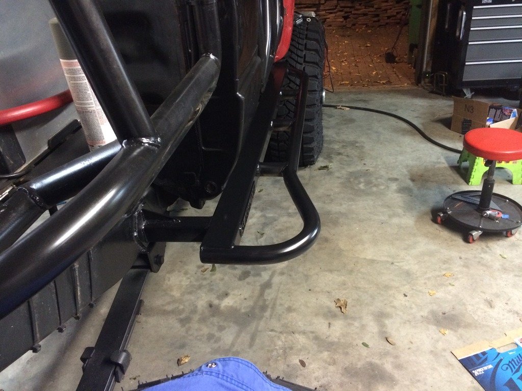

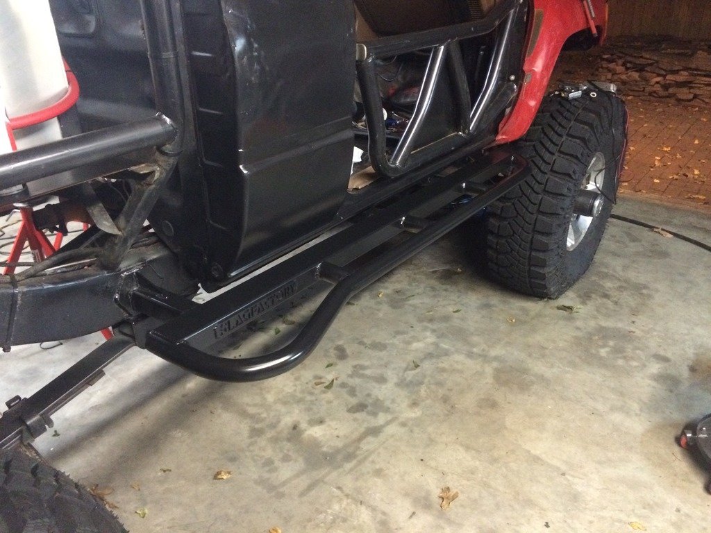

    After running out of wire and gas for the welder I finally got my sliders burned in.
    A68FE9AC-0E27-42B3-8B7B-D5E8BCB39384_zps_5504f0762150d0ef924e5835e45da6bb9f10fa66.jpg
    59FFEF1E-7968-42C2-9B5F-DEBBCDB7CC96_zps_b2e9831713c51f07359a11991df096be537f2c4a.jpg
    8F7A6237-D8F5-4479-84A8-D36B9E7A38C4_zps_bece73329c501fa57dafd26b768bb723e4fc44ab.jpg
    173DE880-5530-4B72-9510-C8C046843EA6_zps_97d62f76d91194f1688ddc04f7c9b100f2d7da89.jpg

    Front winch mount
    32FE653E-2844-4C19-9C72-0263B8B38A3C_zps_e4ed0b1179d9cd112f5285a884e9c9024c485aa0.jpg

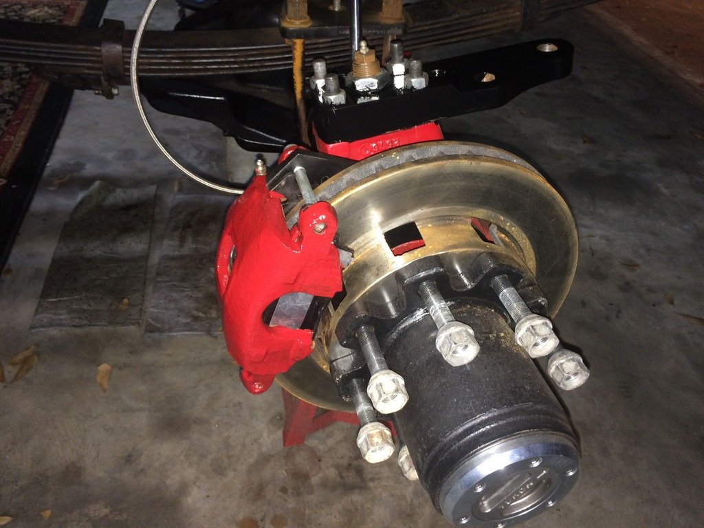

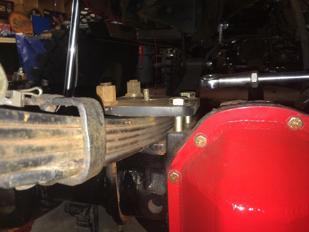

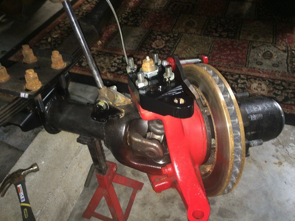

    Addressed my pass side spring perch and got it all torqued down. I had to trim the inner 5/8 bolts to fit correctly to keep the spring plate on evenly.
    D3E007C3-2C1D-4B18-B60D-CE05A9285920_zps_ea27e33c07a61646546f86835b74338855c2ad9e.jpg
    AB97CB25-AFC8-4189-8018-1181A636C8C4_zps_38bc8bbb62e26f49e4baf048a84936291ce10c46.jpg

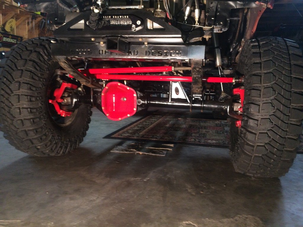

    I painted the front calipers, high steer arms, and steering linkage. I should have painted all this before in installed it the first time.
    9C609700-8E30-4009-8B69-63B01D447404_zps_3f211d0c7c77853cc7c87d04638d0aa0894491cb.jpg
    F74B00DE-5451-482B-8E73-12E901125C08_zps_18e0eb25855cda090a6de9668c80500561cbfe01.jpg
    53BA5B5A-86D5-417B-942C-612CB03E8EAC_zps_b07a8526127eb1680c2554393652a9cf08fd0dfd.jpg
    Just waiting on the paint to dry. Should be back in this week.

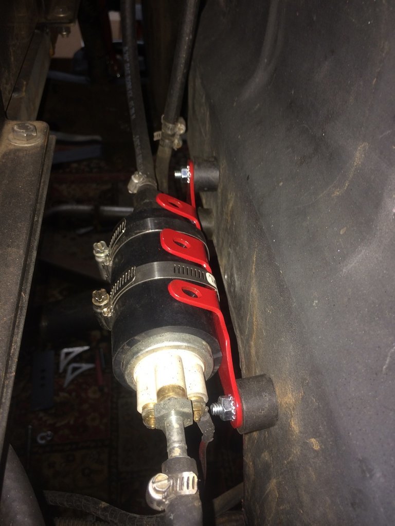

    I installed a new fuel pump mount on the back of the cab just slightly lower than the fuel cell.
    BDBD30D9-5D03-49F9-91BD-762ED8FE8045_zps_5053afc0251de2abf728dca1bca72785e0cd834d.jpg

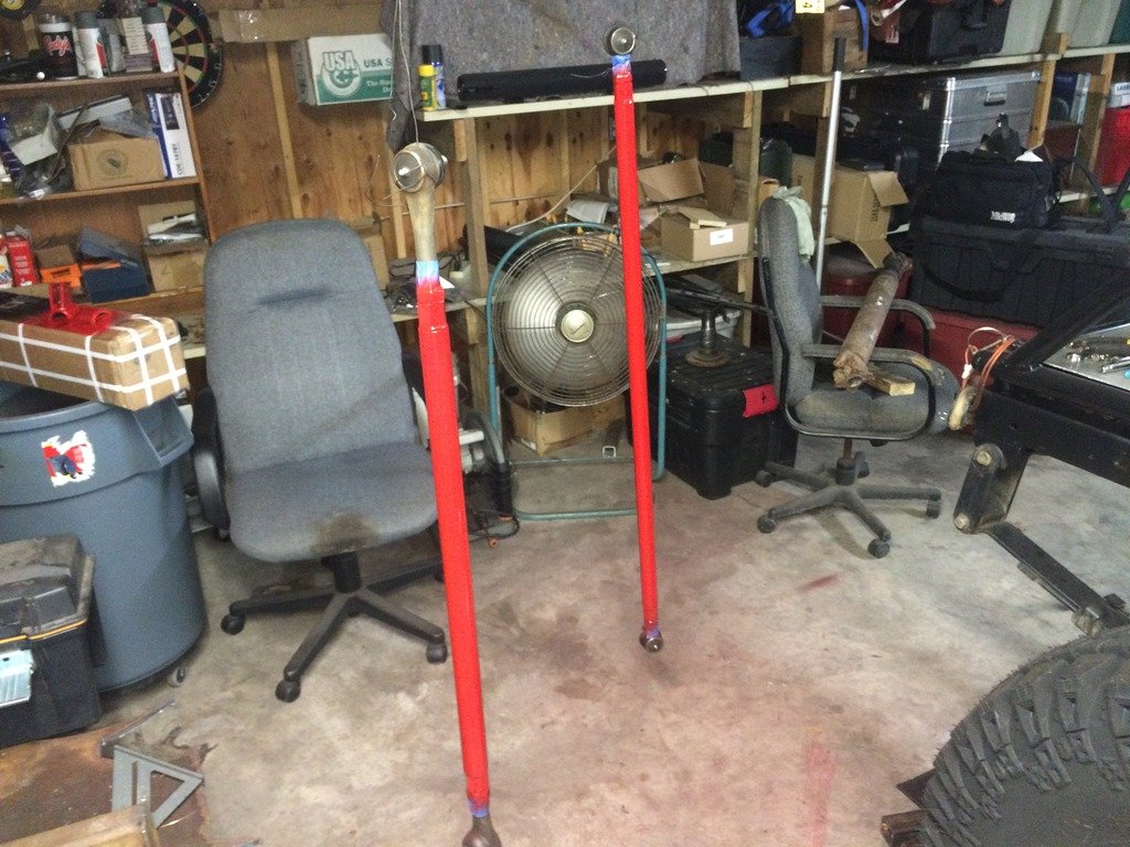

    Finished up my anti wrap bar

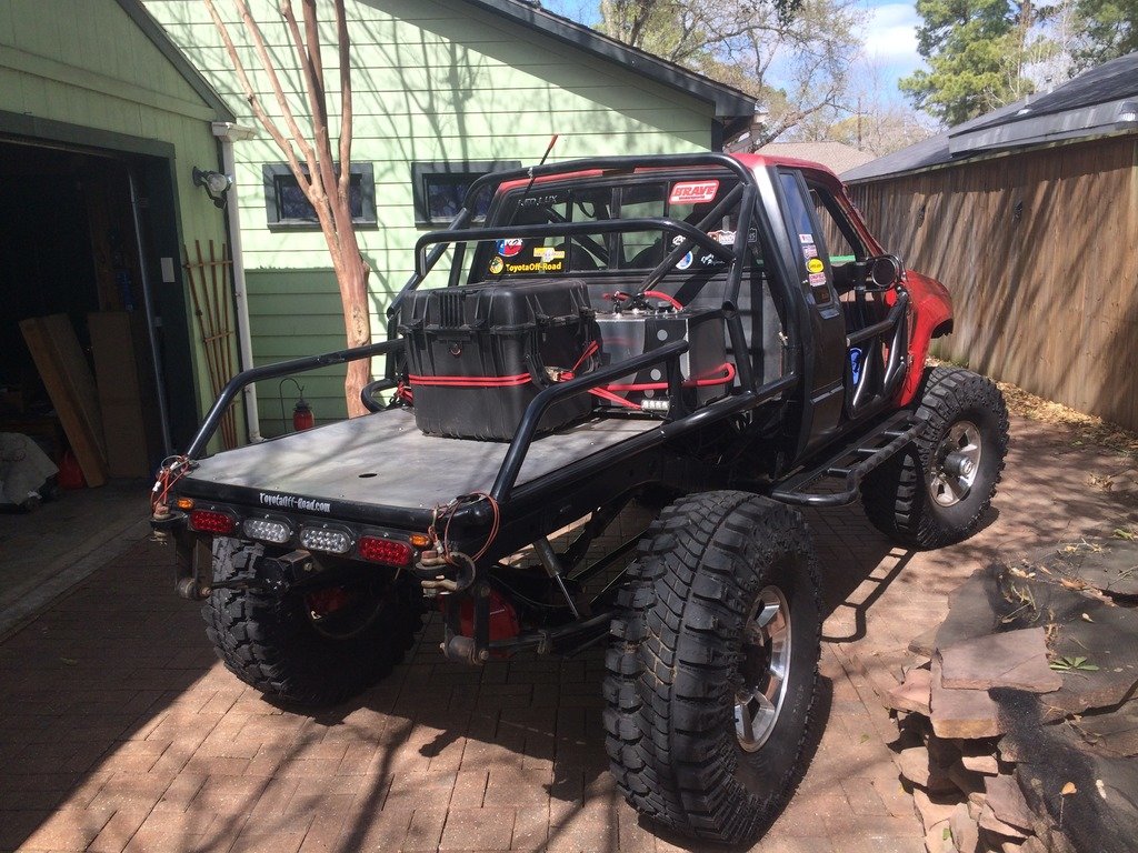

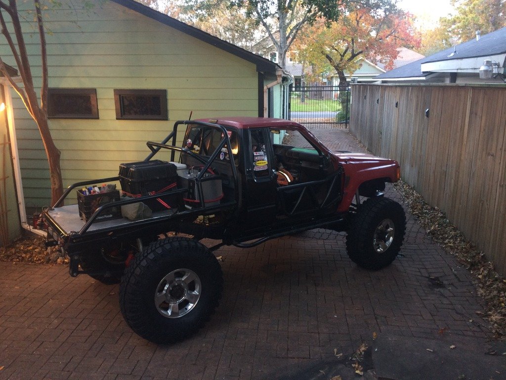

    Truck is ready to wheel as of this afternoon. I made a few hot laps through the neighborhood.
    AE288AA1-230D-4F25-97C2-9A7B69FF2216_zps_209018d933e23108b3c36989220cdf5eb4dd5eb4.jpg
    9B29BC21-C689-495E-87CB-4B9E81E27F34_zps_b7e37d84db1f0a03b1a6b0bdea6afc25a4d58935.jpg

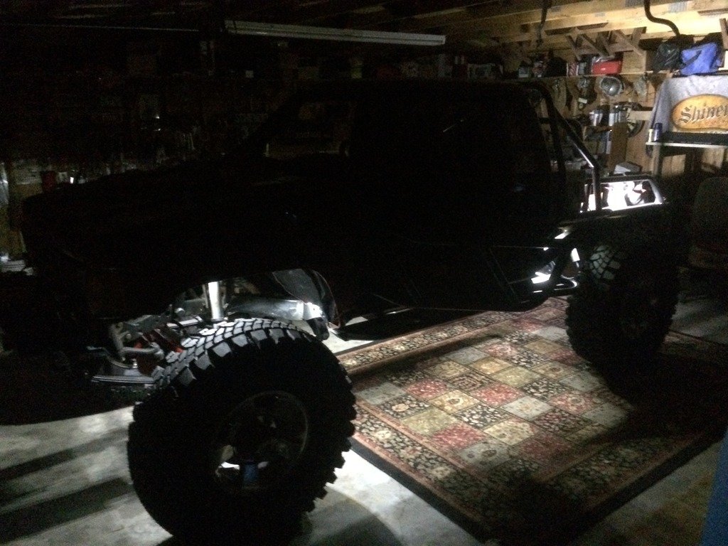

    Rock lights are done.
    3CA7B0A0-1024-41A0-9E3E-E3032B8ABCCE_zps_2e4abafd1a797ffdaf6b81b6a2cde942a214ed6c.jpg
    I need to get my spare DS shortened since the slip yoke on my current one is beat up pretty badly and I don't believe it will hold up for too much longer.
