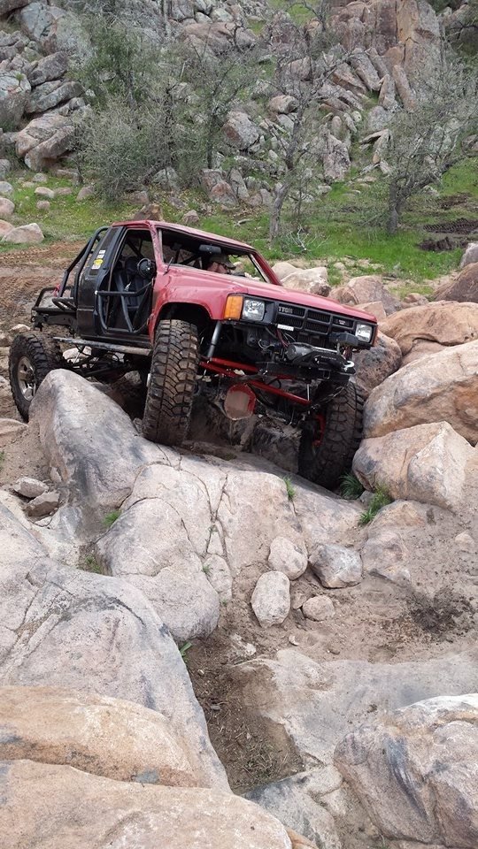

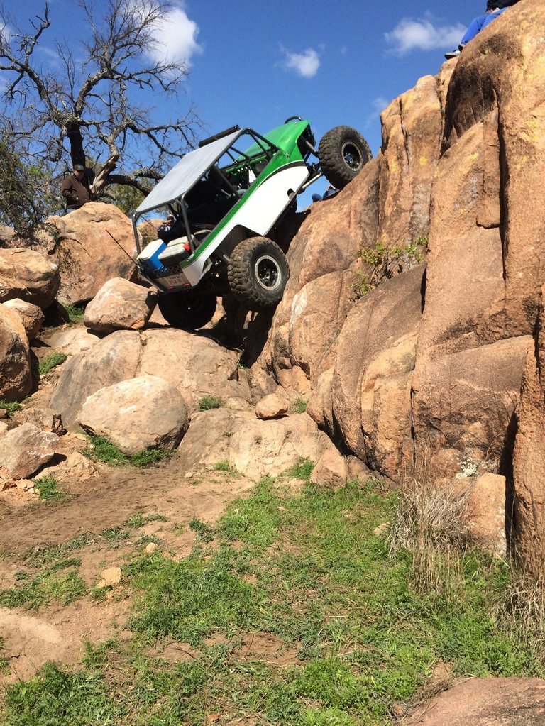

    I've been out of town since getting back from K2. It is truly an awesome park to wheel and is definitely hard on your rig. I think once the tire break in they will be awesome. Issues that I found: I need to clearance both front fenders, cut off about 2 inches of slider in the front and rework my winch situation. My tires eat into the sliders and fenders when stuffed and my approach angle is horrible.
    On to the pics..
    King of the Hill
    https://youtu.be/7Z_p4CR1XMQ
    51076B0B-E2DC-4C67-A110-2472BF7B9A45_zps_1254fd0a7fcd10b380cbe443128369852b27b7eb.jpg
    My tires hit the leaves a little.
    3BB8F0DC-B379-443B-BD4A-73E0F30A86F3_zps_efa9cbed788fe39ccda578a42a748a4031e9be65.jpg
    Daniel losing his idler and steering pump pulleys on Smoking butthole.
    21B82869-5141-467C-87A5-E0576EB0DAC3_zps_e71ccbf571db16baa5647cd4baecff6eef0d8496.jpg
    Alex on Crazy Wabbit
    A6B464F0-B555-4C83-9F77-5AC62F9436D0_zps_1d9c2bfa8351f9b95a435a32ffe92faab7123742.jpg

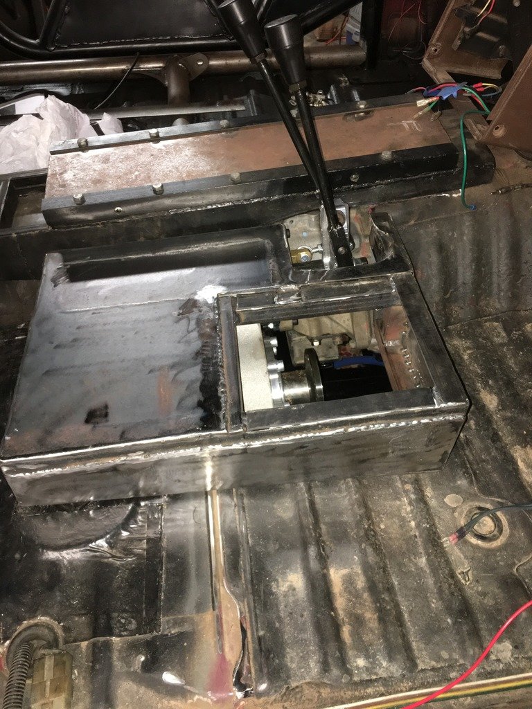

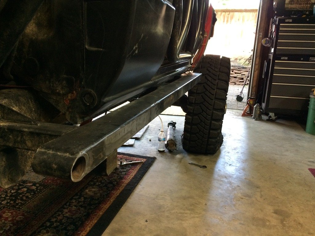

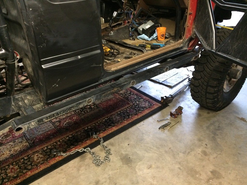

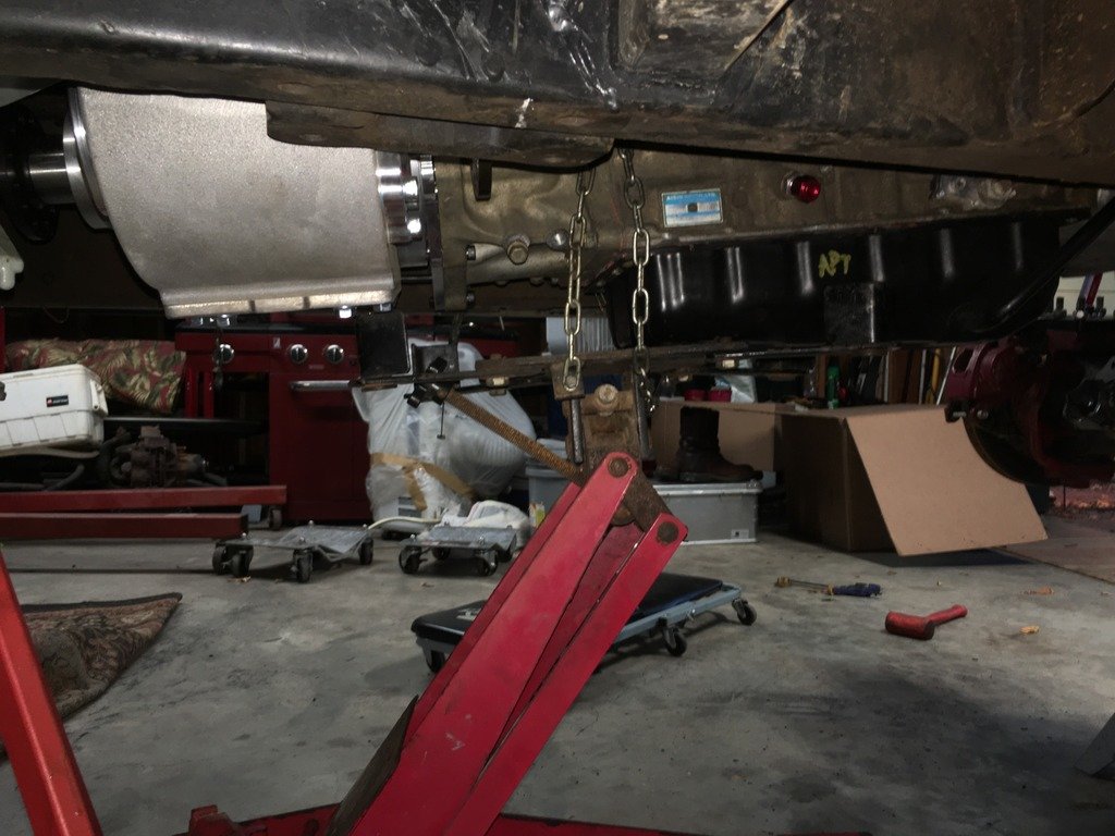

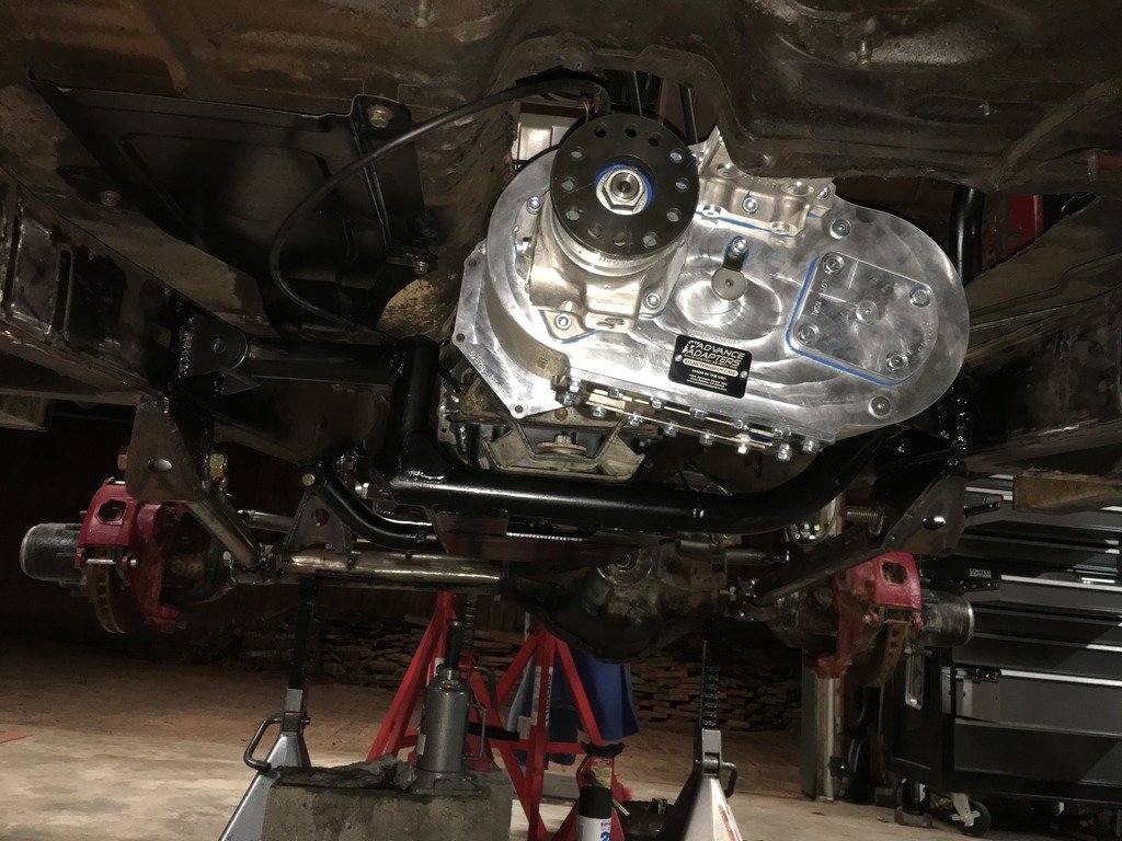

    I have been putting in a bit of work lately since getting back from Superlift ORV in Hot Springs.
    I cut the outer rail and Kickouts off of my sliders. They stuck out way too far and were more of a hindrance than a blessing on my past few trips. I will refit the Kickouts to reweld to the rear of the sliders. I also trimmed another 2 inches off of the front of each slider. The 40's kept digging into them at full stuff and on hard turns.

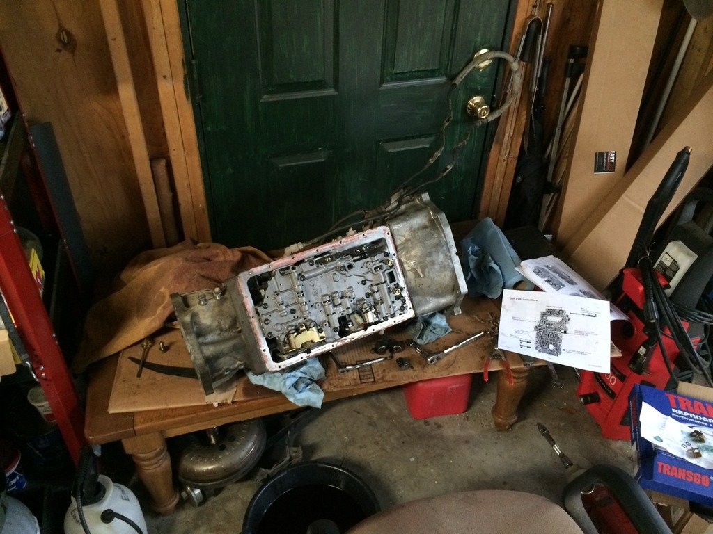

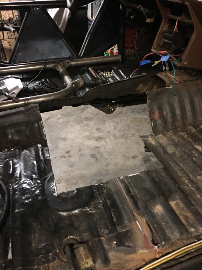

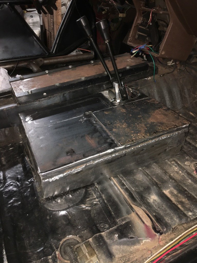

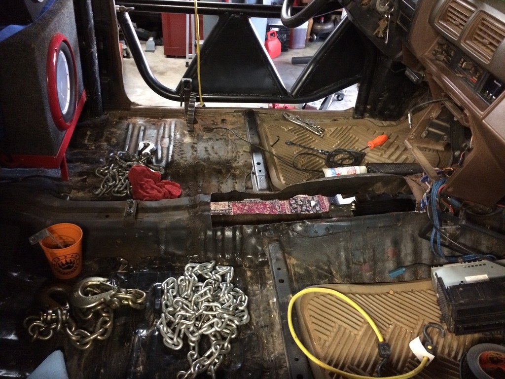

    I stripped down the interior of the truck in preparation for the Auto Swap.

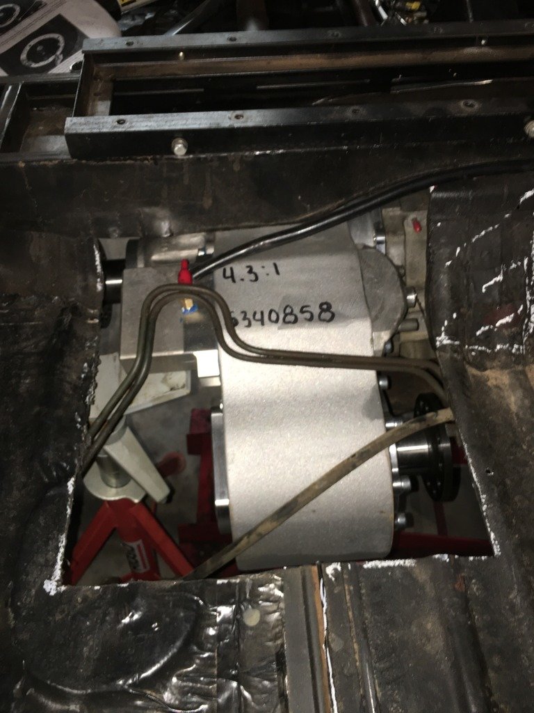

    I have pulled the Duals and am in the process of pulling the transmission. I have them sold and should have enough to drop on an Atlas II 4.3. I removed the clutch peddle, slave cylinder reservoir, hard line and starter.

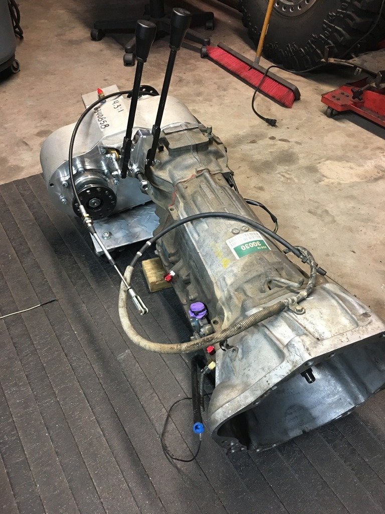

    I found an A340F at a local yard for a decent deal of $300. I ordered the Advanced Adapter 50-5710 adapter to fit the A340 to the Atlas. I also replaced the 3 solenoids in the Transmisson pan and need to install the Transgo 340 HD2 shift kit after the new valve body gaskets come in.
    I also ordered some miscellaneous brackets and tabs to make the transmission crossmember. Dave @ Brave Motorsports is going to Fab up one of his tail housing supports for the Atlas.
    Since my truck was a manual and will be keeping the stock wiring harness, I went with the RADesigns Baja Shifter to manually control the transmission and the Rock shifter for the trans gear selection. Iwill have to fab a mount for the 2 shifters and adjust my transmission tunnel cover accordingly.
    I will be adding an external TransCooler (Derale 13950) and ordered all of the -6 fittings and hose to plumb it in.
    Parts buying should just about be done besides ordering the Atlas..
    Damn I'm broke..Time to get to work.
    A340 with the R series bellhousing
    BBE82FDE-6BB5-40EB-A755-A4672D4C00AE_zps_7f2b11d62a6eb9077eb0ef2512558befdf9ad33c.jpg

    Trimmed down the sliders
    FEDA5599-5ADD-403D-B871-3042B1429717_zps_7f5410fd47044fc49a4441d5ae0b5c1809fde3e4.jpg
    C8B7C5E9-6BB7-47E1-9293-FBA03F62B9E7_zps_29adee779714bcb61316ece6716df0963a8c67ac.jpg
    Cab cleaned out
    7365DCA9-C83F-4231-96B5-8A4BCBC7FD57_zps_8e79f16afd56d1c69a393aec393230e94f2e7f52.jpg

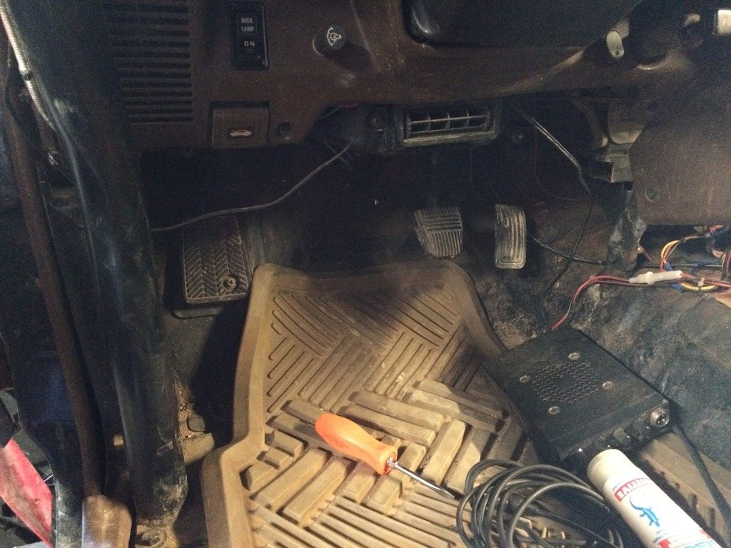

    Down to 2 peddles from 3.
    9D5F42E2-D7FB-455E-81FA-E76DBDADBC71_zps_66af9f7c00b6edc5785d3ae366f34fb90088151e.jpg
    Ready to drop the transmission.
    C4836E92-32AF-4915-81F7-8A4AA8B6AC9D_zps_f7fd50755fde4daa1a61fe04252564b1f1cf5351.jpg

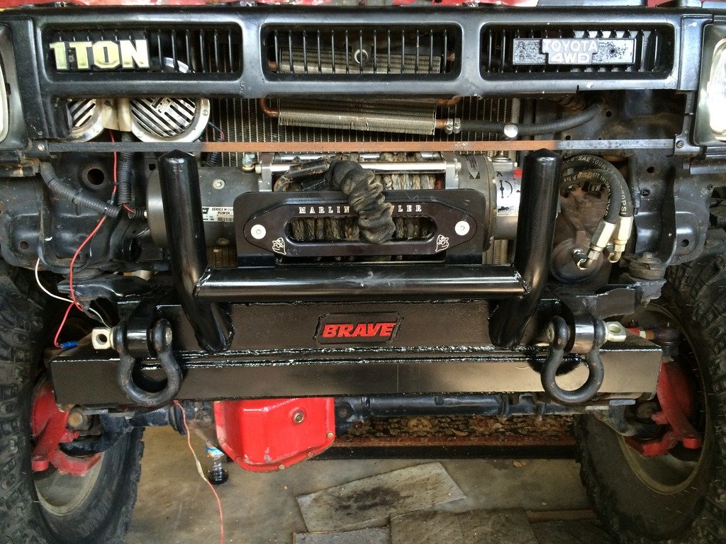

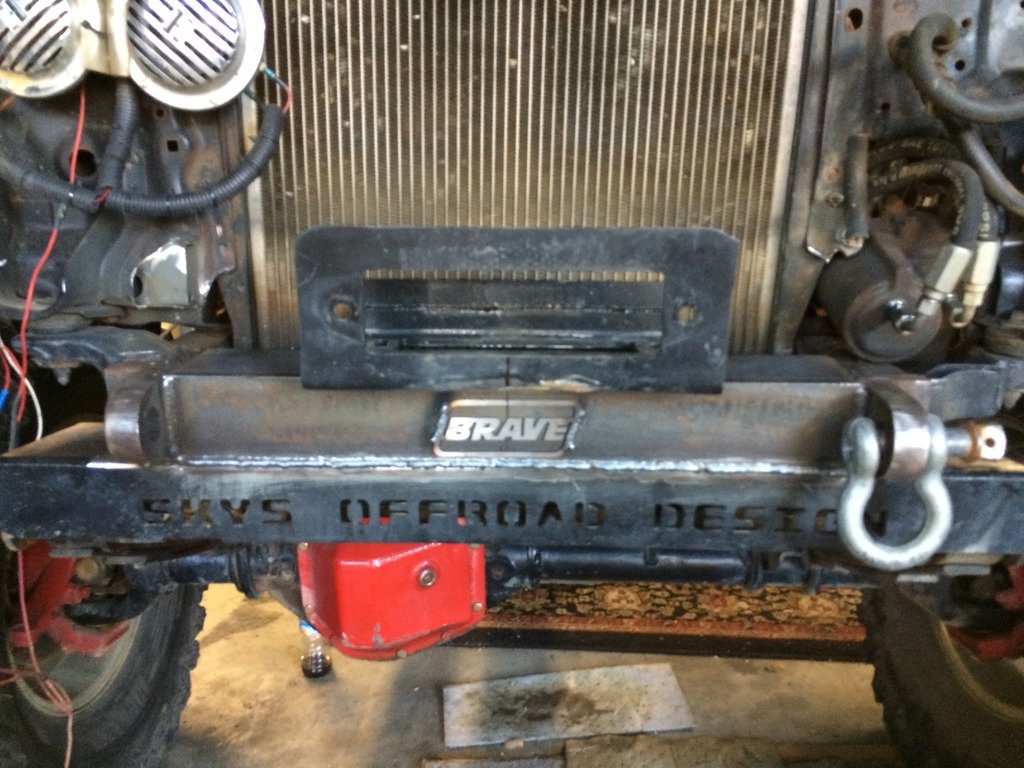

    Almost have my winch mount wrapped up
    4DB4E3FA-FCA8-4C4D-99B2-F3A5A0537C2F_zps_0c81421f2c02c633ce7b26d76d040eda332bc4a2.jpg
    7993520C-3167-4FE5-B9C6-F3E2359F85F1_zps_cd47b54de75fe4a0b80030369bb45cec052f7e4a.jpg
    It's tucked in a lot better than before.
    FE34AFE7-4904-4CB4-869E-04B68787E09E_zps_72d3b78056d853c671233bfabb4694d948168f68.jpg

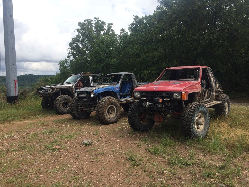

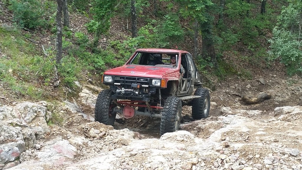

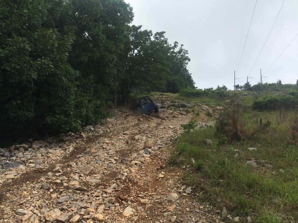

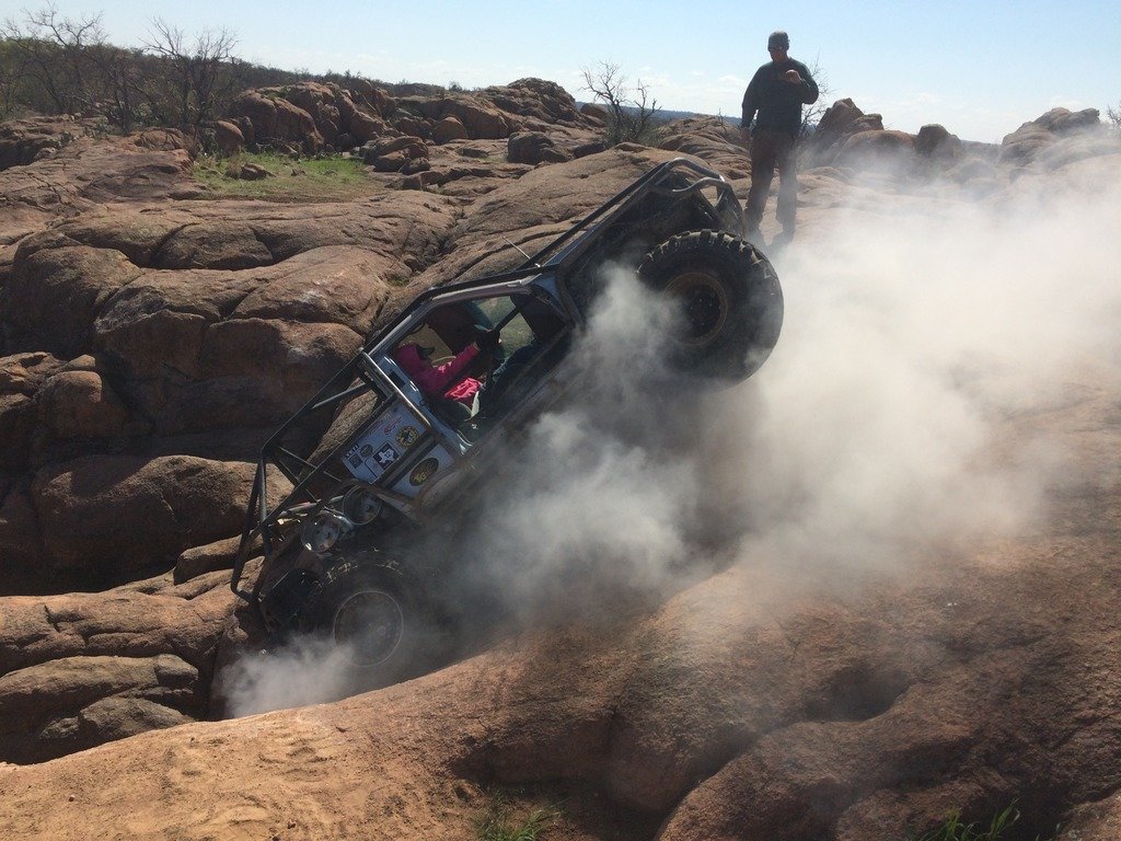

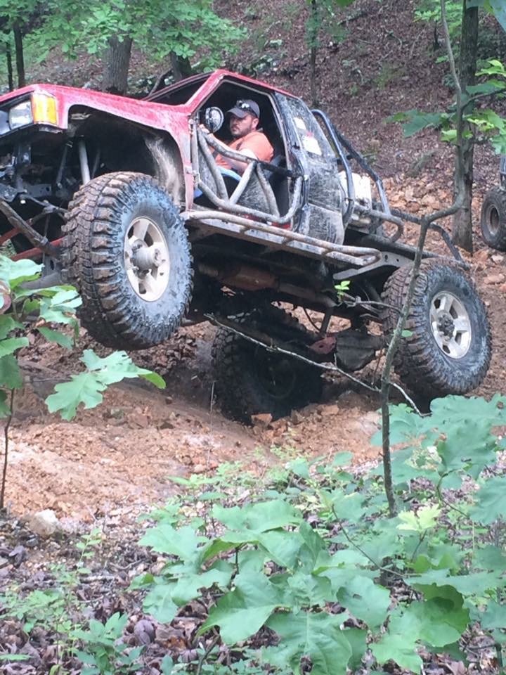

    Here are my pics from Superlift
    Alex and I hit up Superlift ORV in Hot Springs this past weekend. This park is awesome! There was some rain and it was slick.
    Horsepower Hill wrapped out at 5500 rpm!!
    Alex took a harder line and was a little more impressive than mine
    Daniel warming up his tires
    Got 2 tires off of the ground on Schaffers
    Hills galore
    Our group for most of the weekend
    Alex on Pinion Hill
    Red doing work
    Me%20on%20a%20random%20trail_zpsufk6yiqx_26be78618162f21851feb3f9b0fa3fb4a4592900.jpg
    RTI still had a little to go
    headed home

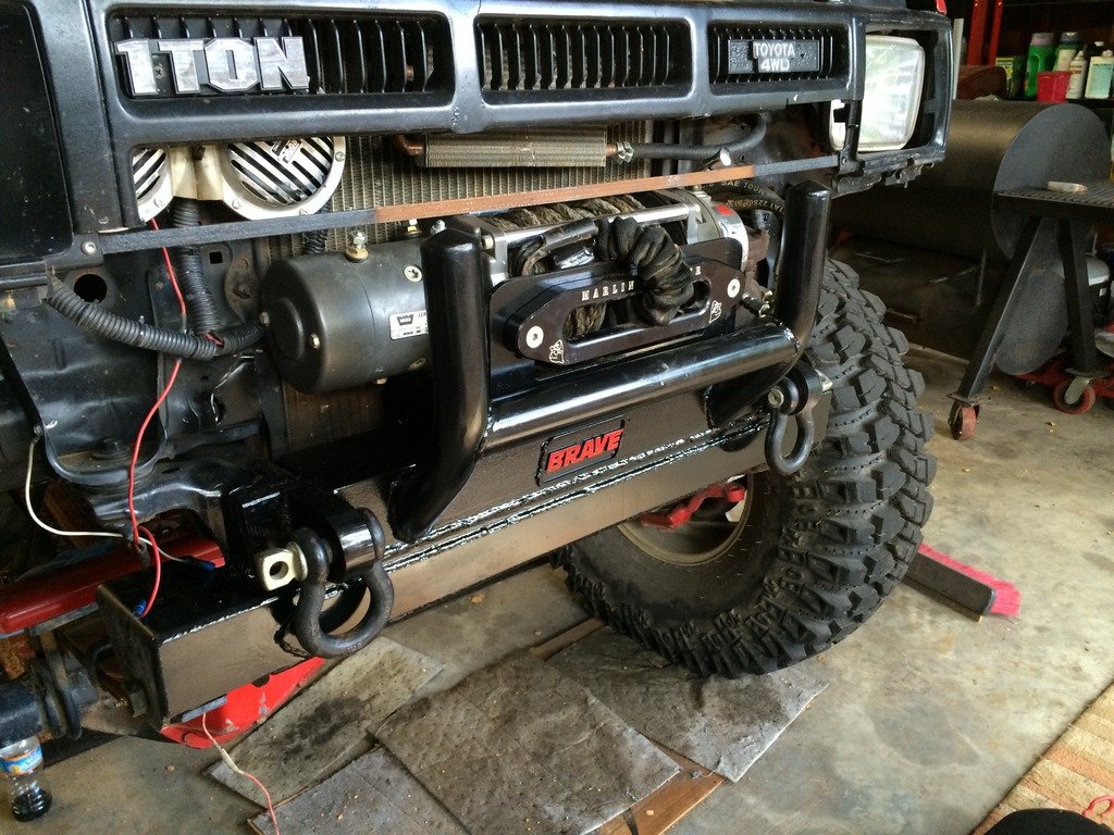

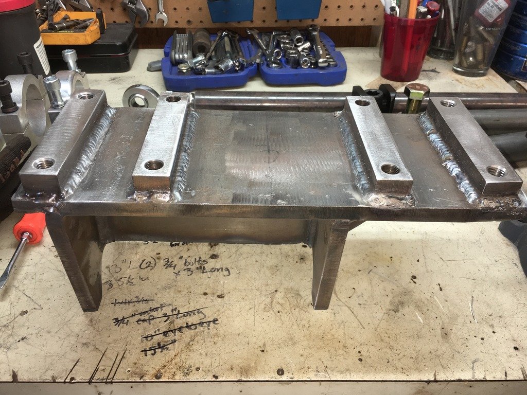

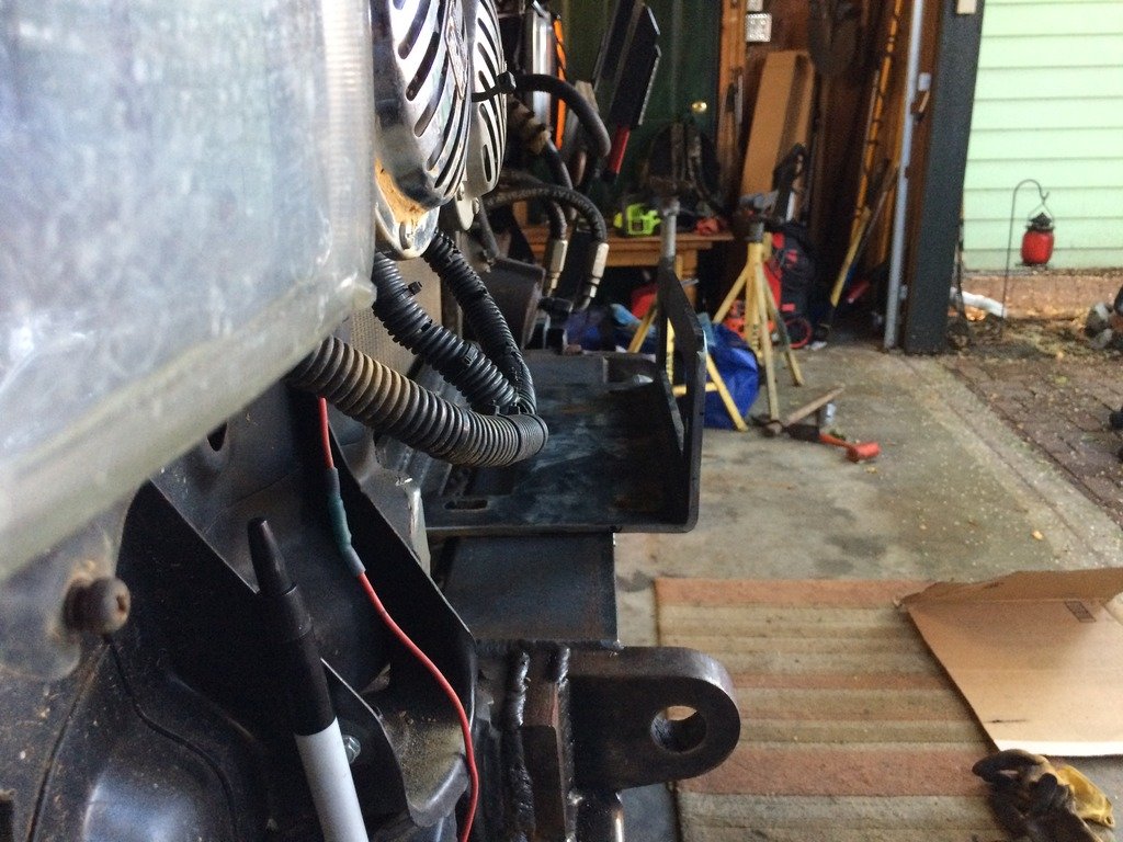

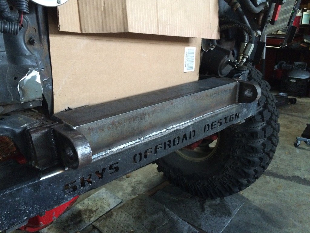

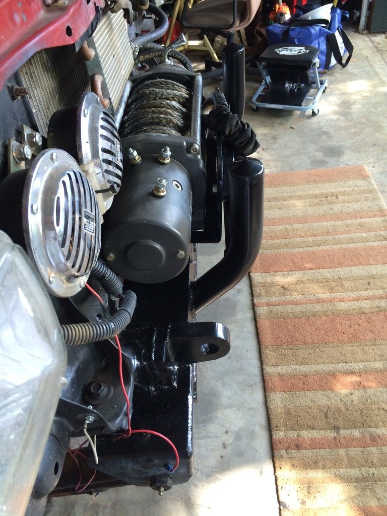

    I finished up my front winch mount. I used a piece of 4" channel iron for the winch base instead of the 2" square tubing like i originally planned. I had to use 4 socket head grade 8 bolts instead of the regular ones due to space constraints. I also trimmed the front grille to fit around the winch. I still need to fab up a mount for my steering cooler and run the wording for the winch but other than that it's done.
    D37812FD-603A-4B45-A7AE-31E26EE47C6F_zps_eb67ee056a9269f6490fc0af85a0a4af32678381.jpg
    12FCFEF1-4C19-4176-9032-CE0B1A24A7F7_zps_a2432dcbee56d04b934cc06a2582efa32d01c8d6.jpg
    E8140C51-A085-404D-8A15-20A94D40E3E6_zps_e98058936f6a21fe9f9586a24d7c24ead46fa797.jpg

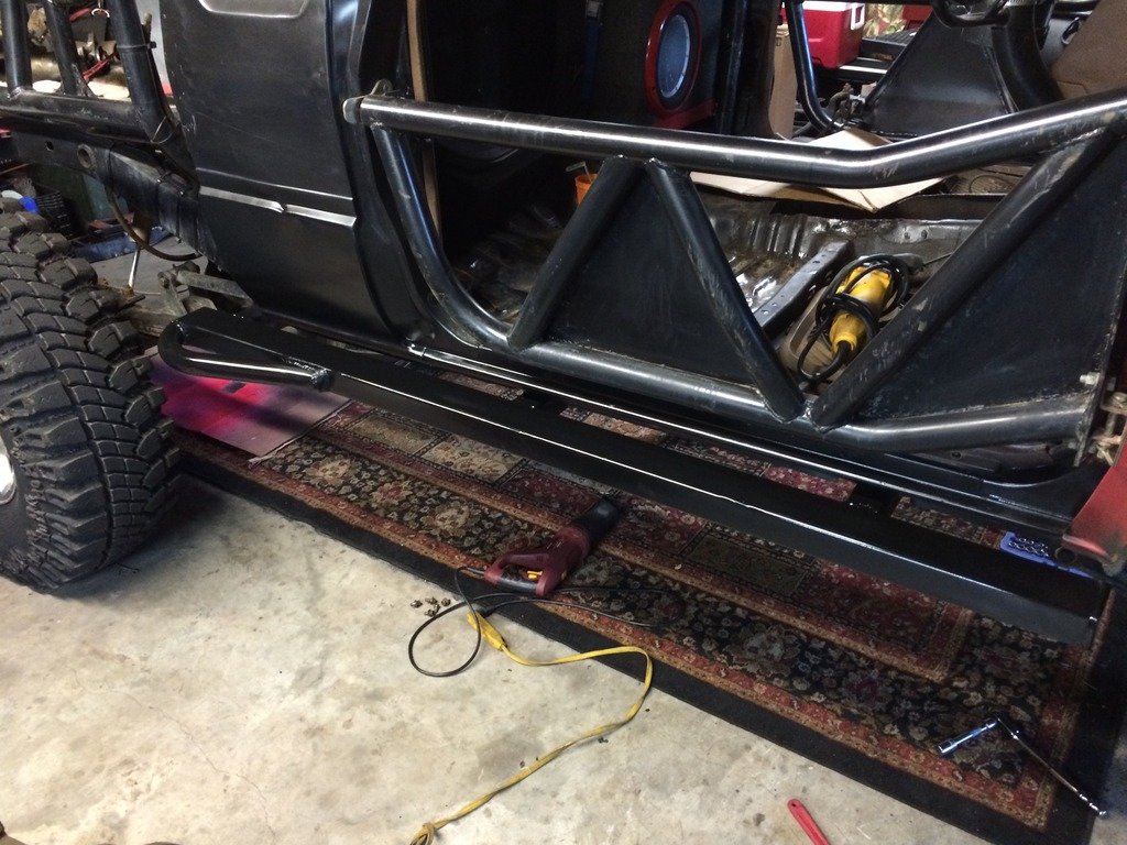

    I also finish welded the trimmed down kickouts on my sliders and capped off the front of them where I trimmed them back.
    Plan for tomorrow is to fire up my new to me smoker and drop the transmission.

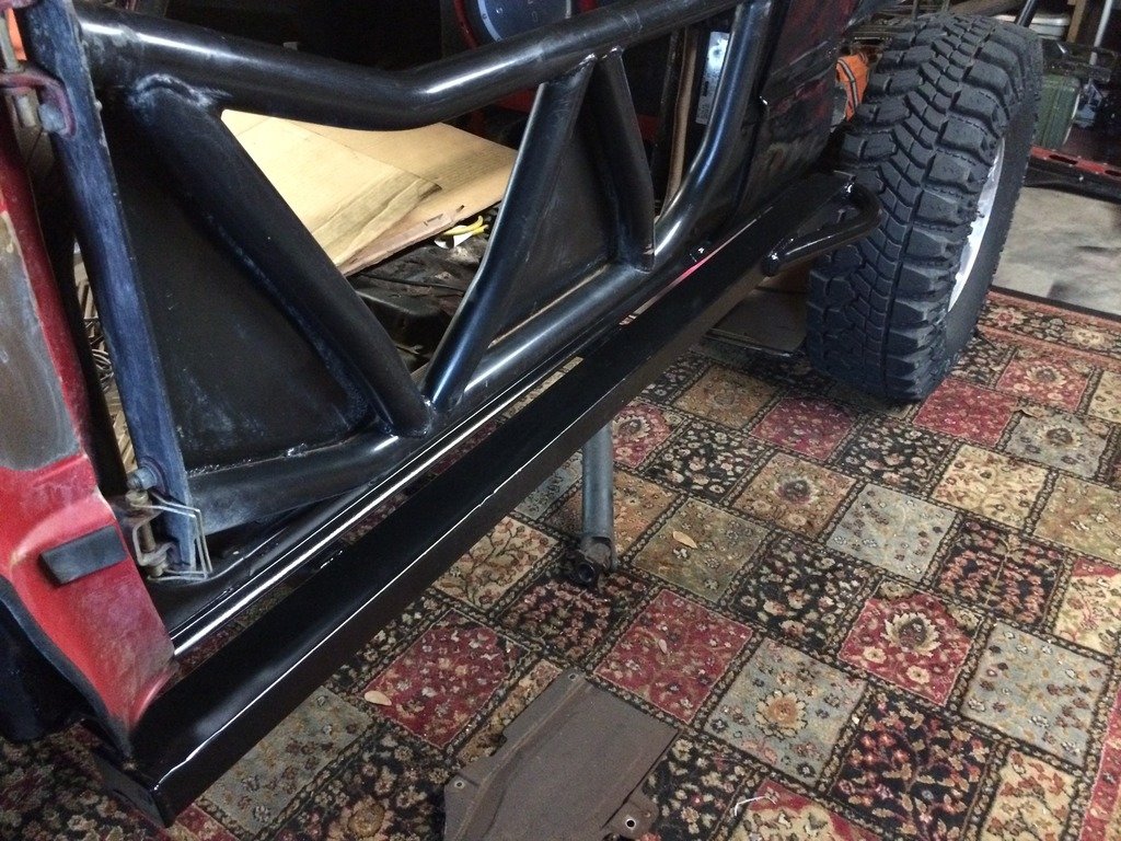

    Through some paint on my modified sliders.
    EEA772A1-8EFF-46C5-85A3-F4DA73E172E7_zps_1b41be8d7b5415cb91f0930cdff2489f7422edbd.jpg
    7A08C15D-2CEF-40B9-9C65-C67AA1523883_zps_04cbffba1b9019a68bf9b9a1871b181e3ad04cab.jpg

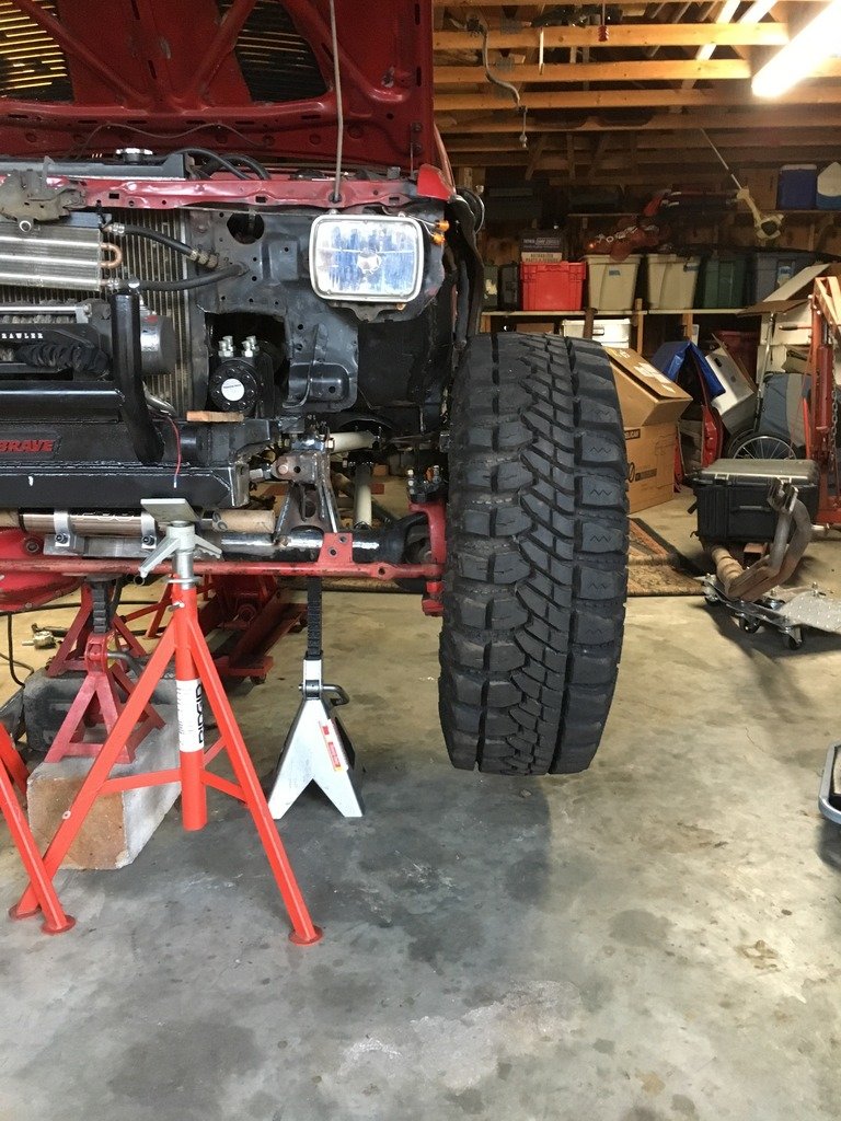

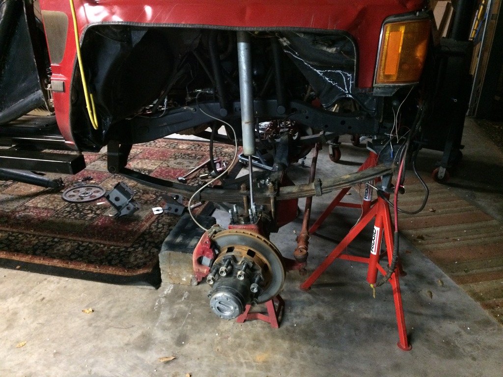

    Started tearing down the front end.
    C4397062-47B3-41EB-85CA-0AF8E11DB330_zps_aa525965cab8f6accf249541957156e5f306b5d5.jpg
    24BE1772-D594-4EB1-B440-DA869FBD34EC_zps_8c1c2a79cab4cebe804d06f1fc9d1a8e359a4ff5.jpg

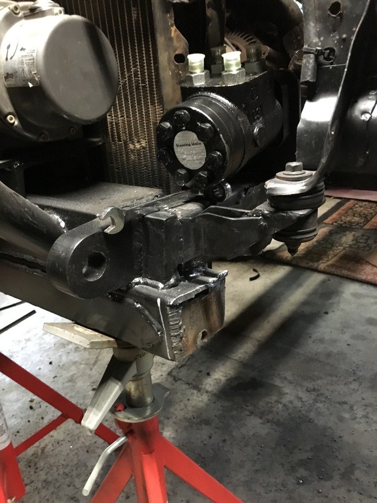

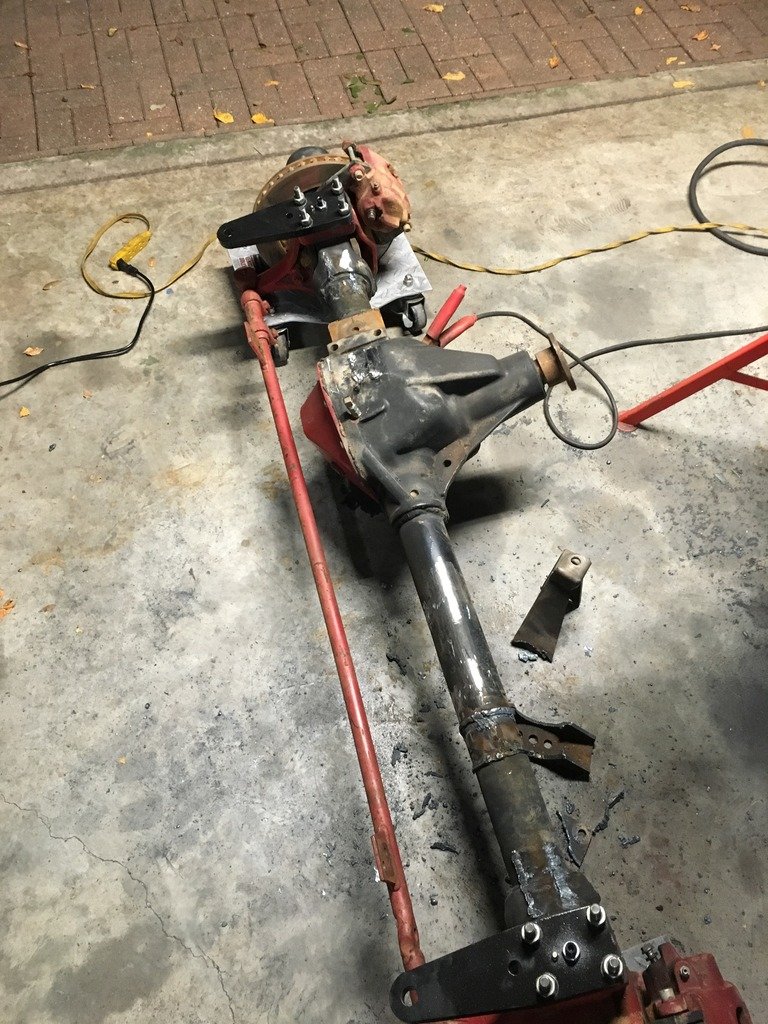

    Houston

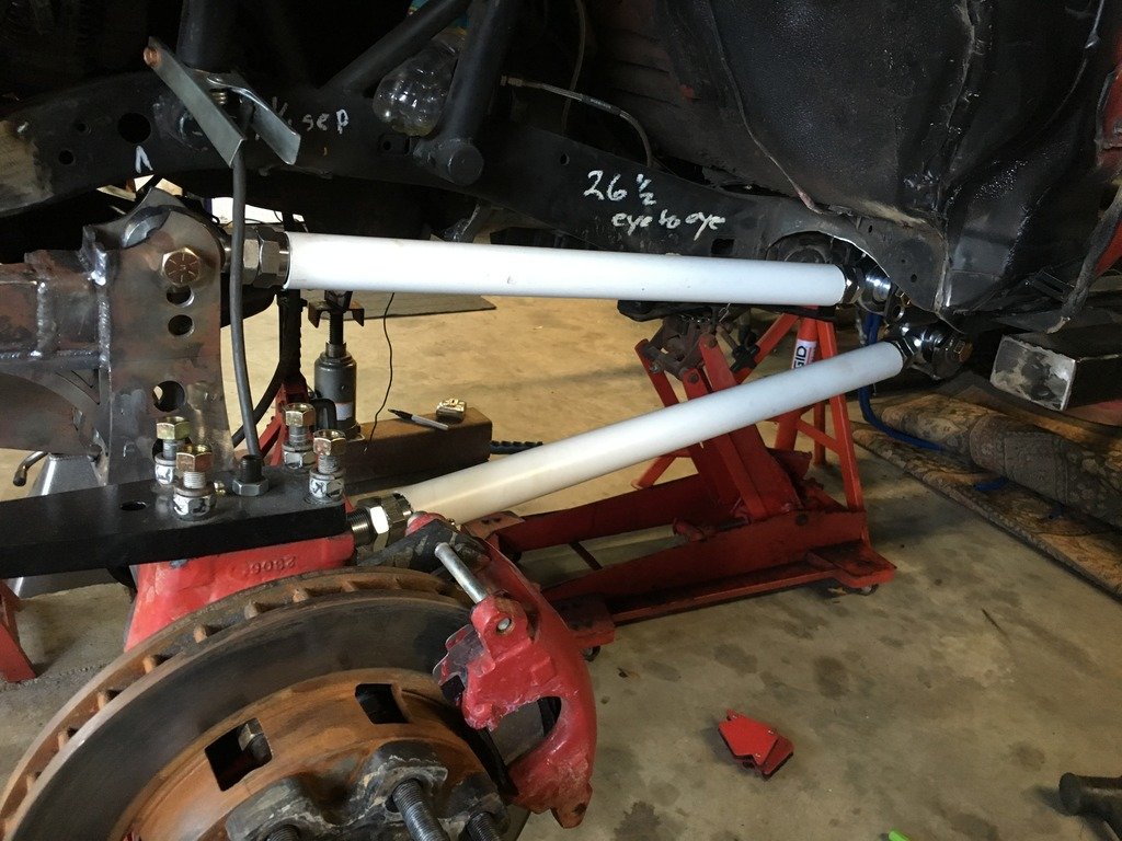

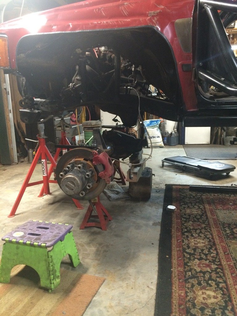

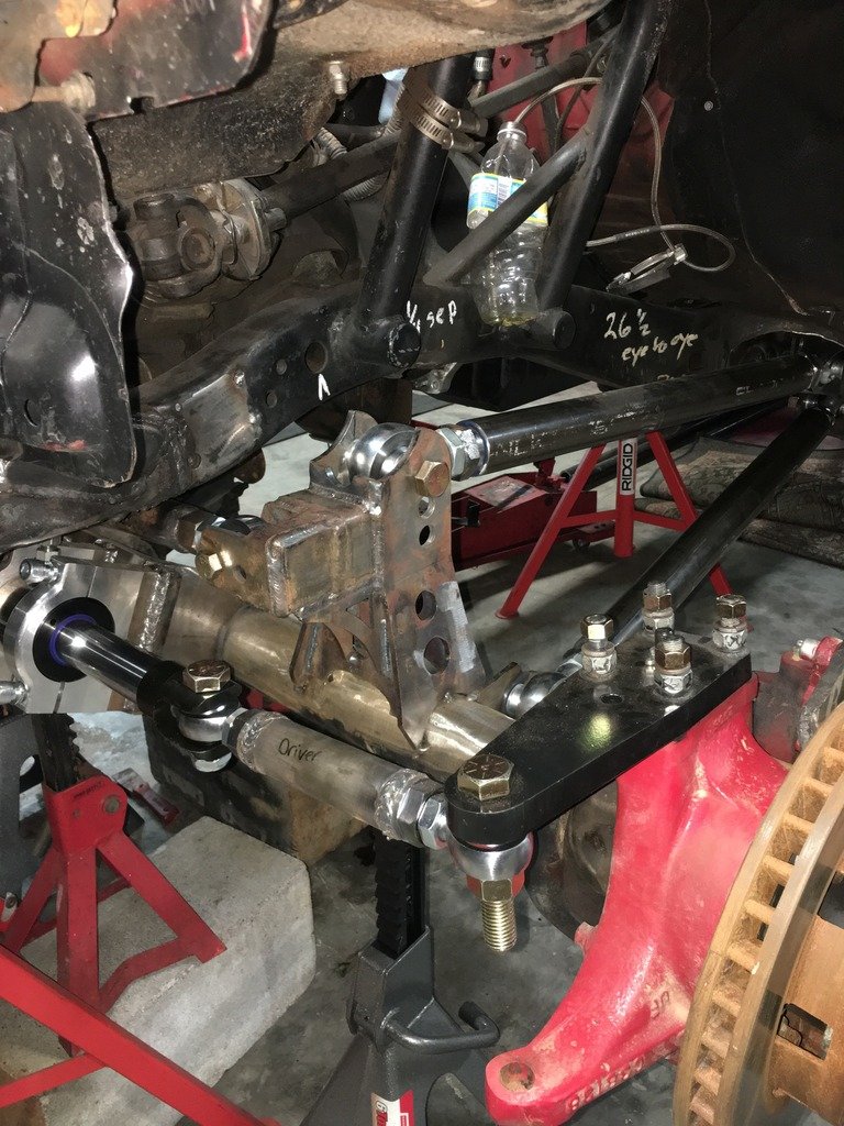

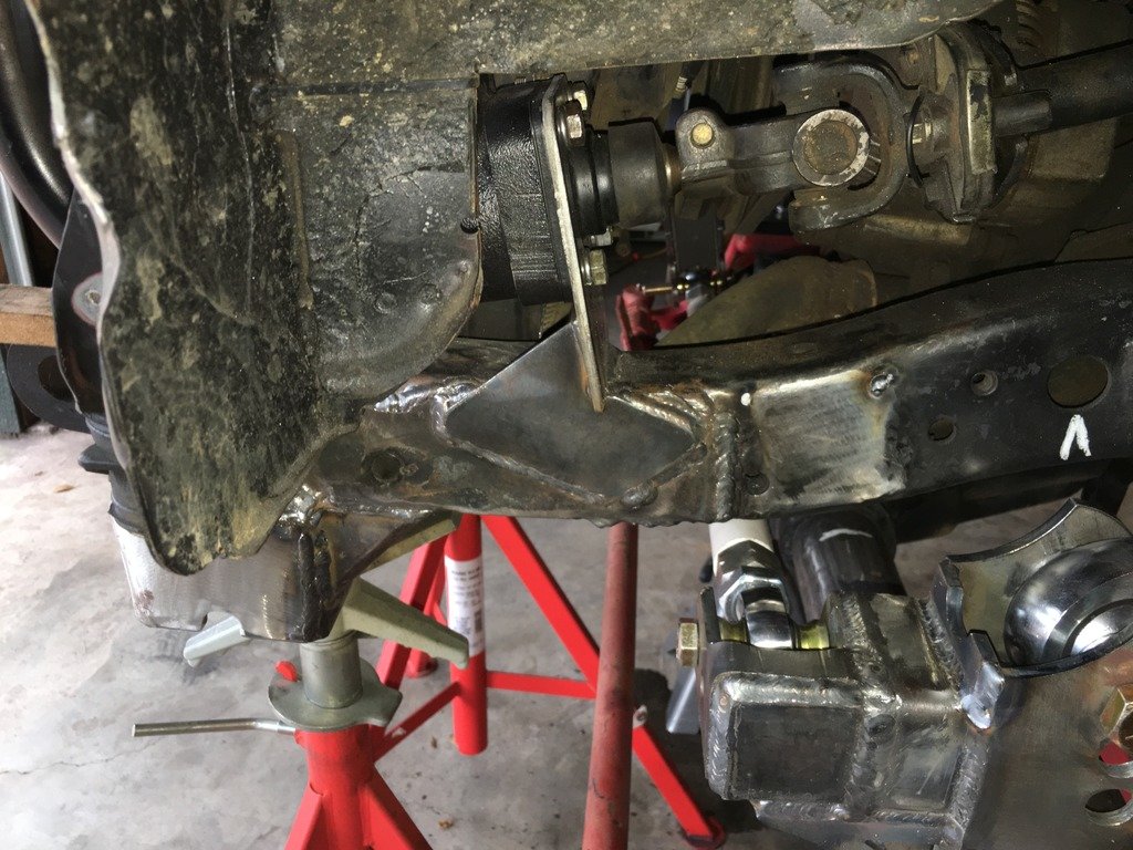

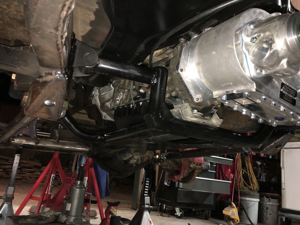

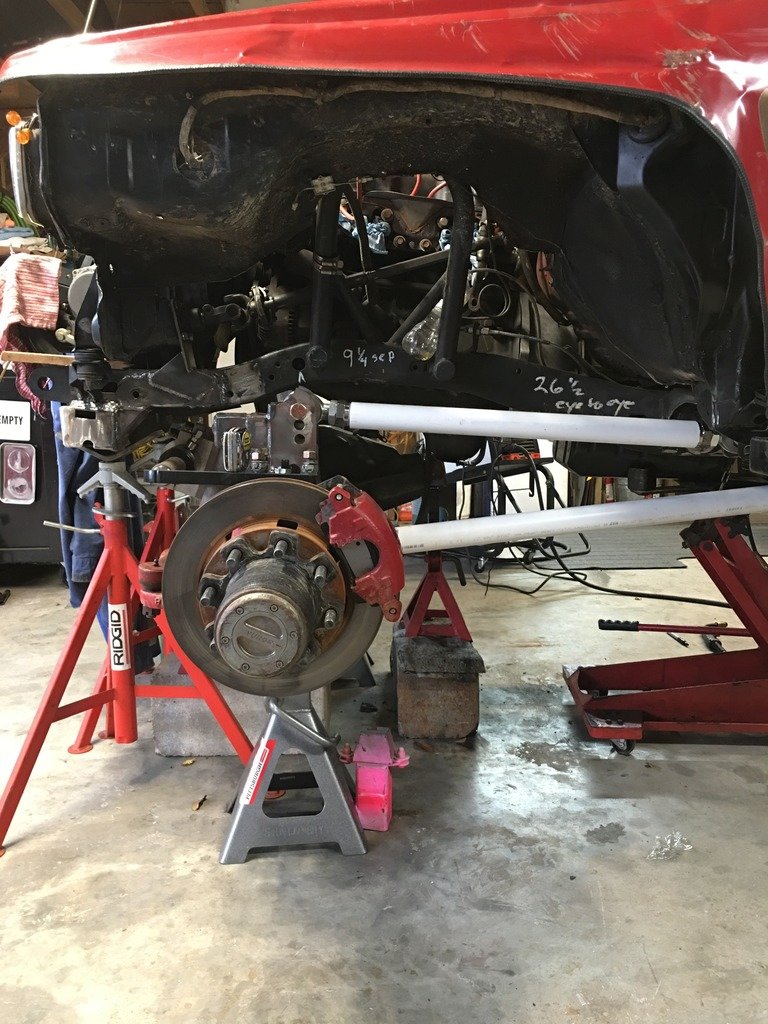

    I have been working on stripping down the front end in preparation for the 3 link. The D60 is sitting on jack stands waiting for the old brackets to be cut off. The Plasma list is pretty long...
    82777FAE-78FC-4AFE-9A5E-793FF2829687_zps_4ec0bae6a78b3bf8f72115f970b7be1afb42cae1.jpg

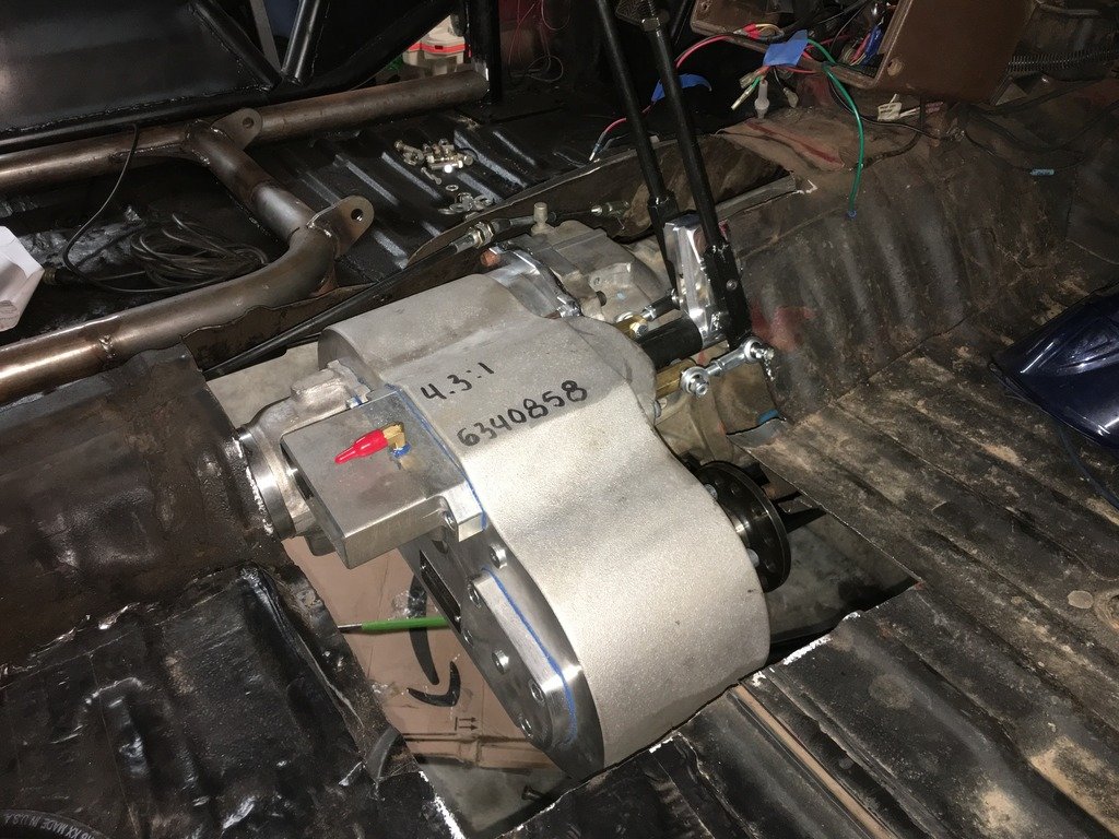

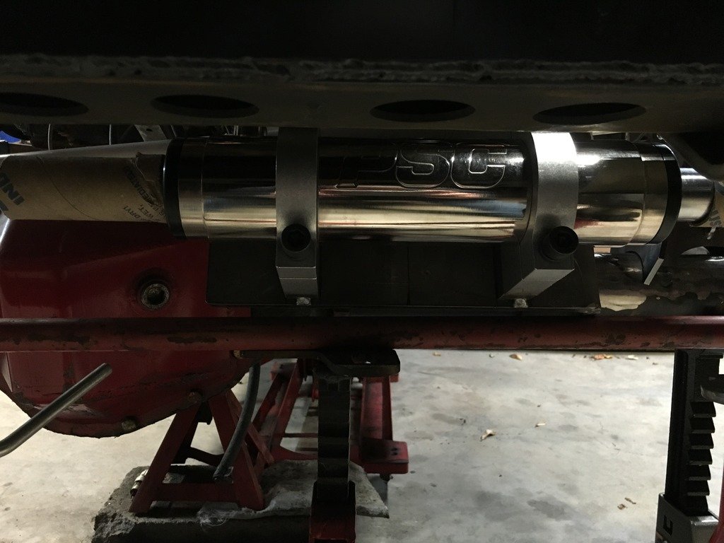

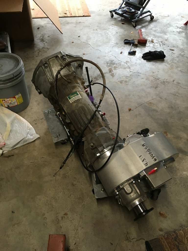

    The transmission is ready to install. The RAD Designs bracket, lever and shift cable are installed. The Flexplate and dust cover are installed and torqued down. I picked up some DEX 3 fluid. Transmission cross member is mocked up and needs to be cut, fit and welded up.
    3 Link parts are piling up around the garage.
    • TG 7.3 orbital,mount and steering shaft adapter
    • PSC XR 2.5 DE ram, clamps and clevis kit
    • Artec upper and lower link brackets/tie rod links
    • Artec adjustable upper axle link
    • Rockwell Offroad 1.25 heims, misalignment spacers and tube adapters
    • RuffStuff Panhard brackets, 7/8 heims and 4 ft of 1.5 .25 DOM
    • 24' of 2" .25 WT DOM for the links
    I drilled out all of the holes on the brackets to 3/4" That was fun. NOT!
    Then I welded them all up.
    I should be torching off the brackets on the 60, trimming the from leaf spring hanger and removing the shock hoops soon.

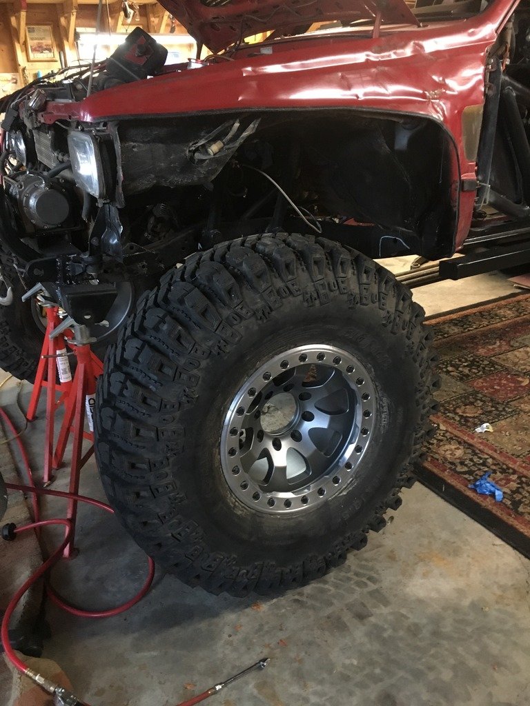

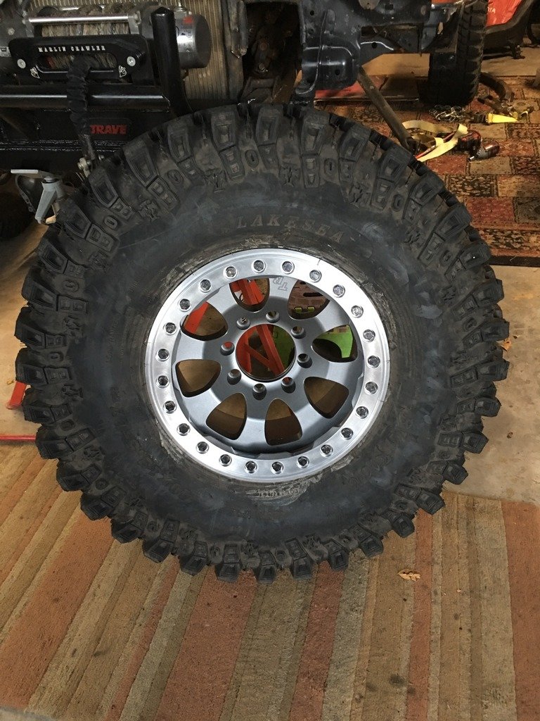

    Well, I bit the bullet and bought some beadlocks. Hopefully they will cure my tire problems on future wheeling trips.
    They are fairly new on the market and are a joint venture between TrailReady and American Eagle Alloys.
    TR Hardrock - Series 025 - TRUE BEAD-LOCK (Single Wheel)
    Hopefully they cure my tire debeading problems.
    ajohnson likes this.
  11. Sep 29, 2016 at 1:57 PM

  13. Oct 10, 2016 at 8:27 PM
    #433
    Boomtacoma01
    Boomtacoma01 [OP] Well-Known Member
    Dec 7, 2009
    #27162
    1,383
    Houston
    1 down 3 to go...
    5EAC3E2D-4CF8-479F-92E4-FC1DBBE20EEF_zps_4984a53d924444e928ef279d85945cd1482d059c.jpg
    This wheel and tire combo is growing on me. I hope they work as well as they look.
    I finally have my own plasma cutter so things should be moving along a little faster pace.
    Found and older Thermal Dynamics Cutmaster 50 for a really good price. Lucky me.
    Ugly Betty, ajohnson and phillstill like this.

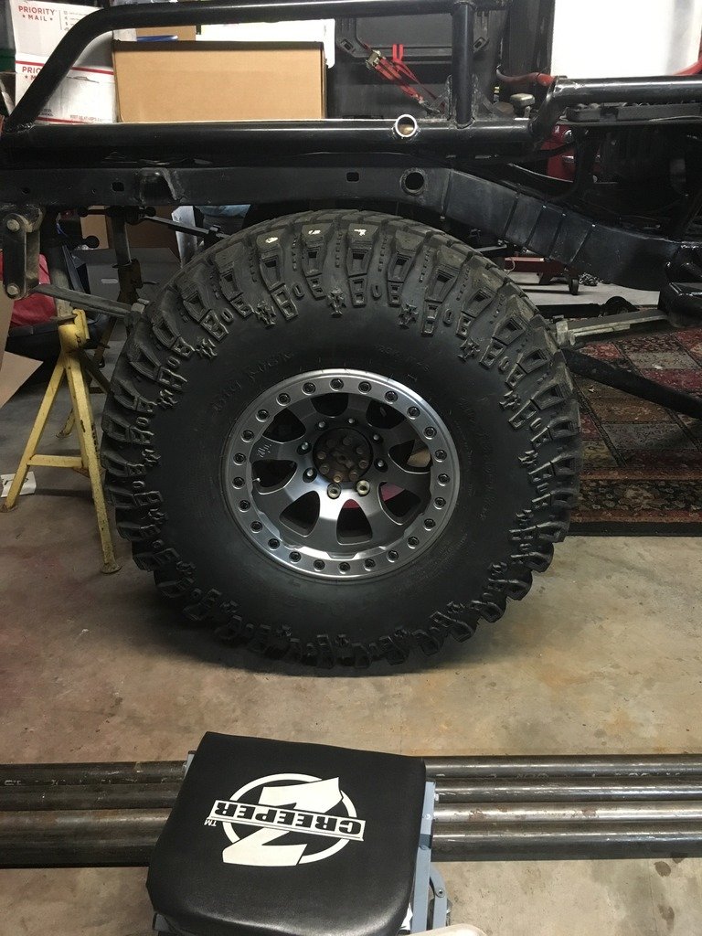

    I got the second tire mounted up on Wednesday substantially faster than the first one. I brought the other 2 to Discount Tire to get dismounted today. I had the chance to use my Thermal Dynamics plasma last night. Besides being an older model, this unit blasts through steel with ease. I trimmed the front leaf spring hanger, driver side body mount, ifs steering box mount and some inner frame brackets. I also cut the front fenders a little higher, deleted the parking/turn signal lights and reinstalled the fender molding. Plan for this evening and weekend is to burn off the D60 leaf perch, hydro steering bracket and shock mounts. I also mocked up my orbital steering valve and made a nice place for it to mount where the IFS steering box was located.
    F70C8277-F14A-4CC1-AB3D-A0BE9B3598CB_zps_f35576ad82f39752b8ce5868af7b5e9200079ff4.jpg
    Mounted the tires on the 14b. I had to order some small diameter lugs which should be here on Tuesday.
    D79CD221-CC5B-4B79-9B1F-16430FD0DA09_zps_ad355ad1292cbf0bcaab6f5eed35d5af8a712966.jpg

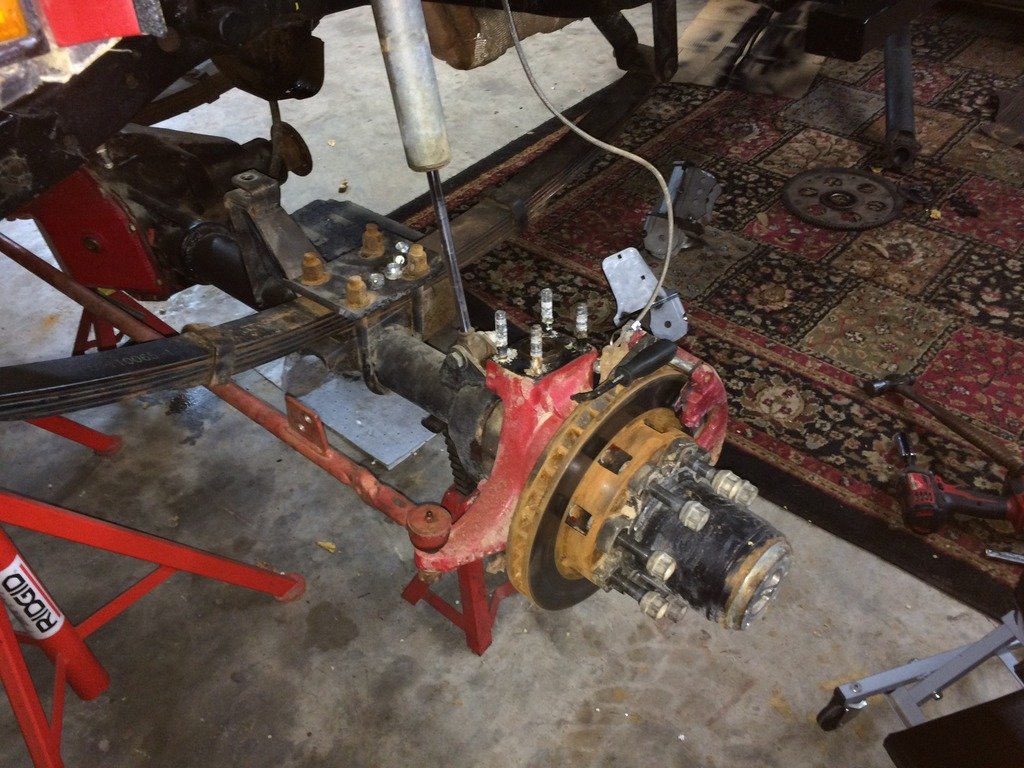

    Working on a few thing as of late. My Atlas should be here in Tuesday.

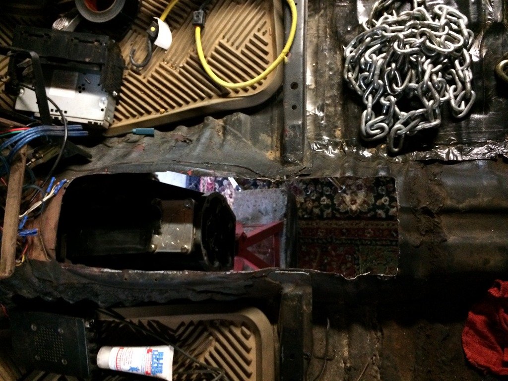

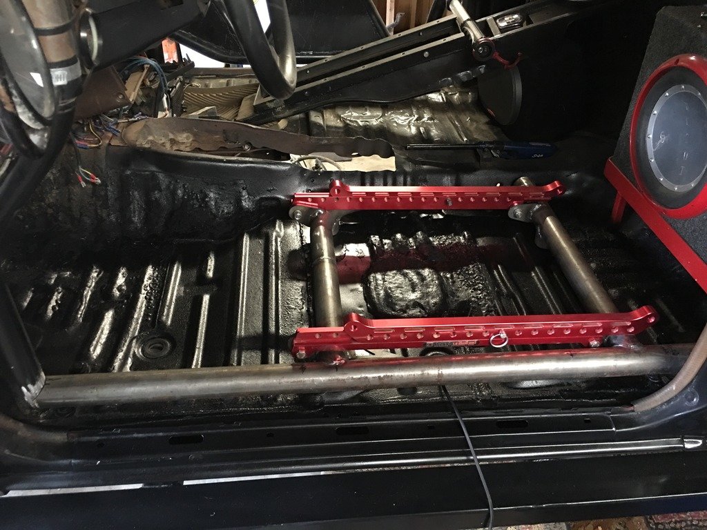

    Had to fab up a new subframe for my driver side seat
    F3657CE7-172D-413E-AED6-F3642EC81CEC_zps_c8a2887a0a0343e93ed5702914943ce4c42bd3e1.jpg
    Orbital mocked up
    FAE6399B-9072-4472-ACAE-1D69499EC100_zps_9ed346410e5eb0cc0b2a4823e8caba8d9dc708ab.jpg
    8046CB7A-7B0B-4972-B40C-37CBE15CADFC_zps_93d80552e11bafa933f41dcca0f65727843ee81f.jpg
    Old brackets went away
    ED2A16F4-5E69-4779-A1FC-3D66F4D0B3F3_zps_35ed43759c783c93409e993c04803e29a21ab799.jpg

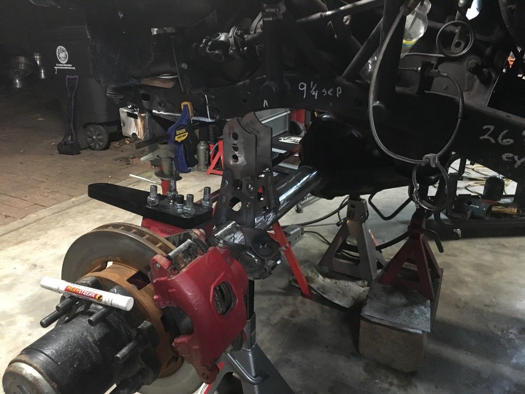

    Axle in place mocking up bracket placement.
    8BB1CE5C-86FF-4A5D-898E-27B40BFC6A04_zps_d0f99b7efeeed9b4e5423525feccb778a35d16cc.jpg
  16. Nov 9, 2016 at 8:25 AM
    #436
    Boomtacoma01
    Dec 7, 2009
    #27162
    1,383
    Houston

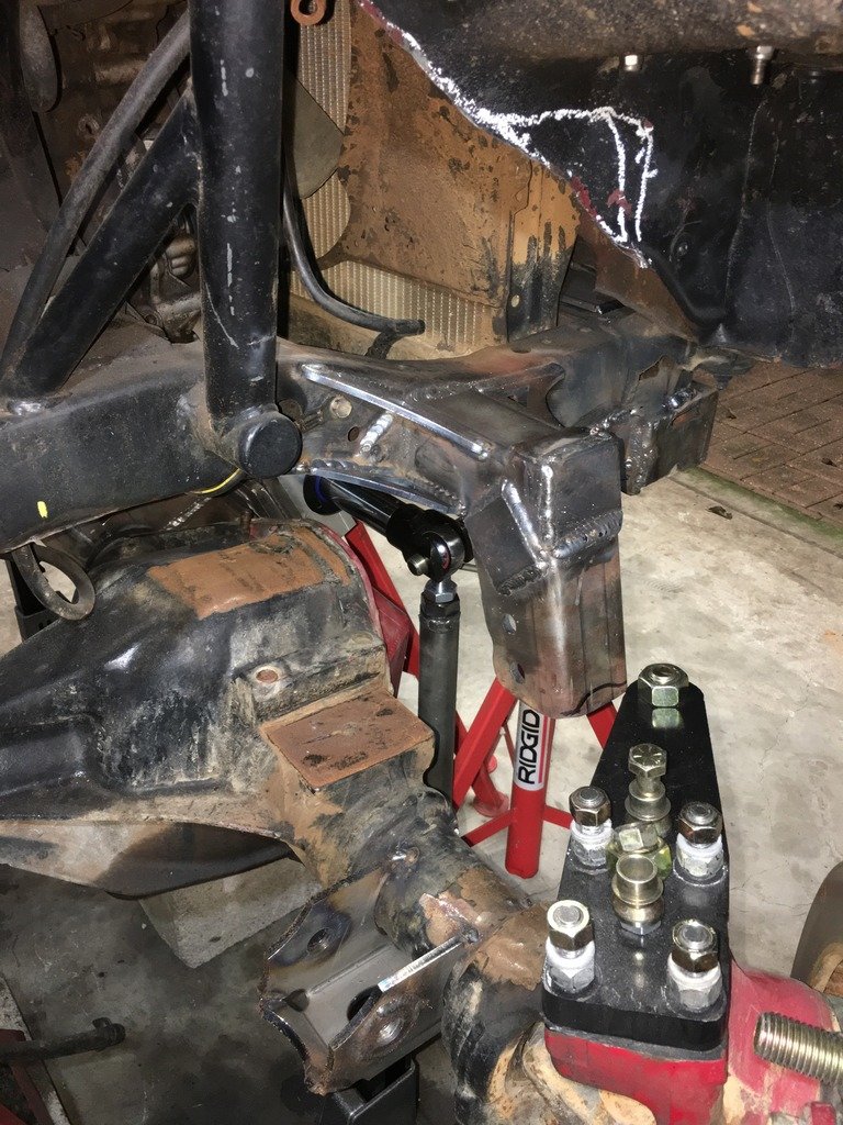

    A little more progress.
    Cleaned up the frame and body mount. I'm running the upper link frame mount here.

    Looks like I will have a 32-33" upper link and approximately 40" lower link in this configuration.
    Orbital mount finished up.

    Atlas mocked up on the A340F.
    76AA15EB-BAB7-4314-AFB2-3693F4962D84_zps_f9b1df585de80ba77605151cd12a68b9b6f6d950.jpg
    Initially fit into place
    65129810-55AE-4AA8-9DFA-952ECF4D660D_zps_e6c36ce5f1b7720111bac23e91d39115f270273c.jpg

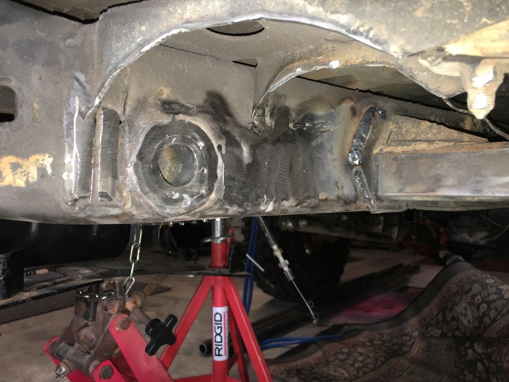

    Big hole in the floor. I have to relocate the fuel return lines here. I also need to figure out some sort of skid plate for the transmission pan. A little too exposed for my liking.
    F6D324BC-96AC-4305-9167-5F38646302C9_zps_3eff22c7b323469fef27b2ceced008bb7fff3966.jpg
    Frame mount upper link bracket with panhard mount tied in. Panhard will be 32-33" as it sits
    4F96DE49-0153-4773-A393-5B42C4EA2158_zps_9b1da9a6c3e6246e39bd4e6bca1cc55cca910206.jpg

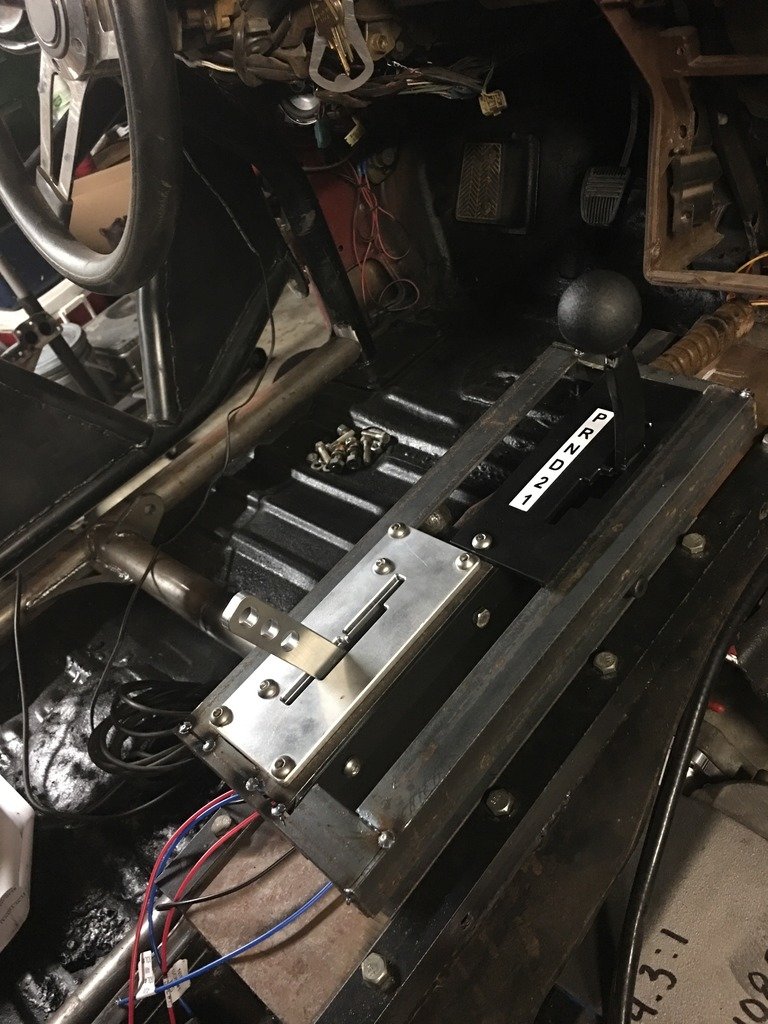

    Worked a little more in the interior this weekend. I cut a new plate for my transmission tunnel cover and got my shifters mocked up.
    D05510FC-6B46-4462-9EEF-0820441F543E_zps_a6c6d02350b1efade47eab687f3091ff0aff598d.jpg

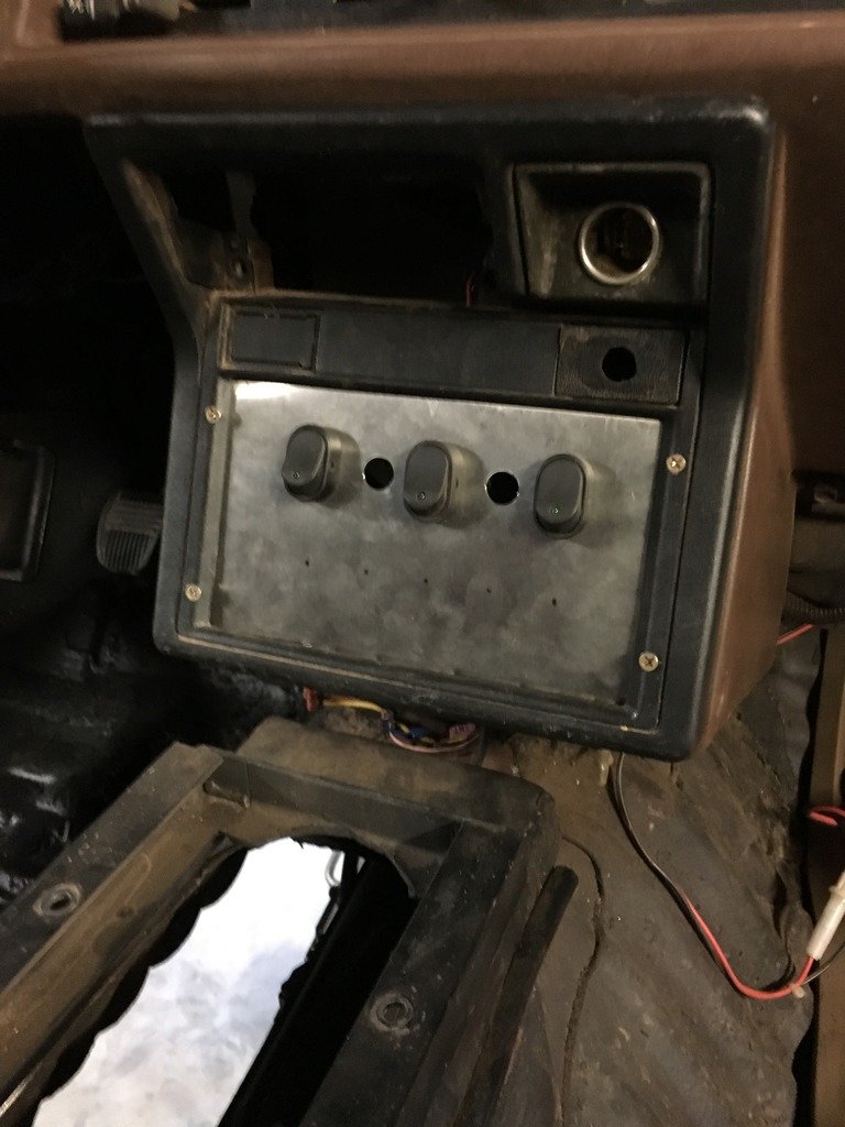

    Since my radio fried at Hot Springs during the monsoon, I decided to make the radio area a spot for some switches. They will control various lights, the trans cooler and some other things. The trans temp gauge may go in there as well since I have the room. I need a few more rocker switches to finish it up. The plate is a piece of stainless sheet metal that I had laying around and I have about 10 bucks in switches invested.
    896C361F-7011-40D3-A798-E84DEDF1CBCC_zps_a6ee06839ff5e23367682289649b4aae2c861661.jpg

    A little more progress...

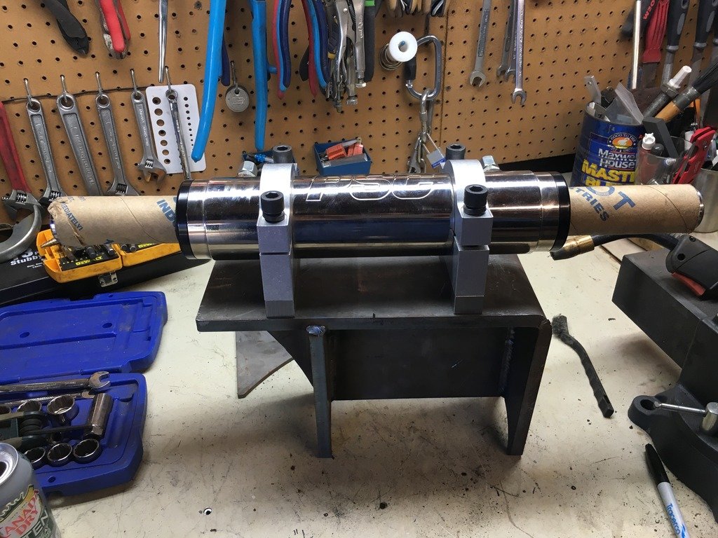

    Blue Torch Fab full hydro mount and PSC XR 2.5x8 DE Ram
    34AB6584-6CDB-43CD-9F66-AE5E81EED49D_zps_eb5eed4978630df7b216fdaeb23e01e13baf6fa1.jpg

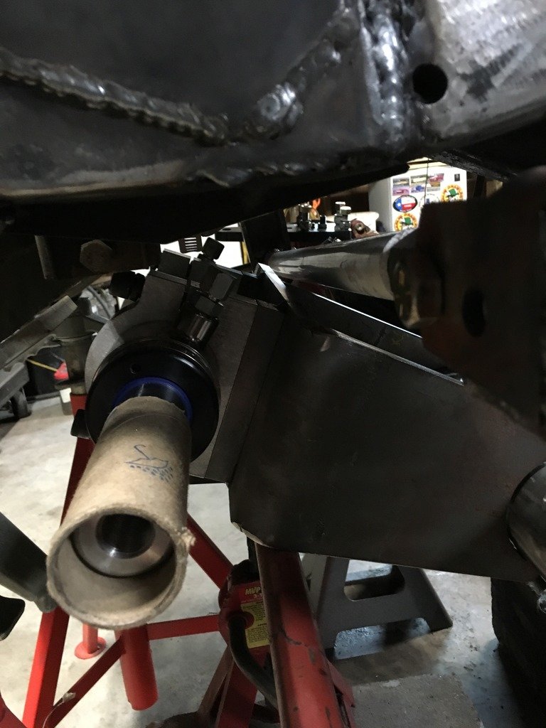

    PVC mock up links in place on the Driver side. Ended up with a 32 in uper and 39" lower.
    1C5B464A-8189-4669-9631-846E4BD78E23_zps_00c04d3b6b2bca41c369c3d3c878e4d6f51a633c.jpg
    25A75B5C-31CB-4FA1-9220-26D368F26E83_zps_ae1b349f1f6e230c01e7743fc8943a8636da8611.jpg
    Threw a tire on to see what it is going to look like. Tire is 5 inches off the ground in the picture.
    F466FD29-9051-46F9-8EEB-FF174273A3F7_zps_71740b5ec068ce27e6ae017d792afcff2d1b1a94.jpg

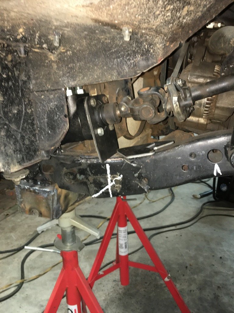

    I started on my transmission X-member and skid plate. Its has been a challenge to say the least. I have to work round the exhaust and driveshaft and a few other things. I almost have a complete flat belly right now. The Atlas is hanging down about 1.5-2 inches below the frame. It will be mounted with 6 bushings to the frame rail. I should have it mostly done tomorrow hopefully.
    Then, I need to drop the trans and TC to get them bolted together completely and install the Torque Converter and reinstall.

    I had some fitment issues with my hydro mount. I had to trim about 3 inches out of the mount to get my steering linkage at a better angle and buy me some room by the lower radiator hose. I also added 2 more clamp mounts for the ram.
    60230587-0382-46E2-82AD-B54199A74A95_zps_019298233268b99c145644d1dde51c511e75c954.jpg
    I also got my 2" .25 DOM links and the 1.5" DOM panhard cut. I extended my frame side panhard mount to add some length. Killed my HF Sawzall. Had to order up a quality Milwaukee one to replace it.
    9B648C8F-D040-487E-877A-8B9722E5731C_zps_b9d71f038544efc85ac66a29819db381f585453b.jpg
    E32744EB-0A42-4223-8986-96DC50178D7F_zps_71b411950f562d226440c03d928fe33788a13e35.jpg
    I got my transmission and Atlas dropped for final assembly and trimmed the hole a little more. I will have to put my sheet metal skills to work to patch this hole and get my passenger seat mounted.
    1C0E0D84-25C2-44F0-BD5F-1004774993EE_zps_4e4eb46f994de71c0f4d522ab66a9a1c50b68911.jpg
    9F518C3C-7F5A-4B9C-A062-743647A655D8_zps_1210af7c1605cdfa440964a64c6630908ca10e00.jpg
    I hope to have it back in place this weekend after I get my crossmember mounts burnt in and do some more finish grinding on the inner frame.
    I finally got the A340 and Atlas together and sealed up. I burned in the crossmember mounts and skinned the transmission/ transfer case skid with a piece of AR500 plate.
    85B59520-8EBD-4154-80AB-47BB58C889CC_zps_d98d44444a26025c8448a57b2ab41bf0838ec21b.jpg
    0D8F9EDB-1474-4E95-8066-BFFA7FD50BE1_zps_61c3bccf531d2da017e19a2b0fddc26ce13a4775.jpg
    0CE76A8F-4D64-4DC7-B3B7-86C1F28021AB_zps_cd749680117ba40b5b1f920548824bef158ff8c0.jpg
    B5562334-A4FB-4595-9844-0BED82DA1B47_zps_eef3675c506dc0a2853bf579ff0c27f68a9f4b83.jpg
    I will be adding another crossmember for a tail support for the Atlas.

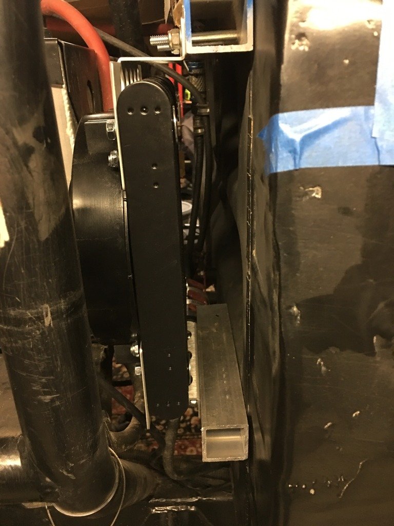

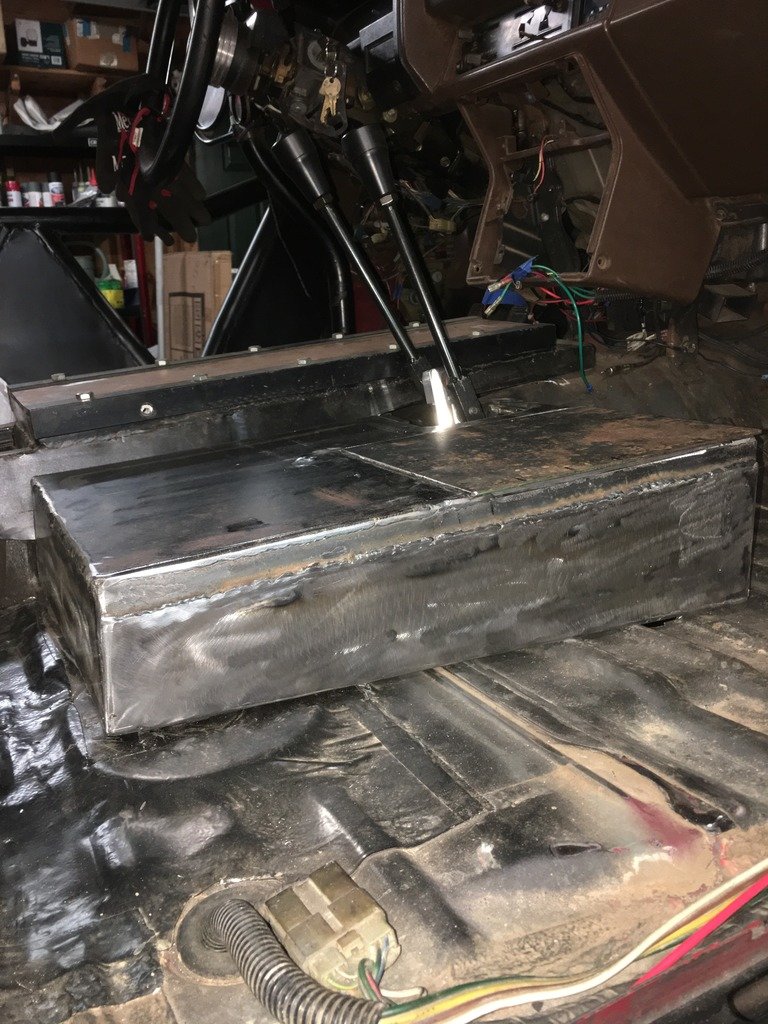

    I fabbed up a cover for my floor pan. Front cover will be removable to access the front driveshaft.
    32B31066-57D0-4777-8E90-A11D82DAB8F0_zps_c57528517503d35efb58596351357e0ae0301f0c.jpg
    E201E881-4FA9-4B4F-BBA3-A45113C8DC9C_zps_28c542307875ca6c9b63a01c5a0ad895a47b9ad1.jpg
    8BEA8E02-35ED-4536-B99E-9D29754B1292_zps_fd03e61dcafe4cedd3e248c40fca34a5f6d05681.jpg

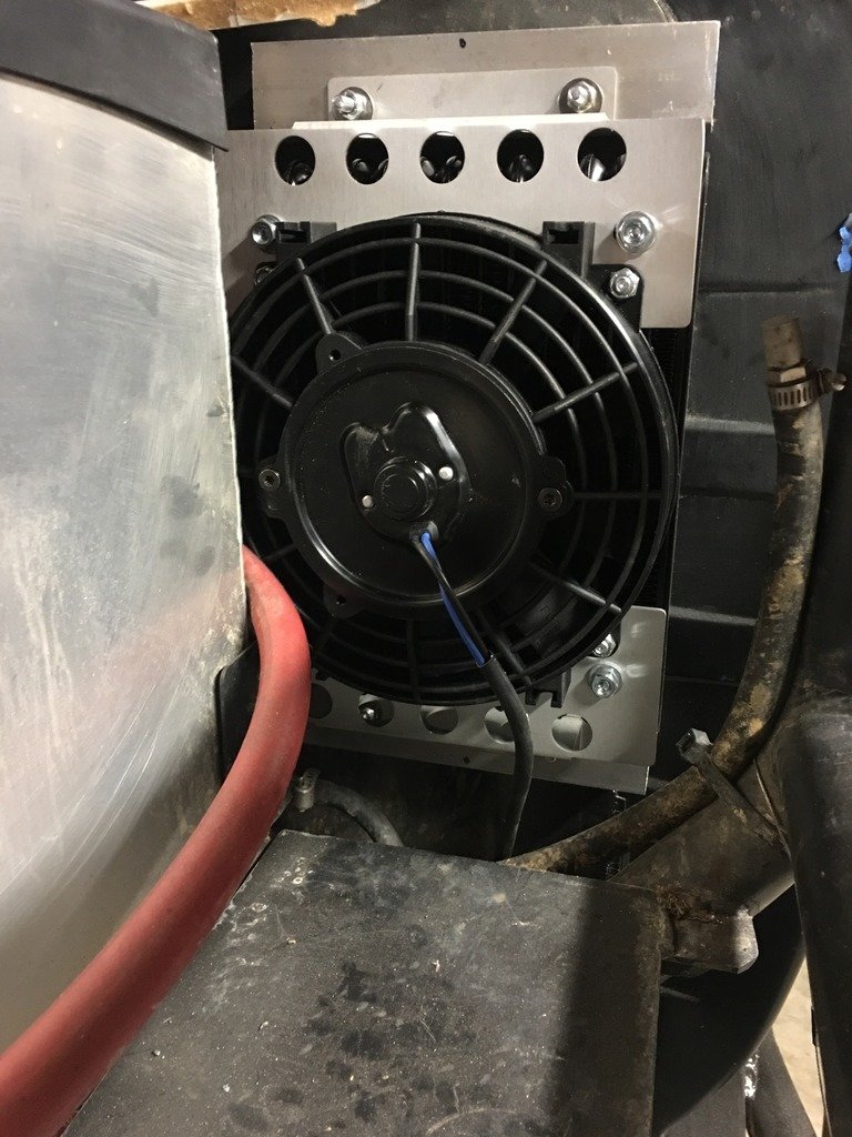

    I got my Derale trans cooler mounted.
    BEA4CF02-951B-4C72-9F6F-17B99BCABB41_zps_2d1ce557cc058b55458a884bd12b647ff68afbc3.jpg
    E3B89936-97A9-4846-B69B-6F8B13FF645F_zps_4efbb93a394b972a0137baa3a5699117ff88e424.jpg
