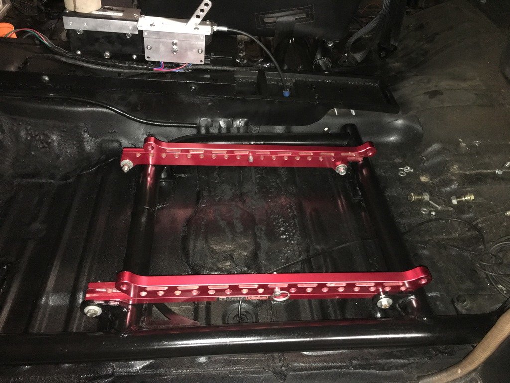

    Transfer case cover finished with the integrated seat mounts.

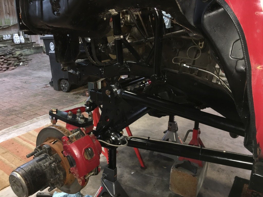

    Most importantly I started mocking up my Fox 14" coilovers. I had to cut off the shock hoops, move them forward about 2.5" and kick them back about 10 degrees. The lower shock mounts are from Artec and integrate to the lower link mounts. The upper shock hoop mounts are from Wide Open Design.

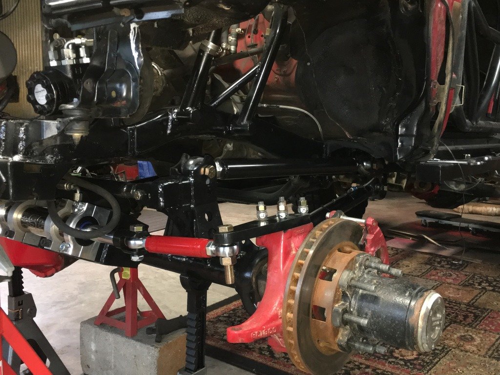

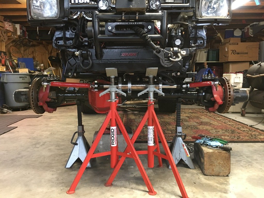

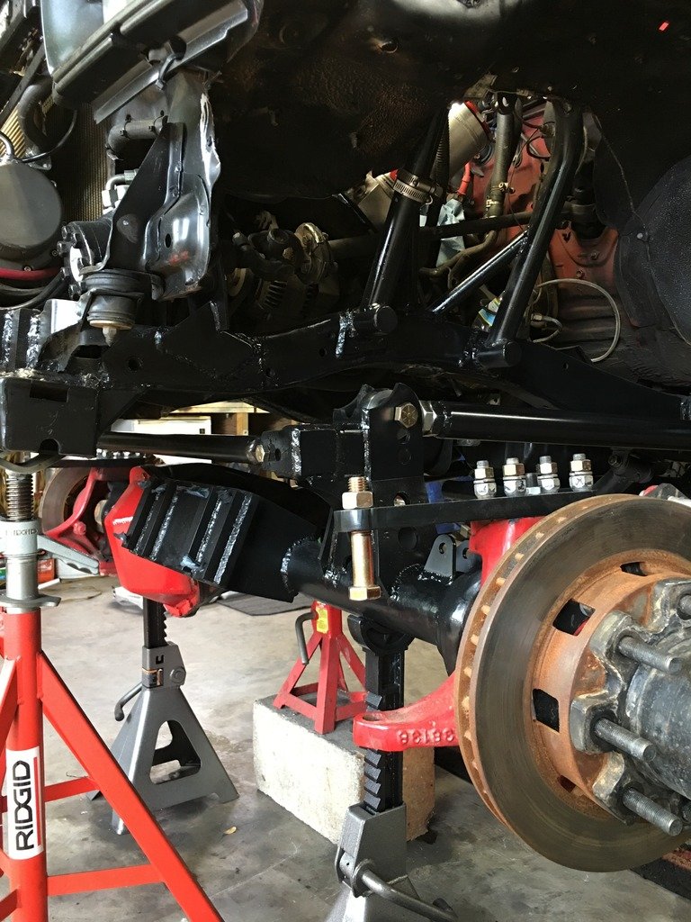

    I had a chance to work in the truck for a solid 3 days. I got the front welded out and painted. Both coilover mounts are done. The full hydro is mounted and the lines are plumbed. I finally finished mounting my last tire and torqued it to spec.
    I mounted the front grille and welded in the driver side seat mount.
    F7B790F4-8CAD-4125-B94E-33B81433DA24_zps_83526540c049d567bd7cfe30c3a94e0764e063c4.jpg
    CA1B7E10-4739-4696-A130-E98036EBF45C_zps_f190dcde24d9d04ebf095cbc11ff26454c479bf0.jpg
    7AC5ACFE-EF17-43E5-81A8-CAF714C70680_zps_91838e5a05f73d1d73d17886d186826565bd5588.jpg
    2769466D-AA77-4F5B-B143-2A4BD78FE97E_zps_d365040a318b1e48702bb5ee5754dfaee0a0588c.jpg
    9C1235E1-A199-484A-A596-842689F723D7_zps_52c32f75fa6b4fa6400e5418243356509db449ff.jpg
    I should have a roller by the end of the week when I get my coilovers back from Brave Motorsports. I'm pretty excited. It has been a long time coming.

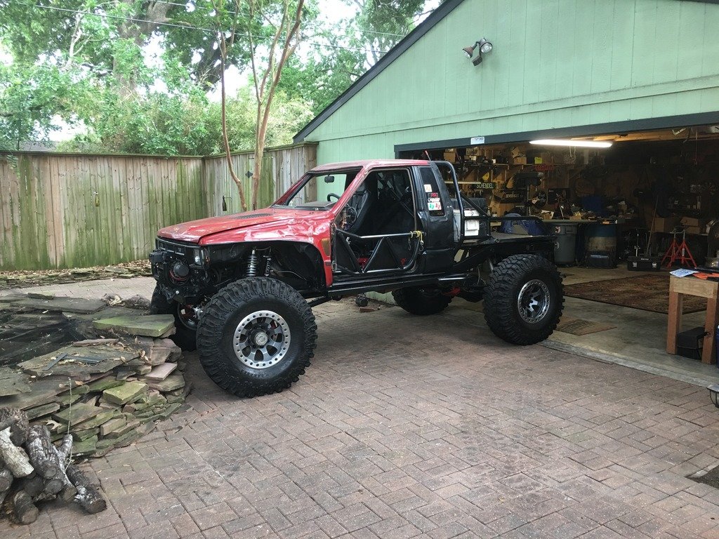

    Short test drive completed. Still a few things to check before I drive her in the street. Notice the tire shine
