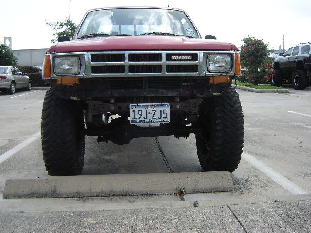

    Clean that cold start inj. It by far was the easiest thing that I have done so far. Less than 10 min easy.
    I need to get my 35's mounted so I can get Rob his tires. I am also kinda bummed a group of friends are going to hidden falls this weekend to wheel and I cant make it. I should have some good fender chopping pics soon though.

    In my above post 41 in the third pic there is a connection on the intake manifold beneath the "I" in "EFI". The rear bolt is a 12mm for the fuel line. Take it off first, the 2 bolts on the intake are 10 mm. 3 bolts total. You might have to bend the fuel line a little to get it out completely. I used some contact cleaner and cleaned it up really good and reassembled. Be careful of the small brass gasket on the fuel line bolt. Its easy to drop.

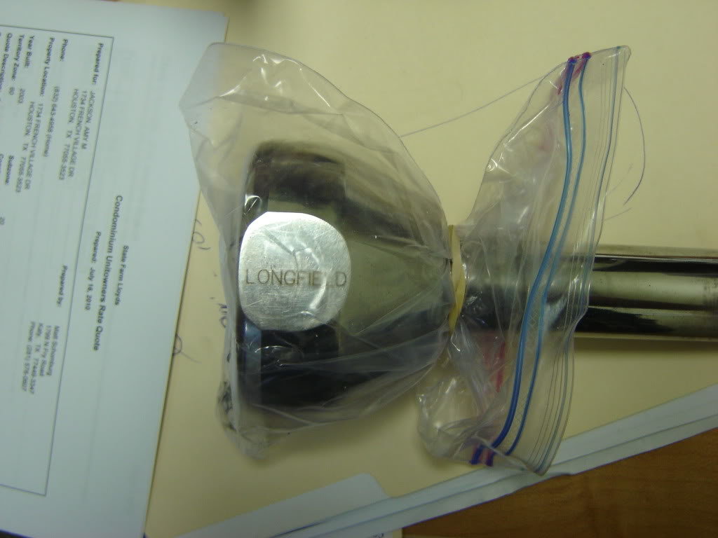

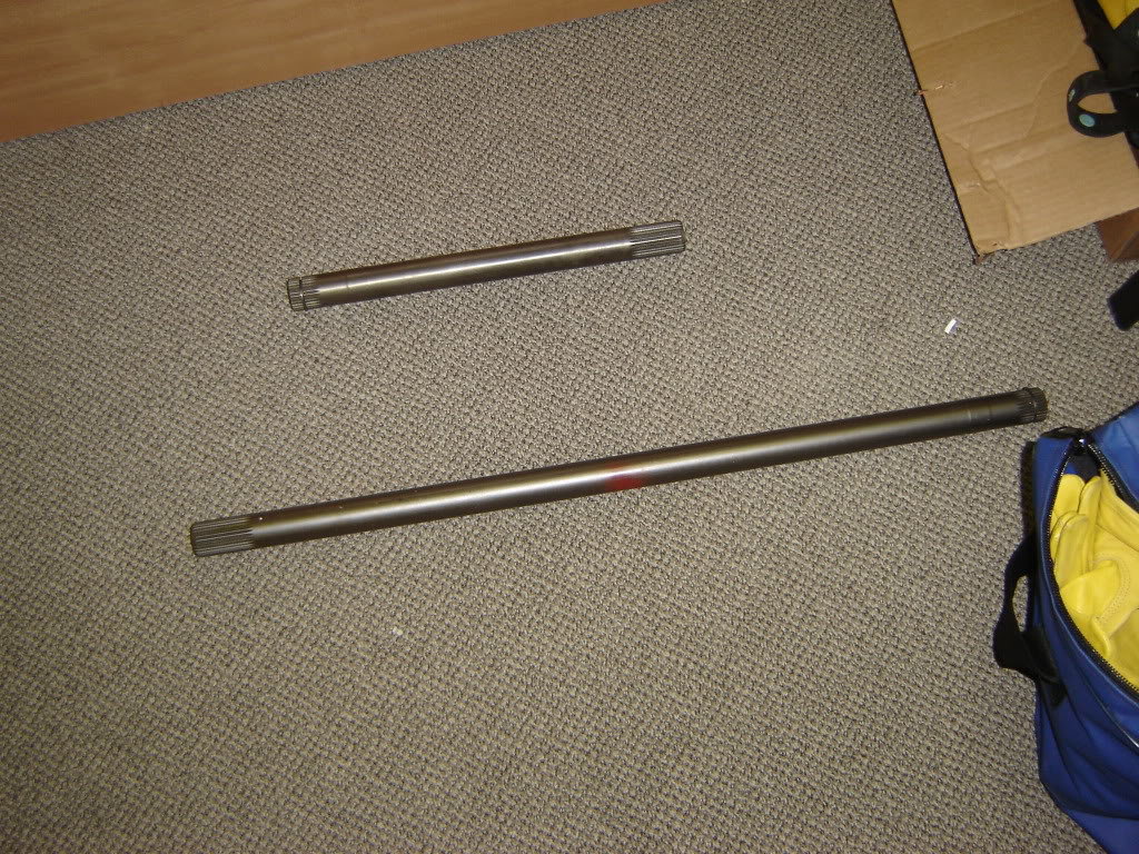

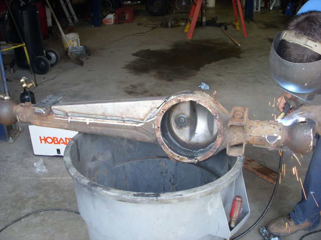

    Well I bit the bullet this morning and ordered a set of Longfields. Ill have to wait another month for my front bumper but thats fine with me.
    Since I'll be diving into my front axle and have all new parts for it; seemed only logical to order the Longs. The new internals include: Longs Chromo Hub Gears, Longs knuckle ball wipers, knuckle rebuild kit from TG and now the Longfield 30 spline axles. The new externals include: TG knuckle gusset kit, Marlin axle truss, Marlin wheel spacers, Marlin HiSteer.........
    Justifying the money for the axles was pretty easy considering they have a lifetime warranty.
    I think it will work well :)

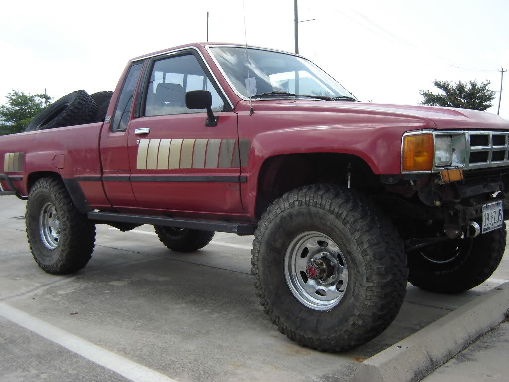

    Got the 35's put on this morning.
    I have a little rubbing but not too bad. This is only temporary for now anyways.
    Suprisingly the truck still seems to accelerate at the same pace as with the 33's.

    Awesome! They look good. 35 x12.5 15 BFG mud terains's?

    Yep. Ended up getting those instead of the 35 in MTR's.

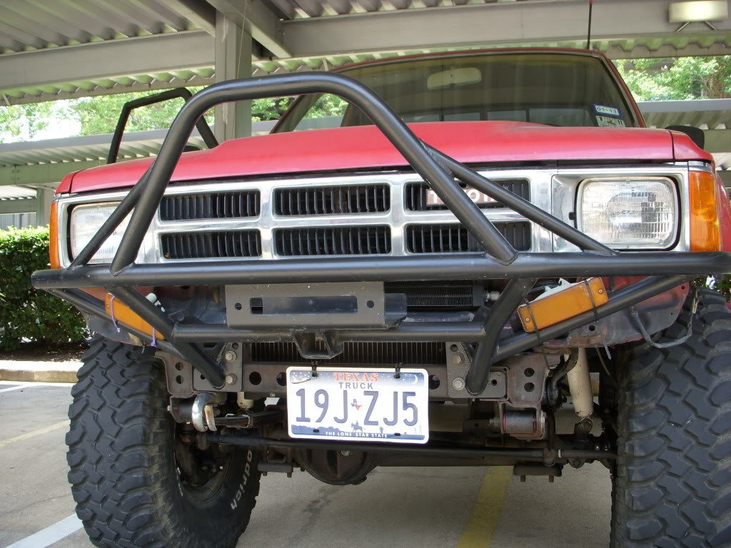

    Just by chance, I was talking to a wheeling buddy from TTORA last night and he is looking to get rid of his Marlin front bumper off his trail rig. He wants one with a little longer stinger on it.
    So long story short, I am the proud new owner of a Marlin Tube bumper. Should be picking it up Sat morning.

    I hope the mounting holes line up since he has an 86 4 Runner.
    If not I'll make it work :) Not trying to copy you too much Sean, but this was a deal I couldnt pass up

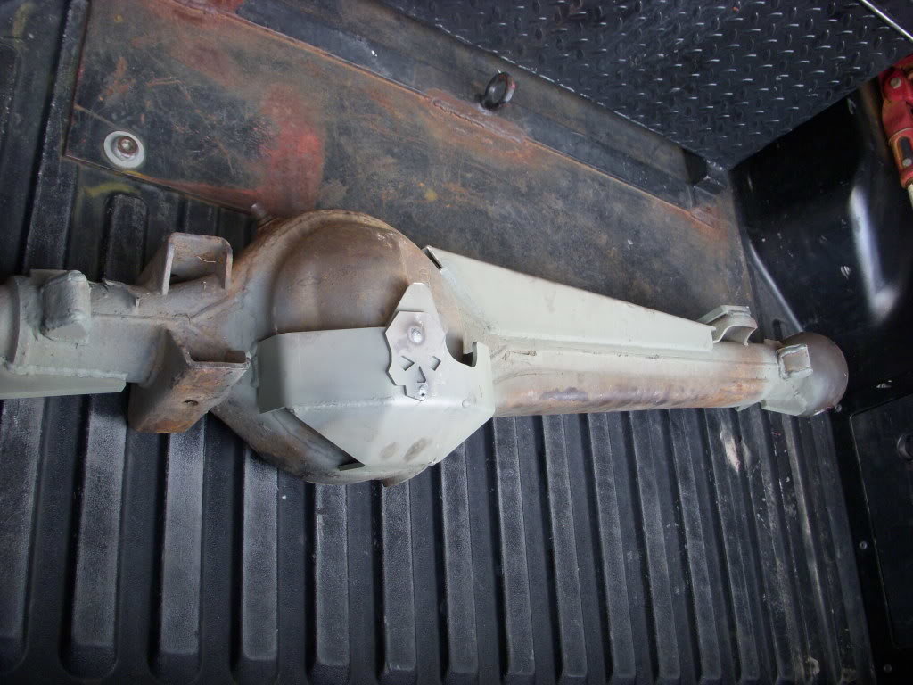

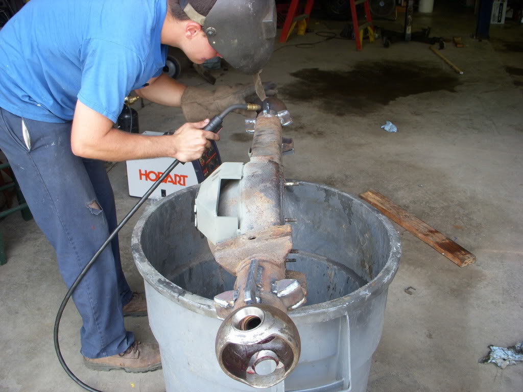

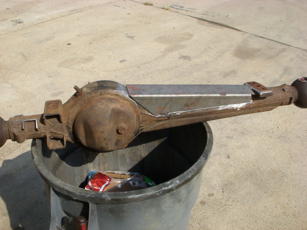

    Got some work done today:) Knuckle gussets, Top axle truss, steering stops reinforced, ring gear guards, 3/8" spacer in DS spring perch, and a Balistic Fab skull :)
    Kinda Complete:
    Longs:
    Got my Marlin front winch bumper (winch to be put on this week I hope)

    #27162
    1,390
    Houston
    It was a little tight but it worked. (That's what she said.)
