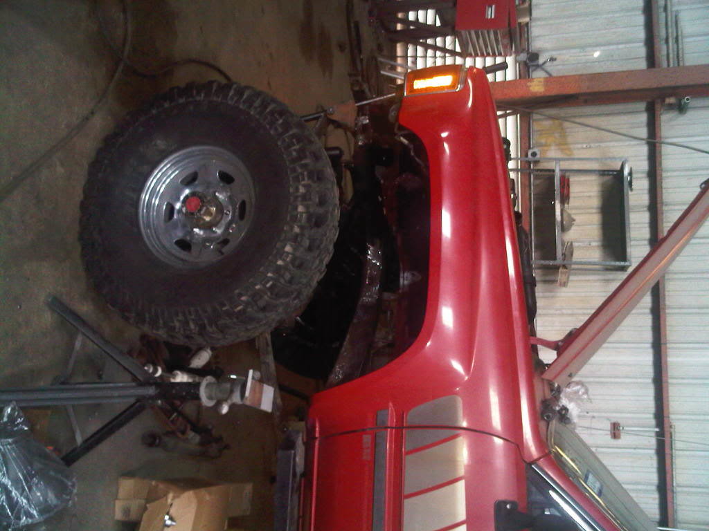

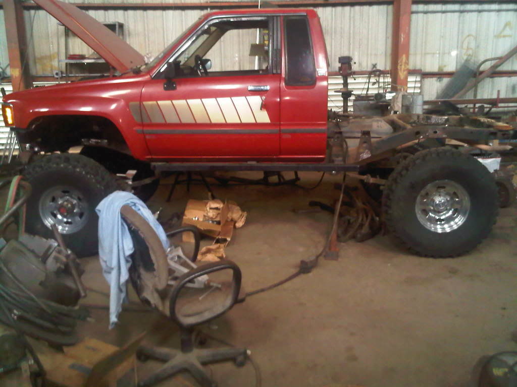

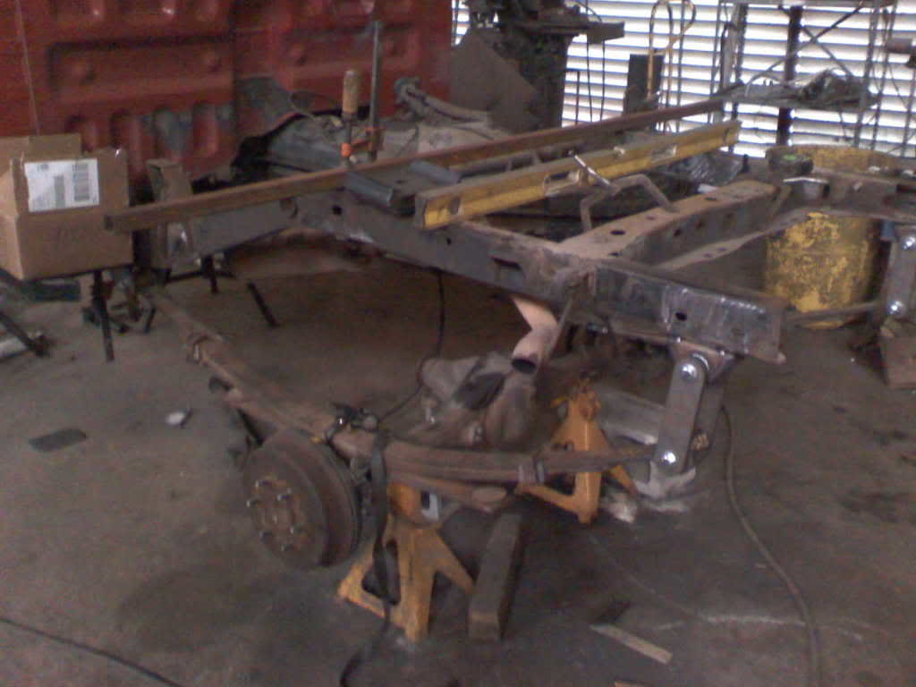

    I went and saw Dale yesterday and this is what he had started :D
    I apologise for the cameraphone pics
    63's mocked up
    rear shot
  12. Aug 20, 2010 at 7:43 AM
    #72
    Dark Knight
    Dark Knight Well-Known Member
    Jul 18, 2008
    #8006
    9,804
    Jeff
    NC/SC
    4Runner Trail, 88 pickup, Tundra Platinum
    A few bolts are different.
    Shaweeet! good by push-pull steering.
  13. Aug 20, 2010 at 7:57 AM
    #73
    Boomtacoma01
    Boomtacoma01 [OP] Well-Known Member
    Dec 7, 2009
    #27162
    1,390
    Houston
    Ya no shit good bye to that crap. My IFS rear is in the shop and should be bolted on today or tomorrow after the the rear spring mounts are pushed up a bit and burned in. They are just tacked in the stock location for right now thats why the shackle angle is so shitty. The thing I am most pleased with (so far) is the care that was taken cutting the old spring mounts out with out notching the frame along with losing the push/pull steering.

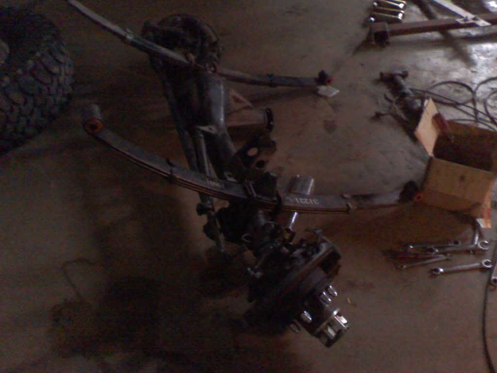

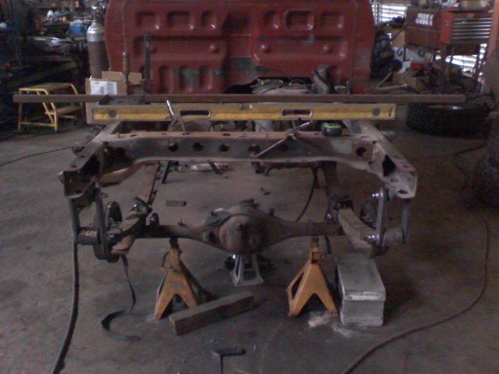

    Some updates
    I only got a couple. The wheelbase is sitting at 113" right now. Front has been burned in and pushed forward about 3.5" over stock. Approach angle is looking really nice. The overloads on the 63's are going to have to be trimmed down a little but other than that the rear is done

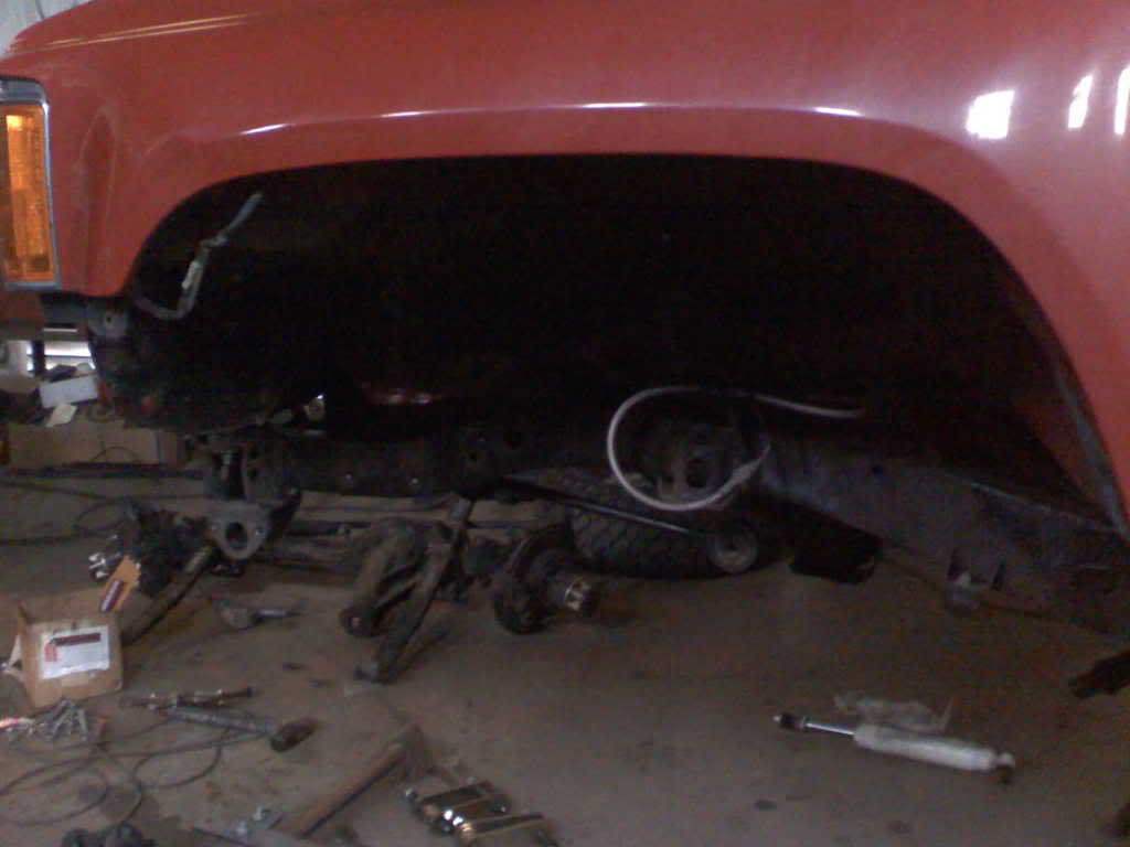

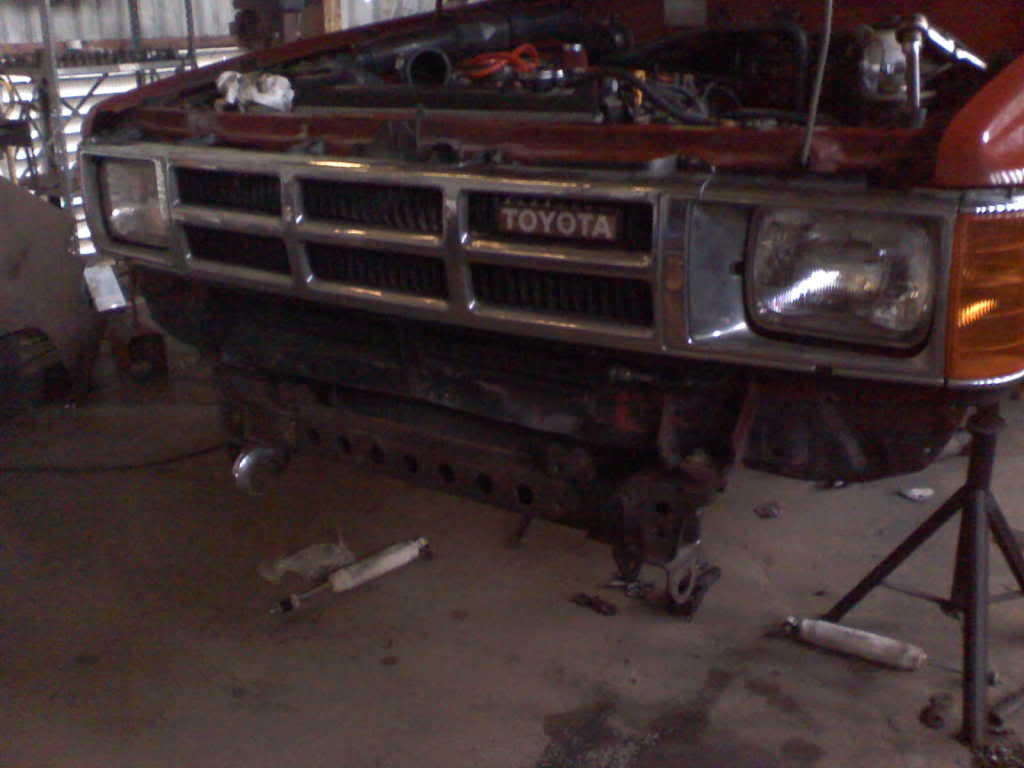

    Here is a close up of the front stretch. I like it a lot. The front is about 1/2" high and will settle out with the bumper and winch installed
