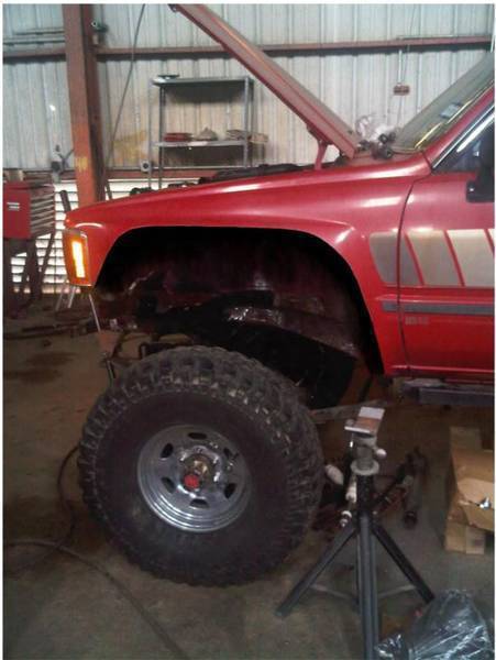

    I messed around with this thought last night
    Did a little playing around in MS paint. This is how I want to trim the front fenders up.
    What do y'all think?

    Just thought I would play with Corel photo paint a lil bit. Fender trimmed from a different angle. :)
