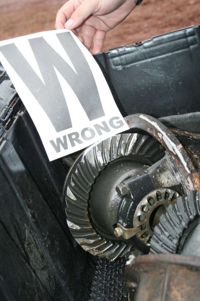

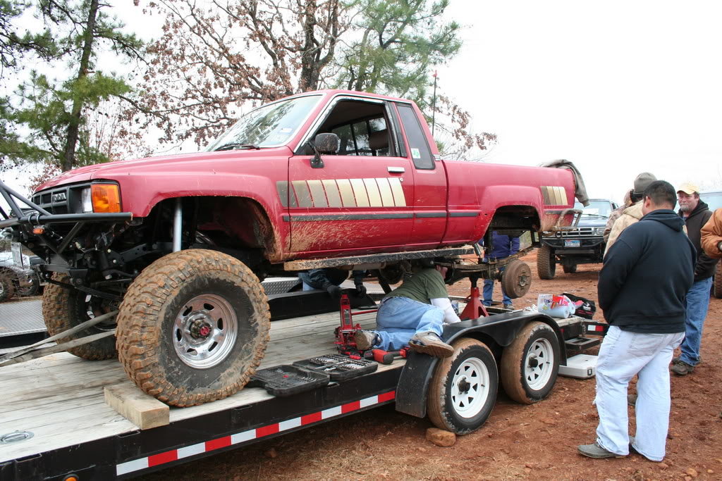

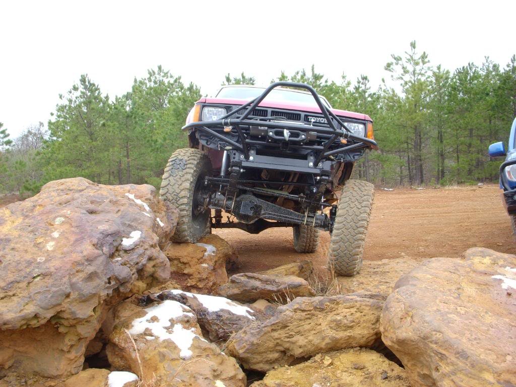

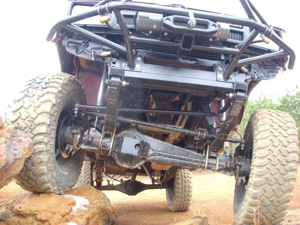

    Got to wheel the red truck on its maiden shakedown at the TX Lonestar Jamboree the weekend of Jan 13-15th.
    The truck did well overall for the most part.
    Here are some pics
    Rock garden flex
    It was pretty sloppy
    One of the trails

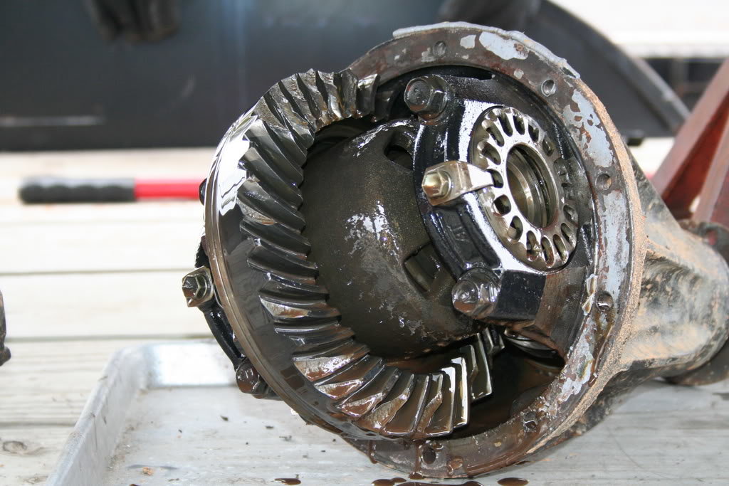

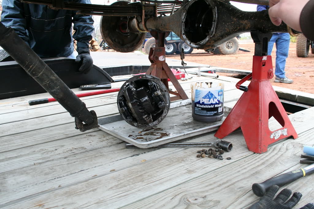

    Had a little carnage from the weekend
    Nothing like breaking 14 of the ring gear teeth :)
    Good friends and spare parts made the weekend a blast even though the weather was crap

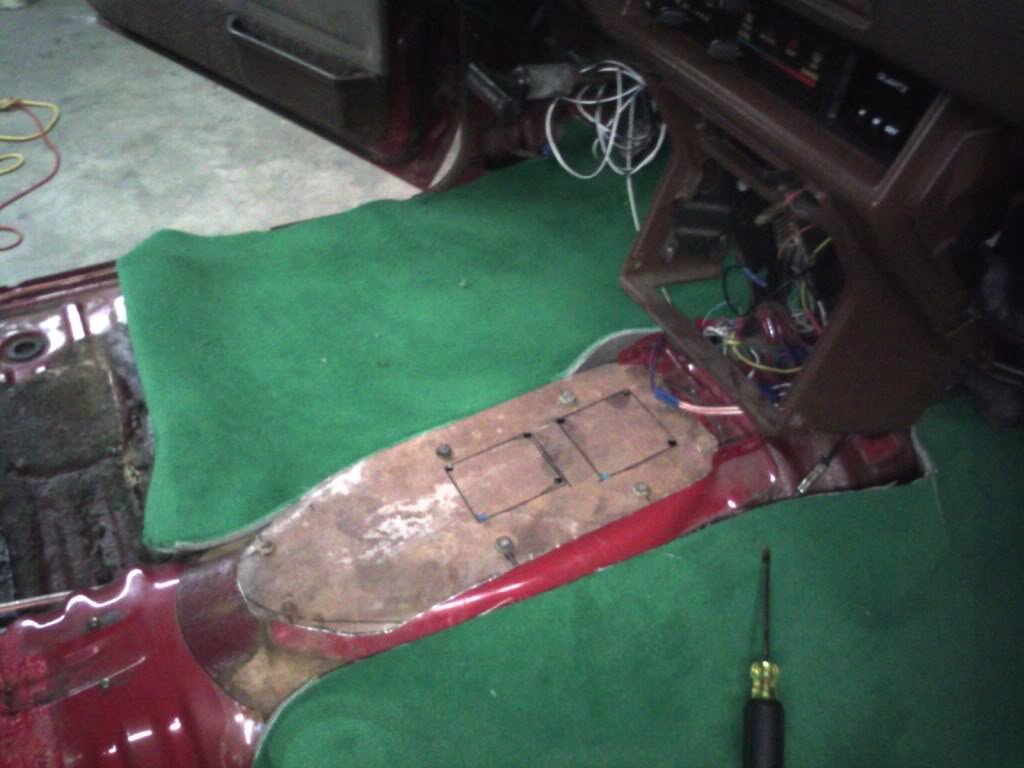

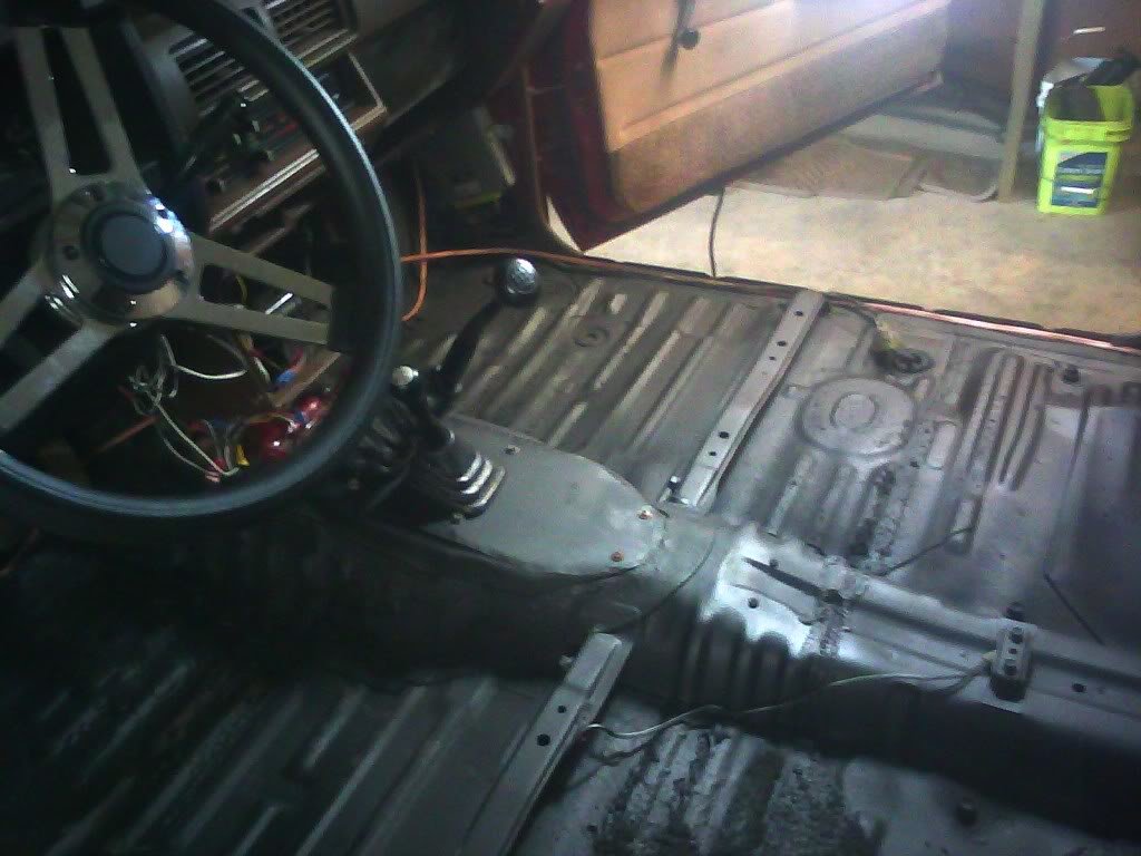

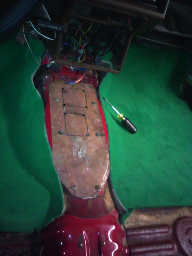

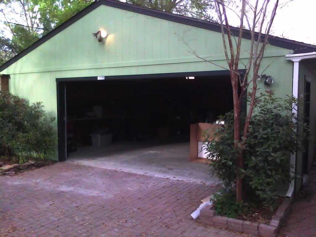

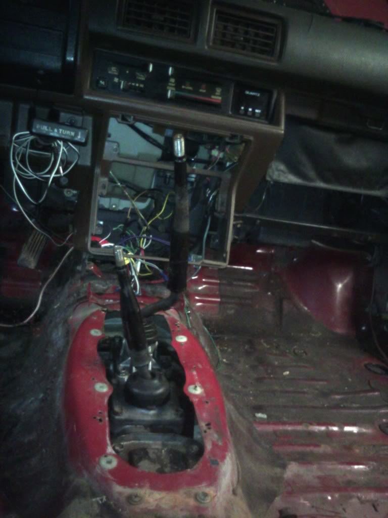

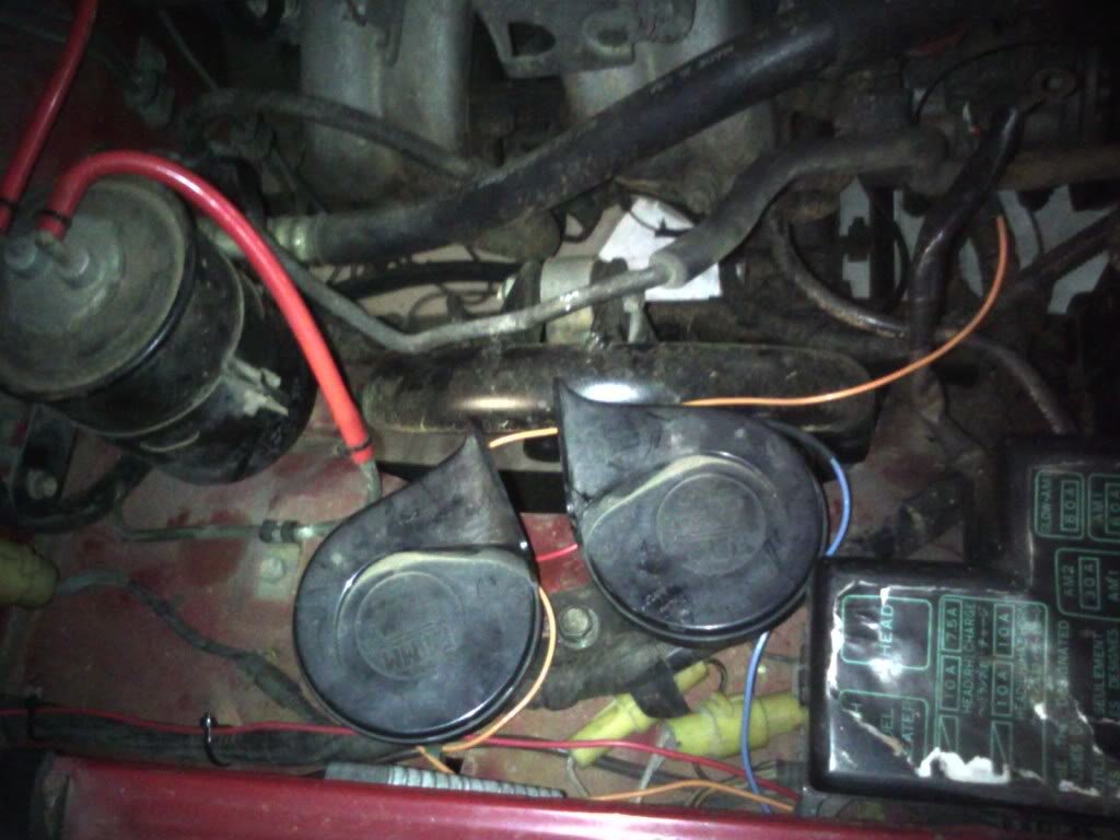

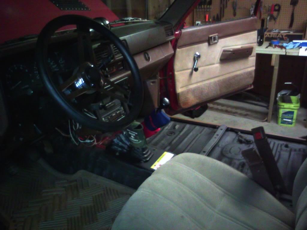

    I havent posted in a while: been busy buying a house. The best part is my new work area a 728 sq ft garage
    My helper
    Here are a couple pics:
    Interior stripped out

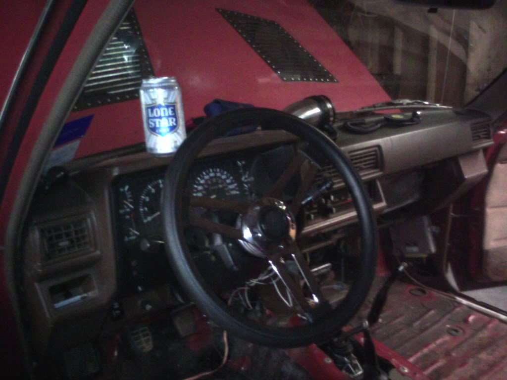

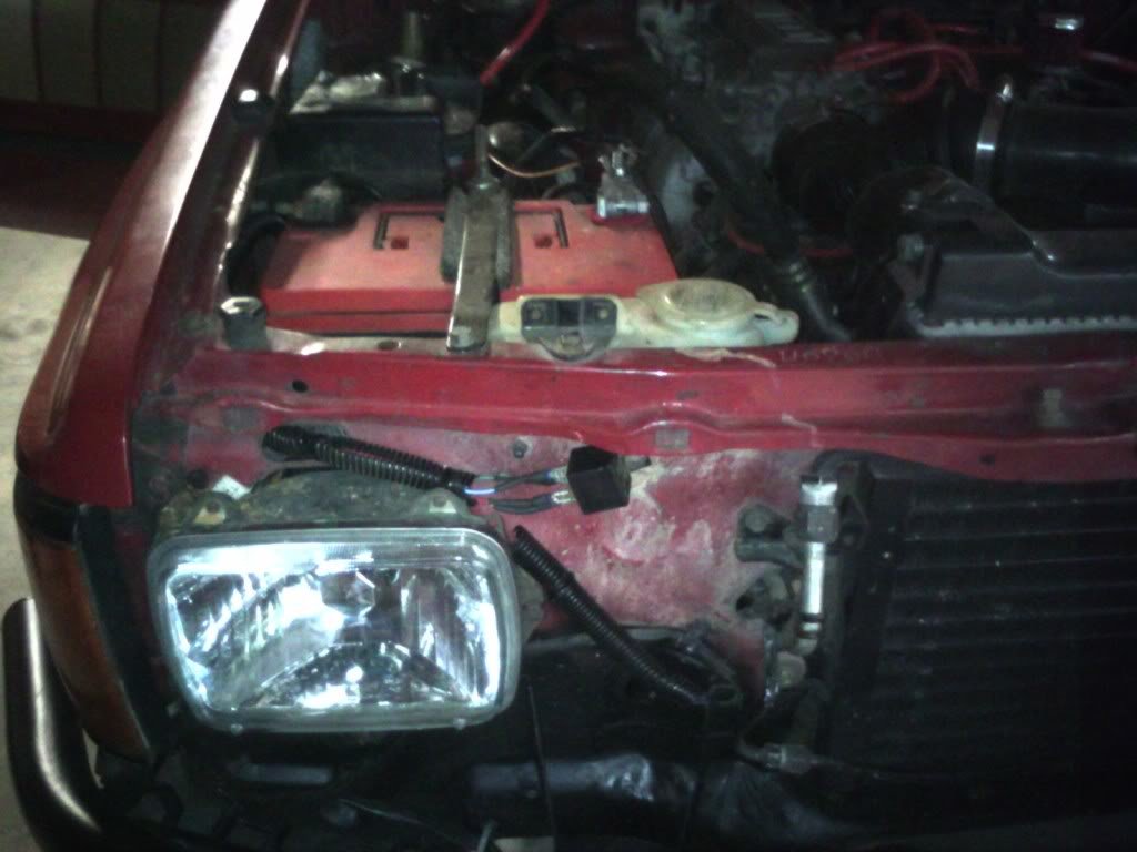

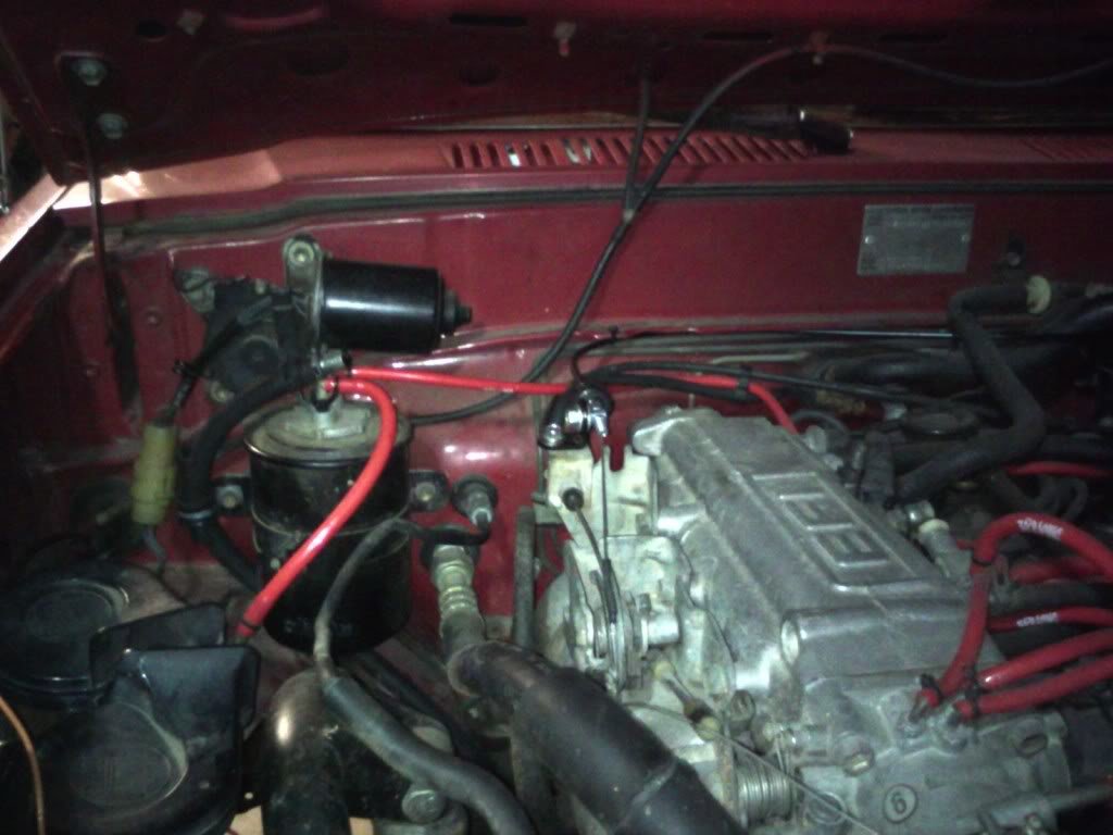

    Horn set up:
    Relay by front headlight
    Dont mind the misc. wiring. I will have it all cleaned up
    Grant steering wheel:
    BTW if you have the ground and hot wire switched on the horn button, the horns will scare the shit out of you when power is added :)
    I also started on Installing my RogerBrown light wiring harness but didnt get it finished up.
    Frond and rear diff breathers are done. Front routed to the firewall and the rear mounted by the gas cap under the fuel door.

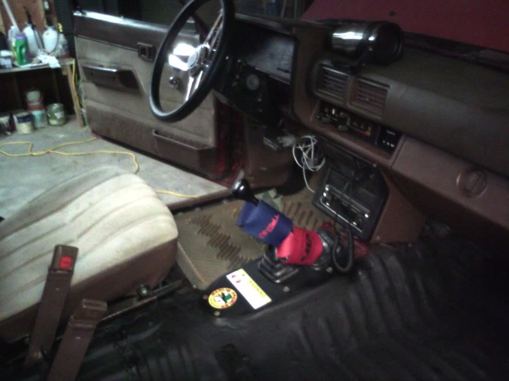

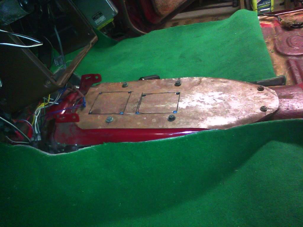

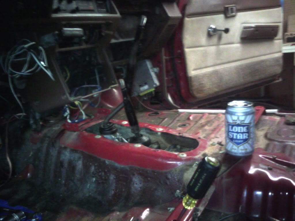

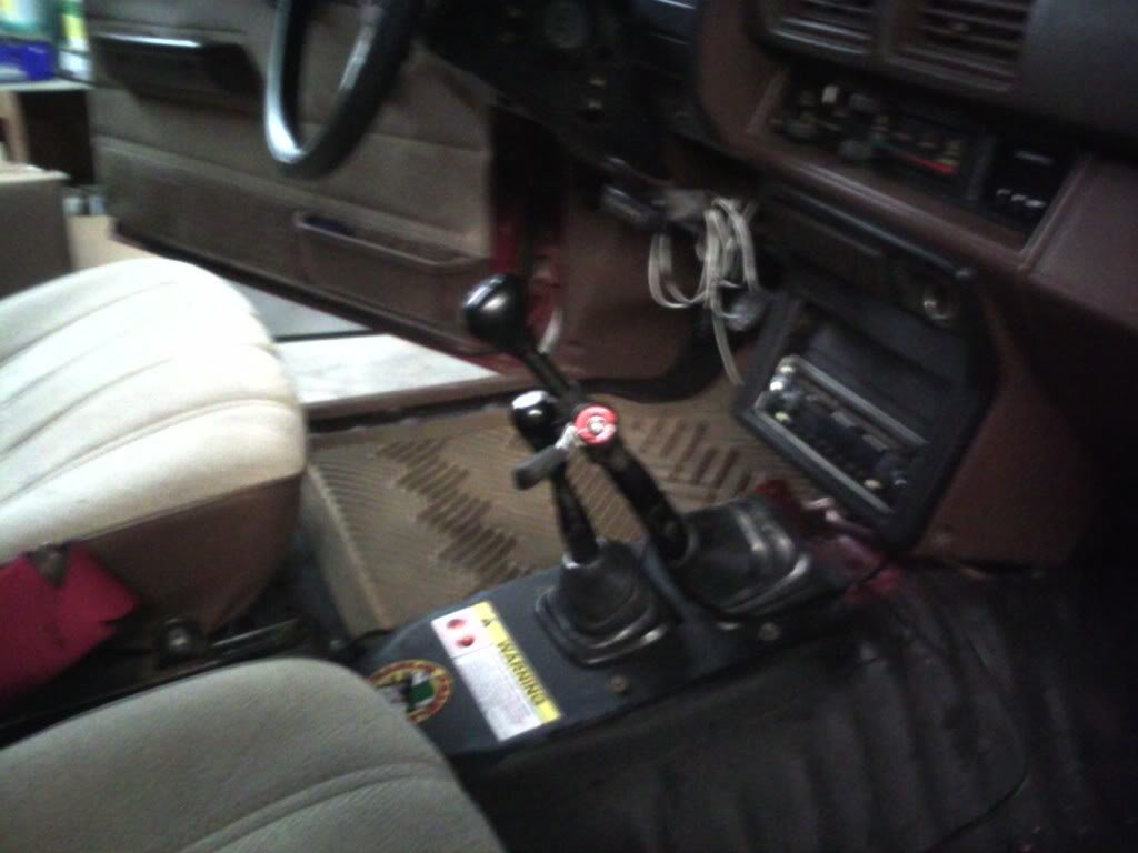

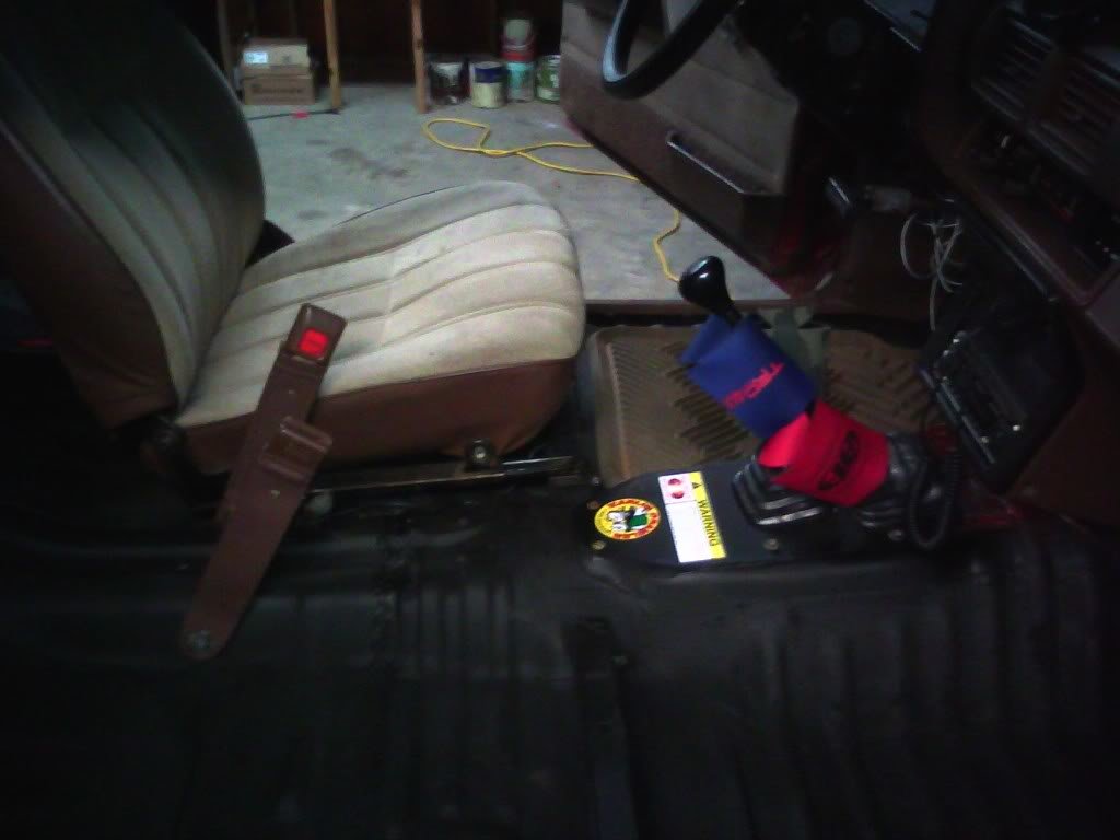

    I got my shifter cover mocked up and the holes drilled out last night. It will use the OEM screw holes to attach it to the transmission tunnel. I still need to cut the holes out of the shifter boots when I bring a jigsaw home from work.

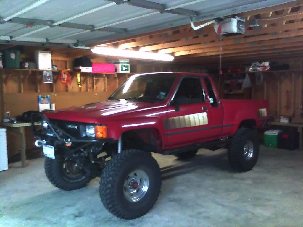

    Thanks. The look of the truck will be changing again very soon :)
    Getting ready for the new retro(ish) wheels and 37in tires

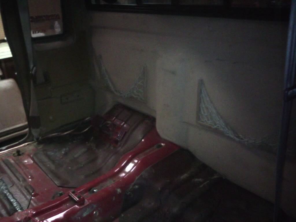

    Got a little done this weekend.
    I cleaned/scaped/vaccumed and degreased the floorpan. Then hit it with a little rust preventative/neutralizer. Plugged up a couple small holes with some caulk.
    Then I hit it with a little self etching primer and two heavy coats of bedliner in a can.
    I also got my shifter plate finished, painted,installed. Wired up my Boston 6x9's anmd got them put in too. I need to figure out asome brackets to keep themn in place.
    Everything thing is just about ready to put back in the truck.
    I also took off the front half of my front DS so I can trim a couple inches off of it.
    I even fired up Ol Red to make sure he still knew how and let him idle for a while

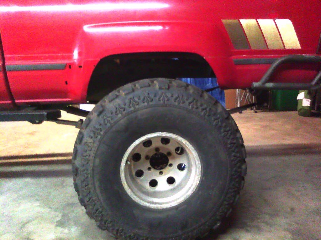

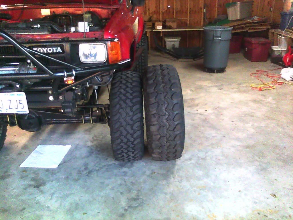

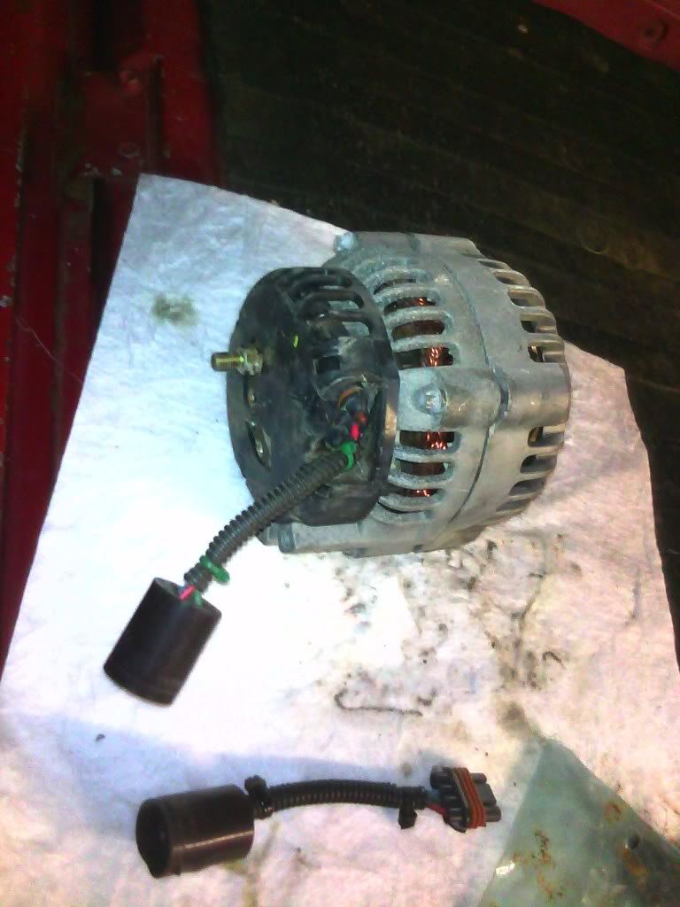

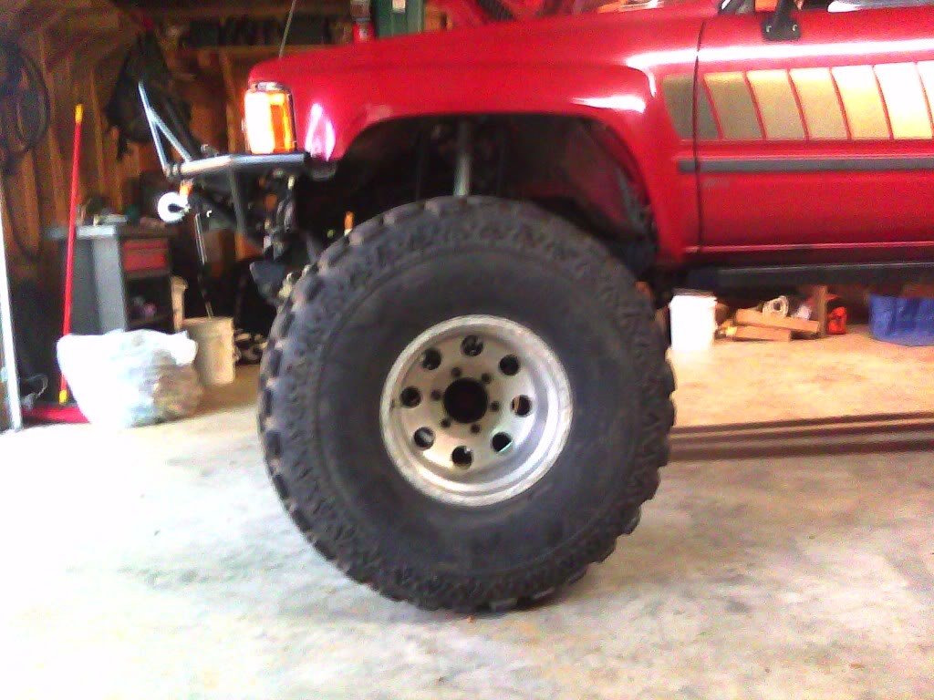

    Picked up an Optima Red top and a 120amp alt
    And some 37/12.5/15 Super Swamper SSR's
    Im going to need to trim the rear fenders a little bit. I had planned on that already.

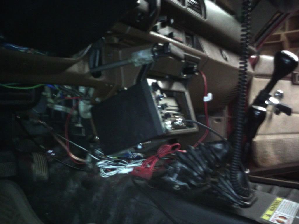

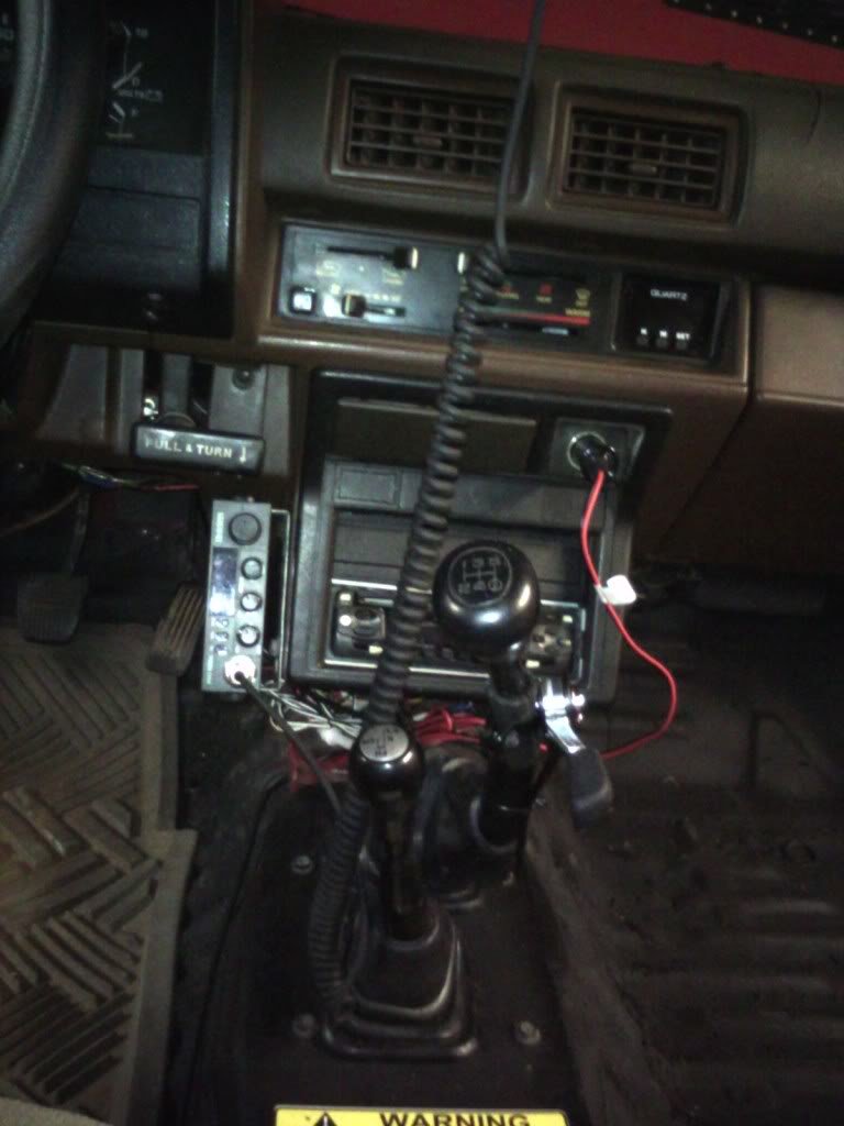

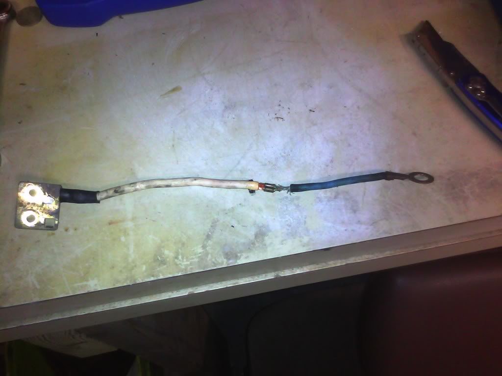

    Hand throttle 99% complete. I just need 1 wire crimp. One word of wisdom becareful of the positive terminal on the battery when the using any metal conductor under the hood. The inner steel cable conduct electricity good enough to create a nice arc under the hood :) and give you some nice burns on your fingers
    CB finally hard mounted :
    Ill try it there first and see how in the ways it is.
