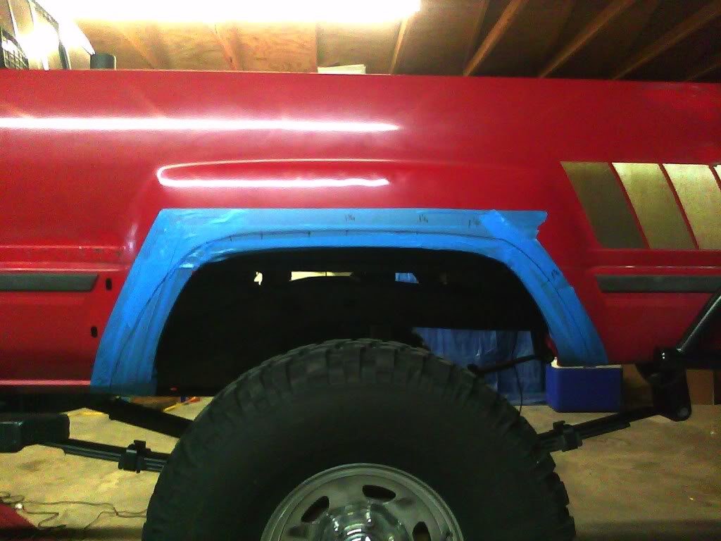

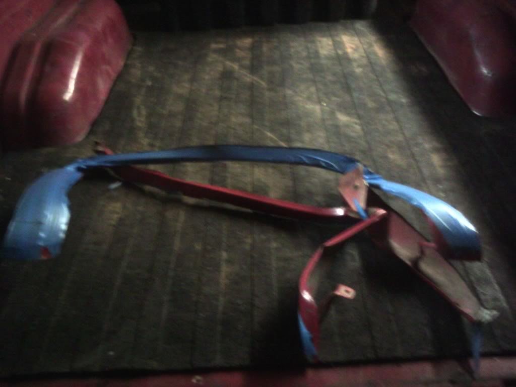

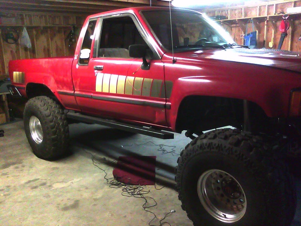

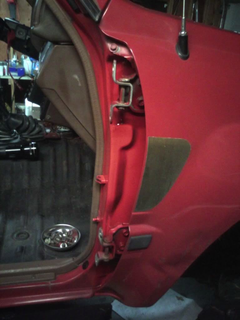

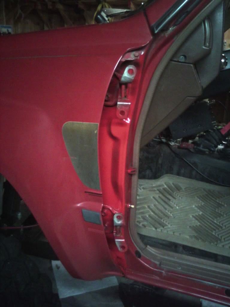

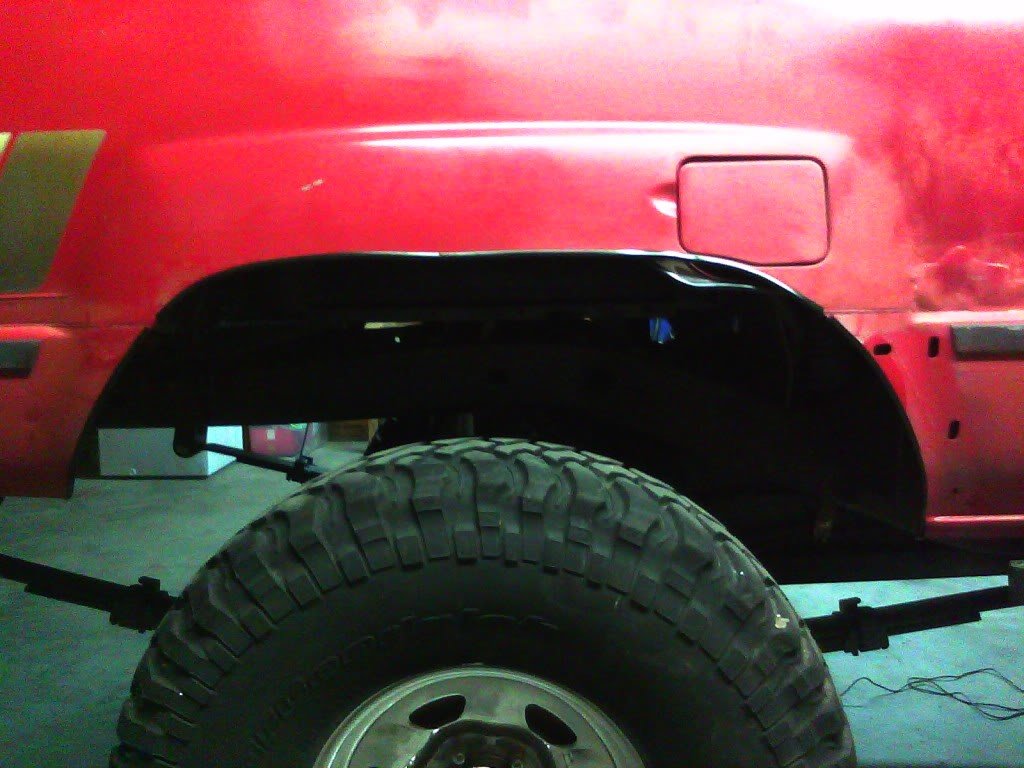

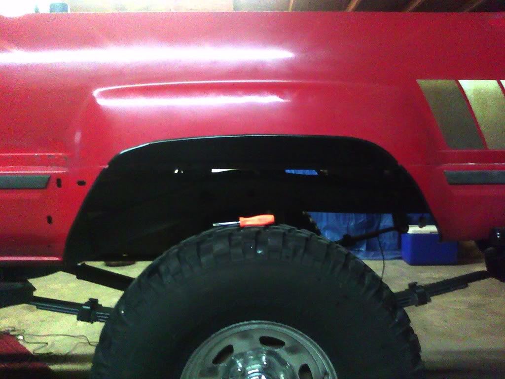

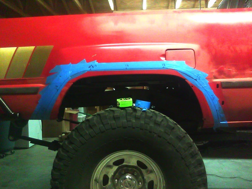

    Finally got my fenders taped off and trimmed up last night
    Passenger Before:
    After:
    Drivers Before:
    After:
    Trimmings :saw:
    I temporarily put some push on moulding on the cuts till i get the fenders rolled under
    They are not perfect by any means but will work for what I want to do with it.

    Nice! What moulding did you use? I gotta get me some for some cutting I have in the future.
  5. Jul 15, 2011 at 6:40 AM
    #165
    Boomtacoma01
    Boomtacoma01 [OP] Well-Known Member
    Dec 7, 2009
    #27162
    1,390
    Houston
    Its some cheap push on moulding that I picked up at Pep Boys. 2-24" peices in a pack for about $3.50

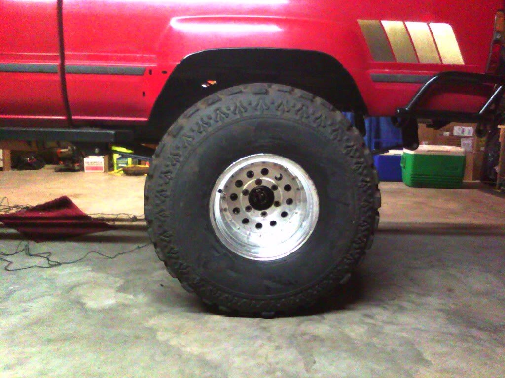

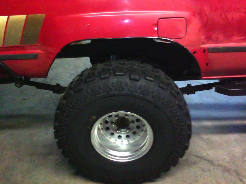

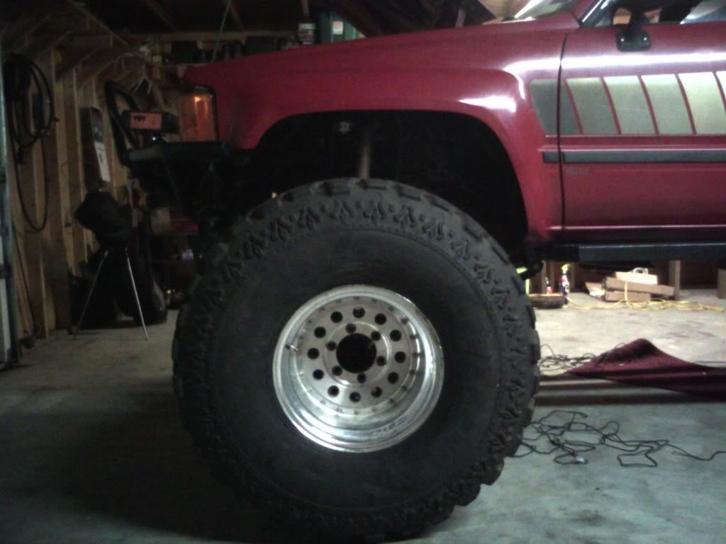

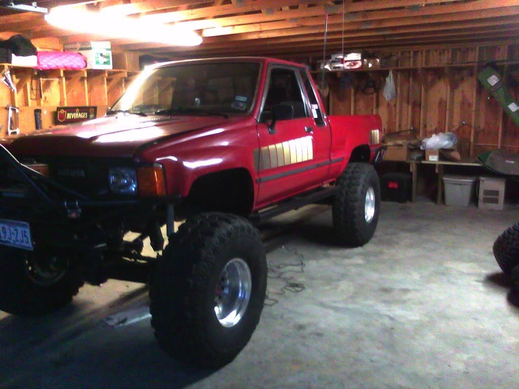

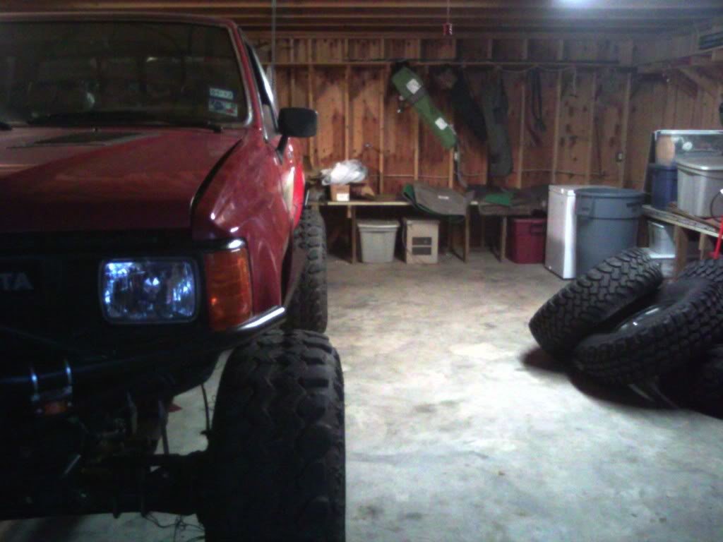

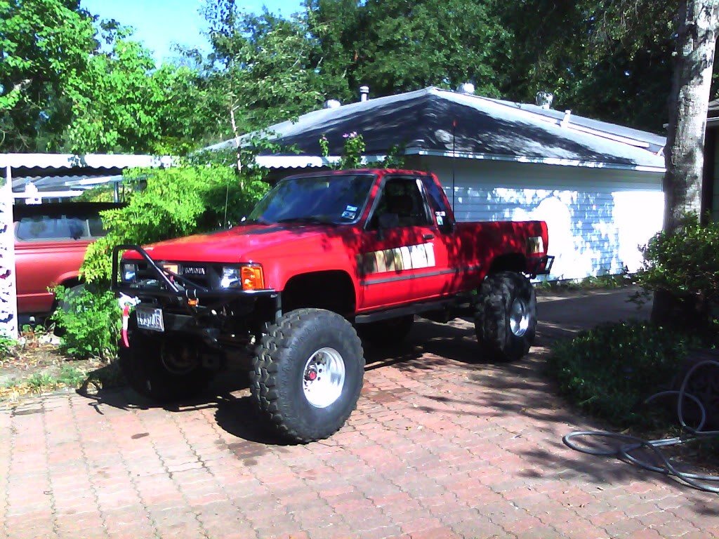

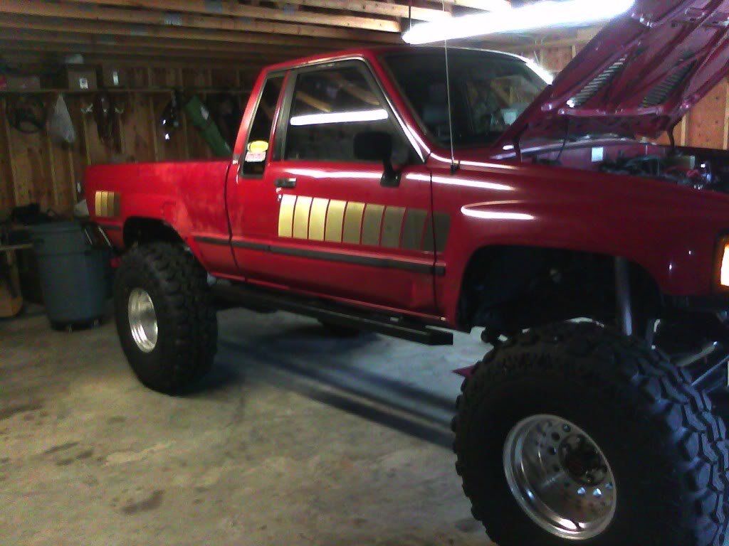

    Got the 37/12.5/15 SSR's put on
    Took the truck for a test ride with the new rubber and hosed him off for the first time in months
    The little 22re pulls the 37's pretty solid. The tires have a little wobble at highway speeds but not too bad.

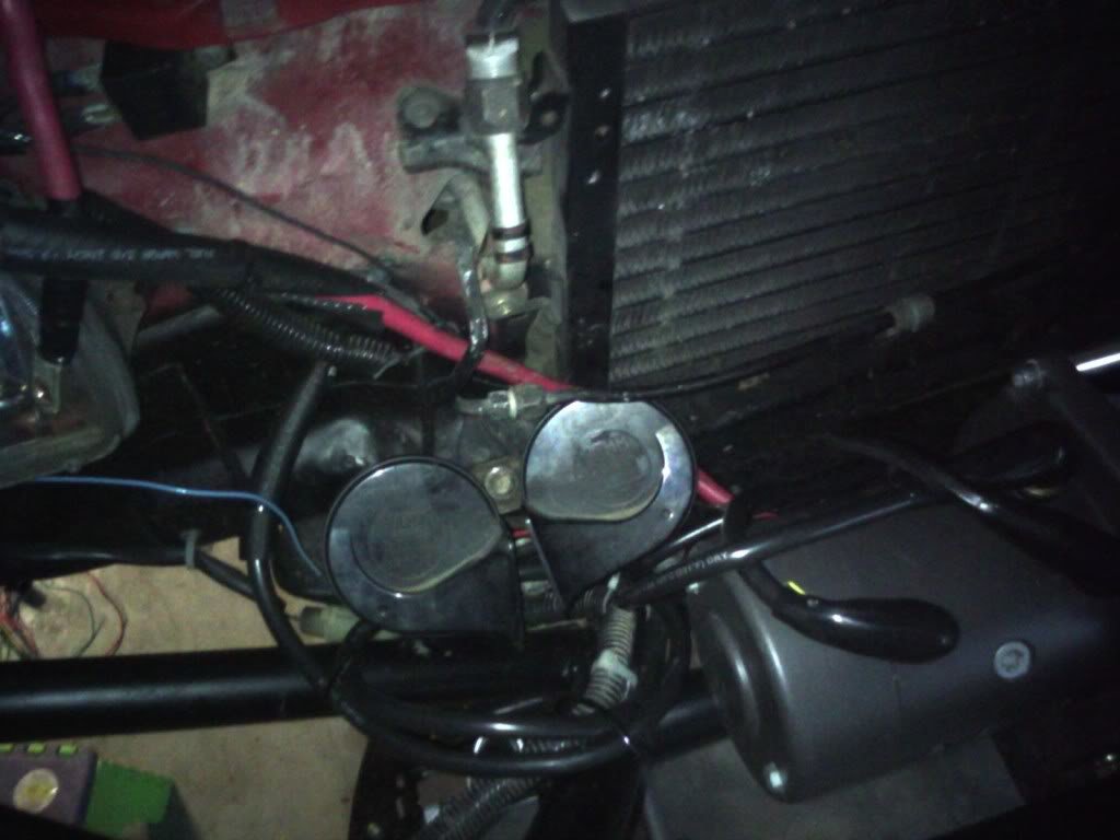

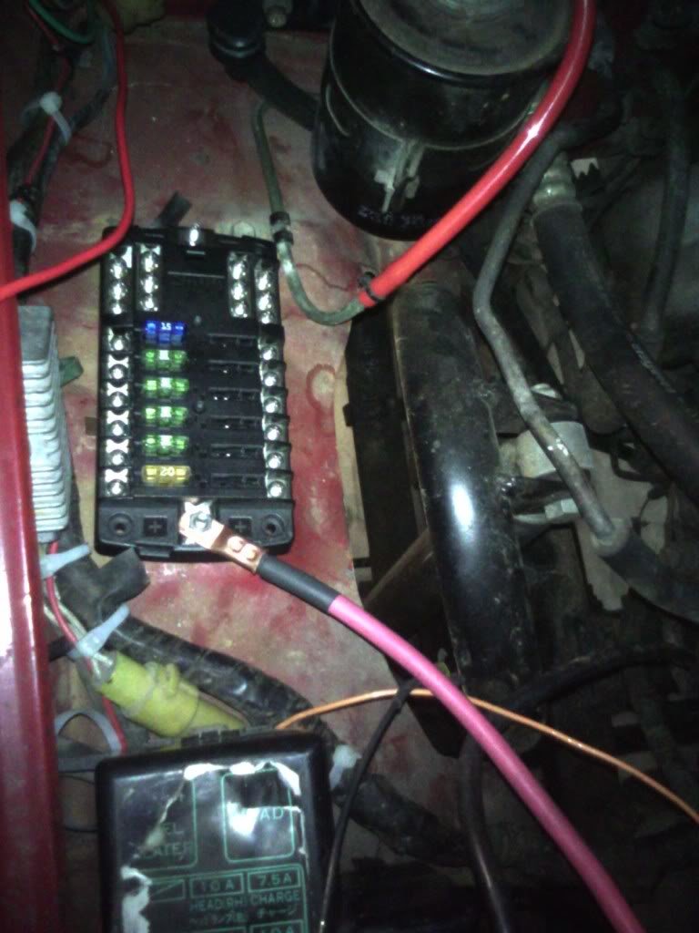

    Relocated my Ford horns to the front of the grill to make room for my next mod

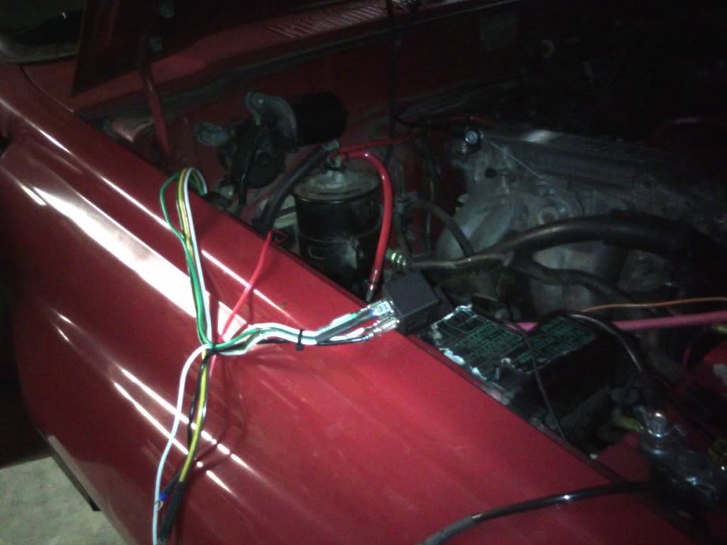

    Had to move the horns up front for the the install of the Blue seas 12 circuit fuse block. I made up a 4ga power and ground cable for that as well.

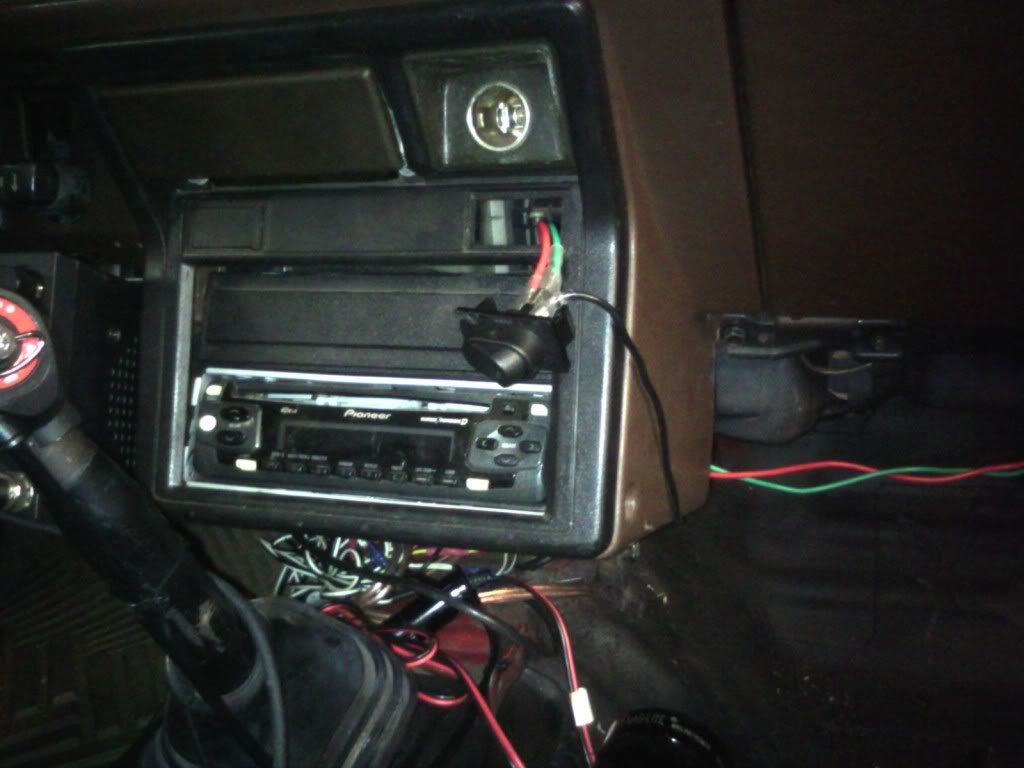

    Finally got my bed lights powered up. I ran the switch to one of the blank spots above the radio and used a 12V 30 Amp relay
    Switch not completely installed but working. I was chasing down a bad ground and a couple blown fuses
    Relay setup that will be under the hood
    Now i just need my warranteed tire to come in and Ol Red will be ready to roll again

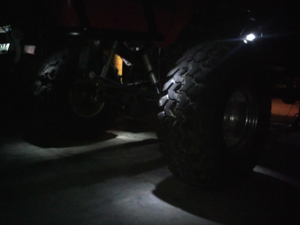

    Basically finished up all the wiring on the red truck (tucked away and zip tied). Finished the Vision X rock lights, and have everything hard wired into the fuse block under the hood. Just waiting on my tires to come in at 4WP so I can drive Ol Red around the block and hopefully to HF Labor Day weekend.
    Spent the better part of the last 2 days doing the Rammat install on my Tacoma. I have the drivers rear door done with the speaker wire run through into the cab. Got the rear of the cab basically finished. Also did the front floorboards as well. I ran my 0 Ga power wire form the engine bay to the drivers seat since i had everything taken apart anyways. I just need to finish the other 3 doors and get some longer bolts to hole the speaker rings in place and the install will be well under way.
    The Vision X rock lights put out plenty of light but have some kinda Bro functions. Except for the strobe, I like that. I thought I was going into a trance the other night while playing with the light control.
    I have had mine for about 2 yrs as well. I origianlly bought them for my Tacoma. There will be a shit ton of cable left which will have to be rolled up and tied out of sight.

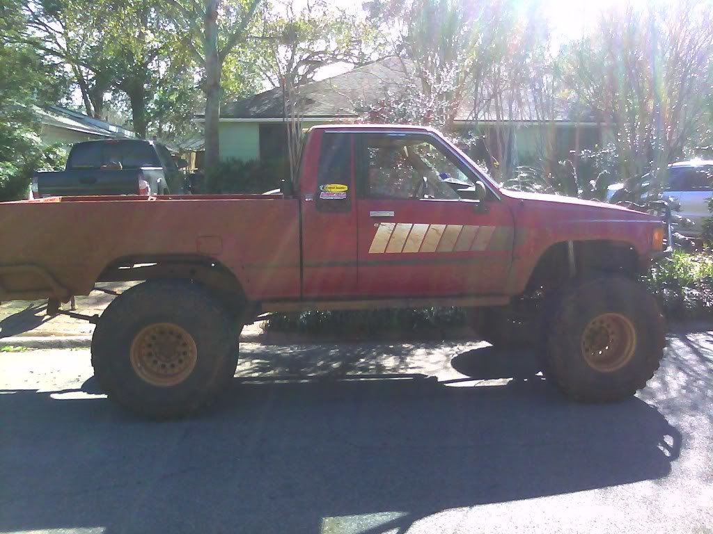

    Ahhhhh new rubber
    Back on all fours finally

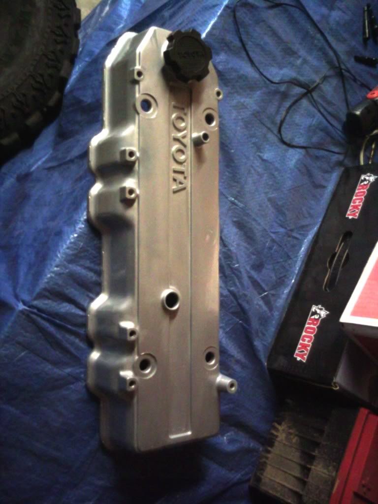

    Sweet PC'd valve cover

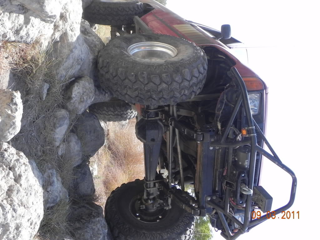

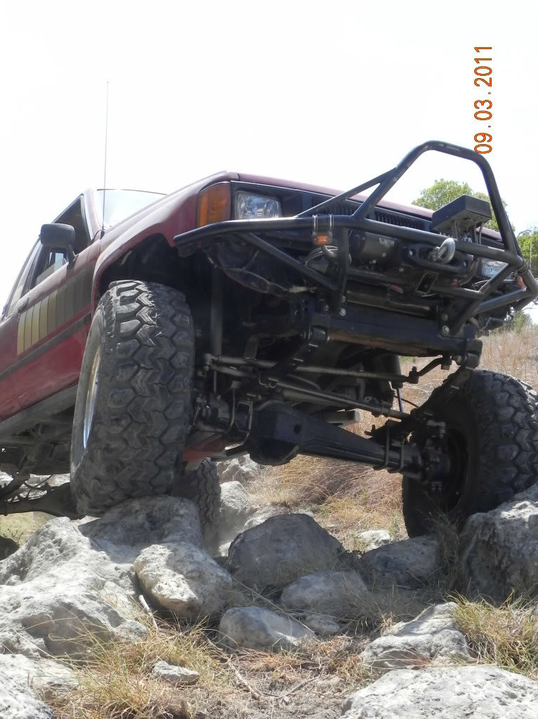

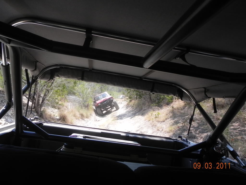

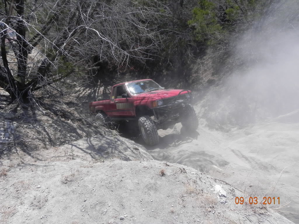

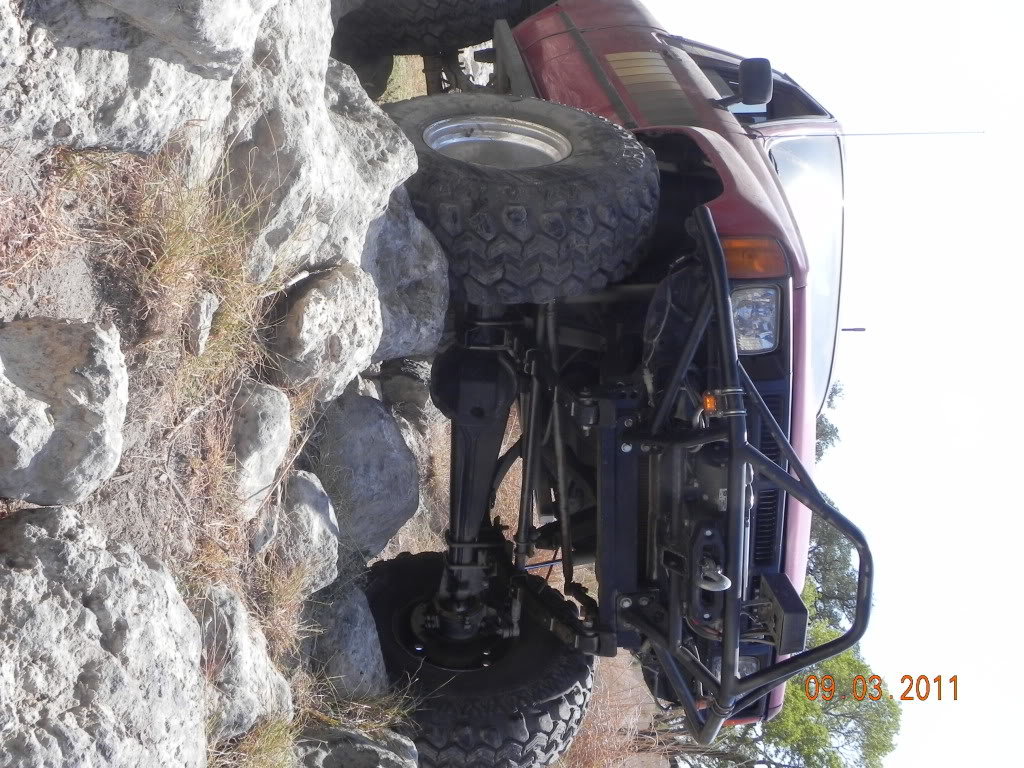

    Here are a couple from the weekend wheeling at Hidden Falls

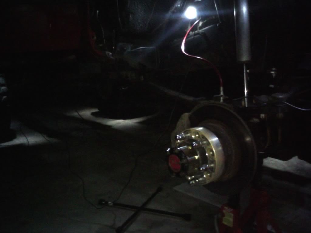

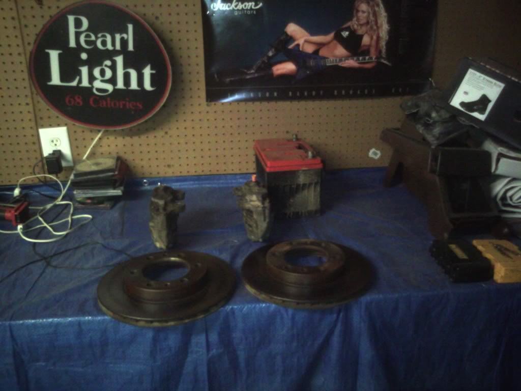

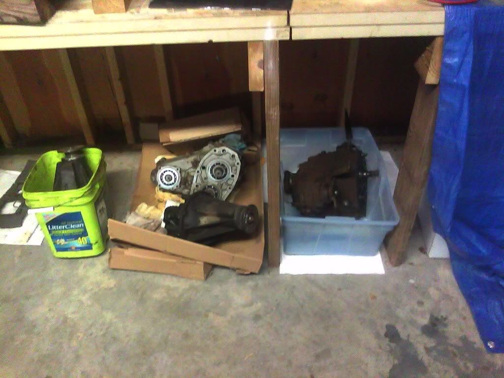

    I havent been up to much lately besides wedding planning. Cleaned up my set of IFS front brakes and calipers. I'll probably shoot a coat of paint on them before install.
    The TC to the left w/ MC 4.7's has a broken front output which will be replaced with a Marlin 30 spl front and rear outputs. Its pretty clean I just need to clean the stock top shift one a little more. I have a Marlin replacement 23spl 2.28 low gear for the TC on the right that I got last Christmas. I just need some more parts and time to get this thing put together.

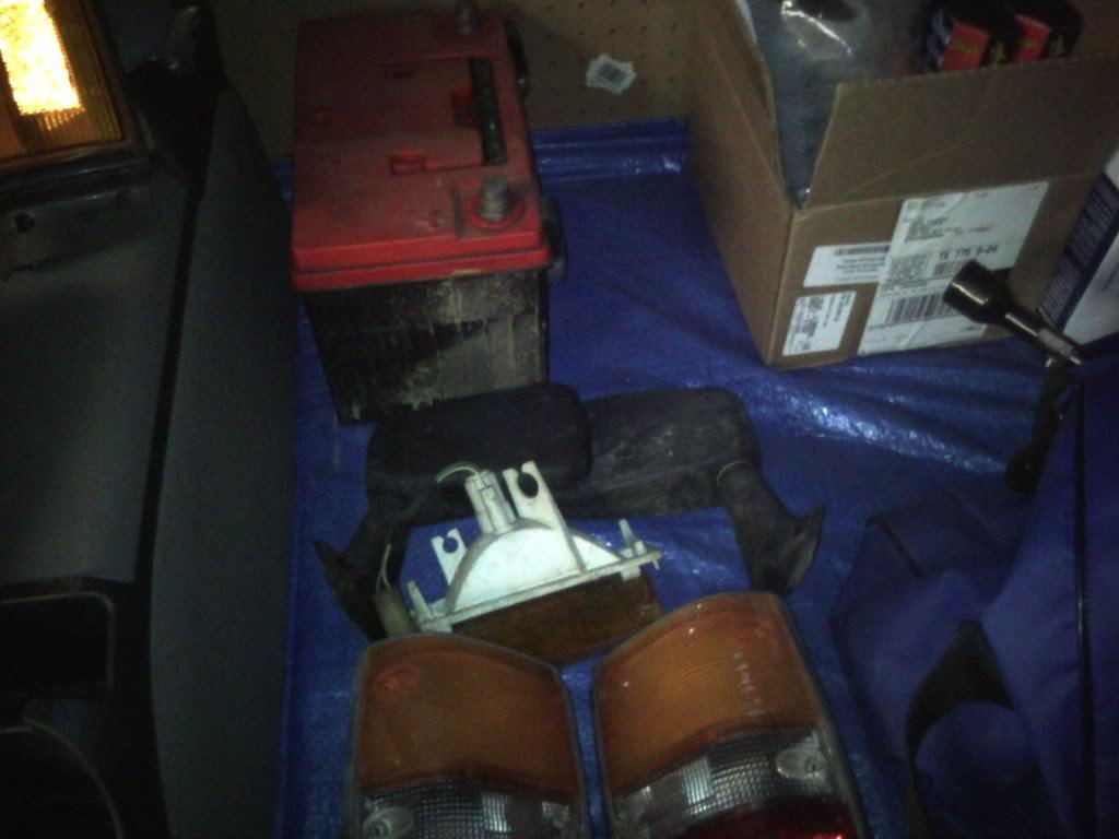

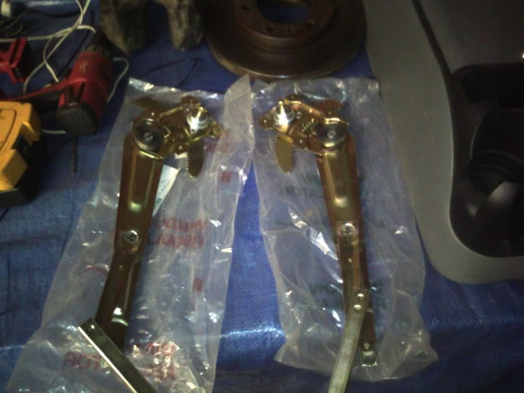

    Had a friend cleaning out his garage and foud a box of parts to an 85 runner that he no longer owns. It was a pretty good score: 2 new window regulators, 2 front marker lights, 2 rear tail lights, tan console, a ton of fasteners, and 2 complete seat belt assemblies and 2 mirrors
    At least I have a couple of spares on hand for any future incidents.

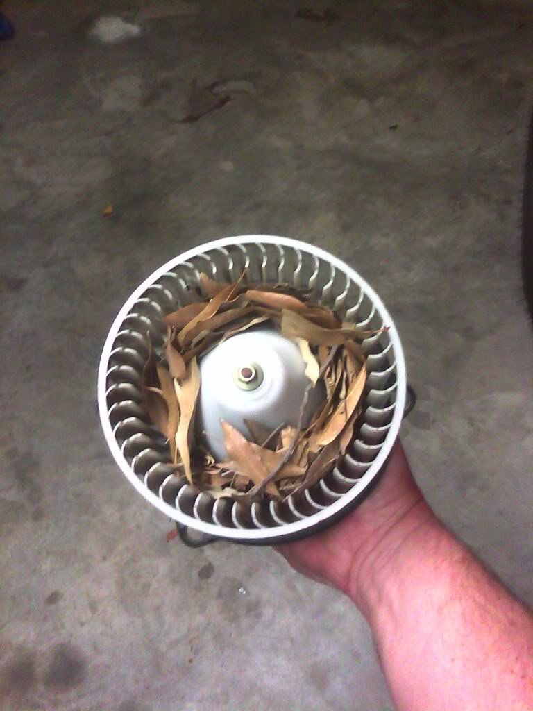

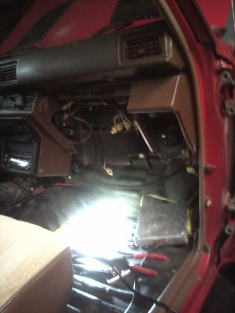

    Messed around on the red truck this weekend for the first time in about a month.
    I basically disassembled the whole dash to clean up wiring and see what the hell was going on with the lack of airflow coming from my vents.
    This was the passenger side.
    Found this in the blower motor assembly
    The condenser was jammed almost full as well.
    Got that mostly cinched back up. Just have to get the bezel around the speedo cluster put back on. Fan blows like a champ now!

    Sealed up the hole in my fuel door from when i trimmed my rear passenger fender.

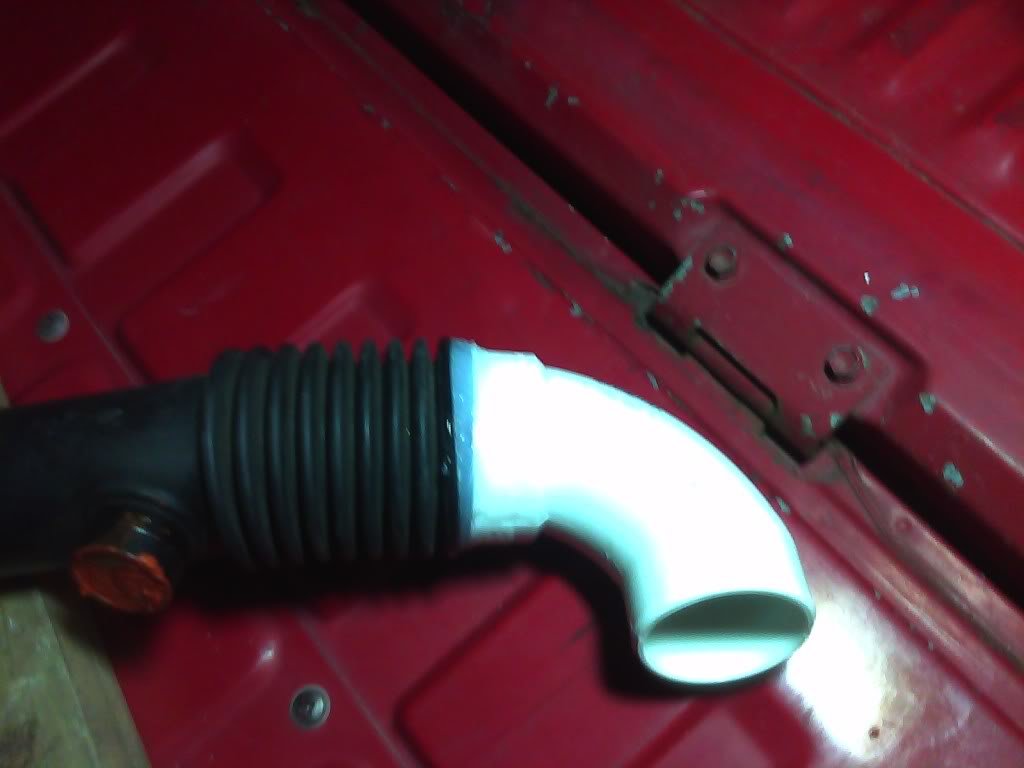

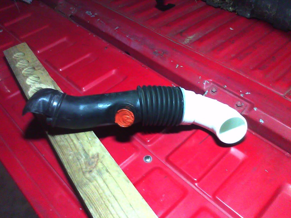

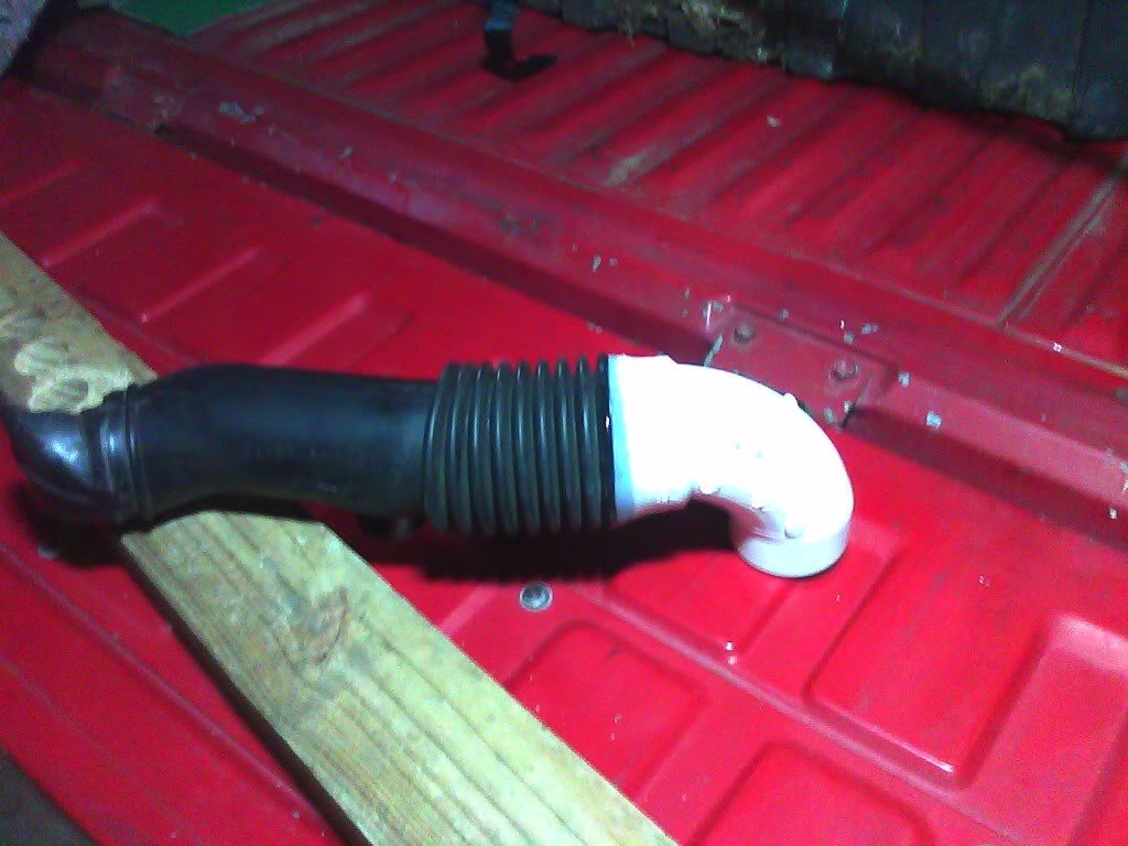

    Started to plumb in an inlet hose to the air box. A carbureated one doesnt work BTW. It almost does though.
    EBC greenstuff 6K pads are on the way along with a new high pressure steering hose. Mine is looking a little brittle. Might as well change it out before it blows.
    So this is what I came up with for my air box intake tube. I used a 2" PVC street L and the intake tube from a carbed 22R. I had to plug the extra port on the tube and put the 2 tubes together with a bead of silicone. Im letting it cure now and installing after that.

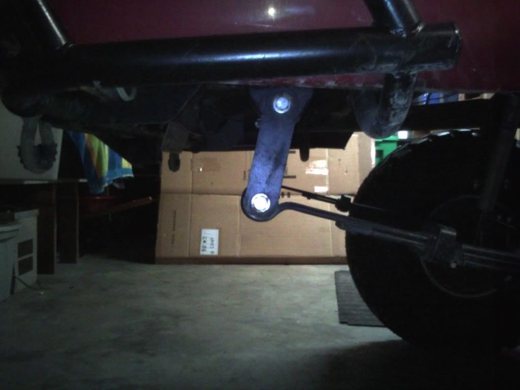

    Seems like my rear shackle angle is getting better too.

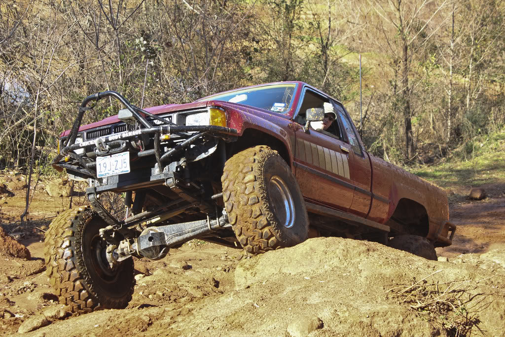

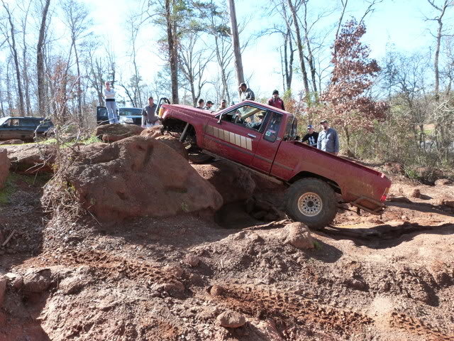

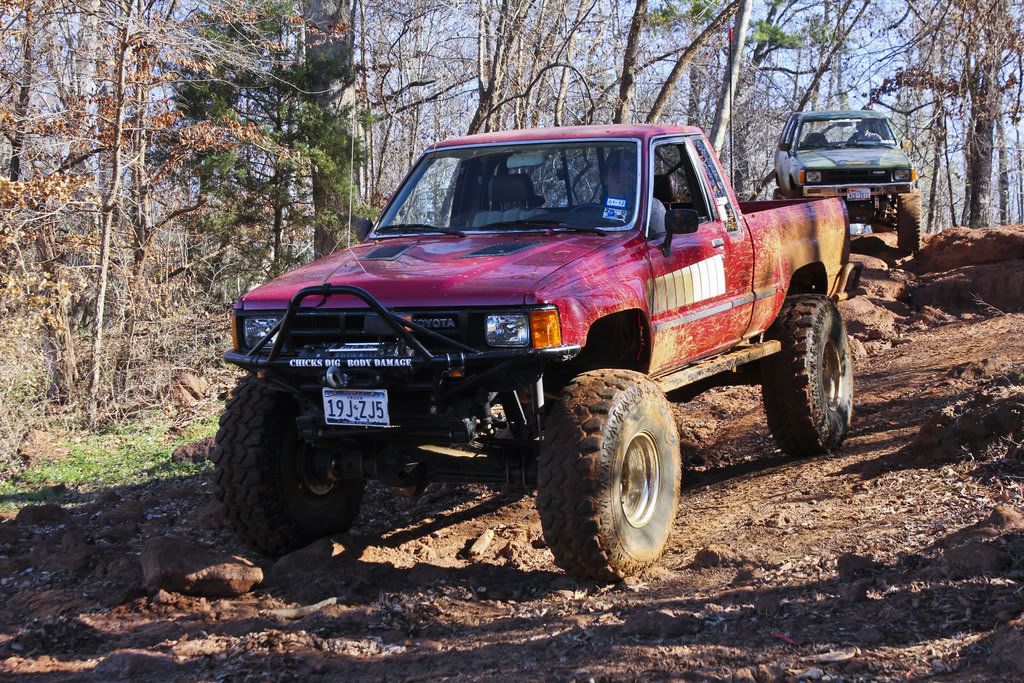

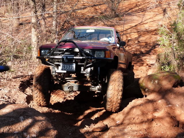

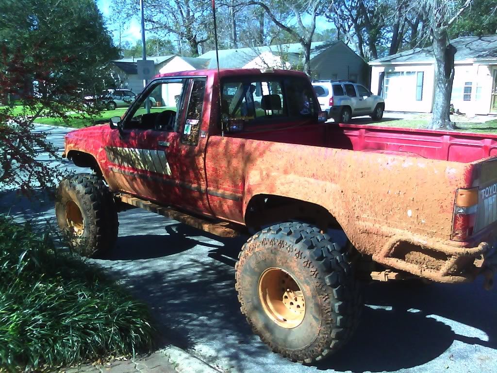

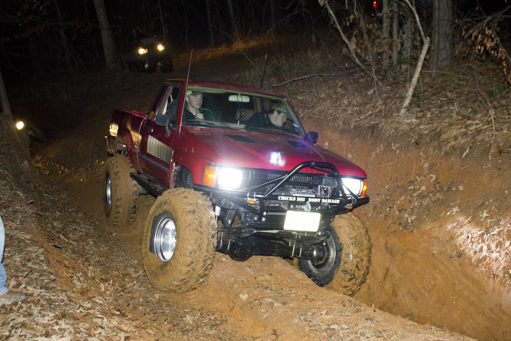

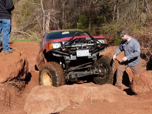

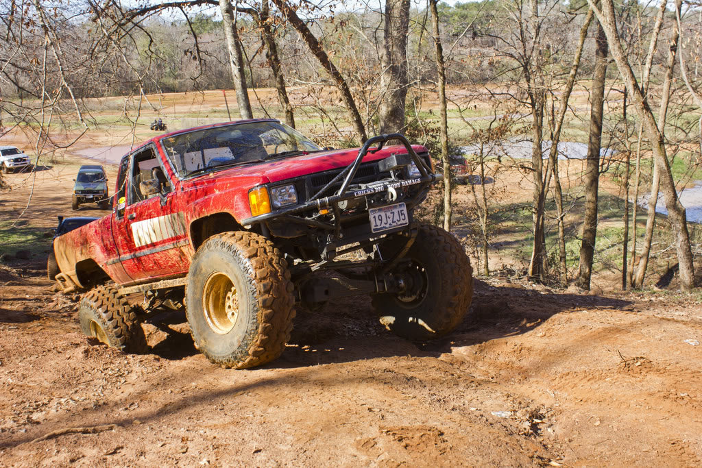

    Pics from Shiloh Ridge in Alto TX. A lot of mud and some trails. It was fun though!!
    The aftermath.....just a muddy truck no major carnage
