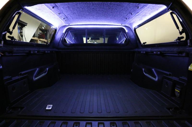

    With the canopy installed and LED lights wrapping the inside of the cap, it's picture time!
    The top is equipped with the Sportsman Package and Yakima Roof Tracks. The roof will support the added weight of a rack and roof top tent.
    The LED's seem to do a good job of lighting up the interior of the canopy. The true test will be a groggy-eyed midnight snack search!
    My sister gave me a battery pack and remote setup for a Christmas gift to compliment the light strips. I didn't want to hard wire the LED's into the truck at the moment

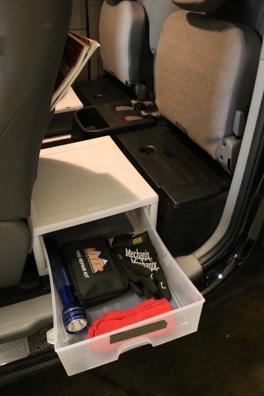

    Preface: One of my priorities when purchasing or making an item is Versatility. I like to have several uses for a single item if at all possible. Some would argue that you're sacrificing function, but it depends on what the sacrifice is. In this case it's portability. Something that is not permanently attached to the vehicle or is an irreversible modification like cutting fenders or in a lesser case, completely removing the rear jumper seats to build a storage platform.
    So I was cruising the storage area of Fred Meyer one day looking for a cheap drawer and found a Sterilite 16qt Stacking drawer. I have had these in the truck for at least 6 months now and they've been really helpful. It gives you a flat stable surface for camping bins on top and easy access to things you store in the drawers. The drawer will fit a pair of my size 12 hiking boots, but not much more. These cost maybe $15/ea. So for $30 you have a great storage setup that is easily removed for cleaning or carrying precious cargo.
    Link to drawers:
    http://www.sterilite.com/SelectProduct.html?id=631&ProductCategory=185&section=1
    I'm 6'-0" and have my seat slid back to just slightly touching the drawer and feel comfortable on long drives with the seat position.
    The top is almost flush with the factory storage areas under the jumper seats.
    The sides have bowed inward from carrying heavier items in them, but they work regardless. I usually carry several ratchet straps for easy access when tying something down.
    You can still fold down the rear jumper seat if needed.

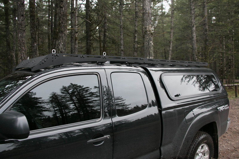

    So I finally had a chance to go through some pictures and share my Prinsu Design Roof Rack install.
    I was really impressed with the design and quality of this rack, it’s one of the only rack setups that I have seen that is able to provide a seamless look and transition from cab to canopy.
    Here are some pictures or what you get when your gigantic package arrives.
    All of the bars and side plates. These were all nicely wrapped and arrived damage free.
    The Various Bags O’ Bolts…
    Spacers, nutserts, and bolts.
    A Big Pile of Rack Bolts.
    A Smaller pile or rack bolts.
    Canopy Track attachment bolts (these were replaced by Thule track nut kits).
    Rack tie downs and extra track nuts.
    One of the things I changed was the rack attachment bolts and nuts for the canopy tracks. I found what I felt was a stronger option from Thule that fits the Yakima tracks that are installed on the Snugtop canopy. The nut is almost twice as thick and has a more positive lock up in the rack slot due to the angled cut.
    Since no two canopies seem to be the same, I had to do some adjusting of the mounting feet to fit the profile of my canopy. In order to keep the powder coat pretty I used a shop towel and a large adjustable wrench to persuade the feet into place. The center tabs had to be bent up more than the outer tabs to follow the curve of the canopy.
    Once I had the Cap Rack installed it was time to install the Access Rack on the cab of the truck. This took me a lot longer to do as I was taking my sweet time to do it right and not have any leaks in the future. After assembling the rack I started test fitting based on measurements given from Prinsu. Once I found the sweet spot I worked on leveling the rack to match the Cap Rack. This took some shimming with washers to determine the right height, from the front of the rack to the back there was a 1/2” difference in height. So I went on the hunt for spacers to match what was in the kit. I found some very similar with a thicker wall but the same outside diameter. As a result of getting taller spacers, I also had to get longer bolts as well. These were an easy find at the local hardware store.
    The front spacers are 1” tall, the center is 1 1/4” and the rear is 1 1/2” tall.
    When it came time to drill the holes in the cab, I bought a three pack of stepped drill bits form Harbor Freight. These actually worked really well. One thing to be VERY careful of on the access cab is the side curtain airbags. I actually pulled the headliner down and drilled one step on the drill bit at a time, inspecting the hole with a piece of plastic hose to feel for any obstructions. There are 6 holes to be drilled per side. The two most rearward holes are the ones to be the most careful on. USE CAUTION when drilling these holes as they are VERY close to the side curtain airbags!
    Once the holes were drilled, the nutserts were installed and glued in place with a sealant to help with waterproofing
    Next it was time to install the rack. I used a 3/4” O.D. leather hole punch for cutting the holes in the weather stripping. This made for a nice clean look and a nice seal around the spacers. I put a bit of sealant on the bottom of the spacers to help keep moisture away from the bolt holes. The same sealant was used on the bolt threads as well when installing them. I also added thin rubber fender washers on top of the spacers just under the rack feet.
    Call me paranoid, but the PNW sometimes gets rain… And then it was time to bolt it all down like a cylinder head on a NHRA dragster. In the end I was really pleased with how it turned out. It’s been a great rack so far and has been used to haul the RTT, lumber, doors, noisy children, etc.
    Here is the finished product:

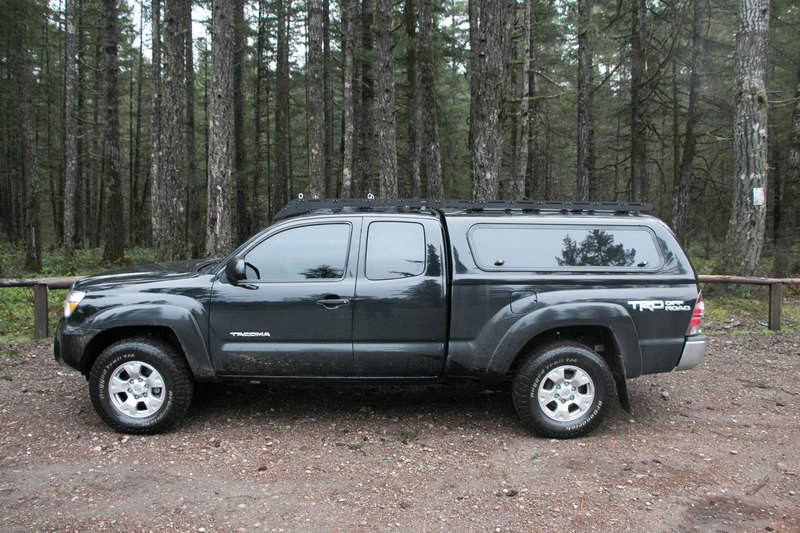

    We went out to Tahuya state Park to do some exploring.
    Here are some side shots of the rack setup.

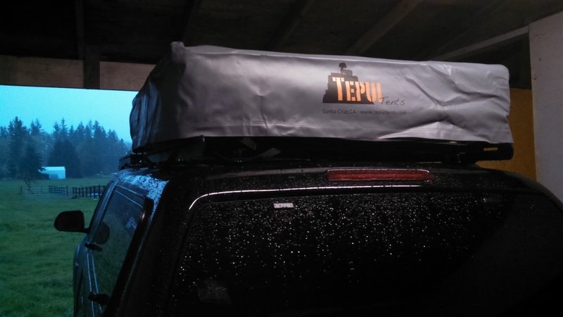

    After installing the rack this year, we heard about an open house event at Mule Expedition Outfitters in Issaquah, Wa. We had a great BBQ lunch and met with a lot of the crew and other folks at the shop that day. Super cool! It was a nice sunny day and by the time we got home to install it, it was raining like crazy, but it HAD to be installed and it HAD to be used, THAT NIGHT! So we set to work in the horse barn to get it installed and then set it all up in the backyard for the first night of testing.
    What better way to test than in the rain!
    In the barn...
    Out of the barn and into the light!...errr.....rain.......
    The morning after. Survived the night, nice and dry.

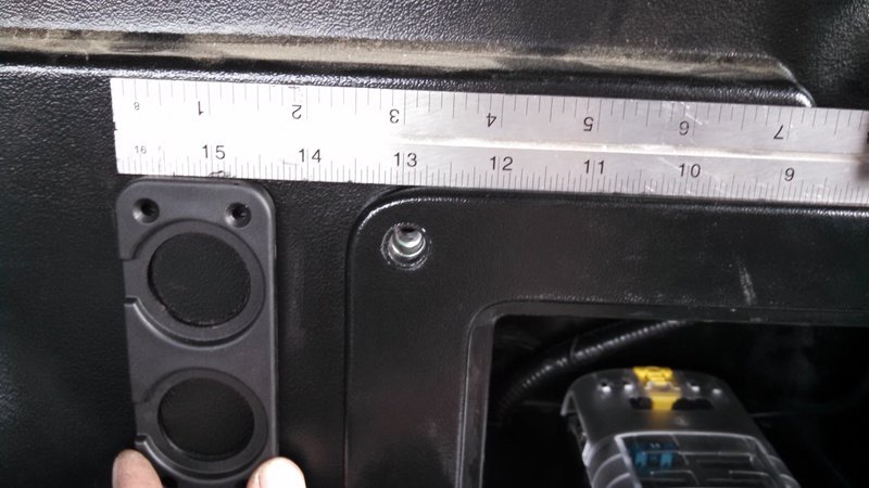

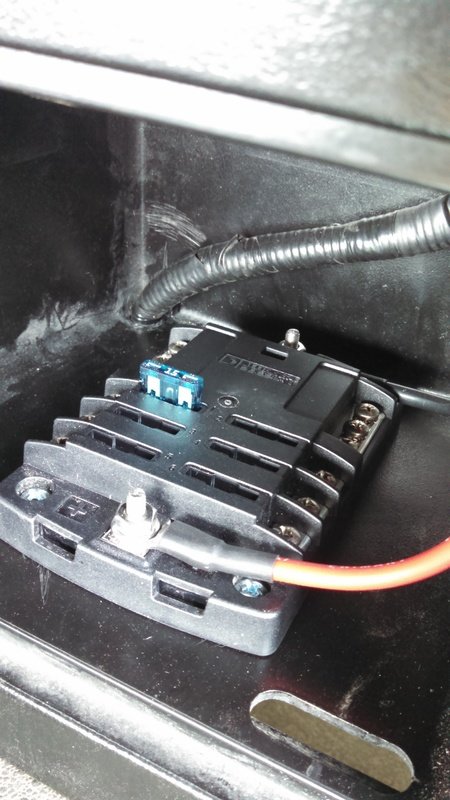

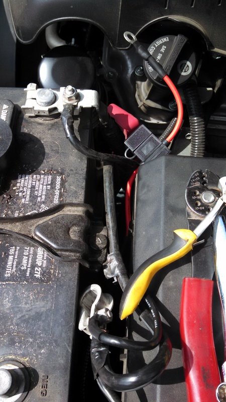

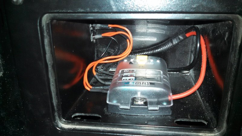

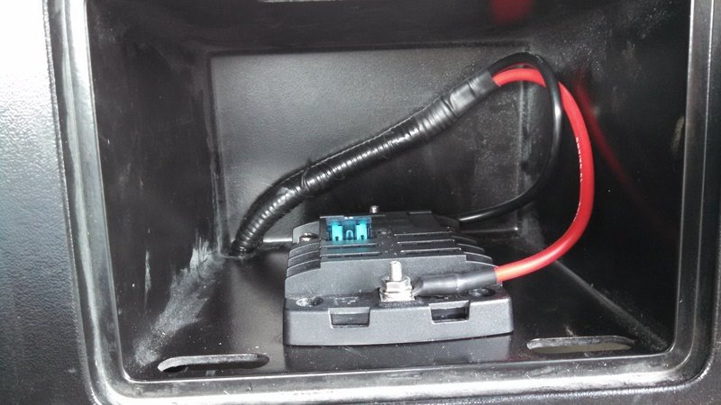

    So We recently purchased an ARB 50qt fridge and ARB 1250 awning for the truck. I used @rkfoote instructions for doing a 12v system in the bed, since I'm not yet decided on a dual battery system and would rather build a SPOD style unit for in the engine bay.
    The parts I used were from Powerwerx, I got a 4.2 amp USB charger and an anderson powerpole dual plug for the ARB, I will eventually put a switch in for the USB charger so it doesn't drain the battery.

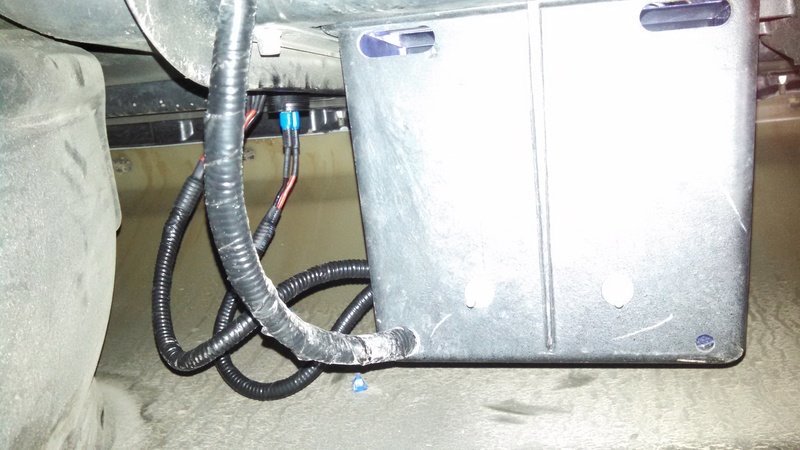

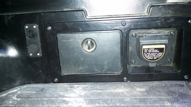

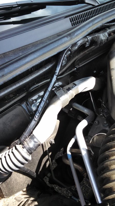

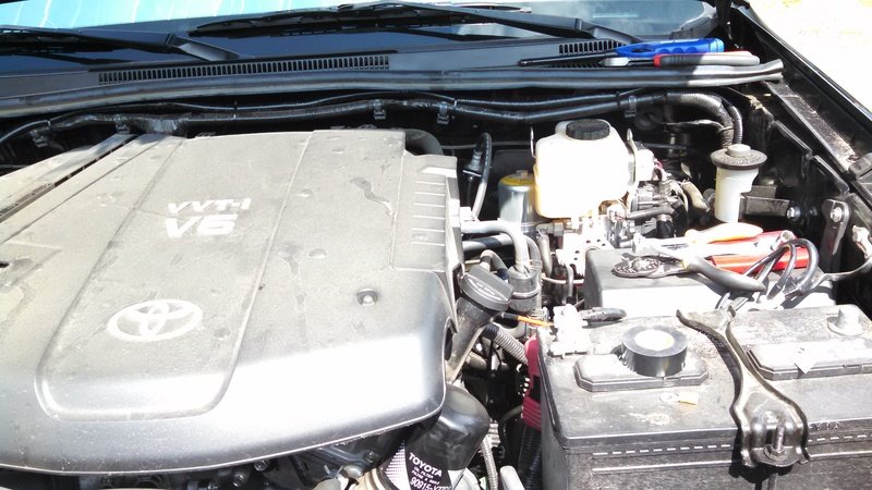

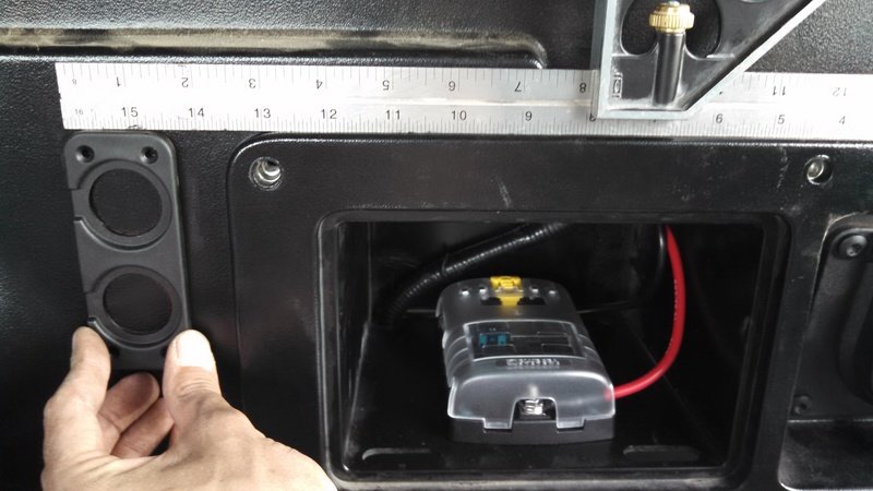

    So I started by making a 25ft wire loom from 10awg wire, I went from the battery around the back of the firewall and down the pass frame rail following the 110v bed outlet wiring to the back.
    Connections to the battery with inline 30amp fuse.
    Down the firewall to the frame.
    Main power wired to the box.
    There are two drain holes in the back of the box, I enlarged the one to get the wire loom through and attached a zip tie so it would fall back through.
    Checking behind the side wall, there is a structural rib about ¾” from the storage bin opening, so I aligned the top of the panel with the top of storage bin and located the new panel over 2 ½” to the outside edge of it. I have allowed room for future expansion of items below the two that are currently installed. The only issue with mounting the panel vertically is the plugs are installed sideways to allow use of the covers.

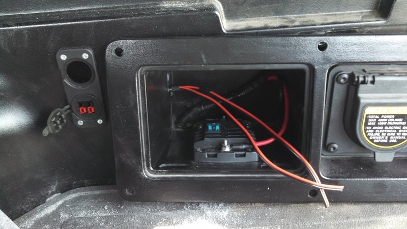

    Overall view

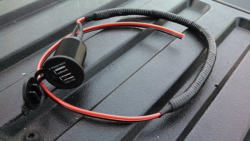

    Here is the USB charger wire loom ready to be installed, I drilled holes in the side of the storage bin for the wire looms to come through. And zip tied then on the inside as well so they would fall back through.
    Wire loom through the side.
    This is looking up into the area behind the rear tire and fender area where the box is located.
    Wires getting ready to be attached.
    EDIT:
    Here are some more pictures

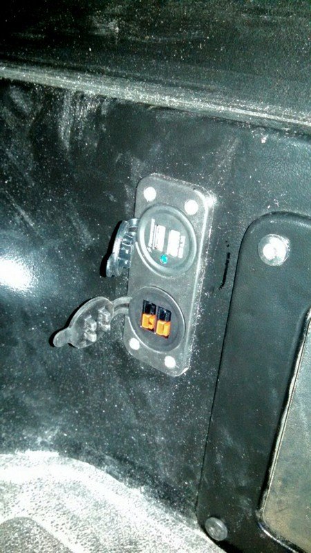

    View of the plugs, (sorry for the washed out flash picture, it was getting dark out)
    Wires connected. I would like to add a switch for the USB as it will always be a drain.
    All buttoned up.
    Thanks go out to rkfoote for his write-up and all the others who I have gleaned info from.
