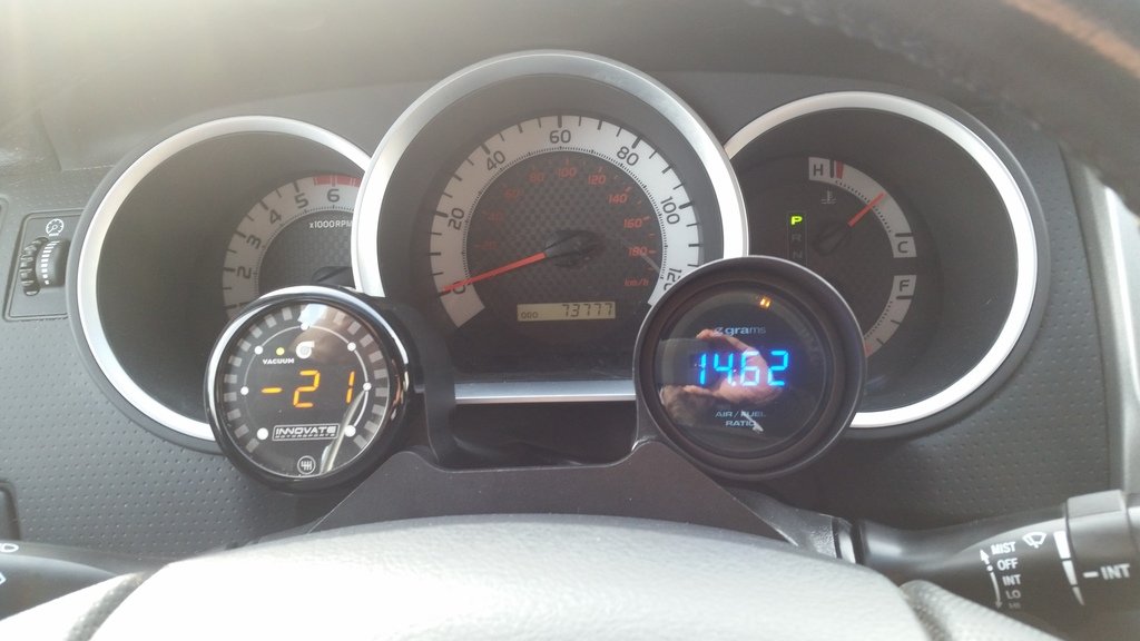

    I'm making this post to help others make a better more informed decision for when and if they want to get gauges on their blown Taco's.
    I will have to edit this post as I don't have an immediate picture to show. I'm running an Innovate MTX-D boost gauge and a Grams AFR gauge.
    Max limits are 10:1-20:1. Great AFR gauge compared to my stupid MTX-L which NEVER worked and always populated an E8 code. Just replaced it with my Grams gauge and here's a concept... it actually WORKS, and damn well at that also! Hahaha.
    Max boost PSI on the MTX-D gauge is 30PSI and reads out vaccuum as well. I had to double up the gauge faces on them in order to tint down the lighting because running just one was ridiculously bright at night. Even with having the dimmer hooked up to it. Solid combo, just have to work a few contact points at the wheel out while turning it. Both hooked up to be on at ignition ON position.
    Post up your combo, max limits (if you know them), how you have them hooked up to work (if you know that as well), and if you have done any mods to them at all.
    My current setup.

    Just look for 14.7 at cruise, around 10.5 or so at WOT runs. (Extremely rich, as all our boosted tacos should be no more than 11.5, but thats okay, better lower numbers at WOT than anything over 14.7 at WOT). As for boost look for anywhere at 7.0-8.0 PSI at WOT since you have the pulley (assuming you have a GOOD intake URD, AFe). Good to go looking at those numbers now. :thumbsup:

    The Grams AFR boost gauge is garbage. Without warning it started blinking 20.00 AFR all the time, which would really be a problem at night and is not true either. I am going to switch out to an AEM X-series gauge and change it's LED color to orange to match the other gauge using a stage gel cover.
    I receive the gauge tomorrow.
