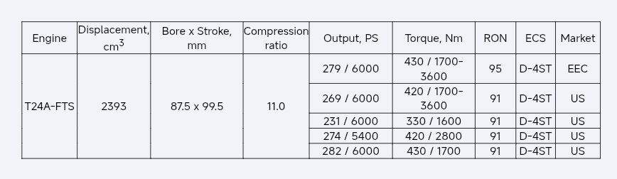

    I know what "oversquare" is: bore longer than stroke, so I assume undersquare is a long-stroke engine.

    The T24A-FTS is an undersquare engine because the distance the piston travels is longer than the diameter of the cylinder bore:
    87.5mm (bore) to a 99.5mm (stroke)
    This is part of why the engine doesn't rev very high, since the longer the stroke the higher the piston speed at higher RPMs compared to a shorter stroke engine.
    That's fine though because with the tiny twin scroll turbo and long stroke setup it makes a lot of low end torque.

    Thank you for the explanation and the diagrams. My previous was an 86mmx86mm bore/stroke. New rabbit whole of learning to go by. Hope I didn’t hijack the thread.
